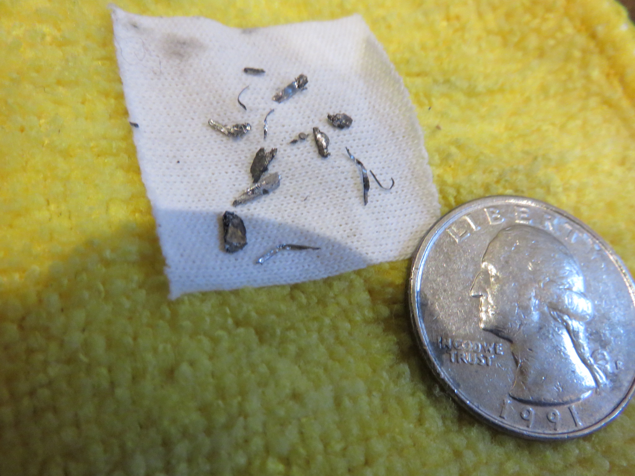

The first and last time I used Thunderbolts, 6 years ago during that shortage, and they leaded up my barrels so bad I could hardly get my cleaning rod in the barrels. Upon some considerable effort I managed to removed chunks and flakes of lead out and get the cleaning rod in to do a proper cleaning.
This is what some of that looked like from out of a single barrel:
This is what some of that looked like:

It's pretty obvious that if you were hitting steel at 200 even with thunder stuff you now have a major lead/carbon ring that is stripping the driving band off the bullet and turned your .22 into a musket. May come out fast like the Pic of the patch in the thread or may have to work it a bit. Patch left in place to dwell, maybe JB's. JB will also polish throat area and maybe help slow the leading process.
