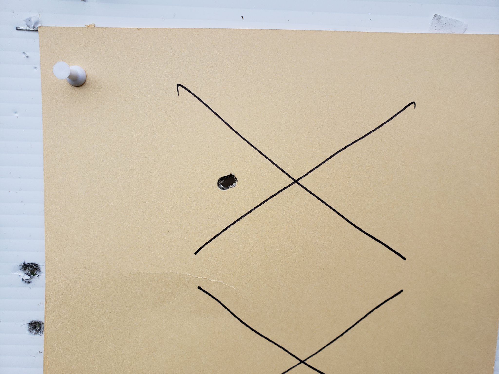

    Keystone Accuracy is a local gunsmith that has done barrel work for me in the past. Keystone recently asked me to test one of their button barrels that they speak very highly of. I was more than glad to shoot the hell out of it. Keystone uses 416 SS Green Mountain blanks for most of their button barrels and contours, threads and chambers them in house to your specs. They offer other blanks as well including Wilson and Kreiger to name a few. I've never tested a Green Mountain blank but have heard good things from guys that have shot their 22LR and 223 Wylde AR barrels. I was looking forward to see what it could do.
    26" 6.5x47 Lapua
    Green Mountain Button 1:8
    416 SS
    M24 Contour
    Bighorn TL3 Shouldered Tenon
    Muzzle Threaded 5/8-24"
    I havent done any load development or testing on this barrel prior to todays testing. In my experience, button barrels have really tightened up in the 25-50rd mark. Because of this I loaded up 55rds of junk Nosler 130 RDF's with 41.1g H4350 in virgin Lapua brass just to get some rounds down the barrel. The 130 RDF's did not disappoint, they shot like shit like they have in every barrel I've tested them in. LOL. I put 35rd through it then put a wet patch down the bore of CLP then dry patched it out. I then put the remaining 20rds down the barrel and let the barrel cool down.
    I then shot a 5x5 over the LabRadar at 100yds with some 130 Bergers. First group down the barrel was 0.342". At this point I had been outside in 35F for 2hr and my hands were pretty frozen. I will be loading up some more 130 Hybrids to shoot at distance next range trip.
    To recap I was more than surprised at how well this Green Mountain shot. Especially with zero load development. Really good deal on a great shooting barrel for sure.

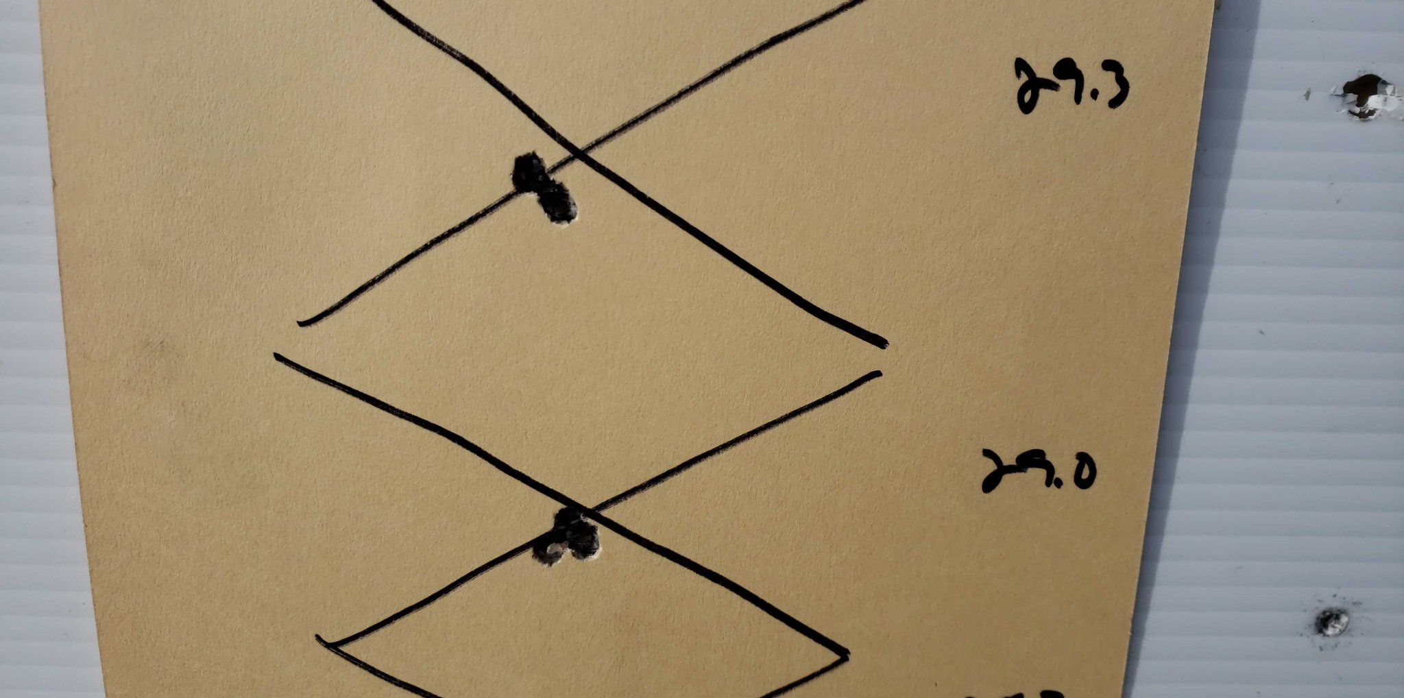

    I just loaded up another 55rd of the 130 AR Hybrids to test at distance with this barrel. 100, 200, 300, 500. Now if we can get a calm day around here. Blowing 25 with gusts up to 40 today. Hopefully tomorrow is calmer. Stay tuned
    Curious,if you’ve had a chance to get out and shoot this barrel anymore? Thanks for review

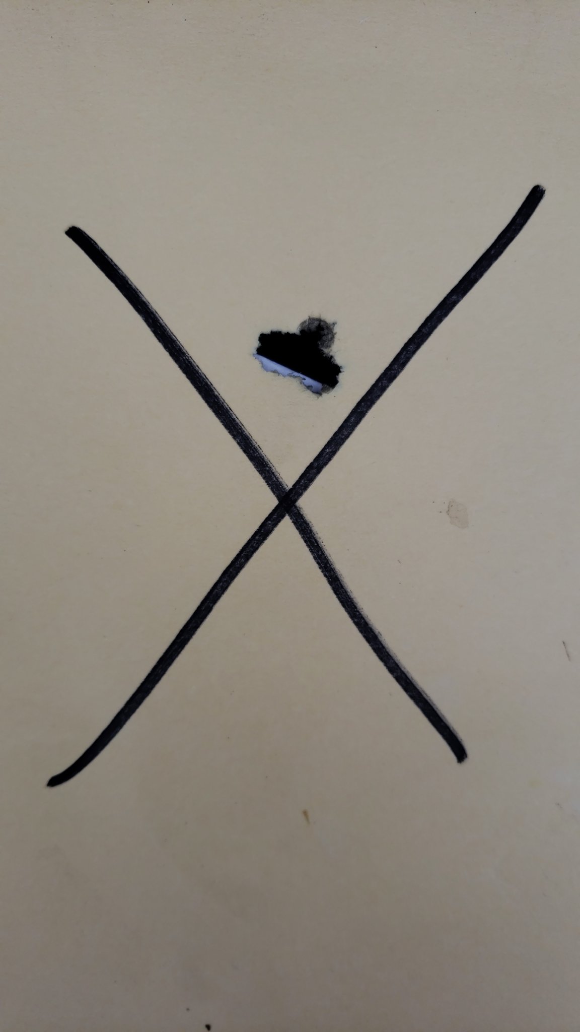

    I got out last week on a windy day and shot some half moa 5 shot groups with 130 Bergers at 300yds. I havent done any load development for it yet. Just shooting 130 Bergers over 41.1g H4350 to get some rounds down the barrel and its shooting nicely. Will work up a 140g load this week for it.

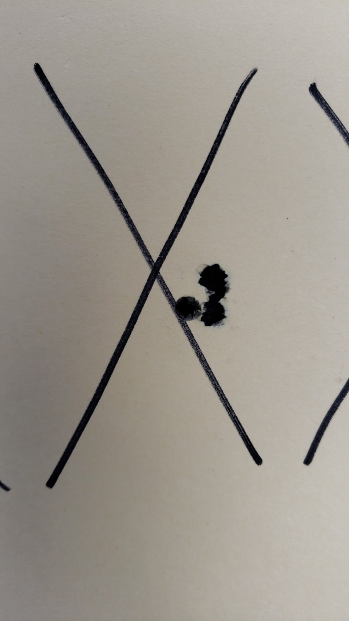

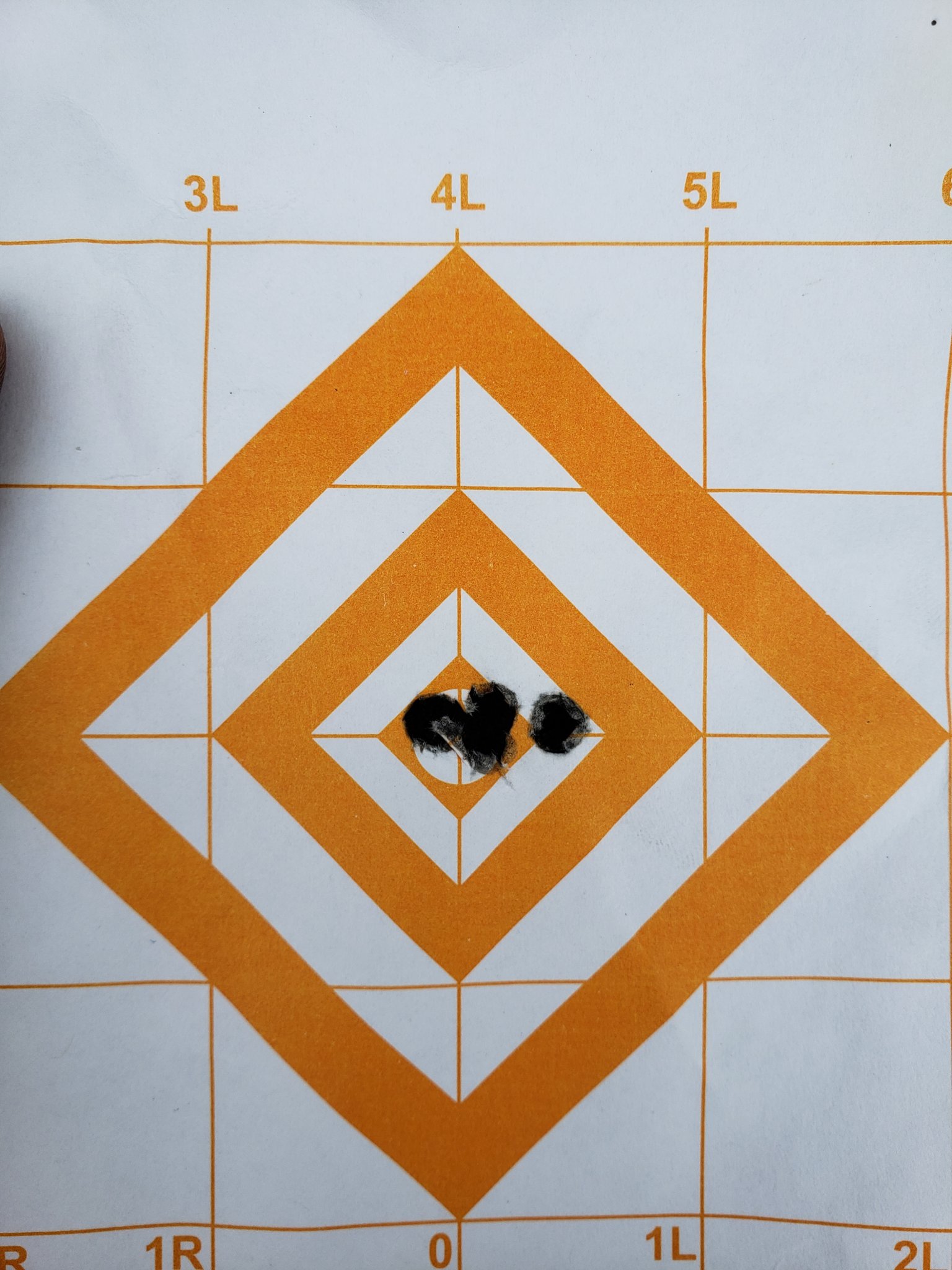

    Here are some 5 shot shot groups from load testing with a Keystone Krieger 6br yesterday. The last target was 5 shots from the 5 different charge weights. The lowest charge weight was out a bit right. The other 4 made a .2x moa group in the center. Definitely a forgiving round and an accurate barrel.

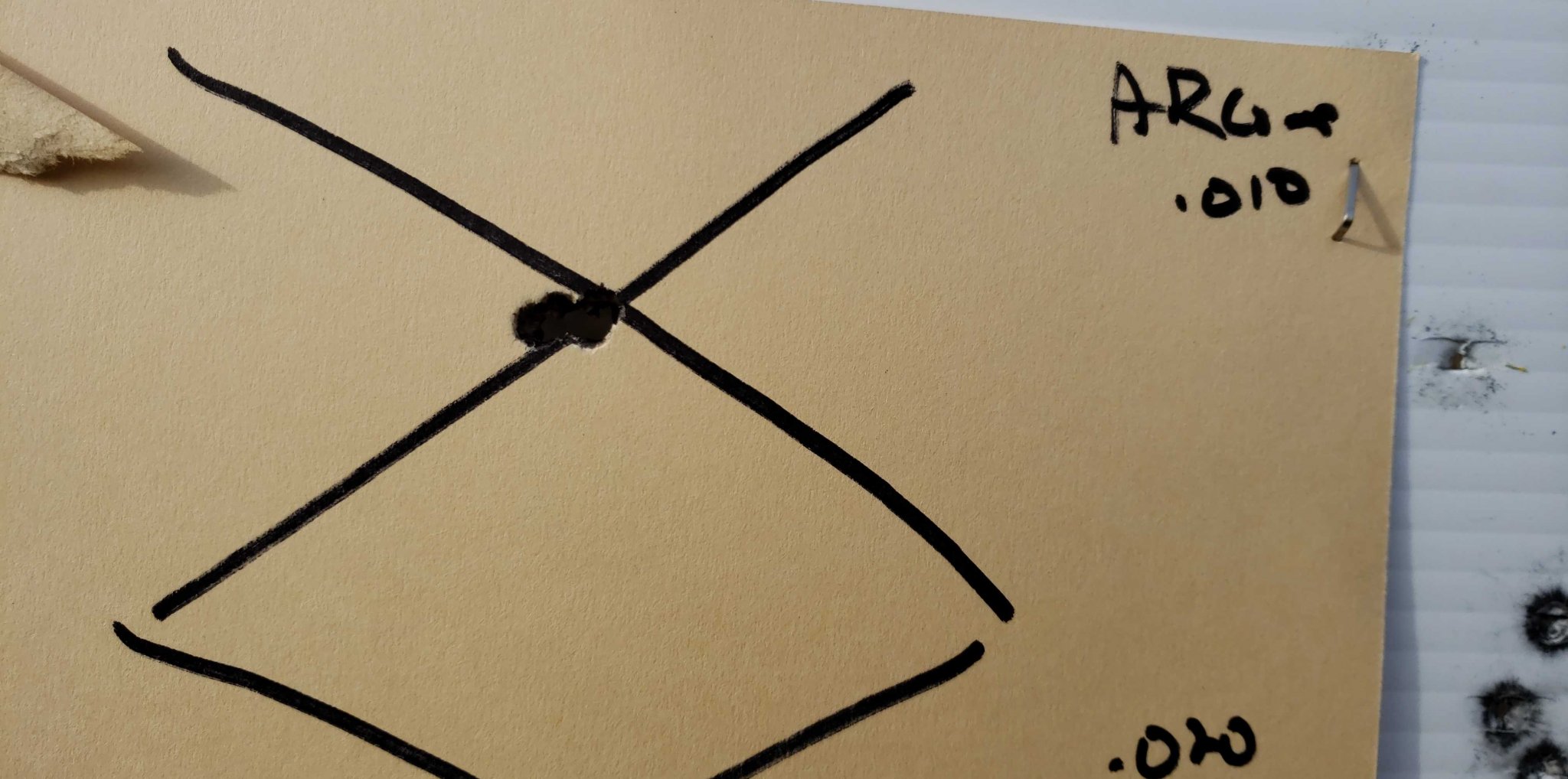

    Some 5 shot groups from today testing 8208 and double checking an AR Comp load with this 6br. I think I shot more groups that were bug holes than weren't.
