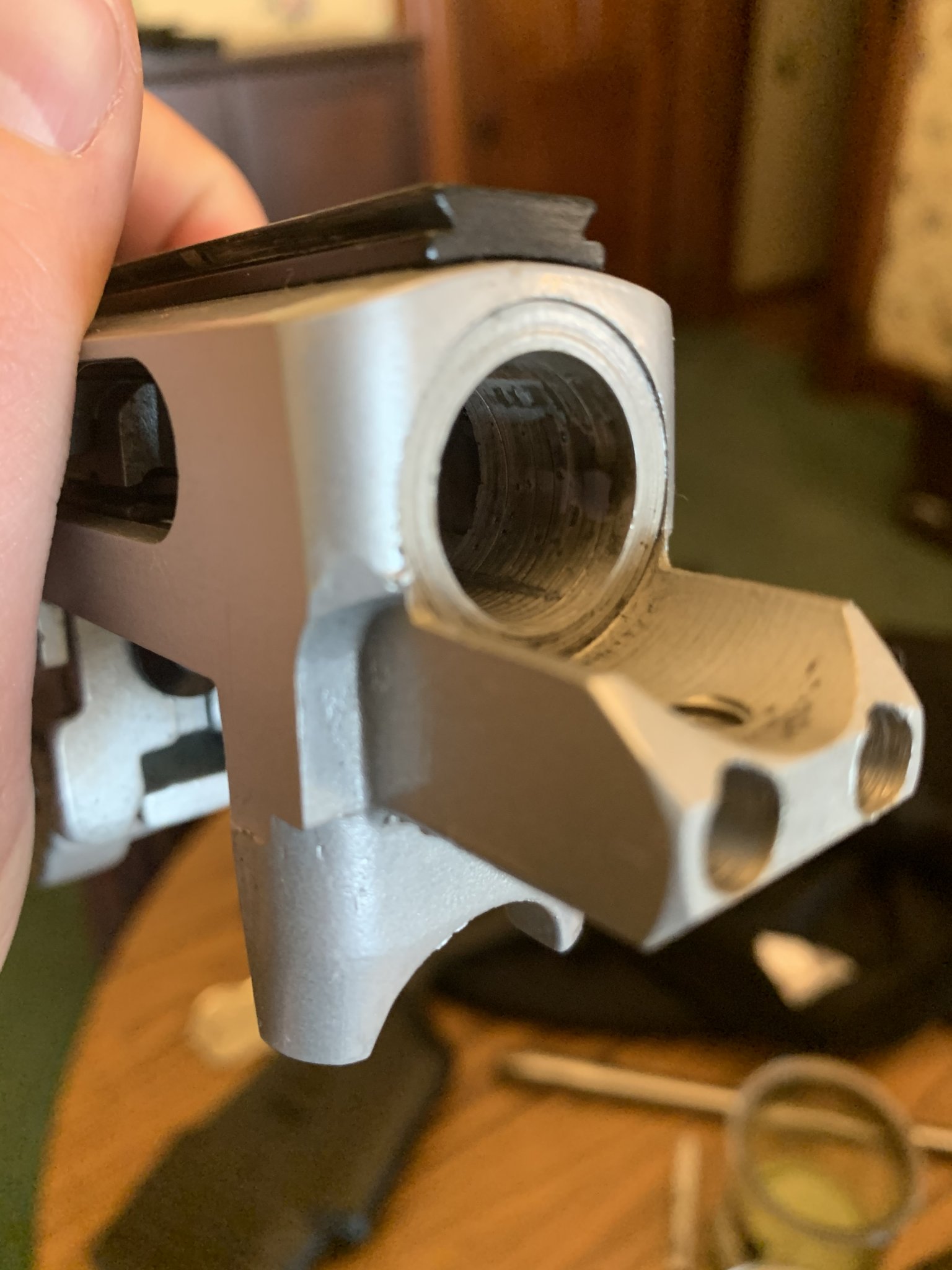

I’ve also read it says to remove the paint from the inside, this is not clean yet but I am not seeing much paint?
For prep, I removed all the paint off of the receiver-tenon interface surface and the barrel shoulder surface with scotchbrite. While you are at it, I’d recommend scotchbrite on the receiver’s inner grooves and bolt mating surface to remove the overspray.

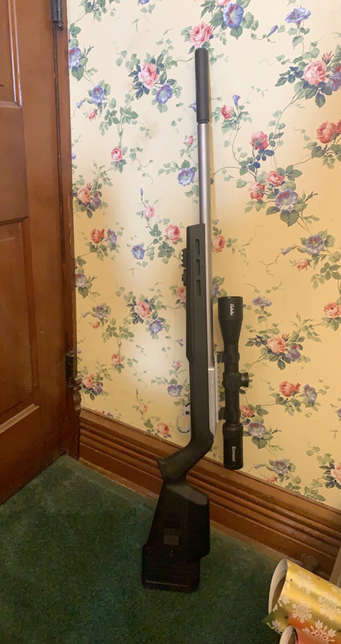

Just a little update, my barrel got delivered today of course while I was working a double.
it sat in my mailbox between the temperature of 25 and 35° for 13 hours. It was ice cold when I put hands on it so of course I had to take advantage of it. Threw a little bit of anti-seize on it and it slid right into my receiver. Easy enough, can’t wait to shoot!
