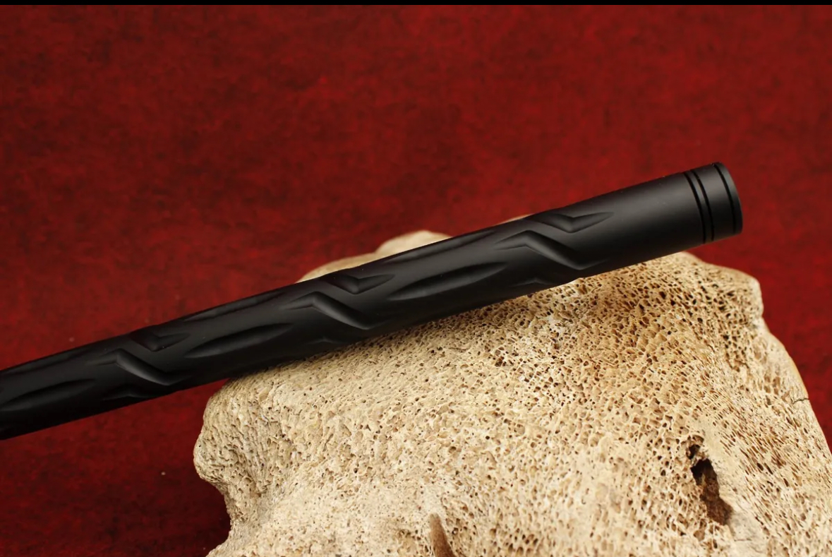

Recently bought a blemished Kidd barrel off of eBay. I’m shooting your basic of the mill Winchester ammo. I can’t get this thing to hold a group less than an inch at 50 yards. I have quite a bit of shooting experience with larger calibers but not a ton with precision 22lr. Could the ammo be causing this thing to shoot like crap? Hopefully it’s not the barrel as I’ve heard Kidd doesn’t put out a bad product even if it is blemished.

Assuming you installed the barrel in a stock Ruger receiver? Did it go in loose or really tight? V-block screws only need to be torqued to about 10 - 15 in/lb. If the barrel went in loosely, you can have barrel droop. Take down screw torque not too tight? Is the barrel free floated? Stock trigger? Ammo will definitely be an issue. A lot of variables can be attributed to large groups. KIDD blemished barrels are cosmetic issues not functional issues.
The barrel went in very tight. KIDD trigger and KIDD bolt. Torqued to spec.
