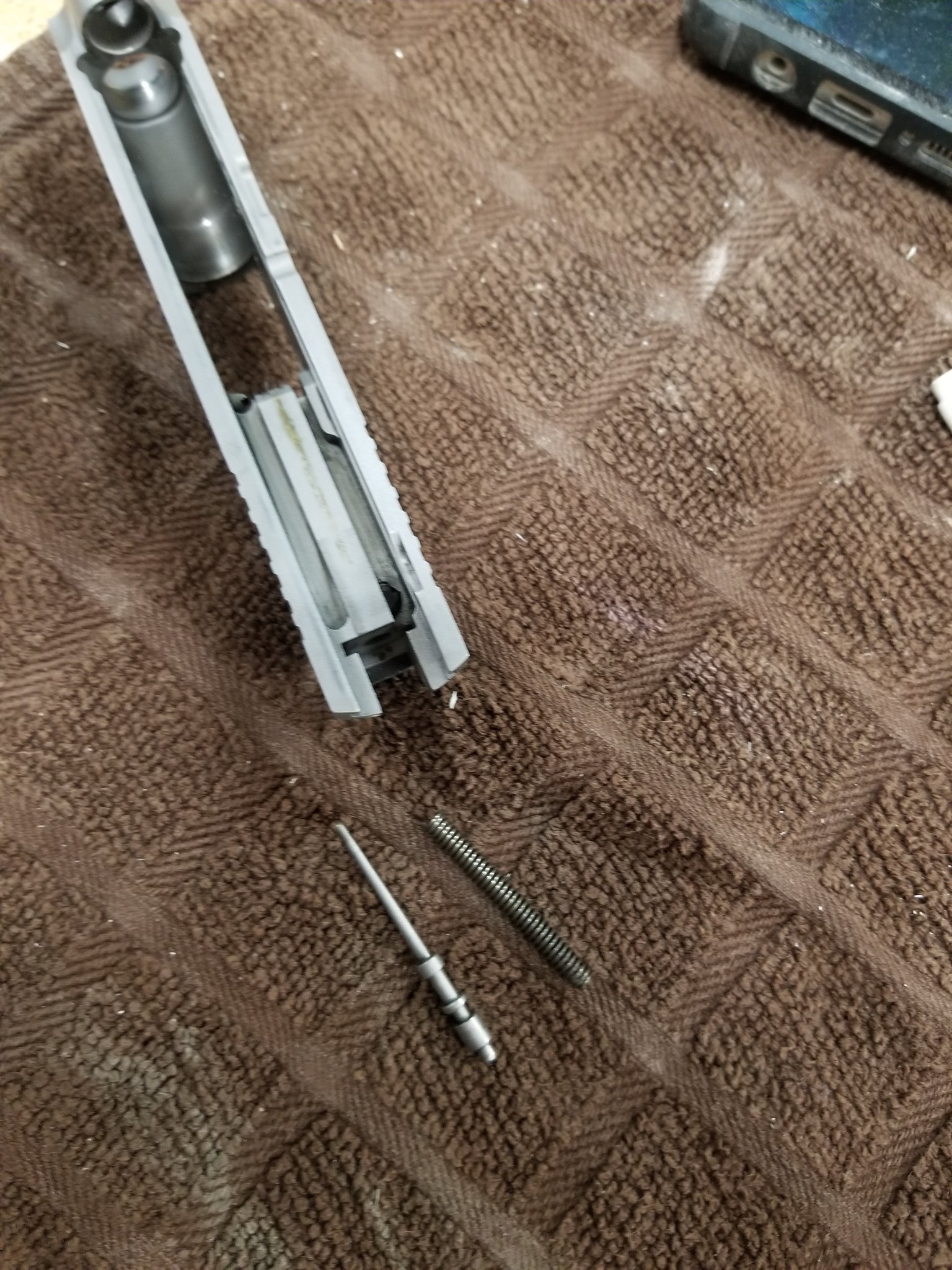

    I bought a kimber micro 9 a little over a year ago. When I first started using it I would get misfires or soft strikes and I asked the guys at the store I bought it from about it. I was told kimber wouldn't even look at it until I had 500 rnds through it. I currently have about a 1000 rounds through it and will still get soft strikes about every 7th or 8th shot. I'm hesitant to mail it off to kimber. Anybody else having this issue?

    I'm not familiar with the micro 9 but let's see if we can figure out what the problem might be.
    Does this design have a Firing Pin block built into the slide?
    -- Todd

    Maddybrook -- in the picture -- where are the other parts? It looks like there might be a Firing Pin block near the slot for the Firing Pin Stop.
    Also, it looks like the tip of the Firing Pin might be broken or buggered up. Could you take another picture of the Firing Pin?

    I think that is grease? I don't see a plunger there for the firing pin block.

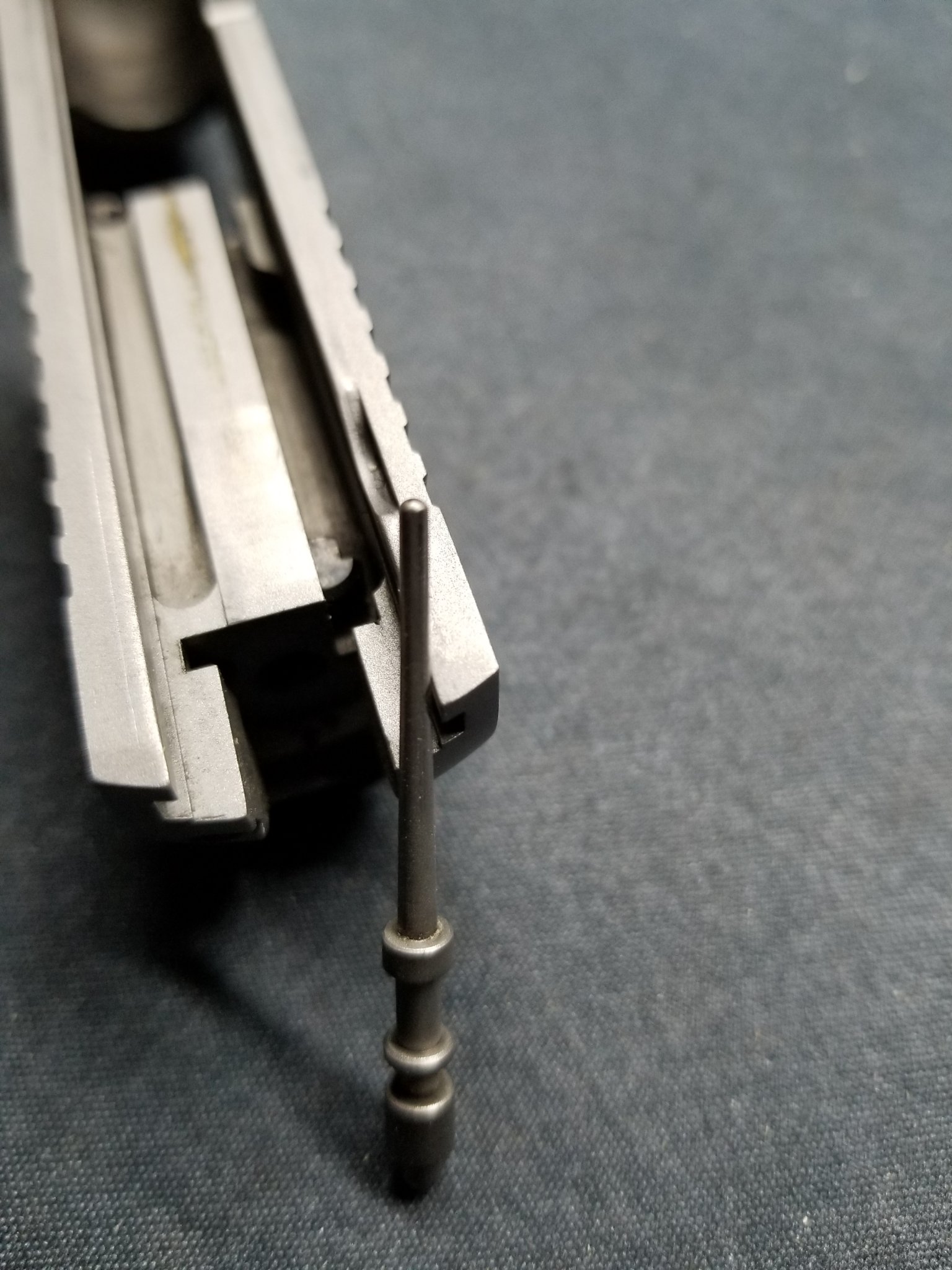

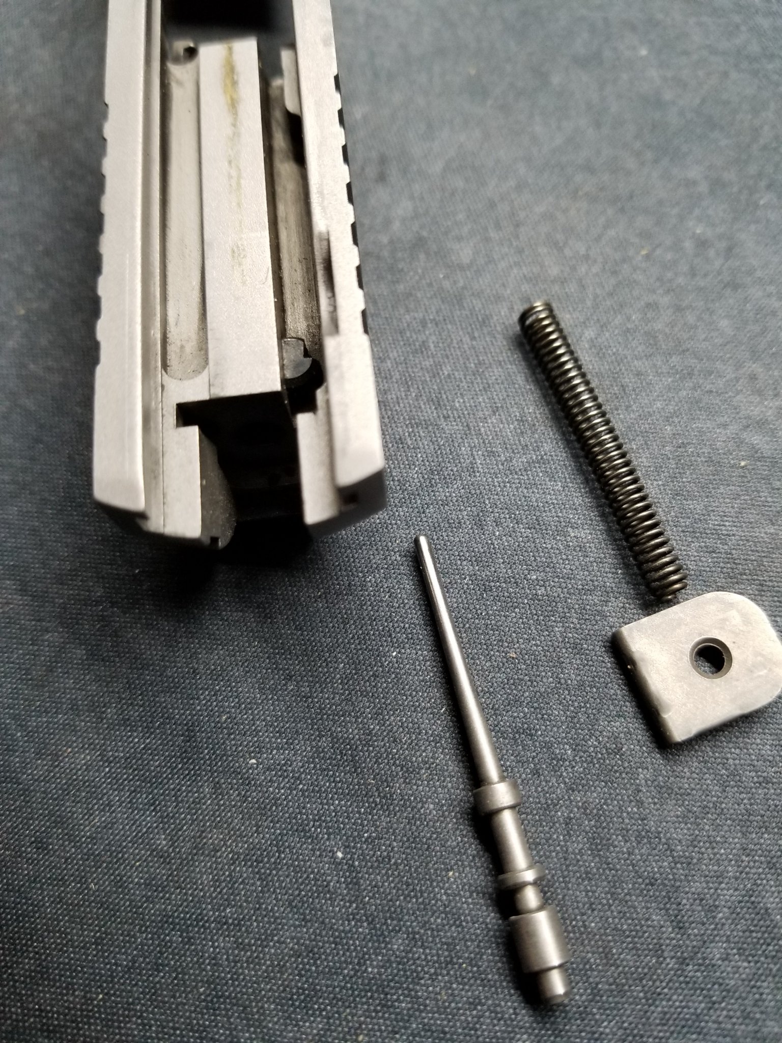

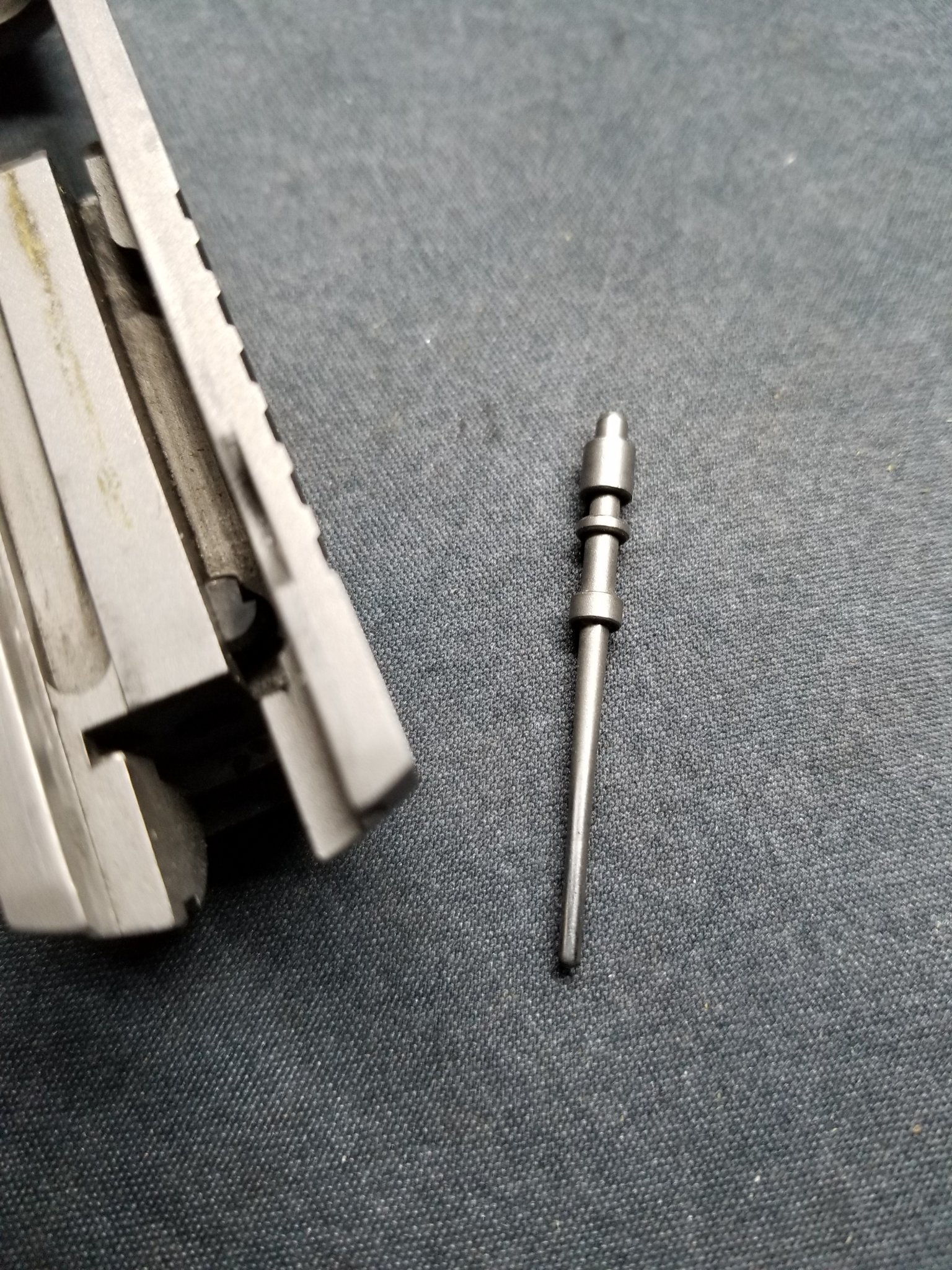

    I really appreciate all your help!

    Thanks for the excellent pics. The Firing Pin looks okay now. Did it have the rounded shape on the tip before you polished the Firing Pin?
    I would take a close look at the Firing Pin Block mechanism. Maybe even consider removing the Block. My guess is this is where the problem is. In this design, what moves the Firing Pin Block?
    I would take a close look at the Firing Pin Block mechanism. Maybe even consider removing the Block. My guess is this is where the problem is. In this design, is it the grip safety that moves the Firing Pin Block?
    Yeah, it had that rounded tip. I have a tormek with a low speed leather wheel that I used to polish the firing pin.
    If I'm understanding you correctly this model does not have a grip safety, just a thumb safety.
    I think I'm going to take it to the range before I disassemble it any further because I believe I have to remove the rear sight to pull the firing pin block.
    Fingers crossed!
    Thank you so much for your help, you seem very knowledgeable and I appreciate your input.
    LOL, I'm a recovering 1911 addict. I have a good idea of the operation of the 191q design.
    I think your right about having to remove the rear sight to get to the Firing Pin Block.
    Good luck!
    -- Todd

    Hey man, I finally had a chance to take that micro 9 out to the range today and was able to put 100 rounds through it without any soft strikes. Seems like it may be good to go with the tip polishing! Thanks again for all your help a couple weeks ago
