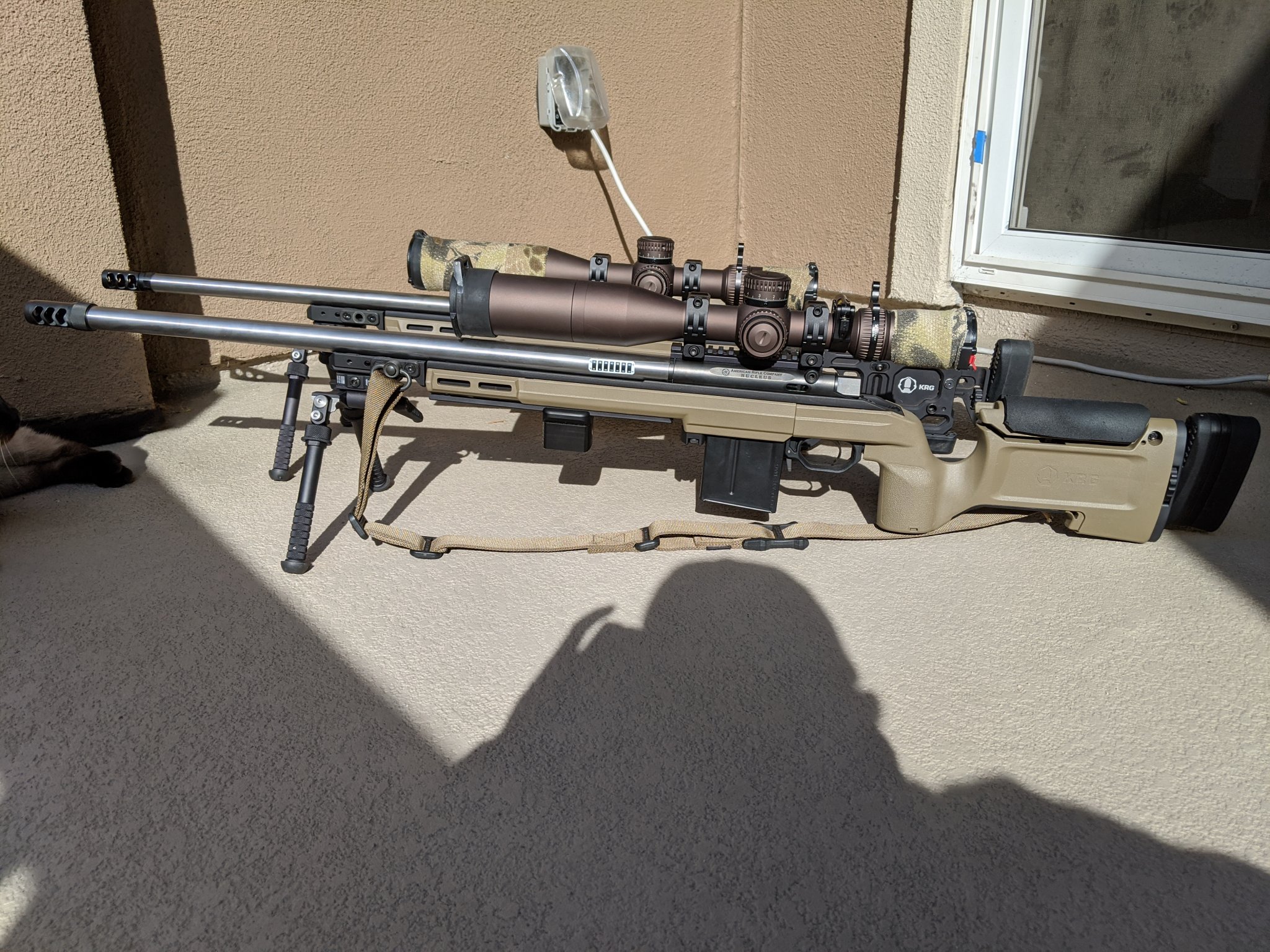

KRG Bravo ?

@SonicBurlap no weight kit. Just a KRG ARCA clamp with the polymer barrier stop block. As it stands that rifle weighs 18lbs. That Vortex Razor 3-18x50mm is a tank. Almost 3lbs and only a few ounce lighter than the Razor 4.5-27x56mm.
Familiar with the concept, somehow I always end up with right around 17-18lbs. that's why the next one is going to get a carbon fiber barrel just for kicks.
