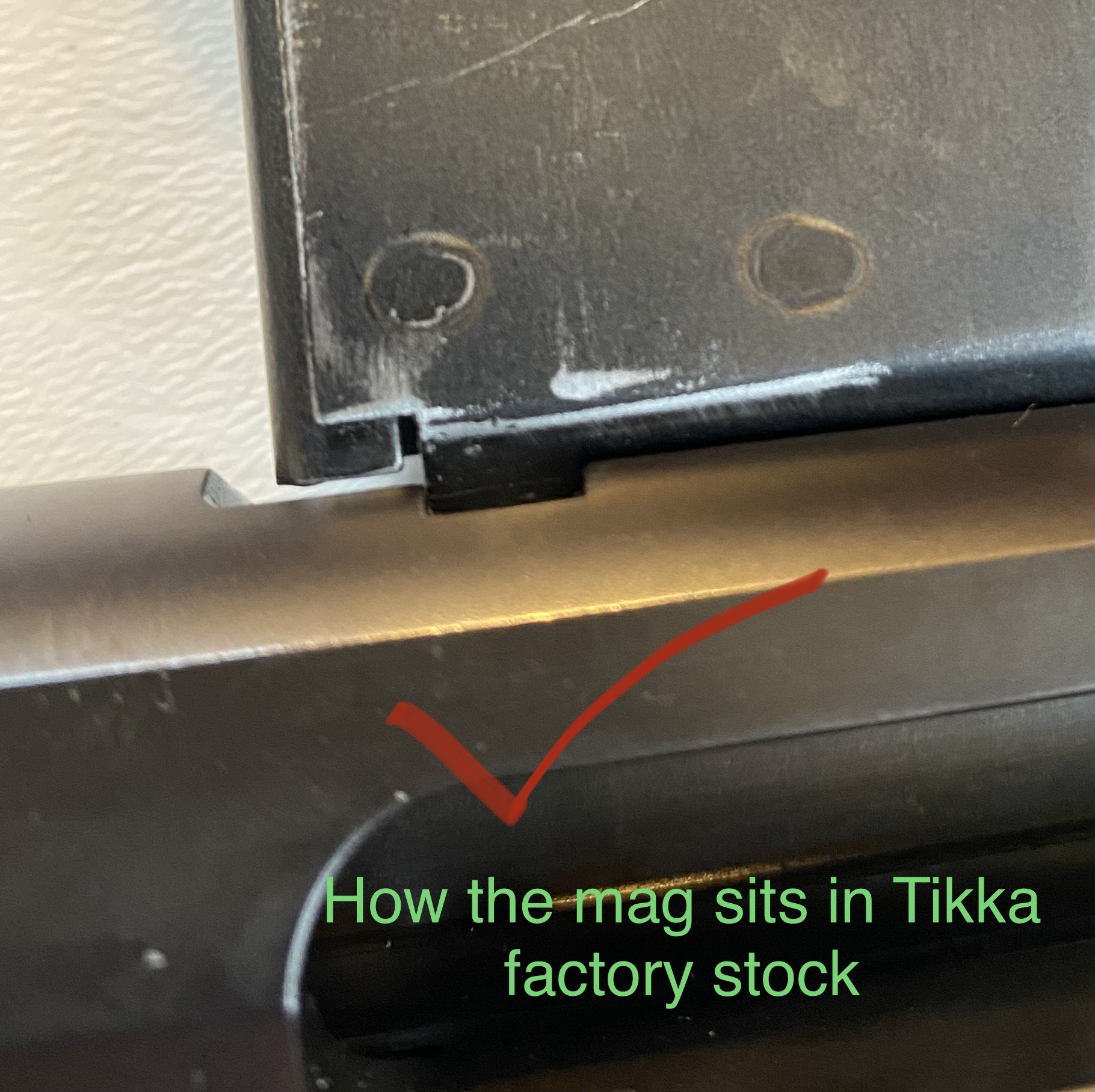

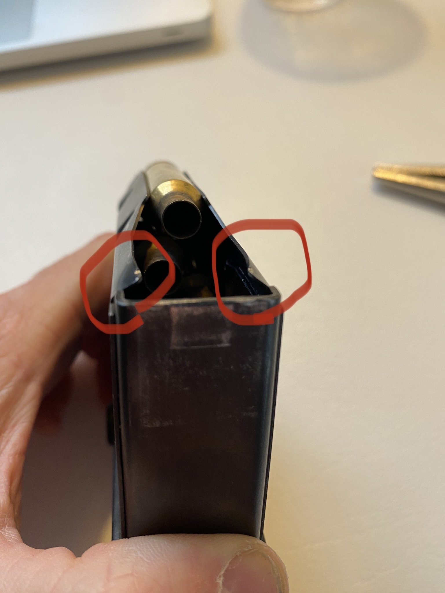

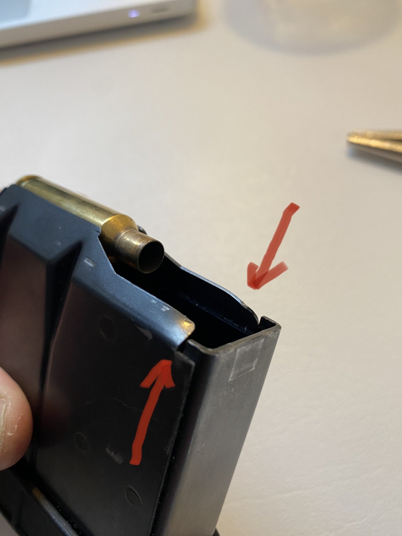

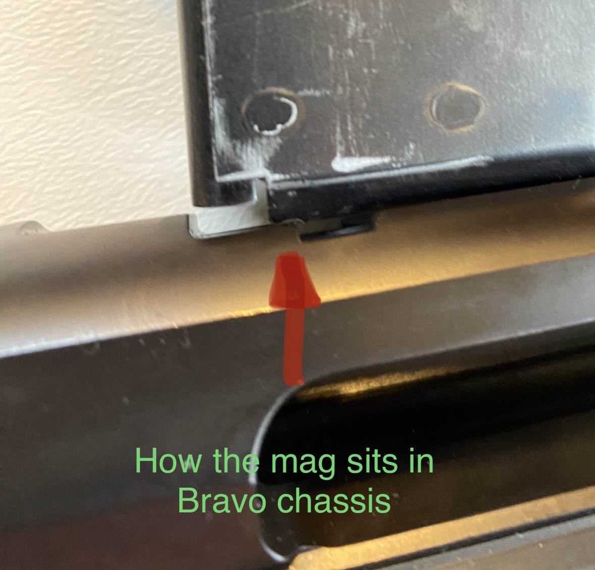

Tikka in KRG Bravo w/ CTR mag inlet. I have been having issues with my CTR mag popping loose under recoil. Seems like a common issue for several reasons...but after spending a few hours this afternoon fooling with the gun, I realized that the feed lips on the mag were bent and marred up. I realized the mag was riding way too far forward in relation to the receiver. I tried adjusting the hand guard and trigger all the way back, but the mag still will not sit in its proper place. The pictures can describe this much better than I. I haven't found any other folks having this issue.

The stock doesn’t allow the CTR mag to sit in the receiver properly.
I will let them know. I have been pretty gentle on inserting my mags because I could see and feel it contact. My feed lips aren’t bending yet, but you can easily see where they’re hitting the receiver and the finish has worn off. I haven’t shot this setup yet. It’s new to me, just swapped over, so no idea if the mag may pop out under recoil yet. It seems to be in there pretty good. Worst part is I just sold my new Manners EH-1 with CTR mini chassis in favour of the Bravo before I knew of this problem. I wanted the NV bridge of the Bravo.
My best guess is you got the wrong mag catch installed, or it needs to be adjusted or trimmed to get it to fit better.
I have the AICS mag catch now because I swapped. I def was running the CTR mag catch. Also I adjusted the trigger guard and hand guard as far back as possible and the mag was still sitting WAY too far forward in relation to the receiver.
I would go ahead and contact them ASAP, that way you might be able to make a return/exchange. I had to buy a AICS Bravo backbone, mag catch, and handguard. An easy, albeit expensive fix. I kept my buttstock. If you can I'd try to return the stock and swap it for the AICS version. It runs just fine. Not quite as smooth as the CTR mag in the Tikka factory stock...but at least the mag isn't falling out every 3rd shot and not getting bent.
