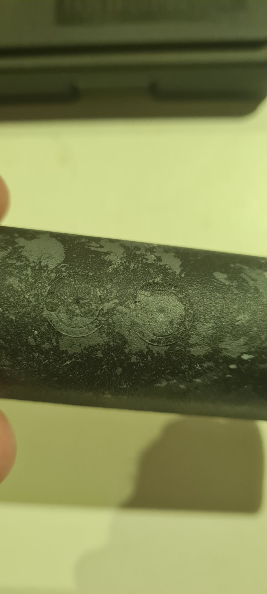

    Ive had my KRG Bravo for a year and a half and the other day I noticed the 2 posts on the adjustable cheek piece are loose. They both turn but I cant get them to tighten up.
    Ive noticed theres 2 little plastic caps on top of the cheek piece which might have something inside to tighten up the posts? They look pretty hard to remove, hopefully someone here has done it or knows how to remove them.
    Have attached picture of top caps.
    Any suggestions or information greatly appreciated, im not sure if there is any KRG reps on this site? If so hopefully they chime in.
    Cheers
    PS. Absolutely love the Bravo, im not bashing it in any way, I just want to be able to tighten up my cheek posts.
    Those marks are caps. Below them are two hex screws you need to tighten them up. The easiest way to remove them is to loosen the posts more and use the bolt inside to push the caps out. My Bravo for my Tikka came with two different cheek rests and I swapped them out to the one with a notch cut all the way through for the bolt.

    Thank you, ill give that a try today
    That worked an absolute charm, thanks very much for your time and information.
