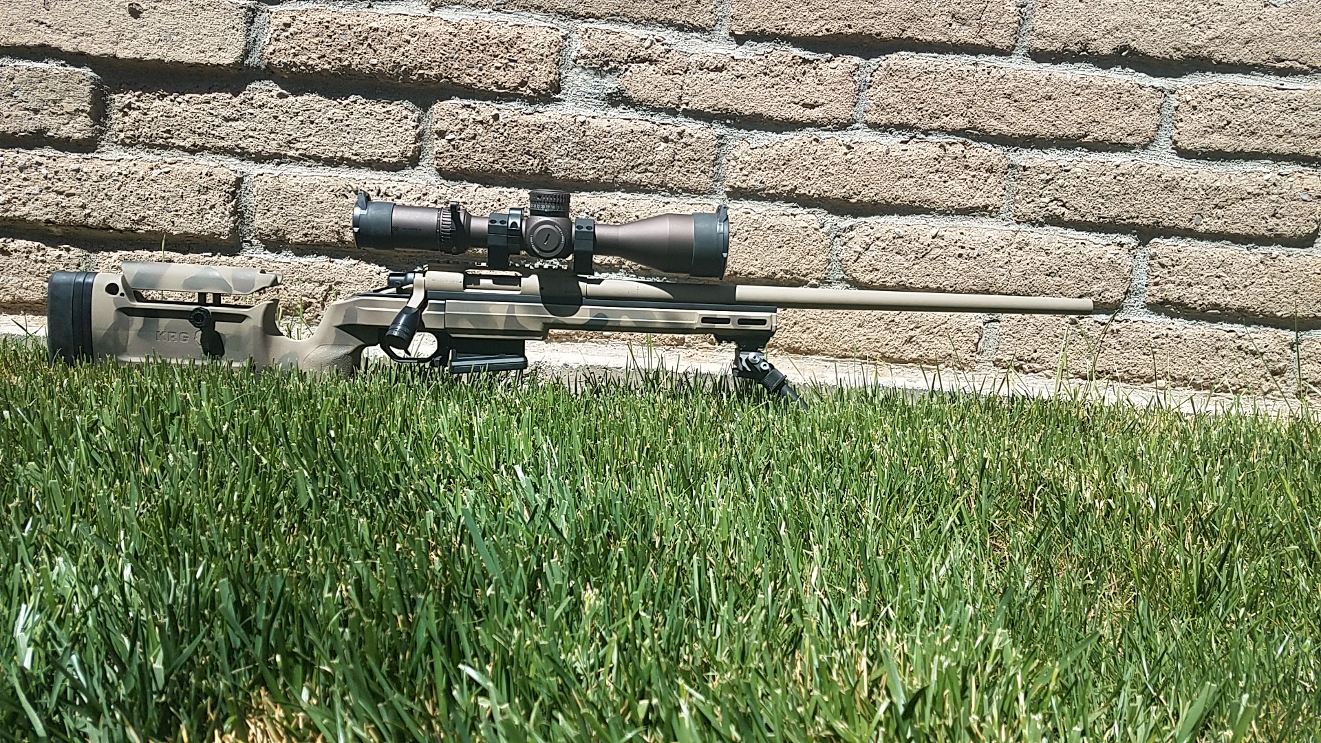

    Only issue i had with a KRG Bravo and a remage setup was the recoil lug, not the barrel nut. The KRG Bravo didn't like a straight-sided recoil lug...it wanted the tapered lug. If thats standard on your Rem700, then you should be fine.
    Here's my remage with a bravo
