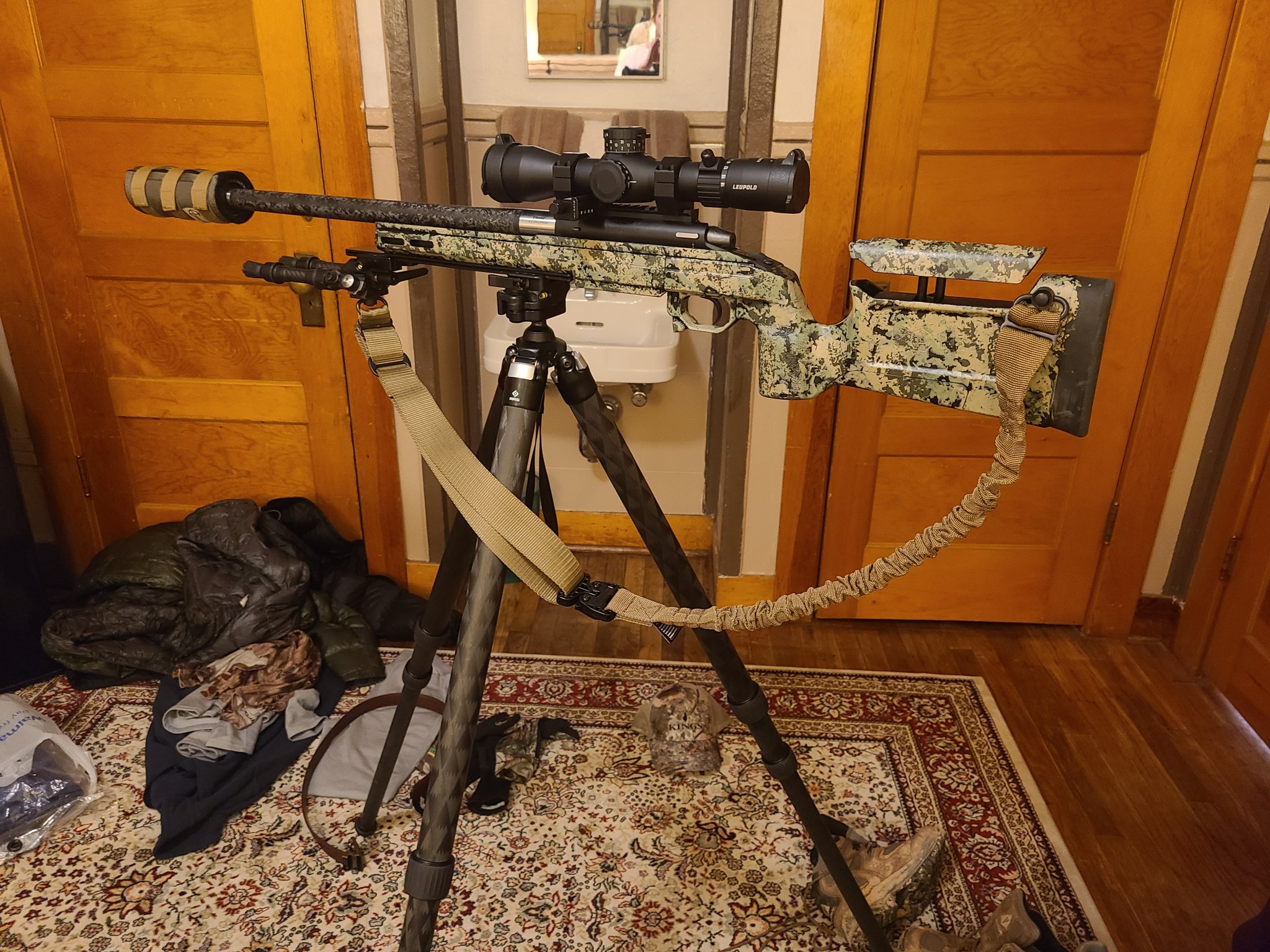

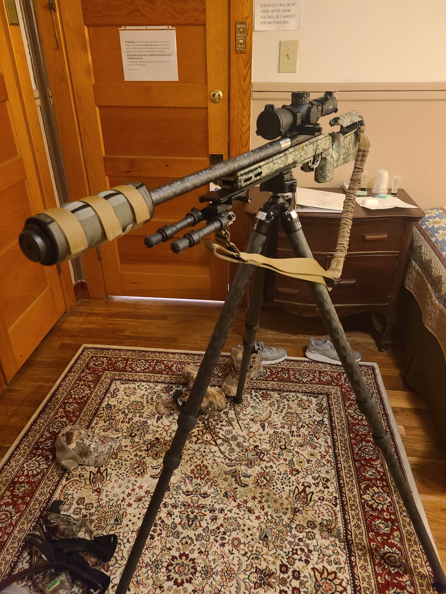

Here's a few pics of my XRS hunting rig. It's a trued Rem 700 action with a Krieger barrel chambered in .270WSM. I installed the MDT Arca rail that's made for the XRS and I'm really happy with the whole set up.
Reactions: rbs7500 and Stoweit

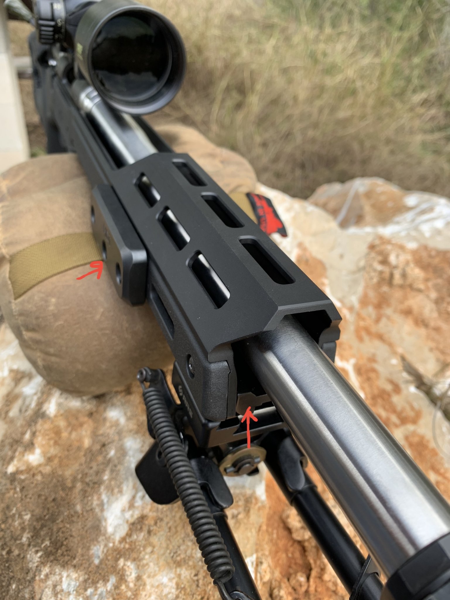

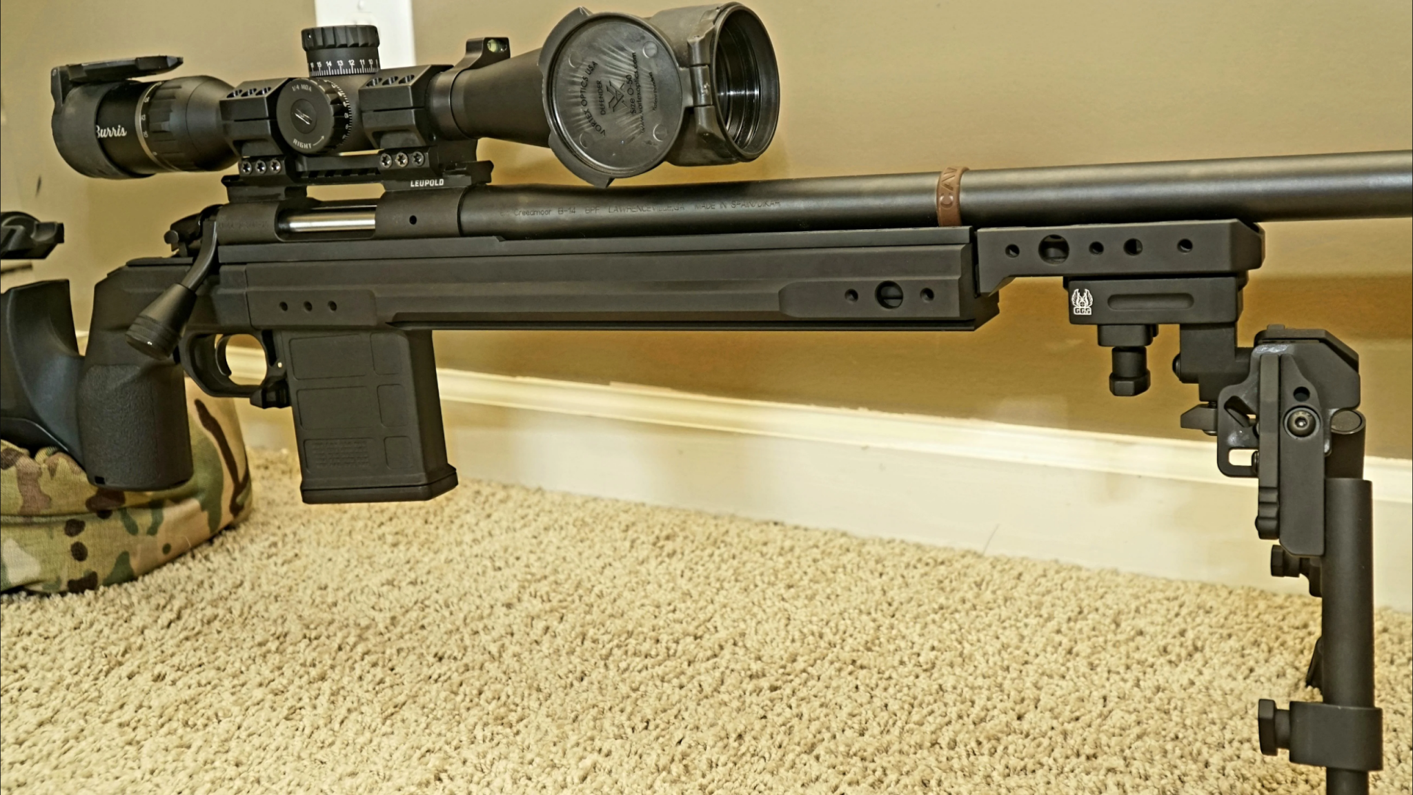

My Bravo with the adjustable height/cant buttpad, aluminum arca forend, t-slot weight, and spigot. Costs more than the base $349 but it shot well without all the attachments. I love the modularity of the KRG system. The balance with my Bergara B-14 24" barreled action is perfect.

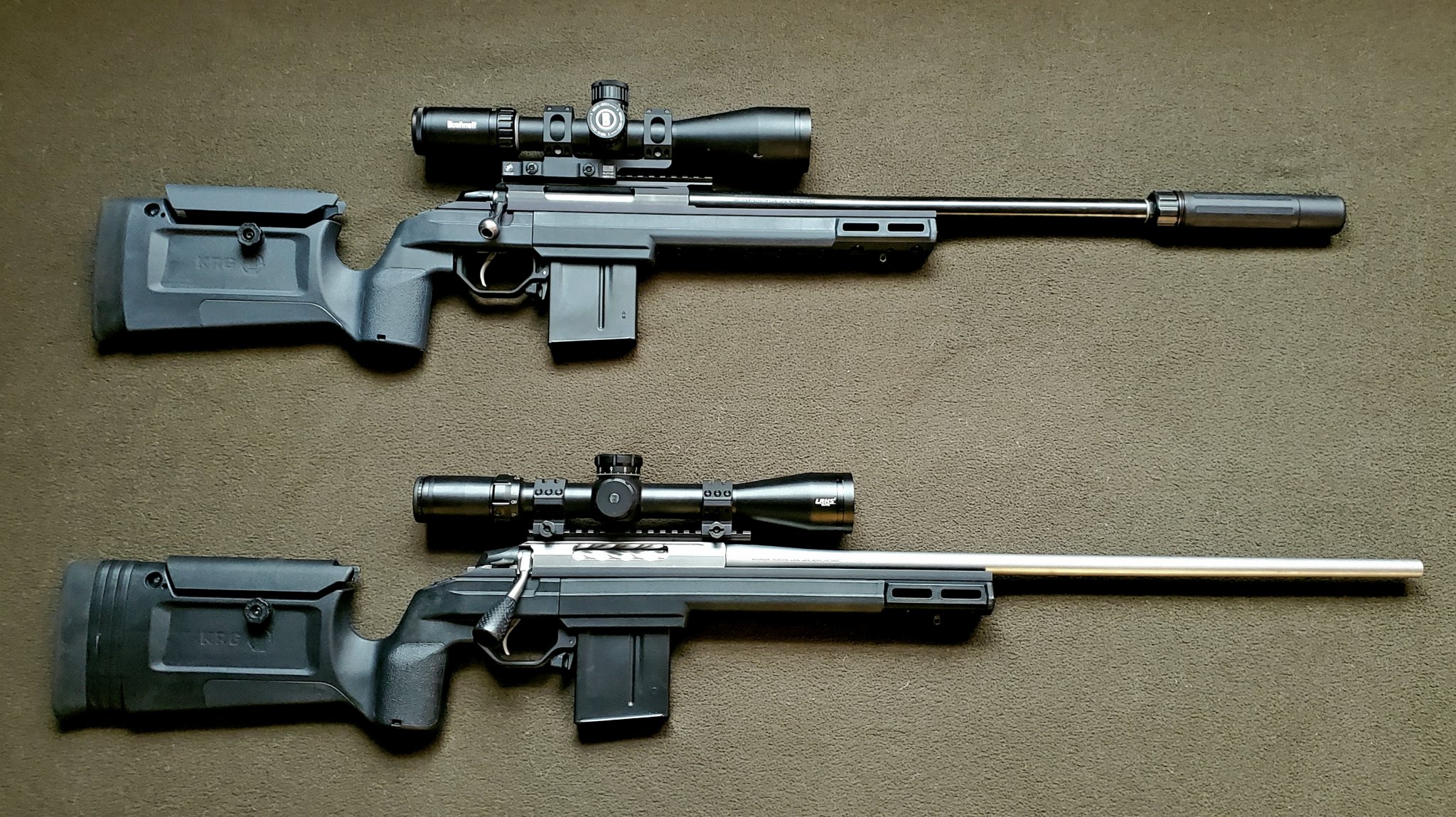

It's good to read this as going off photos I thought the XRS looked a little more solid.
I also love the look or the enclosed forend on the Bravo but I don't know much about the function of it. Is it necessary and does it give the Beavo a huge advantage?
I really like both, I think I'm leaning a little more towards the XRS.
Thanks for all the info!
The enclosed forend sure looks cool! However, no it doesn't really add much more function to be honest. I bought it for looks, then transferred it to my Whiskey 3, again, for looks lol. It made the bravo a bit front-heavy.
Which brings me to another point.
The XRS forend is integrated into the chassis, and is all aluminum where the bipod attaches too. If i recall correctly (and someone correct me if I'm wrong) the only way to attach a bipod to the Bravo from the factory, is to attach it to the polymer skin that covers the aluminum chassis. So the bipod is not directly attached to the metal body itself, but rather just the plastic skin that is screwed onto the body.
That being said, the KRG spigot mount can be directly screwed to the aluminum chassis through the hole in the front between the polymer skin, and the metal backbone. Then you can attach the bipod to the spigot mount, and you achieve a metal on metal attachment. I personally preferred the idea of my bipod attaching to something more solid than the polymer skin, so I bought the spigot mount.
Is there a performance or durability difference? No clue, likely no. It was more of a personal thing, and I doubt it is any more/less secure. But if it bothers you, then I'd get the spigot mount, or the enclosed forend which does the same job. However at that point, the price gets closer to the XRS.
Again, both choices are great, and I'm glad we have so many options these days! I lean towards the XRS personally, but wouldn't hesitate to buy a Bravo, especially at the lower price.
