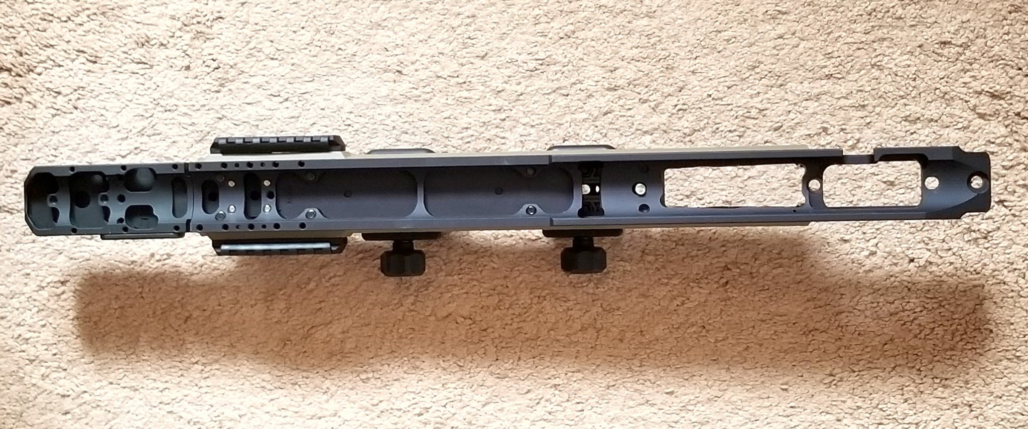

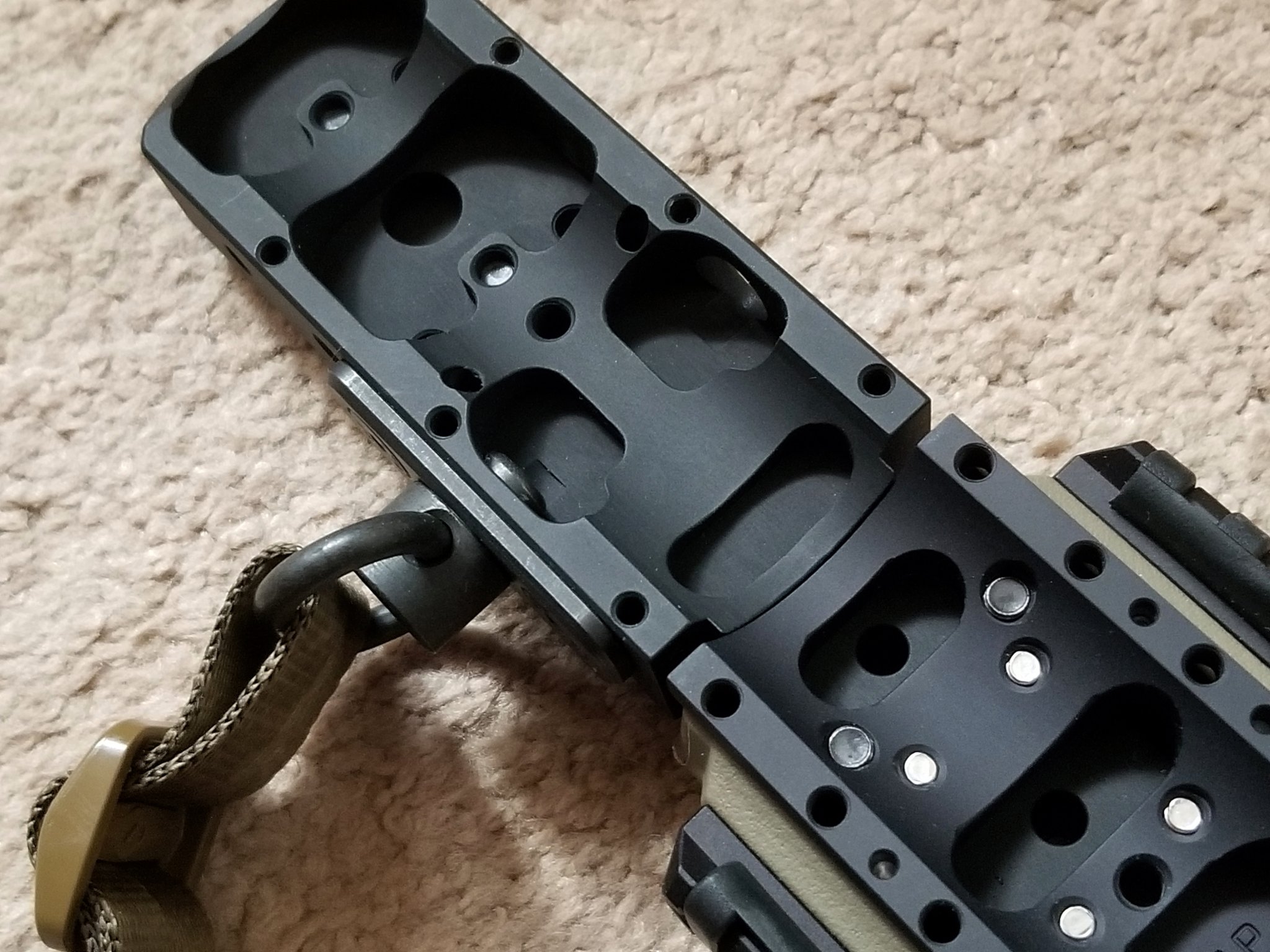

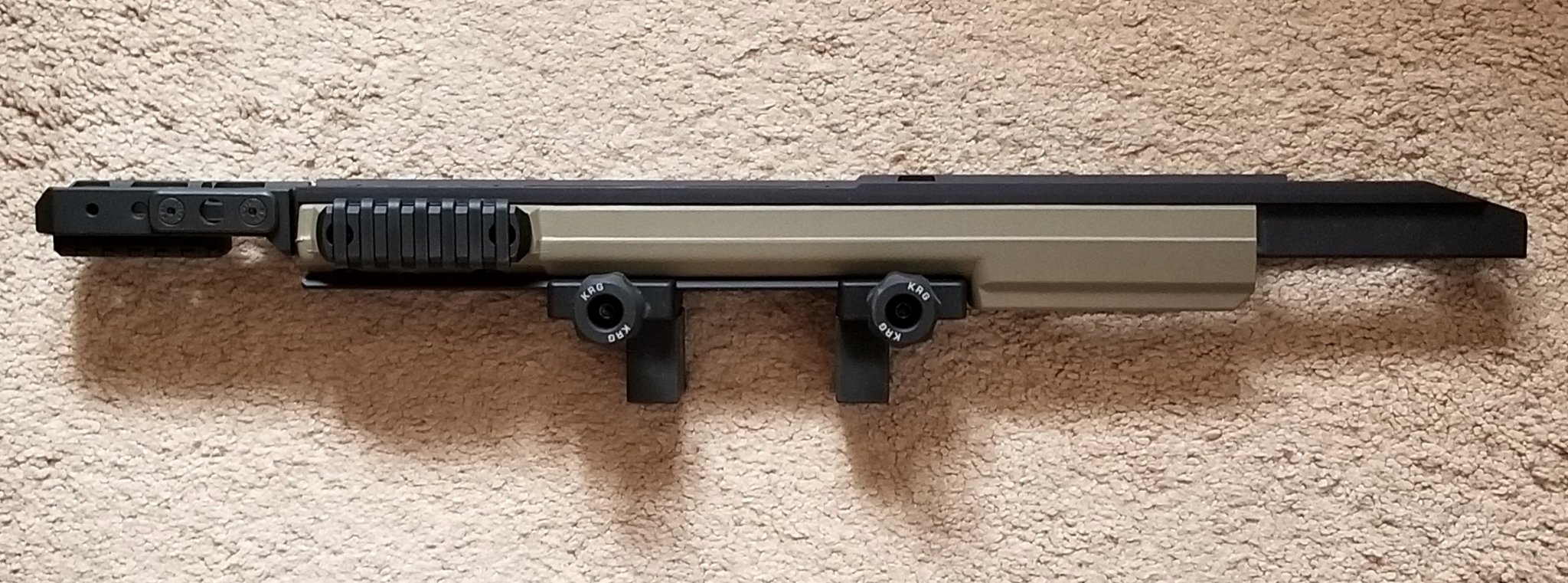

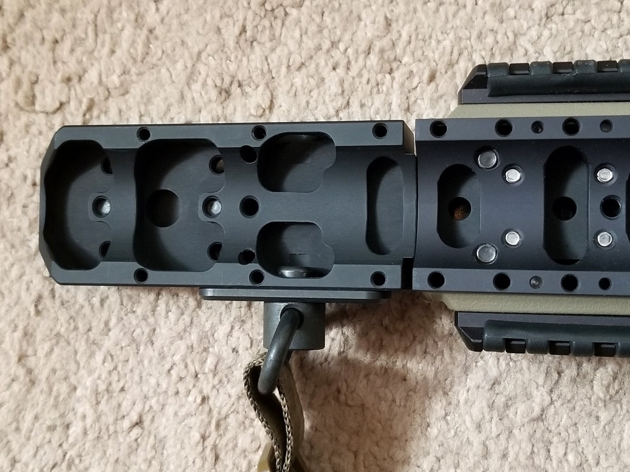

Waiting for the action and PROOF CF barrel on this one so I figured I'd show what the backbone with the spigot mount with Pic rail and QD plate attached looks like without the barreled action. This thing is rock solid. I've got the ARCA rail and the heavy T-slot weight on the forend, there is not even the fleeting thought of flex that some had claimed they could perceive in a Bravo.

Now i see why the spigot mount is so expensive. That is a nicely made piece. Looks strong as hell.
It's a CNC crafted, functional piece of art. I've got the polymer ladder rail covers on my aluminum pic rails to keep them from getting dinged when I don't have what's supposed to go on them mounted.
I'm also using two of the ARCA clamps with heavy barricade stops so I can either use just one as a regular barricade stop and for better weight distribution, or I can use both for a fence, or a rope and essentially clamp the fence, or rope like in a vise to get a more stable platform. Where was all this when I was still in the service?

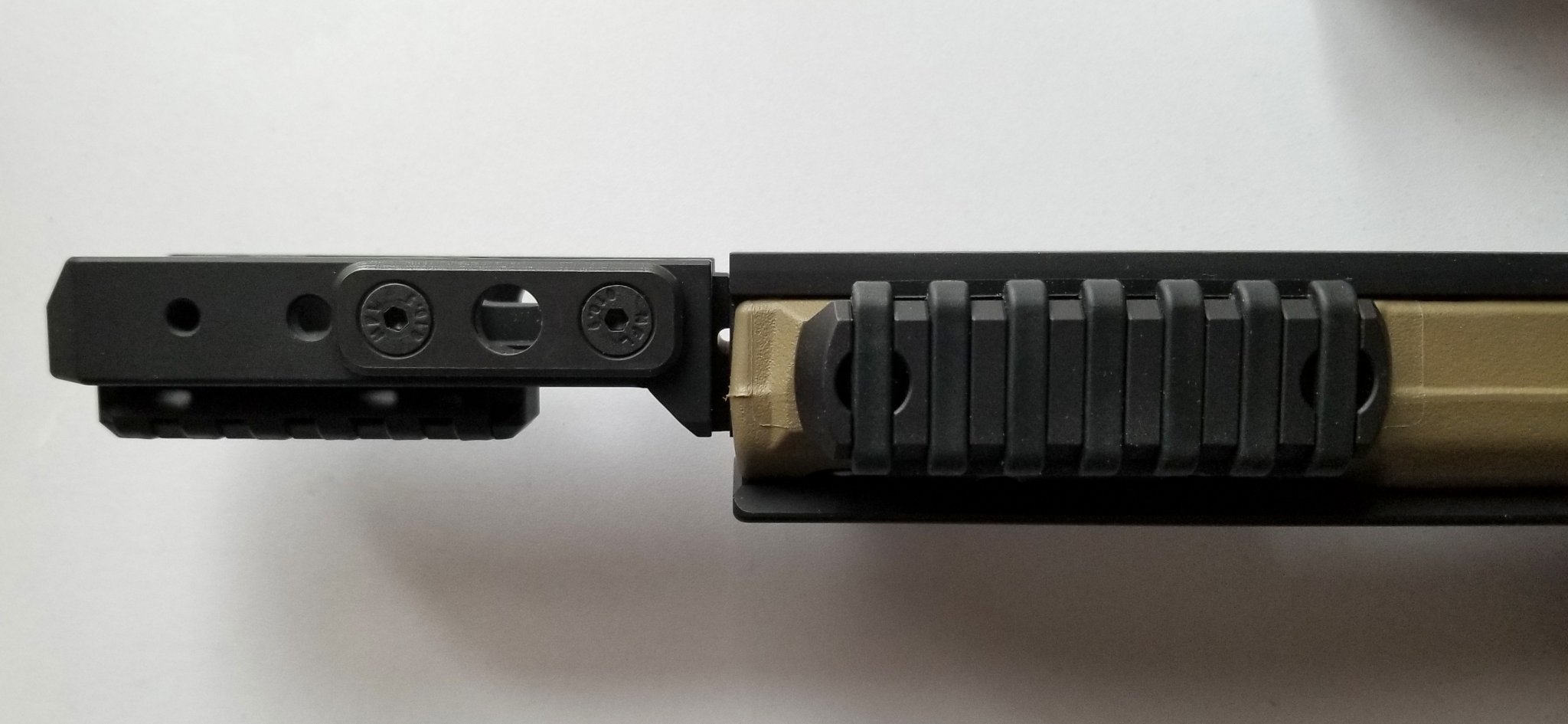

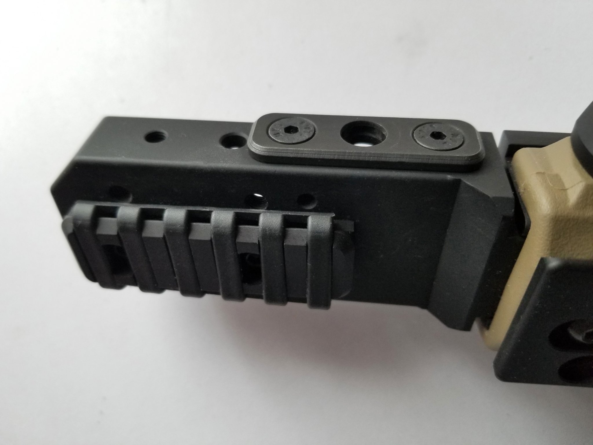

Below is a pic of the rail with both ARCA clamps mounted on just the backbone and forend.
