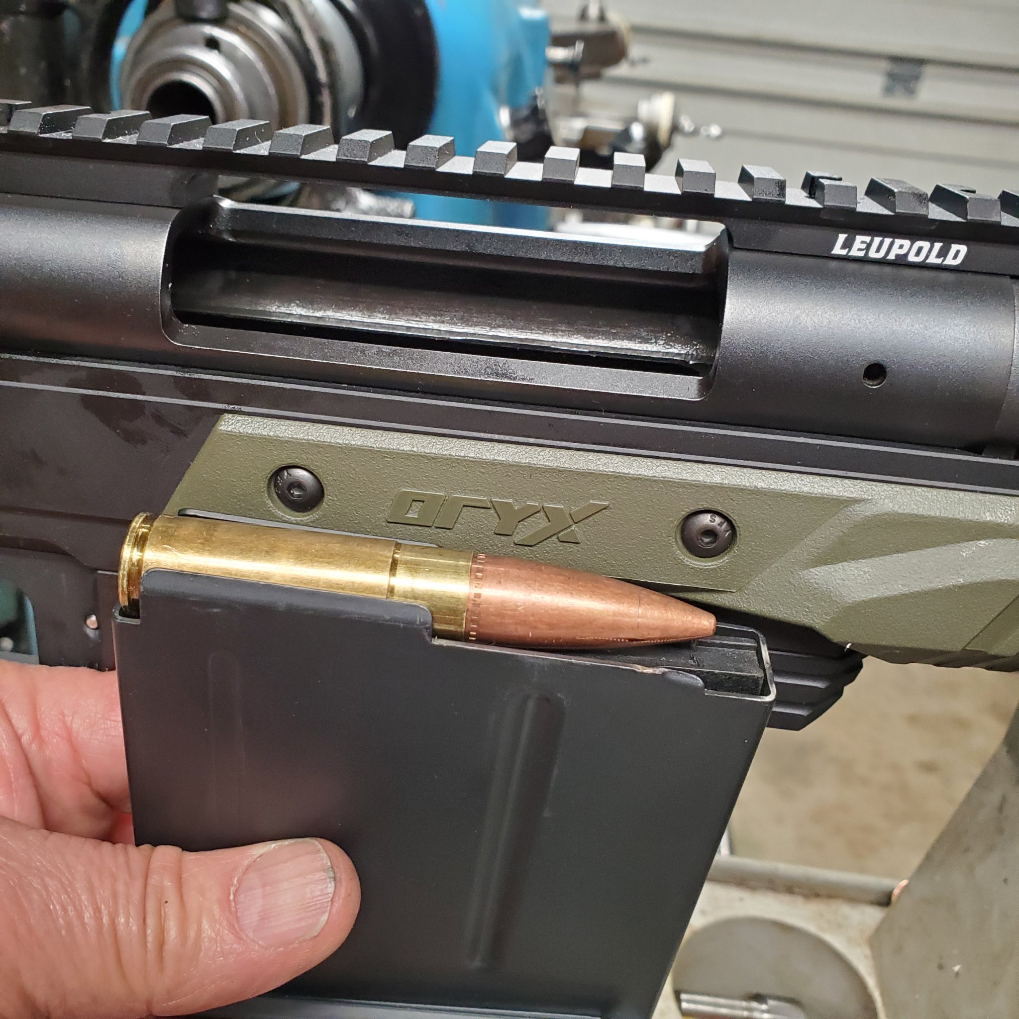

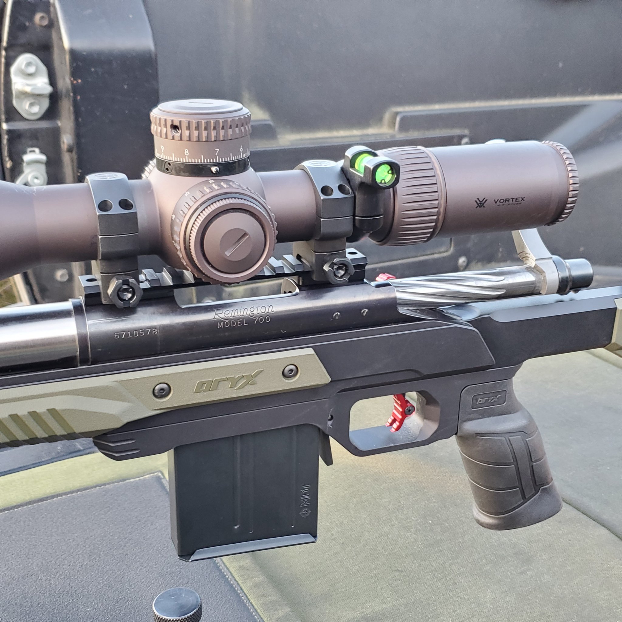

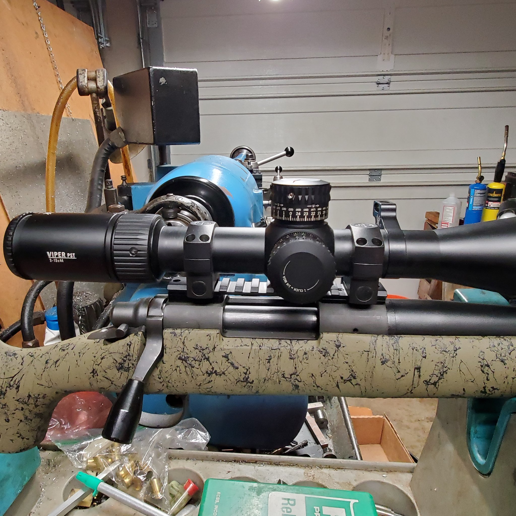

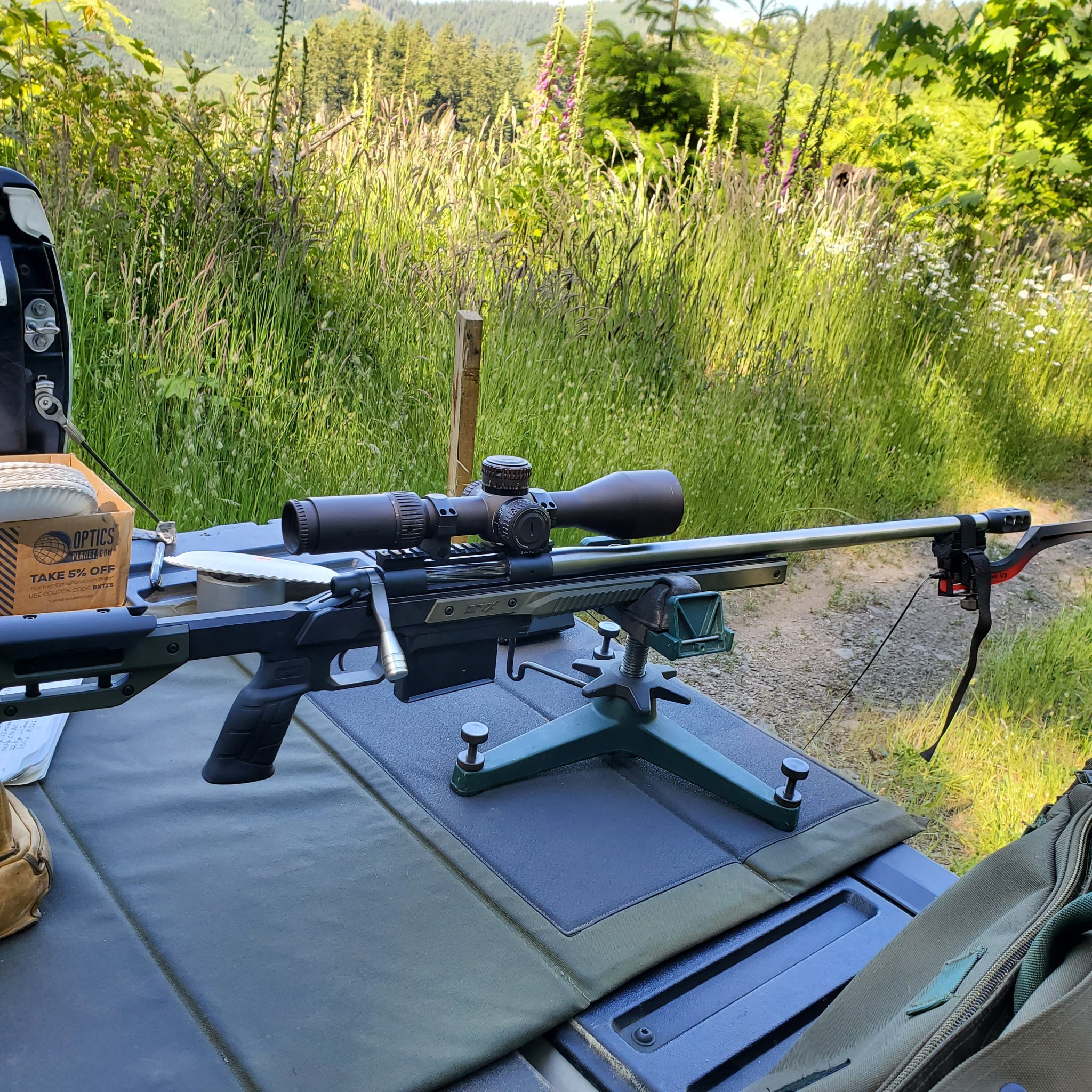

I use alot of Oryx chassis, from 6 Dasher, 8.6 Blackout, 300 WM, to 510 Whisper, because they work for me and are reasonably priced....they are easier to shoot small groups, for prone, or in the blind shooting. They are a bit heavier.
But perfect for your application.
If walking and stalking I would go to conventional rifle stock as the one pictured for jump shooting inside 100 yds, with a low power variable...incase a longer shot presents itself.

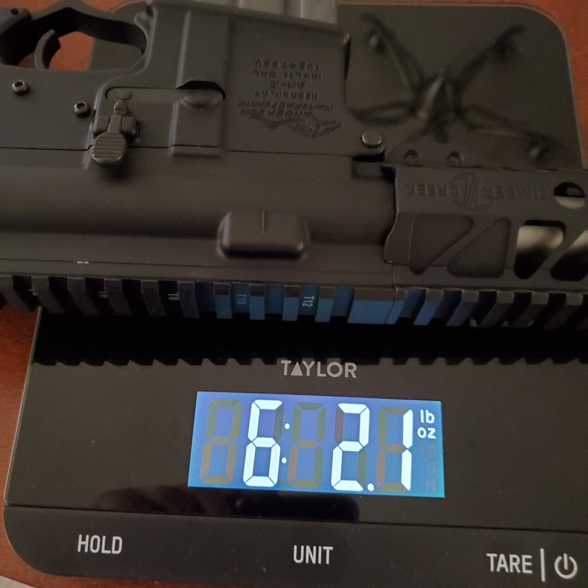

One can build a light weight AR 10, it's a joy to carry and accurate at just 6 lbs 2 oz for the complete rifle 16" fluted barrel running 168 ELDM at an ave 2756 fps or 150 gr bonded at 2850 fps would likely do on hogs....you can use cheap LC brass to get this accuracy, so ya dont have to worry about losing brass in the field.
Give ya the build info if interested... ya don't have to hunt with a heavy AR 10.
The scope is only for accuracy testing, it shoots 1/2"moa 5 shot groups, but I run a lighter scope for general use.
But at 6 lbs ready to go, one can add whatever you like for a short, fast handling rifle with power, and accuracy.

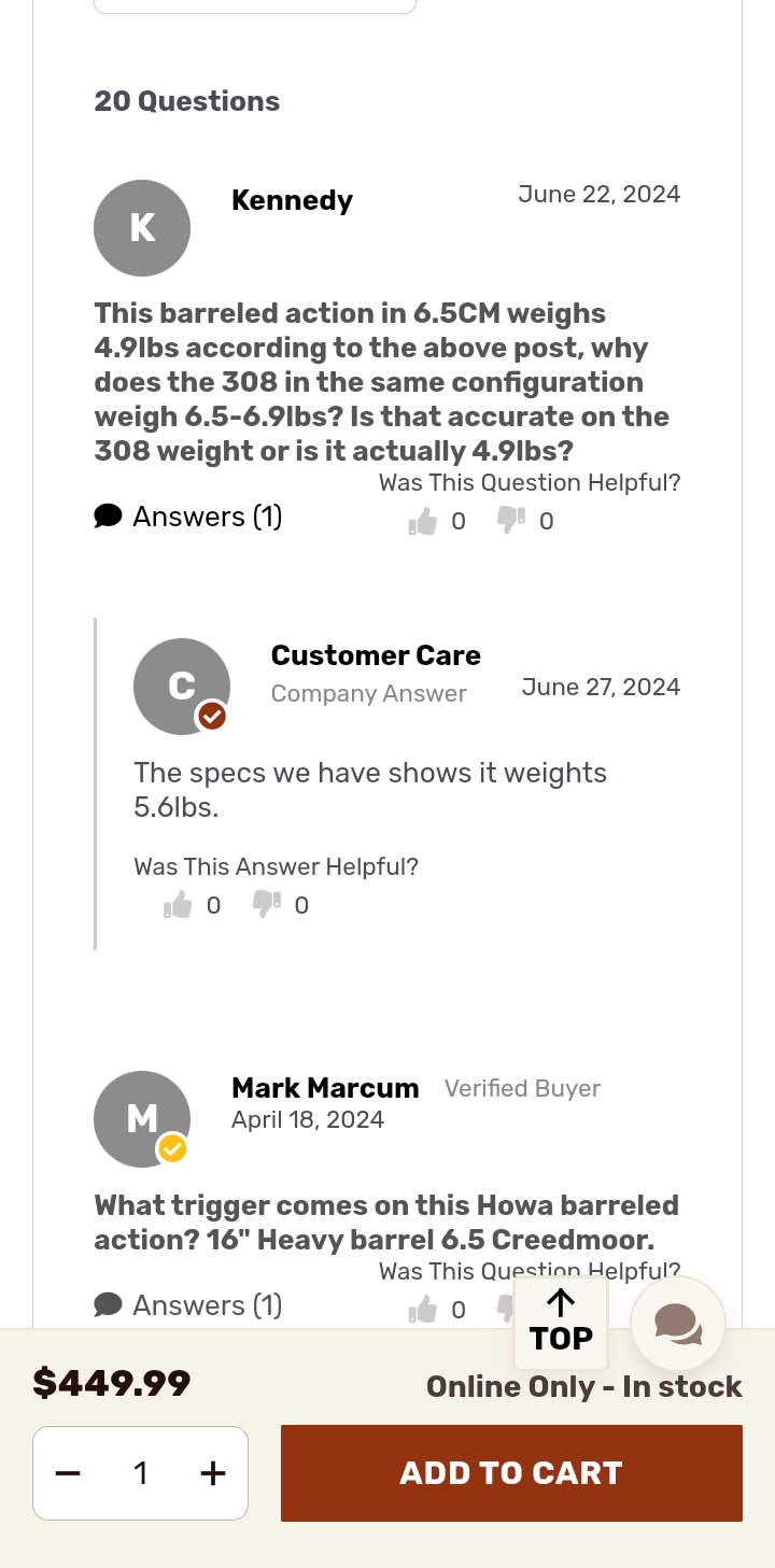

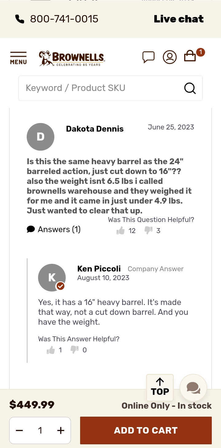

I was looking at the 16" model in 6.5CM myself and found this question/answer on brownells page about it.
The lower picture has a brownells rep answering that their spec has it weighing in at 5.6 pounds. I'm willing to bet that's the shipped weight. As in including the box it's in, all the foam peanuts, packing paper, etc.
