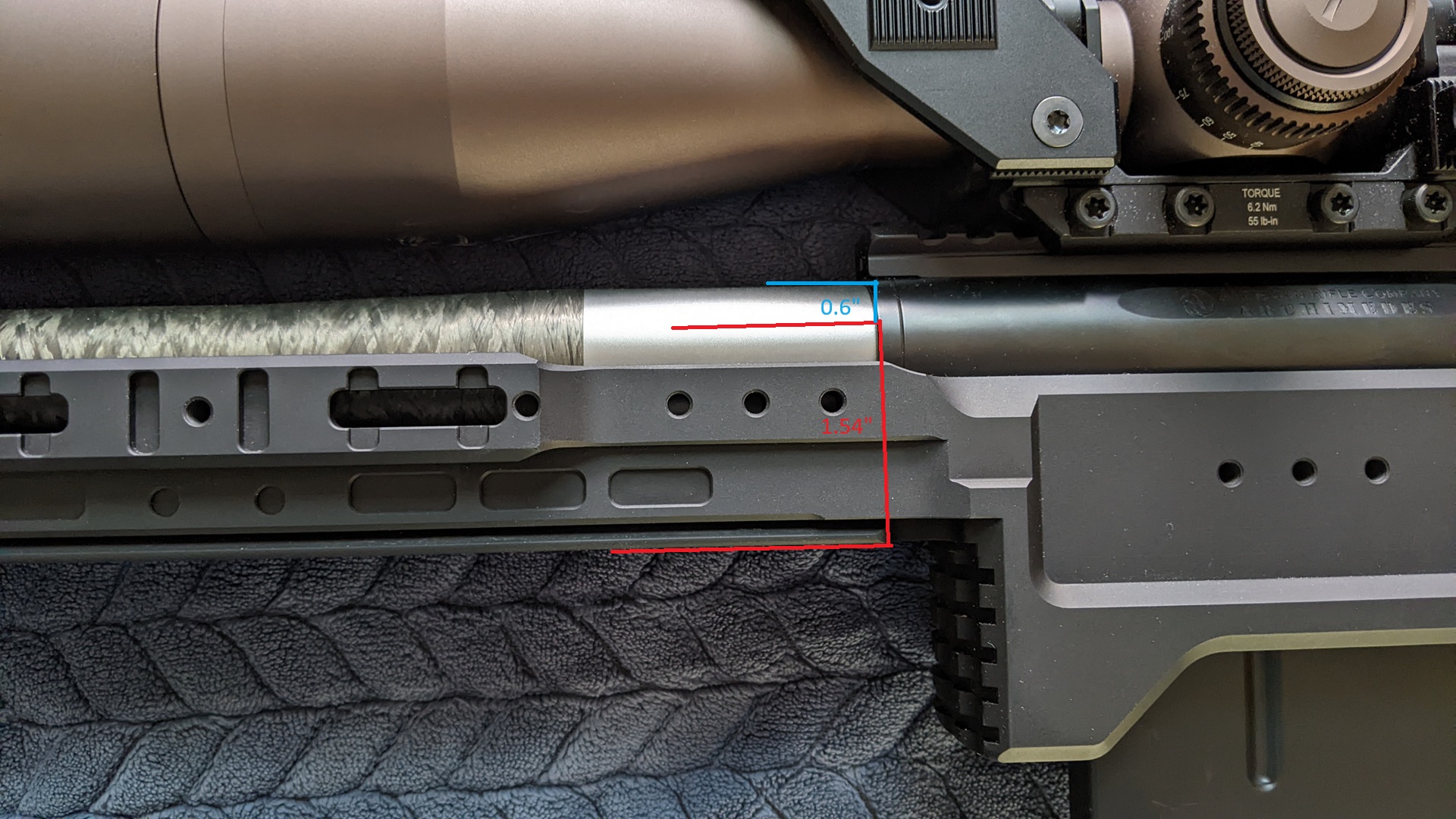

Can anyone measure the bore height on their c4? Basically measure from top of barrel to bottom of chassis forend,.minus half the barrel diameter at measure point? I like my atx, xlr chassis wit the very low bore centers, the seem to track a lil better under recoil staying on target when I do a decent job of recoil management(positional prop/bag shooting). I don't run my rifles super heavy, most my match rifles are 18#.
I can measure it later today. It does sit higher than my XLR and ACC Elite.
The ACC Elite, Envy Pro, and ATX are all pretty comparable in terms of HOB and considerably lower than the KRG.
I’ve shot a number of C4s and each time the rifle has felt top heavy on a bag. It doesn’t settle as quickly and the recoil impulse is more apparent. There are obviously alternative ways to mitigate the recoil aspect but the fact that it doesn’t feel as grounded positionally has always made it a non starter for me.

1.54 inches.
