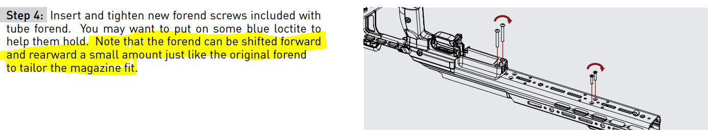

    At any rate, I have an enclosed fore end going on an X-ray backbone that has been converted to a Bravo rear. Everything bolted together nicely. That being said, the mag well is tight. To the point you have to really work getting the mag in, and have to really pull hard to get it out. Anyone else run into this?
    What was your solution? Just take a file to the front of the mag well? I'd really like to not screw with the anodized coating, but something has to give here.
    At any rate, hoping the Hide hive mind might be able to help...
    Have you tried this?
    7068770
    BTW, the enclosed fore end I received does NOT have screws in the mag well like depicted in your drawing. It has a dovetail at the front that the mag well seats into, and two small screws at the rear, attaching it to the fore end tube.
