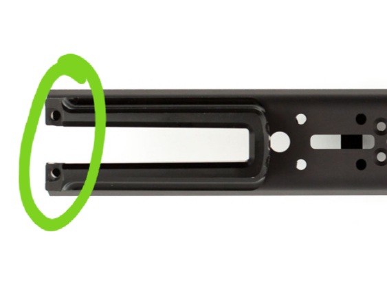

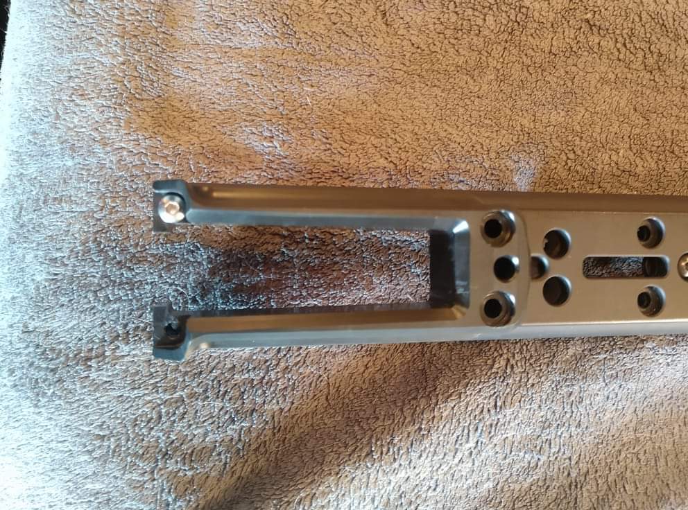

Does anyone know if screws are supposed to go in the two aft holes of the magazine well on the gen 1 enclosed forend? I ordered a hardware kit from KRG and that hardware wasn't included. If that is what in fact goes there, do you have the dimensions of said screw? I have scoured high and low to look for pictures but here I am for specifics. It's on a SA chassis.
The first pic is from KRG website, other is pic I took. The screw was too small to verify.

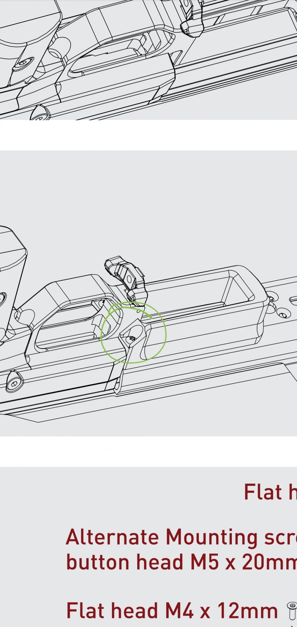

That could most certainly be. The Tikka instructions show a screw here but it fits the Rem SA very well. Without the screw, there is flexibility and some play there. Again, could be for ease of insertion and release of the magazine.
Found this vid so deleted my first reply:
Looks like his forend shipped with screws already installed, and that the screws are holding the rear of the magwell on.
Best to email KRG and ask for a pair of replacement screws.
