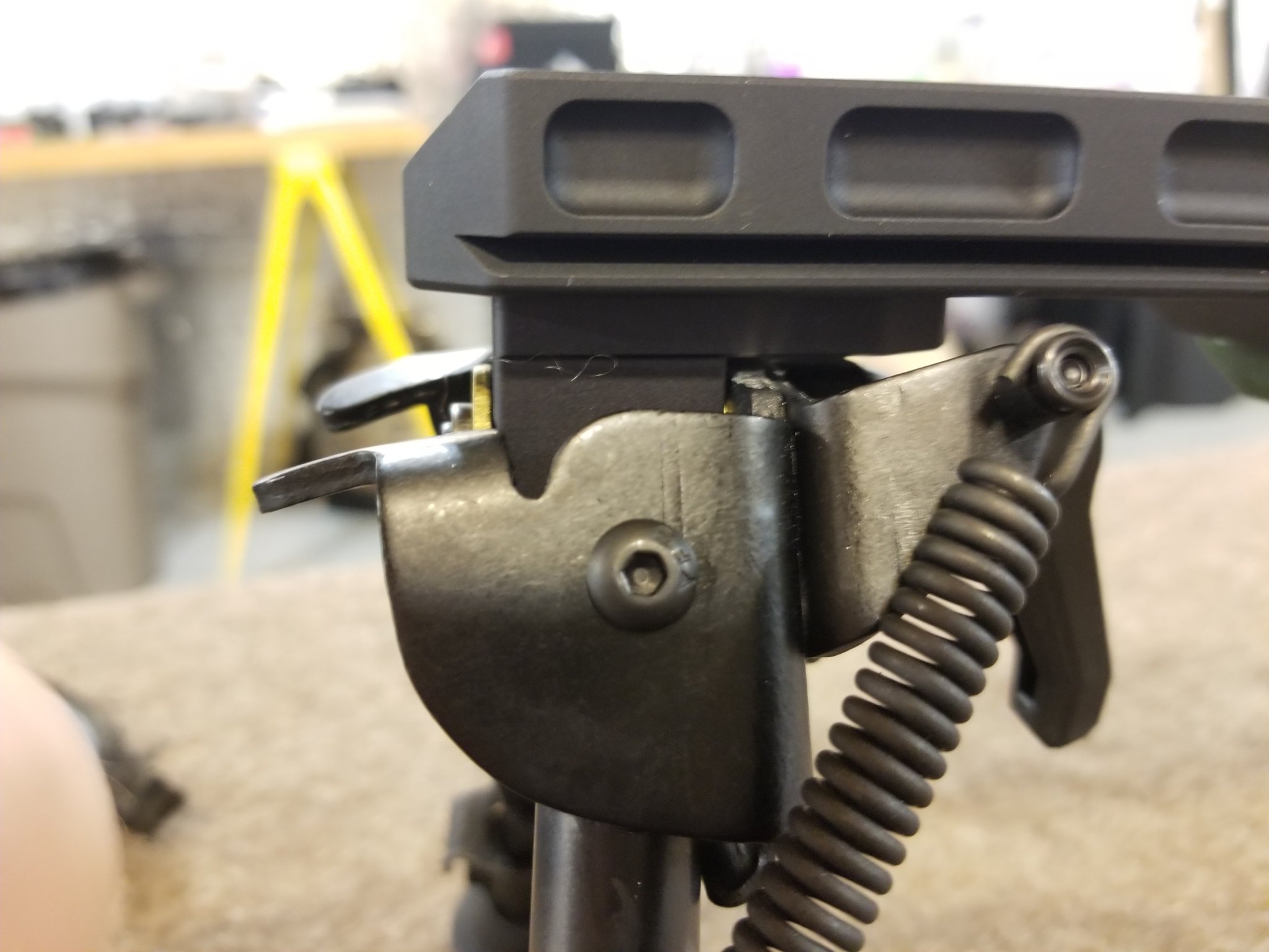

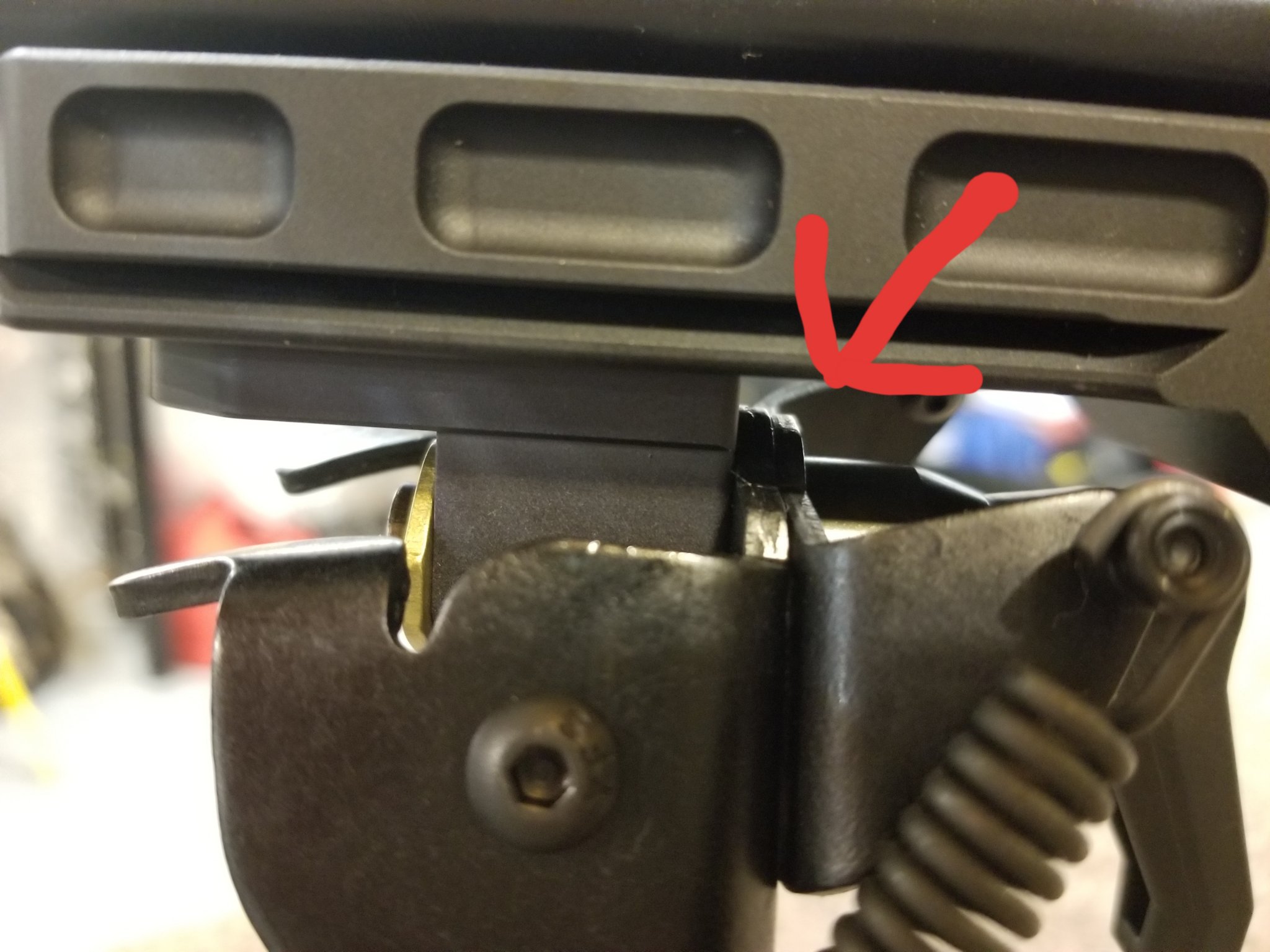

My ARCA Spigot and Harris bipod mount arrived today and after assembling them, I ran into a problem. The KMW pod loc ratcheting collar on my Harris bipod is longer than other locks and actually prevents me from putting the forend cover back onto the Bravo chassis.
After further inspection, it appears that I could grind ~1/8" off the Harris (the little hump where the red arrow is pointing) and then flip the mount around so the pivot mount sleeve is closer to the muzzle by an inch. I cannot think of a reason why the hump that I intend to grind off needs to exist, but I'm open for thoughts and suggestions.
And yes, I totally understand that I could fix this by purchasing a ARCA clamp, but I'm holding off on that till I have another rifle.
The Pod Loc ratcheting collar will protrude above the portion that I intend to grind flat, but it appears I'll have .030" or .040" clearance to the underside of the KRG bipod mount.

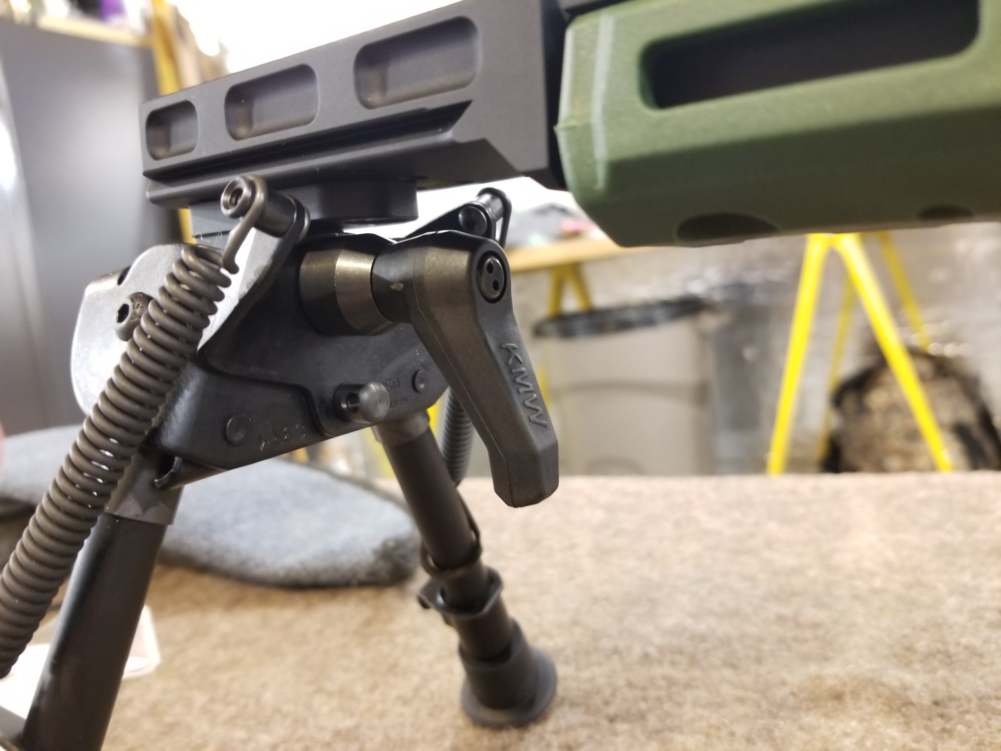

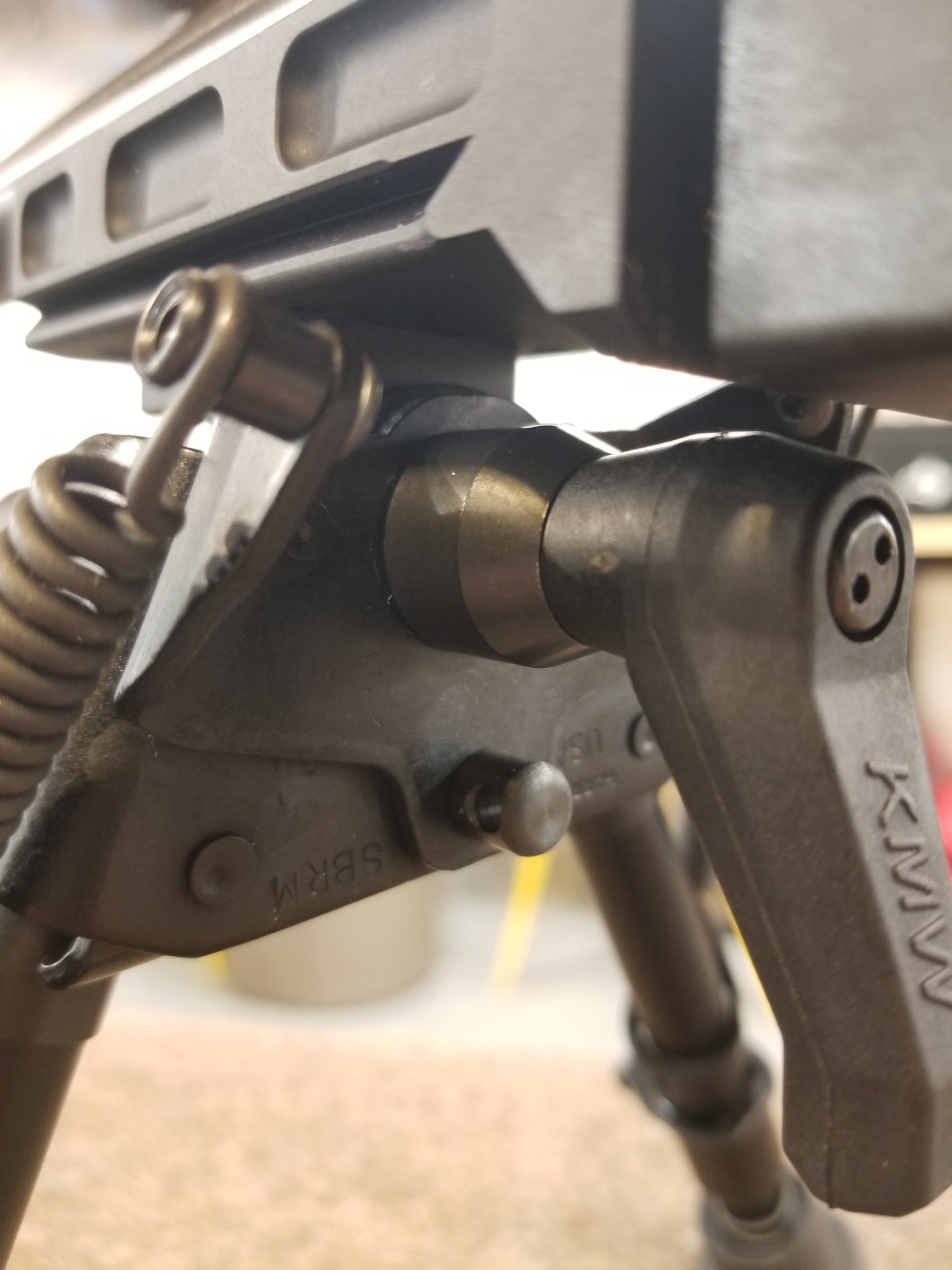

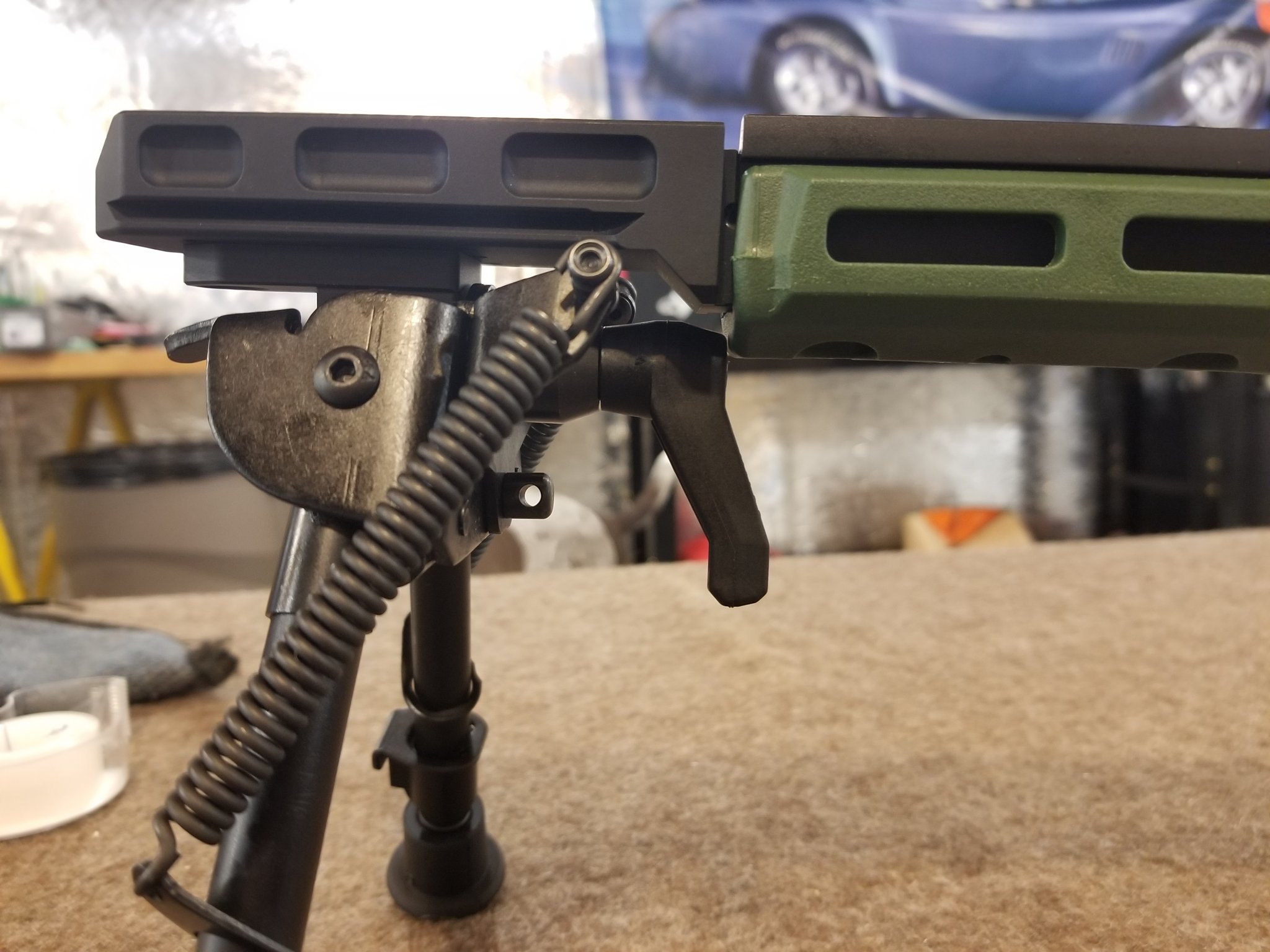

Here's another photo of the issue I am having. I was able to get the forend on with a bit of wiggling and muscle, but it's so close to the pod loc handle that I can't pull back to use the ratchet feature, rendering it useless.
Regarding the Atlas, I could cut my losses on this Harris and just put it in my hunting rifle. Is the BT65-LW17 CAL with the qd pic rail setup approximately what you use?
Yeah, except I use the Area 419 Arca mount rather than the ADM one that you're looking at for a picatinny rail, though if I were mounting to a rail, I like the ADM mount a lot.
I guess when I had the similar setup to yours I remember it being fairly close there, but once you have the Pod-Lok set to where you want it, aren't you basically done messing with it & it's just a simple twist of the handle to go from loose to all locked up?

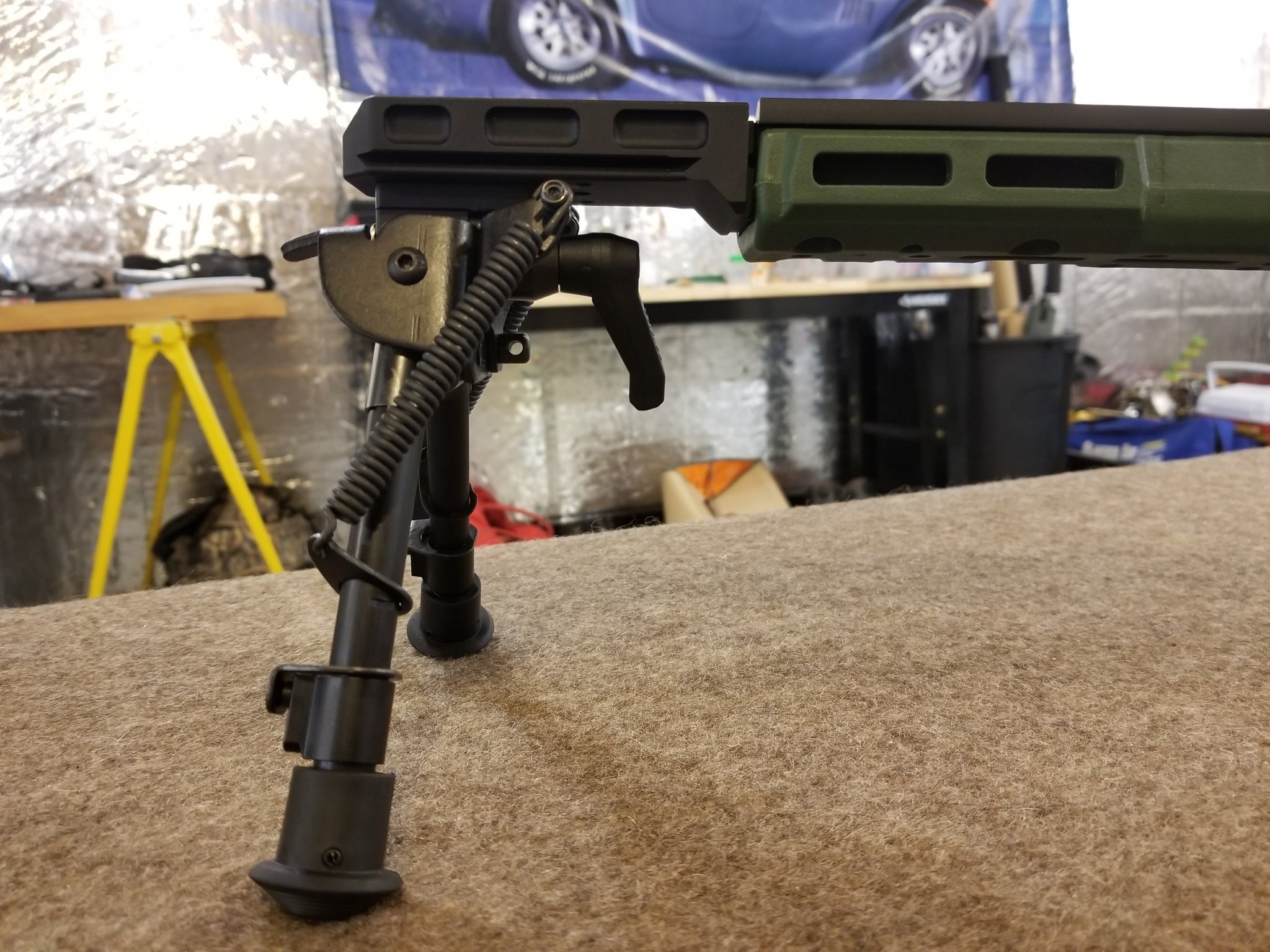

Here's the finished product.
I was able to reverse the KRG Harris bipod mount, moving the bipod ~1" further forward.

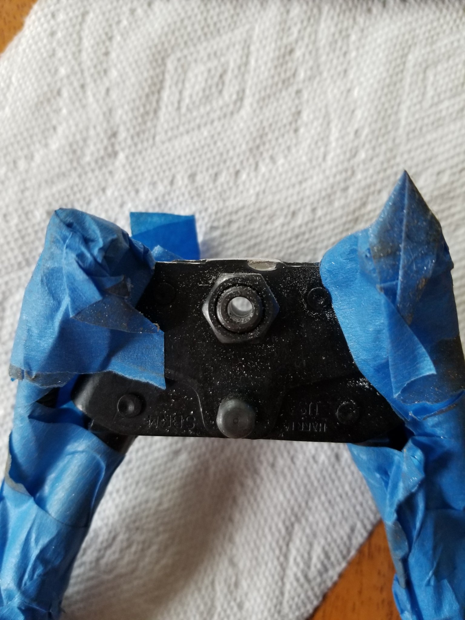

Here's the offending hump of metal.

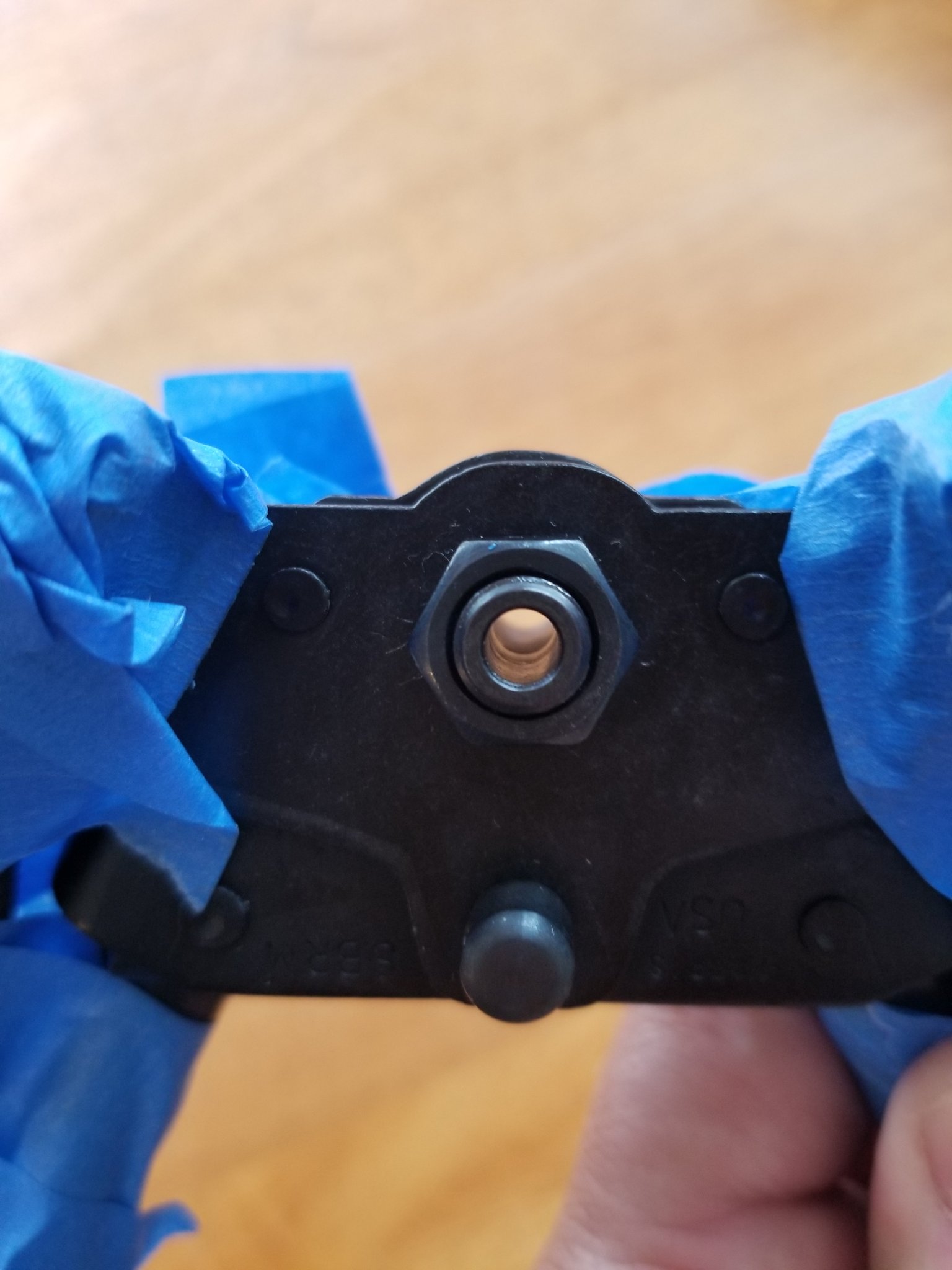

Here it is after a few minutes with a Dremel and a hand file to clean it up.
After cleaning off the metal shavings I ended up with this. I'll repaint it with some Krylon tomorrow.
