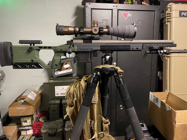

I just noticed the pics shown previously are all with those rigs on tripods... like that, mine was fine too. My issue was the clearance/gap disappeared when resting on the bipod. YMMV?

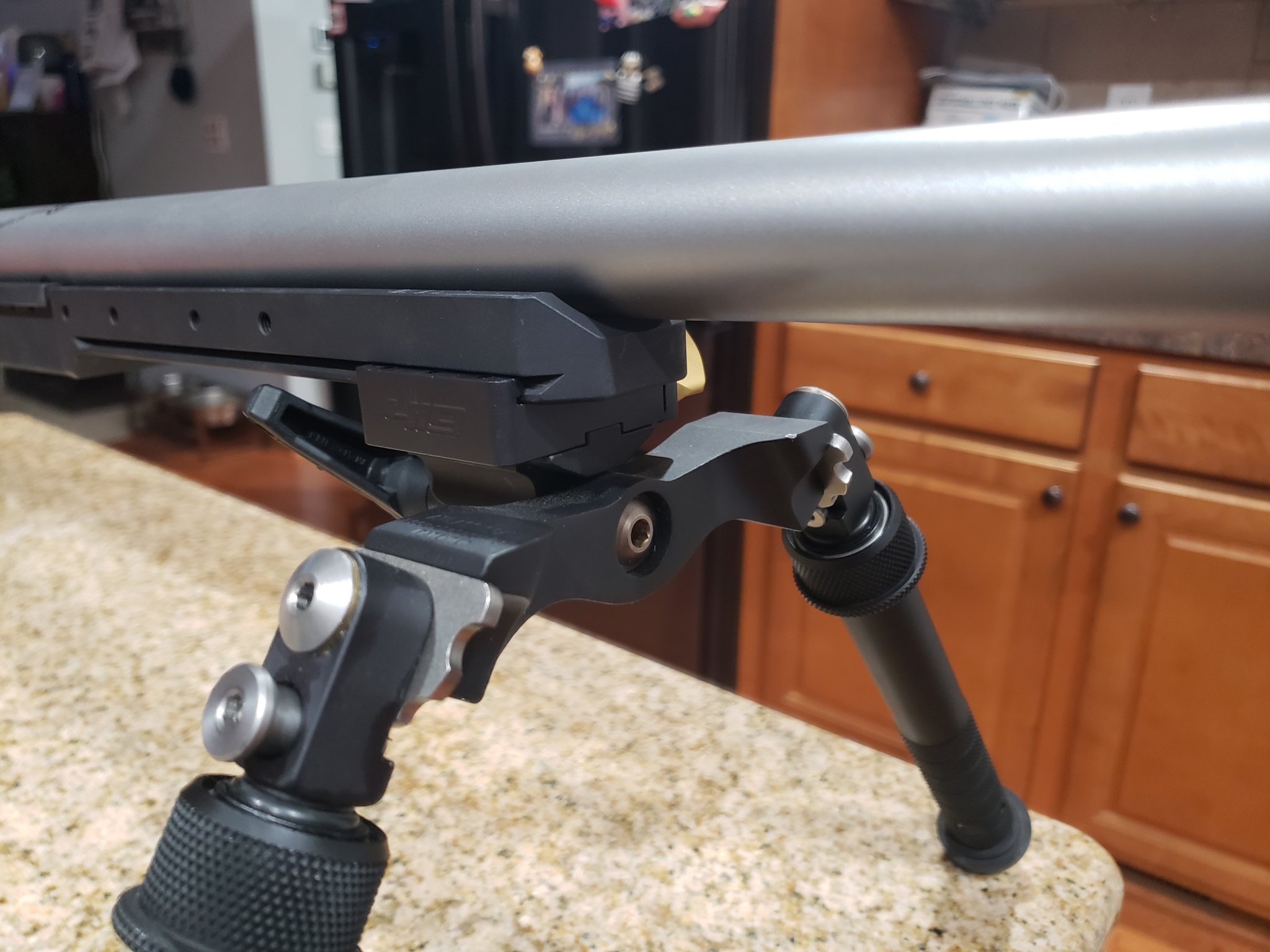

Looks like yours clears... cool.
But, that pic doesn't look like the gun is sitting on a rear bag, ...have you checked it like that? IIRC mine was GTG until I looked at it on a bag (looks like yours is fine though).
Got mine in and it clears the barrel fine when on a bag/me loading it up a bit. Now I can push donw on the barrel with not a lot of force and get it to touch, but at rest on a rear bag I put 4 pieces of 8.5x11 together and ran it the length of the spigot runs free and clear. So stable wow. Can't wait til next week.
