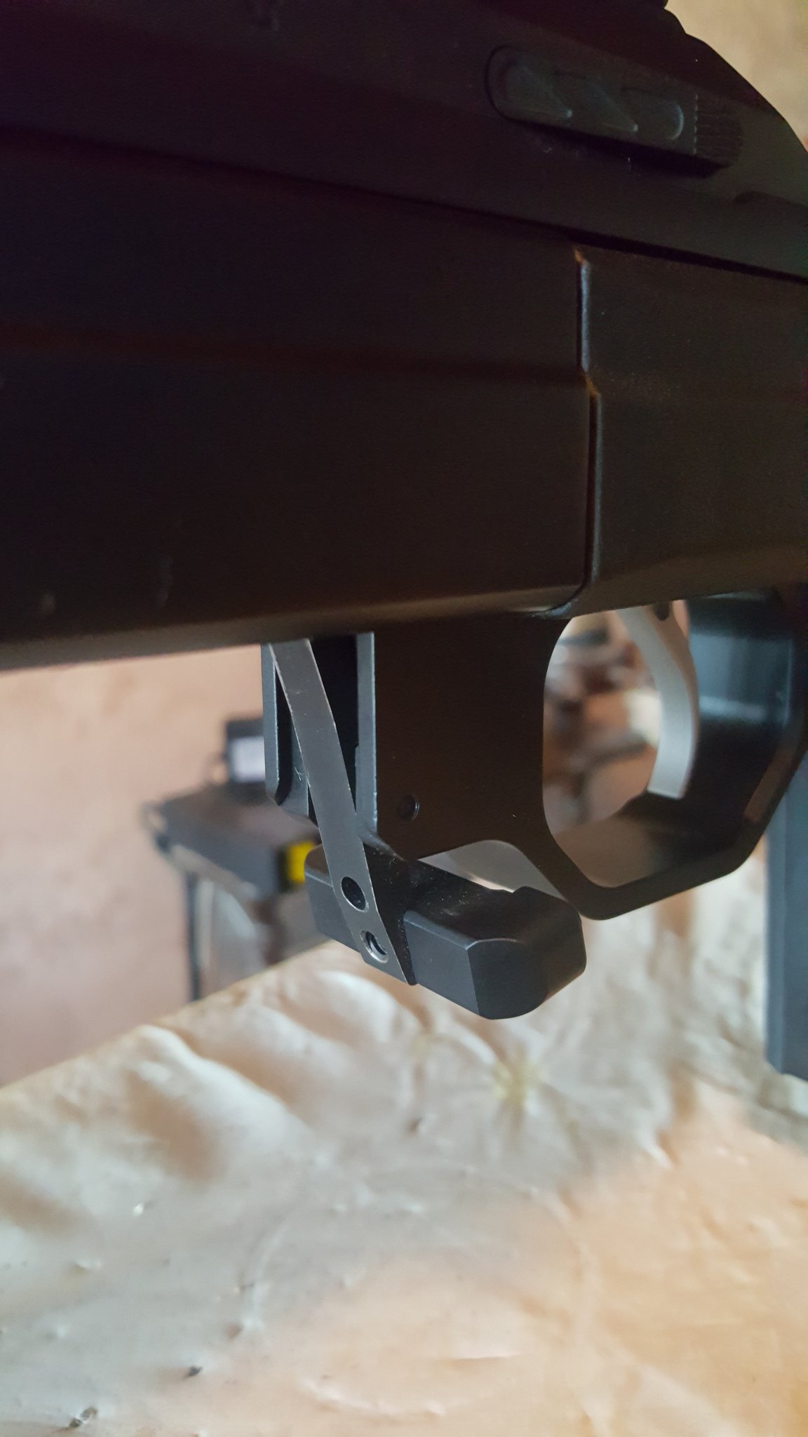

Thank you for your reply justin !
Here is the photo :
I brought it new in may 2015.
I have always feed the chamber manually so haven't notice this issue before.
Can you send me a link of the new double spring product ?
Here is the photo :
Ah I see. There are two things to check. The magazine fit can be adjusted, as you have done with the forend. You can move the triggerguard as well but you need to remove the action. Then you loosen the screw that is hidden by the action. Make sure the mag is tight but not so tight that it's difficult to insert. The second is we can send you a new spring set for the magazine catch which is stiffer and will fix any problems that tightening the mag does not fix. Thank you!
Justin
