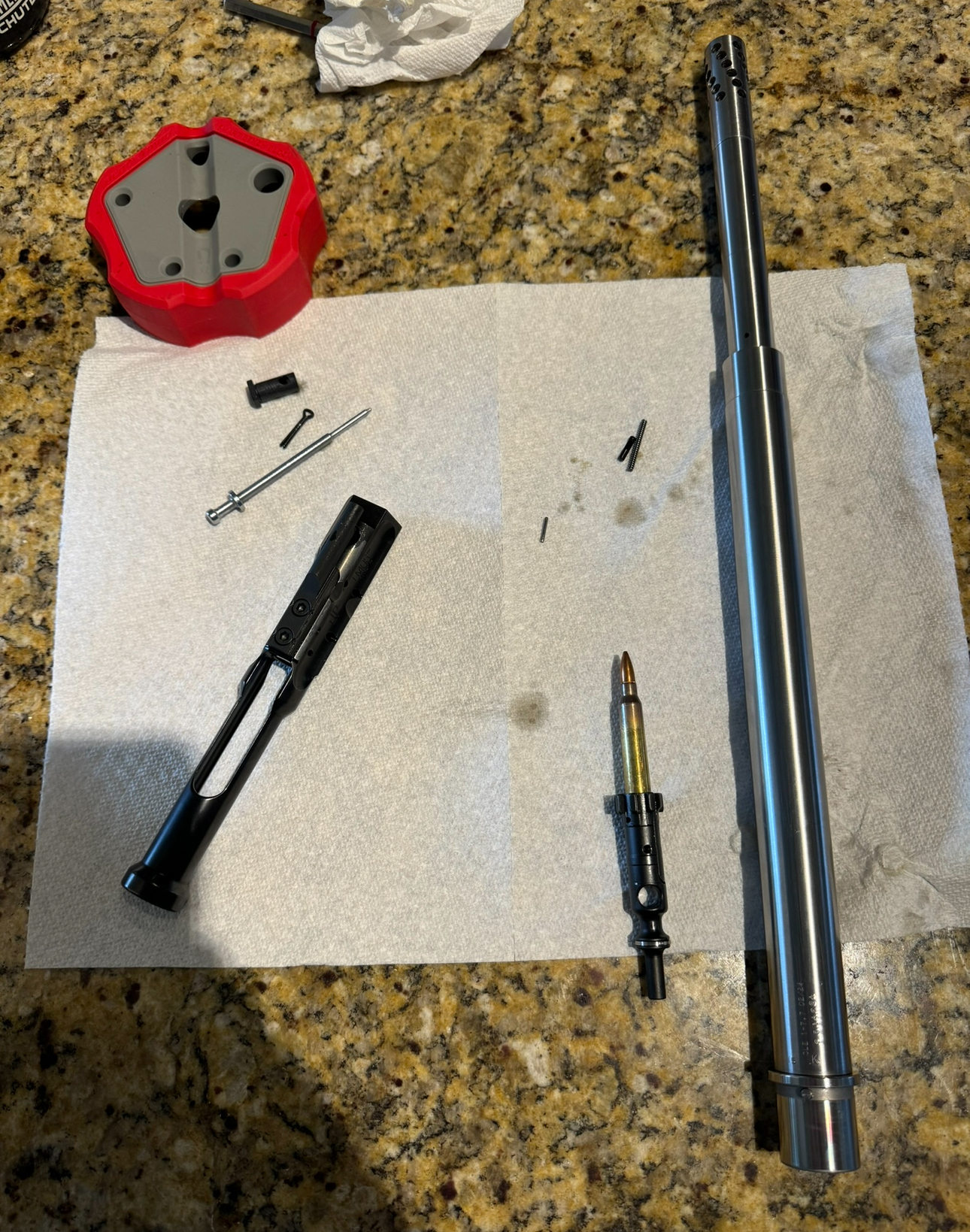

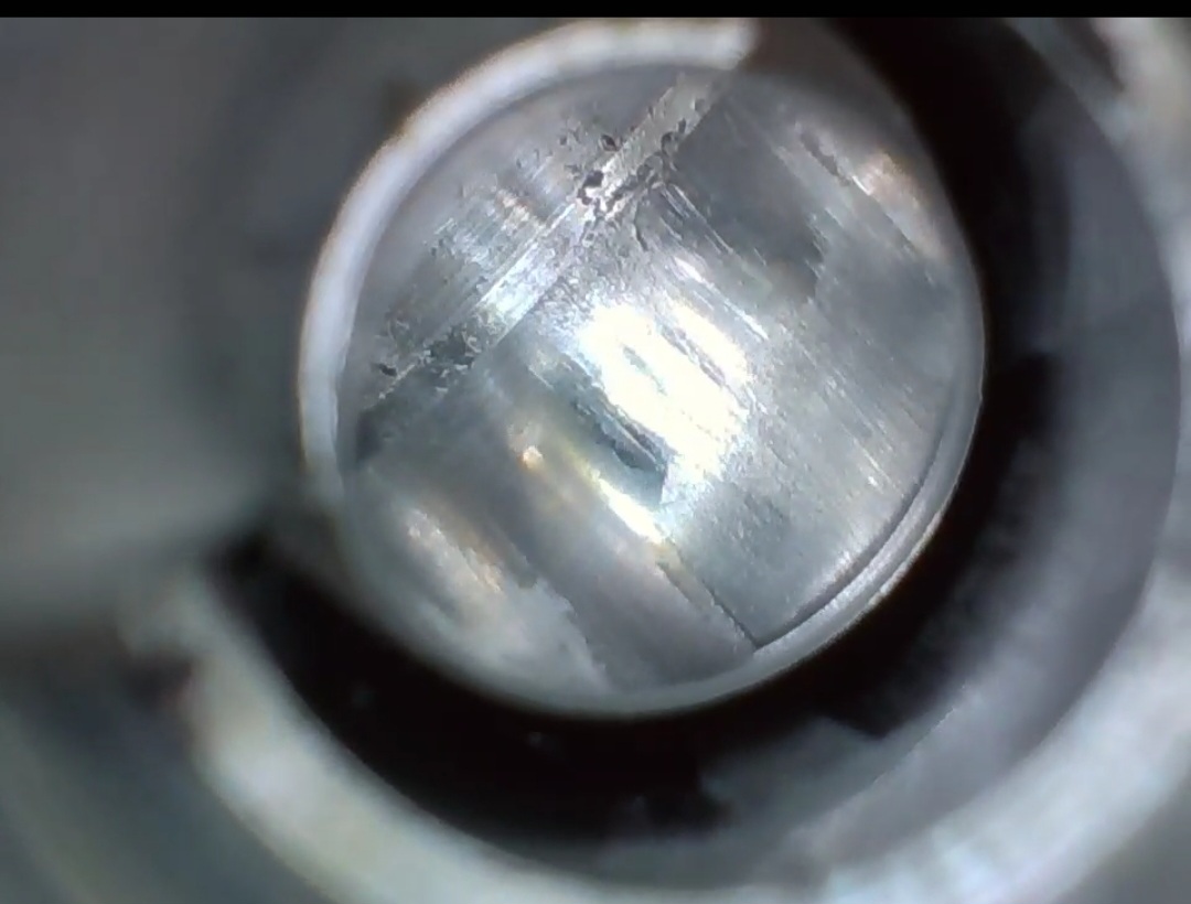

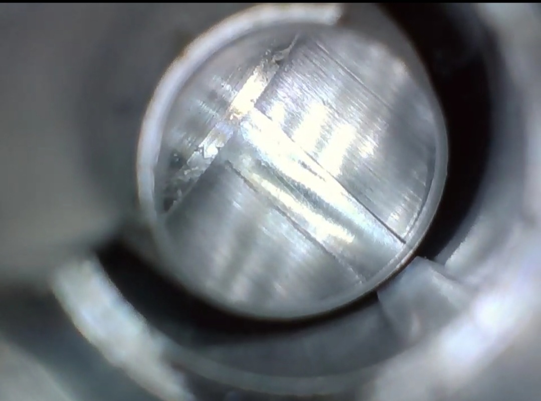

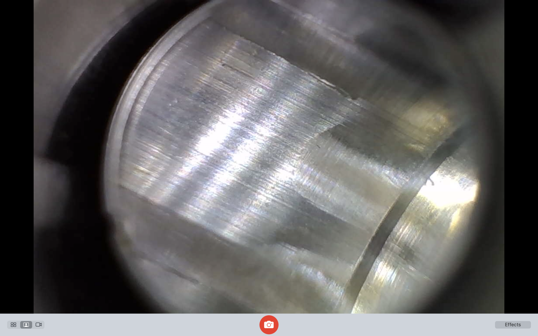

What's wrong in these pictures? Point of view is at the chamfer of the neck. More information to follow...
array:40 [ "versionId" => 2021672 "version" => "2.2.16" "app" => App {#2 #container: Container {#10 #data: array:184 [ …184] #cache: array:77 [ …77] #cacheable: array:184 [ …184] #factory: array:20 [ …20] #factoryObjects: array:7 [ …7] } #preLoadShared: array:26 [ 0 => "addOns" 1 => "addOnsComposer" 2 => "autoJobRun" 3 => "bbCodeMedia" 4 => "classExtensions" 5 => "codeEventListeners" 6 => "connectedAccountCount" 7 => "contentTypes" 8 => "displayStyles" 9 => "helpPageCount" 10 => "languages" 11 => "masterStyleProperties" 12 => "nodeTypes" 13 => "options" 14 => "paymentProvider" 15 => "reactions" 16 => "reportCounts" 17 => "simpleCache" 18 => "smilies" 19 => "unapprovedCounts" 20 => "userBanners" 21 => "userTitleLadder" 22 => "userUpgradeCount" 23 => "widgetCache" 24 => "widgetDefinition" 25 => "widgetPosition" ] #preLoadLocal: array:13 [ 0 => "bannedIps" 1 => "bbCodeCustom" 2 => "discouragedIps" 3 => "forumTypes" 4 => "notices" 5 => "noticesLastReset" 6 => "routeFilters" 7 => "routesPublic" 8 => "styles" 9 => "userFieldsInfo" 10 => "threadFieldsInfo" 11 => "threadPrefixes" 12 => "threadTypes" ] #updateCsrfCookie: "5-6COgV6cr523ty6" #isServedFromCache: false } "request" => Request {#233 #filterer: InputFilterer {#234 #stringCleaning: array:67 [ …67] #fullUnicode: true } #input: array:1 [ "/shooting/threads/cle-krieger-barrel_7206709/" => "" ] #files: [] #cookie: [] #server: array:39 [ "USER" => "production" "HOME" => "/home/production" "HTTP_CF_CONNECTING_IP" => "3.145.51.35" "HTTP_REFERER" => "https://www.snipershide.com/shooting/threads/krieger-barrel.7206709" "HTTP_CONNECTION" => "Keep-Alive" "HTTP_CF_VISITOR" => "{"scheme":"https"}" "HTTP_CDN_LOOP" => "cloudflare; loops=1" "HTTP_ACCEPT" => "*/*" "HTTP_X_FORWARDED_PROTO" => "https" "HTTP_CF_IPCOUNTRY" => "US" "HTTP_ACCEPT_ENCODING" => "gzip, br" "HTTP_USER_AGENT" => "Mozilla/5.0 AppleWebKit/537.36 (KHTML, like Gecko; compatible; ClaudeBot/1.0; [email protected])" "HTTP_HOST" => "www.snipershide.com" "HTTP_X_FORWARDED_FOR" => "3.145.51.35" "HTTP_CF_RAY" => "8fe231956be4e254-ORD" "REDIRECT_STATUS" => "200" "SERVER_NAME" => "www.snipershide.com" "SERVER_PORT" => "443" "SERVER_ADDR" => "144.168.44.98" "REMOTE_PORT" => "" "REMOTE_ADDR" => "3.145.51.35" "SERVER_SOFTWARE" => "nginx/1.18.0" "GATEWAY_INTERFACE" => "CGI/1.1" "HTTPS" => "on" "REQUEST_SCHEME" => "https" "SERVER_PROTOCOL" => "HTTP/1.1" "DOCUMENT_ROOT" => "/usr/share/nginx/sites/production/www.snipershide.com" "DOCUMENT_URI" => "/shooting/index.php" "REQUEST_URI" => "/shooting/threads/cle-krieger-barrel.7206709/" "SCRIPT_NAME" => "/shooting/index.php" "CONTENT_LENGTH" => "" "CONTENT_TYPE" => "" "REQUEST_METHOD" => "GET" "QUERY_STRING" => "/shooting/threads/cle-krieger-barrel.7206709/&" "SCRIPT_FILENAME" => "/usr/share/nginx/sites/production/www.snipershide.com/shooting/index.php" "FCGI_ROLE" => "RESPONDER" "PHP_SELF" => "/shooting/index.php" "REQUEST_TIME_FLOAT" => 1736234514.8329 "REQUEST_TIME" => 1736234514 ] #skipLogKeys: array:1 [ 0 => "_xfToken" ] #cookiePrefix: "xf_" #remoteIp: "3.145.51.35" #robotName: "" #fromSearch: false } "uri" => "/shooting/threads/cle-krieger-barrel.7206709/" "fullUri" => "https://www.snipershide.com/shooting/threads/cle-krieger-barrel.7206709/" "time" => 1736234514 "timeDetails" => array:6 [ "tomorrow" => "1736312400" "now" => 1736234514 "today" => "1736226000" "todayDow" => "2" "yesterday" => "1736139600" "week" => "1735707600" ] "debug" => false "development" => false "designer" => false "visitor" => User {#310 #_getterCache: array:1 [ "PermissionSet" => PermissionSet {#323 …5} ] #_valueCache: array:3 [ "is_moderator" => false "is_banned" => false "is_admin" => false ] #_structure: Structure {#297 +shortName: "XF:User" +contentType: "user" +table: "xf_user" +primaryKey: "user_id" +columns: array:54 [ …54] +relations: array:19 [ …19] +getters: array:68 [ …68] +defaultWith: array:1 [ …1] +options: array:8 [ …8] +behaviors: array:1 [ …1] +columnAliases: array:1 [ …1] +withAliases: array:1 [ …1] } #_em: Manager {#294 #db: Adapter {#223 #statementClass: "XF\Db\Mysqli\Statement" #config: array:6 [ …6] #fullUnicode: true #inTransaction: false #savePointCounter: 0 #savePoints: [] #queryCount: 37 #logQueries: false #logSimpleOnly: null #queryLog: [] #ignoreLegacyTableWriteError: false #schemaManager: null #connection: mysqli {#324} } #valueFormatter: ValueFormatter {#295} #extension: Extension {#227 …4} #entityClassNameMap: array:28 [ …28] #entities: array:19 [ …19] #structures: array:28 [ …28] #repositories: array:23 [ …23] #cascadeEntitySeen: [] #cascadeEventDepth: [] } -_uniqueEntityId: 5 #rootClass: "XF\Entity\User" #_useReplaceInto: false #_newValues: [] #_values: array:52 [ "user_id" => 0 "username" => "" "username_date" => 0 "username_date_visible" => 0 "style_id" => 0 "language_id" => 0 "timezone" => "America/New_York" "visible" => 1 "activity_visible" => 1 "user_group_id" => 1 "secondary_group_ids" => "" "display_style_group_id" => 0 "permission_combination_id" => 1 "message_count" => 0 "question_solution_count" => 0 "alerts_unviewed" => 0 "alerts_unread" => 0 "conversations_unread" => 0 "register_date" => 1736234514 "last_activity" => 1736234514 "last_summary_email_date" => null "trophy_points" => 0 "avatar_date" => 0 "avatar_width" => 0 "avatar_height" => 0 "avatar_highdpi" => 0 "gravatar" => "" "user_state" => "valid" "security_lock" => "" "is_moderator" => 0 "is_admin" => 0 "is_staff" => 0 "is_banned" => 0 "reaction_score" => 0 "vote_score" => 0 "custom_title" => "" "warning_points" => 0 "privacy_policy_accepted" => 0 "terms_accepted" => 0 "adca_last_email_date" => 0 "thdonate_total_donation" => 0.0 "thdonate_total_public_donation" => 0.0 "thdonate_total_anonymous_donation" => 0.0 "thdonate_num_donation" => 0 "thdonate_num_public_donation" => 0 "thdonate_num_anonymous_donation" => 0 "thfeature_feature_count" => 0 "xfmg_album_count" => 0 "xfmg_media_count" => 0 "xfmg_media_quota" => 0 "xfrm_resource_count" => 0 "audapp_preferences" => "[]" ] #_relations: array:4 [ "Auth" => UserAuth {#303 …20} "Option" => UserOption {#305 …20} "Profile" => UserProfile {#307 …20} "Privacy" => UserPrivacy {#309 …20} ] #_previousValues: [] #_options: [] #_deleted: false #_readOnly: true #_writePending: false #_writeRunning: false #_errors: [] #_whenSaveable: [] #_cascadeSave: [] #_behaviors: null #audliveUserRealmIds: null #primaryRealmUserId: null #realmsUserRealmIds: null #forceRealmsChanges: false #thuixWatchedNodes: null #thuc_user_criteria_cache: null #postDaysData: [] } "session" => Session {#275 #storage: DbStorage {#276 #db: Adapter {#223} #table: "xf_session" } #config: array:5 [ "cookie" => "session" "keyLength" => 32 "lifetime" => 14400 "ipv4CidrMatch" => 24 "ipv6CidrMatch" => 64 ] #sessionId: "K21U1hQ125CN3M-syoij3R0xJDAzqmiv" #exists: false #fromCookie: false #data: array:1 [ "_ip" => b"\x03‘3#" ] } "cookie" => array:4 [ "prefix" => "xf_" "path" => "/" "domain" => "" "secure" => true ] "cookieConsent" => CookieConsent {#279 #cookies: array:26 [ "__crossTab" => array:4 [ …4] "cacheKey" => array:4 [ …4] "consent" => array:4 [ …4] "csrf" => array:4 [ …4] "dbWriteForced" => array:4 [ …4] "editorDisabled" => array:4 [ …4] "emoji_usage" => array:4 [ …4] "fr-copied-html" => array:4 [ …4] "fr-copied-text" => array:4 [ …4] "from_search" => array:4 [ …4] "guestUsername" => array:4 [ …4] "inline_mod_*" => array:4 [ …4] "language_id" => array:4 [ …4] "lbSidebarDisabled" => array:4 [ …4] "ls" => array:4 [ …4] "multiQuote*" => array:4 [ …4] "notice_dismiss" => array:4 [ …4] "push_history_user_ids" => array:4 [ …4] "push_notice_dismiss" => array:4 [ …4] "push_subscription_updated" => array:4 [ …4] "session" => array:4 [ …4] "style_id" => array:4 [ …4] "tfa_trust" => array:4 [ …4] "toggle" => array:4 [ …4] "user" => array:4 [ …4] "visitorCounts" => array:4 [ …4] ] #thirdParties: array:133 [ "abcnews" => true "acast" => true "anchor" => true "apple_music" => true "applepodcasts" => true "audioboom" => true "audiomack" => true "audius" => true "bandcamp" => true "bbcnews" => true "bitchute" => true "brightcove" => true "bunny" => true "captivate" => true "castos" => true "cbsnews" => true "clyp" => true "cnbc" => true "cnn" => true "cnnmoney" => true "codepen" => true "comedycentral" => true "coub" => true "dailymotion" => true "democracynow" => true "dumpert" => true "eighttracks" => true "espn" => true "facebook" => true "falstad" => true "flickr" => true "foxnews" => true "funnyordie" => true "gamespot" => true "getty" => true "gifs" => true "giphy" => true "gist" => true "globalnews" => true "gofundme" => true "google" => true "google_analytics" => true "google_recaptcha" => true "hudl" => true "hulu" => true "ign" => true "imdb" => true "imgur" => true "indiegogo" => true "instagram" => true "internetarchive" => true "izlesene" => true "jsfiddle" => true "jwplatform" => true "kaltura" => true "khl" => true "kickstarter" => true "libsyn" => true "liveleak" => true "livestream" => true "mailru" => true "mastodon" => true "medium" => true "megaphone" => true "meta" => true "metacafe" => true "mixcloud" => true "mlb" => true "mrctv" => true "msnbc" => true "natgeochannel" => true "natgeovideo" => true "nbcnews" => true "nhl" => true "npr" => true "nytimes" => true "odysee" => true "on3" => true "orfium" => true "pastebin" => true "pinterest" => true "podbean" => true "prezi" => true "reddit" => true "rumble" => true "rutube" => true "scribd" => true "sendvid" => true "slideshare" => true "soundcloud" => true "sporcle" => true "sportsnet" => true "spotify" => true "spreaker" => true "steamstore" => true "strawpoll" => true "streamable" => true "teamcoco" => true "ted" => true "telegram" => true "theatlantic" => true "theguardian" => true "theonion" => true "tiktok" => true "tmz" => true "tradingview" => true "traileraddict" => true "trendingviews" => true "tumblr" => true "twentyfoursevensports" => true "twitch" => true "twitter" => true "ustream" => true "vbox7" => true "veoh" => true "vevo" => true "videodetective" => true "vimeo" => true "vine" => true "vk" => true "vocaroo" => true "vox" => true "washingtonpost" => true "wavekit" => true "wistia" => true "wshh" => true "wsj" => true "xboxclips" => true "xboxdvr" => true "xenforo" => true "youku" => true "youmaker" => true "youtube" => true ] #consentedGroups: [] } "enableRtnProtect" => true "serviceWorkerPath" => null "language" => Language {#311 #id: "1" #options: array:18 [ "title" => "English (US)" "language_code" => "en-US" "date_format" => "M j, Y" "time_format" => "g:i A" "currency_format" => "{symbol}{value}" "decimal_point" => "." "thousands_separator" => "," "text_direction" => "LTR" "week_start" => 0 "label_separator" => ":" "comma_separator" => ", " "ellipsis" => "…" "parenthesis_open" => "(" "parenthesis_close" => ")" "user_selectable" => true "language_id" => 1 "parent_id" => 0 "parent_list" => array:2 [ …2] ] #db: Adapter {#223} #groupPath: "/usr/share/nginx/sites/production/xf_code_cache/phrase_groups" #phraseCache: array:4113 [ "nav.NewsFeed" => "Your news feed" "nav._default" => "Default (no selected tab)" "nav.ad_leaderboards" => "Leaderboards" "nav.articles" => "Articles" "nav.audfeeds" => "Feeds" "nav.audfeeds_feed_1" => "Events" "nav.audfeeds_feed_10" => "Trending threads" "nav.audfeeds_feed_11" => "Hot" "nav.audfeeds_feed_12" => "Threads" "nav.audfeeds_feed_13" => "Questions" "nav.audfeeds_feed_14" => "Posts" "nav.audfeeds_feed_15" => "Hot Social" "nav.audfeeds_feed_2" => "Social" "nav.audfeeds_feed_3" => "Resources" "nav.audfeeds_feed_5" => "Comments" "nav.audfeeds_feed_6" => "Media" "nav.audfeeds_feed_7" => "Forum list" "nav.audfeeds_feed_8" => "Following" "nav.audfeeds_feed_9" => "Latest activity" "nav.audlive_realm_1" => "Home" "nav.contributedThreads" => "Threads with your posts" "nav.currentVisitors" => "Current visitors" "nav.defaultLatestActivity" => "Latest activity" "nav.defaultLogOut" => "Log out" "nav.defaultNewsFeed" => "Your news feed" "nav.defaultRegister" => "Register" "nav.defaultYourAccount" => "Your account" "nav.defaultYourProfile" => "Your profile" "nav.findThreads" => "Find threads" "nav.forumList" => "Forum list" "nav.forums" => "Forums" "nav.home" => "Home" "nav.latestActivity" => "Latest activity" "nav.markForumsRead" => "Mark forums read" "nav.members" => "Members" "nav.merch" => "Merch" "nav.newMedia" => "New media" "nav.newPosts" => "New posts" "nav.newProfilePosts" => "New profile posts" "nav.nfCalendar" => "Calendar" "nav.nfCalendarCreateEvent" => "Create event" "nav.nfCalendarEventWaitlist" => "Events you're waiting for" "nav.nfCalendarFindEvents" => "Find events" "nav.nfCalendarMarkRead" => "Mark read" "nav.nfCalendarNewEvents" => "New events" "nav.nfCalendarRsvpGoing" => "Events you're going to" "nav.nfCalendarRsvpMaybe" => "Events you might be going to" "nav.nfCalendarSearch" => "Search events" "nav.nfCalendarWatchedEvents" => "Watched events" "nav.nfCalendarYourEvents" => "Your events" "nav.nfNewCalEvents" => "New calendar events" "nav.realms_quizzes" => "Quizzes" "nav.realms_realm_1" => "Home" "nav.registeredMembers" => "Registered members" "nav.searchForums" => "Search forums" "nav.searchProfilePosts" => "Search profile posts" "nav.thMonetize_accountUpgrades" => "Account upgrades" "nav.th_donate" => "Donate" "nav.thfeature" => "Featured" "nav.thfilters_all_threads" => "All threads" "nav.thfilters_latest_threads" => "Latest threads" "nav.thfilters_newest_threads" => "New posts" "nav.thfilters_trending_threads" => "Trending threads" "nav.thtrending" => "Trending" "nav.thxlink_1" => "Home" "nav.unansweredThreads" => "Unanswered threads" "nav.upgrade" => "Upgrade" "nav.watched" => "Watched" "nav.watchedForums" => "Watched forums" "nav.watchedThreads" => "Watched threads" "nav.whatsNew" => "What's new" "nav.whatsNewNewsFeed" => "Your news feed" "nav.whatsNewPosts" => "New posts" "nav.whatsNewProfilePosts" => "New profile posts" "nav.xcfs" => "Feedback" "nav.xcfsFeedbackPref" => "Feedback Preferences" "nav.xcfsStatistics" => "View Statistics" "nav.xfmg" => "Media" "nav.xfmgAddMedia" => "Add media" "nav.xfmgMarkViewed" => "Mark viewed" "nav.xfmgNewComments" => "New comments" "nav.xfmgNewMedia" => "New media" "nav.xfmgSearchMedia" => "Search media" "nav.xfmgWatchedAlbums" => "Watched albums" "nav.xfmgWatchedCategories" => "Watched categories" "nav.xfmgWatchedContent" => "Watched" "nav.xfmgWatchedMedia" => "Watched media" "nav.xfmgWhatsNewMediaComments" => "New media comments" "nav.xfmgWhatsNewNewMedia" => "New media" "nav.xfmgYourAlbums" => "Your albums" "nav.xfmgYourContent" => "Your content" "nav.xfmgYourMedia" => "Your media" "nav.xfrm" => "Resources" "nav.xfrmLatestReviews" => "Latest reviews" "nav.xfrmNewResources" => "New resources" "nav.xfrmSearchResources" => "Search resources" "nav.xfrmWatched" => "Watched" "nav.xfrmWatchedCategories" => "Watched categories" "nav.xfrmWatchedResources" => "Watched resources" "nav.xfrmYourResources" => "Your resources" "nav.yourThreads" => "Your threads" "button.attach" => "Attach files" "button.cancel" => "Cancel" "button.confirm" => "Confirm" "button.copy" => "Copy" "button.delete" => "Delete" "button.edit" => "Edit" "button.export" => "Export" "button.hide" => "Hide" "button.import" => "Import" "button.login" => "Log in" "button.merge" => "Merge" "button.move" => "Move" "button.preview" => "Preview" "button.purchase" => "Purchase" "button.save" => "Save" "button.search" => "Search" "button.show" => "Show" "button.sort" => "Sort" "button.submit" => "Submit" "button.translate" => "Translate" "widget_def.XP_xpress_recent_posts_3" => "XPress: thxpress_widget_recent_posts" "widget_def.adav_level_progress" => "[Audentio] Achievements: Progress to next level" "widget_def.adav_recent_achievements" => "[Audentio] Achievements: Recently Earned Achievements" "widget_def.adav_tracked_achievements" => "[Audentio] Achievements: Tracked Achievements" "widget_def.adca_account_completion" => "[Audentio] Account Completion" "widget_def.adlb_leaderboard" => "[Audentio] Leaderboards: Leaderboard" "widget_def.birthdays" => "Today's birthdays" "widget_def.find_member" => "Find member" "widget_def.forum_statistics" => "Forum statistics" "widget_def.html" => "HTML" "widget_def.member_stat" => "Member stat" "widget_def.members_online" => "Members online" "widget_def.new_posts" => "New posts" "widget_def.new_profile_posts" => "New profile posts" "widget_def.new_threads" => "New threads" "widget_def.newest_members" => "Newest members" "widget_def.nf_calendar_featured_even" => "Calendar: Featured events" "widget_def.nf_calendar_upcoming_evnt" => "Calendar: Upcoming events" "widget_def.online_statistics" => "Online statistics" "widget_def.php_callback" => "PHP callback" "widget_def.search_forum" => "Search forum" "widget_def.share_page" => "Share this page" "widget_def.template_syntax" => "Template syntax" "widget_def.th_post_thread_uix" => "[UI.X] Start a thread" "widget_def.th_reactplus_top_content" => "[TH] Reactions Plus: Top content" "widget_def.th_widget_login_uix" => "[UI.X] Login form" "widget_def.thdonate_campaign" => "[TH] Donate: Campaign" "widget_def.thdonate_earnings" => "[TH] Donate: Earnings" "widget_def.thdonate_goals" => "[TH] Donate: Goals" "widget_def.thdonate_topDonations" => "[TH] Donate: Top donations" "widget_def.thdonate_topDonors" => "[TH] Donate: Top donors" "widget_def.thfeature_full" => "[TH] Featured Threads and Content: Full" "widget_def.thfeature_full_thread" => "[TH] Featured Threads and Content: Full Threads" "widget_def.thfeature_grid" => "[TH] Featured Threads and Content: Grid" "widget_def.thfeature_grid_threads" => "[TH] Featured Threads and Content: Grid Threads" "widget_def.thfeature_slider" => "[TH] Featured Threads and Content: Slider" "widget_def.thfeature_slider_threads" => "[TH] Featured Threads and Content: Slider Threads" "widget_def.thfilters_filters" => "[TH] Filters" "widget_def.threactplus_userReactList" => "[TH] Reactions Plus: Member reaction list" "widget_def.thread_poll" => "Thread poll" "widget_def.thtrending" => "[TH] Trending" "widget_def.thuix_socialMedia" => "[TH] UI.X social media feed" "widget_def.thxpress_latest_articles" => "[TH] XPress: Latest Articles" "widget_def.visitor_panel" => "Visitor panel" "widget_def.xcfs_latest_feedback" => "XCFS: Latest Feedback" "widget_def.xcfs_top_traders" => "XCFS: Top Traders" "widget_def.xcfs_untrusted_traders" => "XCFS: Untrusted Traders" "widget_def.xfes_similar_threads" => "XFES: Similar threads" "widget_def.xfmg_albums_slider" => "XFMG: Albums slider" "widget_def.xfmg_gallery_statistics" => "XFMG: Gallery statistics" "widget_def.xfmg_latest_comments" => "XFMG: Latest comments" "widget_def.xfmg_media_slider" => "XFMG: Media slider" "widget_def.xfrm_featured_resources" => "XFRM: Featured resources" "widget_def.xfrm_latest_reviews" => "XFRM: Latest reviews" "widget_def.xfrm_new_resources" => "XFRM: New resources" "widget_def.xfrm_top_resources" => "XFRM: Top resources" "widget.Complete_Account" => "Complete Your Account" "widget.advertisement" => "Advertisement" "widget.app_download_canvas" => "App download" "widget.become_a_member" => "Upgrade Your Account" "widget.canvas_menu" => "Canvas Menu" "widget.canvas_menu_social" => "Canvas menu social" "widget.donation" => "Help Cover Community Costs!" "widget.forum_overview_forum_statistics" => "" "widget.forum_overview_members_online" => "" "widget.forum_overview_new_posts" => "" "widget.forum_overview_new_profile_posts" => "" "widget.forum_overview_share_page" => "" "widget.latest_followed_profile_posts" => "Latest profile posts by followers" "widget.latest_posts" => "Latest posts" "widget.latest_profile_posts" => "Latest profile posts" "widget.latest_watched" => "Latest watched" "widget.leaderboards" => "Leaderboard: Posts" "widget.member_wrapper_find_member" => "" "widget.member_wrapper_newest_members" => "" "widget.nf_calendar_list_featured_events" => "" "widget.online_list_online_statistics" => "" "widget.sh_forumStats" => "Forum Statistics" "widget.sh_homeTrending" => "Trending Threads" "widget.sh_mediaSlider" => "Latest Media" "widget.sh_subscribe" => "Subscribe" "widget.thdonate_earnings" => "" "widget.thdonate_goals" => "" "widget.thdonate_topDonations" => "" "widget.thdonate_topDonors" => "" "widget.thuix_footer_aboutUsWidget" => "About us" "widget.uix_footer_forumStatistics" => "" "widget.uix_footer_newPosts" => "" "widget.uix_footer_onlineStatistics" => "" "widget.uix_footer_sharePage" => "" "widget.uix_sidebar_postNewThread" => "Can't find a topic?" "widget.unread_posts" => "Unread posts" "widget.whats_new_new_posts" => "" "widget.whats_new_new_profile_posts" => "" "widget.xfes_thread_view_below_quick_reply_similar_threads" => "" "widget.xfrm_forum_overview_new_resources" => "" "widget.xfrm_list_featured_resources" => "" "widget.xfrm_list_top_resources" => "" "widget.xfrm_overview_latest_reviews" => "" "widget.xfrm_overview_top_authors" => "" "widget.xfrm_whats_new_overview_new_resources" => "" "emoji.100" => "Hundred points" "emoji.1234" => "Input numbers" "emoji.8ball" => "Pool 8 ball" "emoji.a" => "A button (blood type)" "emoji.ab" => "AB button (blood type)" "emoji.abacus" => "Abacus" "emoji.abc" => "Input latin letters" "emoji.abcd" => "Input latin lowercase" "emoji.accept" => "Japanese “acceptable” button" "emoji.accordion" => "Accordion" "emoji.adhesive_bandage" => "Adhesive bandage" "emoji.adult" => "Person" "emoji.adult_tone1" => "Person: light skin tone" "emoji.adult_tone2" => "Person: medium-light skin tone" "emoji.adult_tone3" => "Person: medium skin tone" "emoji.adult_tone4" => "Person: medium-dark skin tone" "emoji.adult_tone5" => "Person: dark skin tone" "emoji.aerial_tramway" => "Aerial tramway" "emoji.airplane" => "Airplane" "emoji.airplane_arriving" => "Airplane arrival" "emoji.airplane_departure" => "Airplane departure" "emoji.airplane_small" => "Small airplane" "emoji.alarm_clock" => "Alarm clock" "emoji.alembic" => "Alembic" "emoji.alien" => "Alien" "emoji.ambulance" => "Ambulance" "emoji.amphora" => "Amphora" "emoji.anatomical_heart" => "Anatomical heart" "emoji.anchor" => "Anchor" "emoji.angel" => "Baby angel" "emoji.angel_tone1" => "Baby angel: light skin tone" "emoji.angel_tone2" => "Baby angel: medium-light skin tone" "emoji.angel_tone3" => "Baby angel: medium skin tone" "emoji.angel_tone4" => "Baby angel: medium-dark skin tone" "emoji.angel_tone5" => "Baby angel: dark skin tone" "emoji.anger" => "Anger symbol" "emoji.anger_right" => "Right anger bubble" "emoji.angry" => "Angry face" "emoji.anguished" => "Anguished face" "emoji.ant" => "Ant" "emoji.apple" => "Red apple" "emoji.aquarius" => "Aquarius" "emoji.aries" => "Aries" "emoji.arrow_backward" => "Reverse button" "emoji.arrow_double_down" => "Fast down button" "emoji.arrow_double_up" => "Fast up button" "emoji.arrow_down" => "Down arrow" "emoji.arrow_down_small" => "Downwards button" "emoji.arrow_forward" => "Play button" "emoji.arrow_heading_down" => "Right arrow curving down" "emoji.arrow_heading_up" => "Right arrow curving up" "emoji.arrow_left" => "Left arrow" "emoji.arrow_lower_left" => "Down-left arrow" "emoji.arrow_lower_right" => "Down-right arrow" "emoji.arrow_right" => "Right arrow" "emoji.arrow_right_hook" => "Left arrow curving right" "emoji.arrow_up" => "Up arrow" "emoji.arrow_up_down" => "Up-down arrow" "emoji.arrow_up_small" => "Upwards button" "emoji.arrow_upper_left" => "Up-left arrow" "emoji.arrow_upper_right" => "Up-right arrow" "emoji.arrows_clockwise" => "Clockwise vertical arrows" "emoji.arrows_counterclockwise" => "Counterclockwise arrows button" "emoji.art" => "Artist palette" "emoji.articulated_lorry" => "Articulated lorry" "emoji.artist" => "Artist" "emoji.artist_tone1" => "Artist: light skin tone" "emoji.artist_tone2" => "Artist: medium-light skin tone" "emoji.artist_tone3" => "Artist: medium skin tone" "emoji.artist_tone4" => "Artist: medium-dark skin tone" "emoji.artist_tone5" => "Artist: dark skin tone" "emoji.asterisk" => "Keycap: *" "emoji.astonished" => "Astonished face" "emoji.astronaut" => "Astronaut" "emoji.astronaut_tone1" => "Astronaut: light skin tone" "emoji.astronaut_tone2" => "Astronaut: medium-light skin tone" "emoji.astronaut_tone3" => "Astronaut: medium skin tone" "emoji.astronaut_tone4" => "Astronaut: medium-dark skin tone" "emoji.astronaut_tone5" => "Astronaut: dark skin tone" "emoji.athletic_shoe" => "Running shoe" "emoji.atm" => "ATM sign" "emoji.atom" => "Atom symbol" "emoji.auto_rickshaw" => "Auto rickshaw" "emoji.avocado" => "Avocado" "emoji.axe" => "Axe" "emoji.b" => "B button (blood type)" "emoji.baby" => "Baby" "emoji.baby_bottle" => "Baby bottle" "emoji.baby_chick" => "Baby chick" "emoji.baby_symbol" => "Baby symbol" "emoji.baby_tone1" => "Baby: light skin tone" "emoji.baby_tone2" => "Baby: medium-light skin tone" "emoji.baby_tone3" => "Baby: medium skin tone" "emoji.baby_tone4" => "Baby: medium-dark skin tone" "emoji.baby_tone5" => "Baby: dark skin tone" "emoji.back" => "BACK arrow" "emoji.bacon" => "Bacon" "emoji.badger" => "Badger" "emoji.badminton" => "Badminton" "emoji.bagel" => "Bagel" "emoji.baggage_claim" => "Baggage claim" "emoji.bald" => "Bald" "emoji.ballet_shoes" => "Ballet shoes" "emoji.balloon" => "Balloon" "emoji.ballot_box" => "Ballot box with ballot" "emoji.ballot_box_with_check" => "Check box with check" "emoji.bamboo" => "Pine decoration" "emoji.banana" => "Banana" "emoji.bangbang" => "Double exclamation mark" "emoji.banjo" => "Banjo" "emoji.bank" => "Bank" "emoji.bar_chart" => "Bar chart" "emoji.barber" => "Barber pole" "emoji.baseball" => "Baseball" "emoji.basket" => "Basket" "emoji.basketball" => "Basketball" "emoji.bat" => "Bat" "emoji.bath" => "Person taking bath" "emoji.bath_tone1" => "Person taking bath: light skin tone" "emoji.bath_tone2" => "Person taking bath: medium-light skin tone" "emoji.bath_tone3" => "Person taking bath: medium skin tone" "emoji.bath_tone4" => "Person taking bath: medium-dark skin tone" "emoji.bath_tone5" => "Person taking bath: dark skin tone" "emoji.bathtub" => "Bathtub" "emoji.battery" => "Battery" "emoji.beach" => "Beach with umbrella" "emoji.beach_umbrella" => "Umbrella on ground" "emoji.beans" => "Beans" "emoji.bear" => "Bear" "emoji.bearded_person" => "Person: beard" "emoji.bearded_person_tone1" => "Bearded person: light skin tone" "emoji.bearded_person_tone2" => "Bearded person: medium-light skin tone" "emoji.bearded_person_tone3" => "Bearded person: medium skin tone" "emoji.bearded_person_tone4" => "Bearded person: medium-dark skin tone" "emoji.bearded_person_tone5" => "Bearded person: dark skin tone" "emoji.beaver" => "Beaver" "emoji.bed" => "Bed" "emoji.bee" => "Honeybee" "emoji.beer" => "Beer mug" "emoji.beers" => "Clinking beer mugs" "emoji.beetle" => "Beetle" "emoji.beginner" => "Japanese symbol for beginner" "emoji.bell" => "Bell" "emoji.bell_pepper" => "Bell pepper" "emoji.bellhop" => "Bellhop bell" "emoji.bento" => "Bento box" "emoji.beverage_box" => "Beverage box" "emoji.bike" => "Bicycle" "emoji.bikini" => "Bikini" "emoji.billed_cap" => "Billed cap" "emoji.biohazard" => "Biohazard" "emoji.bird" => "Bird" "emoji.birthday" => "Birthday cake" "emoji.bison" => "Bison" "emoji.biting_lip" => "Biting lip" "emoji.black_bird" => "Black bird" "emoji.black_cat" => "Black cat" "emoji.black_circle" => "Black circle" "emoji.black_heart" => "Black heart" "emoji.black_joker" => "Joker" "emoji.black_large_square" => "Black large square" "emoji.black_medium_small_square" => "Black medium-small square" "emoji.black_medium_square" => "Black medium square" "emoji.black_nib" => "Black nib" "emoji.black_small_square" => "Black small square" "emoji.black_square_button" => "Black square button" "emoji.blond_haired_man" => "Man: blond hair" "emoji.blond_haired_man_tone1" => "Blond-haired man: light skin tone" "emoji.blond_haired_man_tone2" => "Blond-haired man: medium-light skin tone" "emoji.blond_haired_man_tone3" => "Blond-haired man: medium skin tone" "emoji.blond_haired_man_tone4" => "Blond-haired man: medium-dark skin tone" "emoji.blond_haired_man_tone5" => "Blond-haired man: dark skin tone" "emoji.blond_haired_person" => "Person: blond hair" "emoji.blond_haired_person_tone1" => "Blond-haired person: light skin tone" "emoji.blond_haired_person_tone2" => "Blond-haired person: medium-light skin tone" "emoji.blond_haired_person_tone3" => "Blond-haired person: medium skin tone" "emoji.blond_haired_person_tone4" => "Blond-haired person: medium-dark skin tone" "emoji.blond_haired_person_tone5" => "Blond-haired person: dark skin tone" "emoji.blond_haired_woman" => "Woman: blond hair" "emoji.blond_haired_woman_tone1" => "Blond-haired woman: light skin tone" "emoji.blond_haired_woman_tone2" => "Blond-haired woman: medium-light skin tone" "emoji.blond_haired_woman_tone3" => "Blond-haired woman: medium skin tone" "emoji.blond_haired_woman_tone4" => "Blond-haired woman: medium-dark skin tone" "emoji.blond_haired_woman_tone5" => "Blond-haired woman: dark skin tone" "emoji.blossom" => "Blossom" "emoji.blowfish" => "Blowfish" "emoji.blue_book" => "Blue book" "emoji.blue_car" => "Sport utility vehicle" "emoji.blue_circle" => "Blue circle" "emoji.blue_heart" => "Blue heart" "emoji.blue_square" => "Blue square" "emoji.blueberries" => "Blueberries" "emoji.blush" => "Smiling face with smiling eyes" "emoji.boar" => "Boar" "emoji.bomb" => "Bomb" "emoji.bone" => "Bone" "emoji.book" => "Open book" "emoji.bookmark" => "Bookmark" "emoji.bookmark_tabs" => "Bookmark tabs" "emoji.books" => "Books" "emoji.boom" => "Collision" "emoji.boomerang" => "Boomerang" "emoji.boot" => "Woman’s boot" "emoji.bouquet" => "Bouquet" "emoji.bow_and_arrow" => "Bow and arrow" "emoji.bowl_with_spoon" => "Bowl with spoon" "emoji.bowling" => "Bowling" "emoji.boxing_glove" => "Boxing glove" "emoji.boy" => "Boy" "emoji.boy_tone1" => "Boy: light skin tone" "emoji.boy_tone2" => "Boy: medium-light skin tone" "emoji.boy_tone3" => "Boy: medium skin tone" "emoji.boy_tone4" => "Boy: medium-dark skin tone" "emoji.boy_tone5" => "Boy: dark skin tone" "emoji.brain" => "Brain" "emoji.bread" => "Bread" "emoji.breast_feeding" => "Breast-feeding" "emoji.breast_feeding_tone1" => "Breast-feeding: light skin tone" "emoji.breast_feeding_tone2" => "Breast-feeding: medium-light skin tone" "emoji.breast_feeding_tone3" => "Breast-feeding: medium skin tone" "emoji.breast_feeding_tone4" => "Breast-feeding: medium-dark skin tone" "emoji.breast_feeding_tone5" => "Breast-feeding: dark skin tone" "emoji.bricks" => "Brick" "emoji.bride_with_veil" => "Bride with veil" "emoji.bride_with_veil_tone1" => "Bride with veil: light skin tone" "emoji.bride_with_veil_tone2" => "Bride with veil: medium-light skin tone" "emoji.bride_with_veil_tone3" => "Bride with veil: medium skin tone" "emoji.bride_with_veil_tone4" => "Bride with veil: medium-dark skin tone" "emoji.bride_with_veil_tone5" => "Bride with veil: dark skin tone" "emoji.bridge_at_night" => "Bridge at night" "emoji.briefcase" => "Briefcase" "emoji.briefs" => "Briefs" "emoji.broccoli" => "Broccoli" "emoji.broken_heart" => "Broken heart" "emoji.broom" => "Broom" "emoji.brown_circle" => "Brown circle" "emoji.brown_heart" => "Brown heart" "emoji.brown_square" => "Brown square" "emoji.bubble_tea" => "Bubble tea" "emoji.bubbles" => "Bubbles" "emoji.bucket" => "Bucket" "emoji.bug" => "Bug" "emoji.bulb" => "Light bulb" "emoji.bullettrain_front" => "Bullet train" "emoji.bullettrain_side" => "High-speed train" "emoji.burrito" => "Burrito" "emoji.bus" => "Bus" "emoji.busstop" => "Bus stop" "emoji.bust_in_silhouette" => "Bust in silhouette" "emoji.busts_in_silhouette" => "Busts in silhouette" "emoji.butter" => "Butter" "emoji.butterfly" => "Butterfly" "emoji.cactus" => "Cactus" "emoji.cake" => "Shortcake" "emoji.calendar" => "Tear-off calendar" "emoji.calendar_spiral" => "Spiral calendar" "emoji.call_me" => "Call me hand" "emoji.call_me_tone1" => "Call me hand: light skin tone" "emoji.call_me_tone2" => "Call me hand: medium-light skin tone" "emoji.call_me_tone3" => "Call me hand: medium skin tone" "emoji.call_me_tone4" => "Call me hand: medium-dark skin tone" "emoji.call_me_tone5" => "Call me hand: dark skin tone" "emoji.calling" => "Mobile phone with arrow" "emoji.camel" => "Two-hump camel" "emoji.camera" => "Camera" "emoji.camera_with_flash" => "Camera with flash" "emoji.camping" => "Camping" "emoji.cancer" => "Cancer" "emoji.candle" => "Candle" "emoji.candy" => "Candy" "emoji.canned_food" => "Canned food" "emoji.canoe" => "Canoe" "emoji.capital_abcd" => "Input latin uppercase" "emoji.capricorn" => "Capricorn" "emoji.card_box" => "Card file box" "emoji.card_index" => "Card index" "emoji.carousel_horse" => "Carousel horse" "emoji.carpentry_saw" => "Carpentry saw" "emoji.carrot" => "Carrot" "emoji.cat" => "Cat face" "emoji.cat2" => "Cat" "emoji.cd" => "Optical disk" "emoji.chains" => "Chains" "emoji.chair" => "Chair" "emoji.champagne" => "Bottle with popping cork" "emoji.champagne_glass" => "Clinking glasses" "emoji.chart" => "Chart increasing with yen" "emoji.chart_with_downwards_trend" => "Chart decreasing" "emoji.chart_with_upwards_trend" => "Chart increasing" "emoji.checkered_flag" => "Chequered flag" "emoji.cheese" => "Cheese wedge" "emoji.cherries" => "Cherries" "emoji.cherry_blossom" => "Cherry blossom" "emoji.chess_pawn" => "Chess pawn" "emoji.chestnut" => "Chestnut" "emoji.chicken" => "Chicken" "emoji.child" => "Child" "emoji.child_tone1" => "Child: light skin tone" "emoji.child_tone2" => "Child: medium-light skin tone" "emoji.child_tone3" => "Child: medium skin tone" "emoji.child_tone4" => "Child: medium-dark skin tone" "emoji.child_tone5" => "Child: dark skin tone" "emoji.children_crossing" => "Children crossing" "emoji.chipmunk" => "Chipmunk" "emoji.chocolate_bar" => "Chocolate bar" "emoji.chopsticks" => "Chopsticks" "emoji.christmas_tree" => "Christmas tree" "emoji.church" => "Church" "emoji.cinema" => "Cinema" "emoji.circus_tent" => "Circus tent" "emoji.city_dusk" => "Cityscape at dusk" "emoji.city_sunset" => "Sunset" "emoji.cityscape" => "Cityscape" "emoji.cl" => "CL button" "emoji.clap" => "Clapping hands" "emoji.clap_tone1" => "Clapping hands: light skin tone" "emoji.clap_tone2" => "Clapping hands: medium-light skin tone" "emoji.clap_tone3" => "Clapping hands: medium skin tone" "emoji.clap_tone4" => "Clapping hands: medium-dark skin tone" "emoji.clap_tone5" => "Clapping hands: dark skin tone" "emoji.clapper" => "Clapper board" "emoji.classical_building" => "Classical building" "emoji.clipboard" => "Clipboard" "emoji.clock" => "Mantelpiece clock" "emoji.clock1" => "One o’clock" "emoji.clock10" => "Ten o’clock" "emoji.clock1030" => "Ten-thirty" "emoji.clock11" => "Eleven o’clock" "emoji.clock1130" => "Eleven-thirty" "emoji.clock12" => "Twelve o’clock" "emoji.clock1230" => "Twelve-thirty" "emoji.clock130" => "One-thirty" "emoji.clock2" => "Two o’clock" "emoji.clock230" => "Two-thirty" "emoji.clock3" => "Three o’clock" "emoji.clock330" => "Three-thirty" "emoji.clock4" => "Four o’clock" "emoji.clock430" => "Four-thirty" "emoji.clock5" => "Five o’clock" "emoji.clock530" => "Five-thirty" "emoji.clock6" => "Six o’clock" "emoji.clock630" => "Six-thirty" "emoji.clock7" => "Seven o’clock" "emoji.clock730" => "Seven-thirty" "emoji.clock8" => "Eight o’clock" "emoji.clock830" => "Eight-thirty" "emoji.clock9" => "Nine o’clock" "emoji.clock930" => "Nine-thirty" "emoji.closed_book" => "Closed book" "emoji.closed_lock_with_key" => "Locked with key" "emoji.closed_umbrella" => "Closed umbrella" "emoji.cloud" => "Cloud" "emoji.cloud_lightning" => "Cloud with lightning" "emoji.cloud_rain" => "Cloud with rain" "emoji.cloud_snow" => "Cloud with snow" "emoji.cloud_tornado" => "Tornado" "emoji.clown" => "Clown face" "emoji.clubs" => "Club suit" "emoji.coat" => "Coat" "emoji.cockroach" => "Cockroach" "emoji.cocktail" => "Cocktail glass" "emoji.coconut" => "Coconut" "emoji.coffee" => "Hot beverage" "emoji.coffin" => "Coffin" "emoji.coin" => "Coin" "emoji.cold_face" => "Cold face" "emoji.cold_sweat" => "Anxious face with sweat" "emoji.comet" => "Comet" "emoji.compass" => "Compass" "emoji.compression" => "Clamp" "emoji.computer" => "Laptop computer" "emoji.confetti_ball" => "Confetti ball" "emoji.confounded" => "Confounded face" "emoji.confused" => "Confused face" "emoji.congratulations" => "Japanese “congratulations” button" "emoji.construction" => "Construction" "emoji.construction_site" => "Building construction" "emoji.construction_worker" => "Construction worker" "emoji.construction_worker_tone1" => "Construction worker: light skin tone" "emoji.construction_worker_tone2" => "Construction worker: medium-light skin tone" "emoji.construction_worker_tone3" => "Construction worker: medium skin tone" "emoji.construction_worker_tone4" => "Construction worker: medium-dark skin tone" "emoji.construction_worker_tone5" => "Construction worker: dark skin tone" "emoji.control_knobs" => "Control knobs" "emoji.convenience_store" => "Convenience store" "emoji.cook" => "Cook" "emoji.cook_tone1" => "Cook: light skin tone" "emoji.cook_tone2" => "Cook: medium-light skin tone" "emoji.cook_tone3" => "Cook: medium skin tone" "emoji.cook_tone4" => "Cook: medium-dark skin tone" "emoji.cook_tone5" => "Cook: dark skin tone" "emoji.cookie" => "Cookie" "emoji.cooking" => "Cooking" "emoji.cool" => "COOL button" "emoji.copyright" => "Copyright" "emoji.coral" => "Coral" "emoji.corn" => "Ear of corn" "emoji.couch" => "Couch and lamp" "emoji.couple" => "Woman and man holding hands" "emoji.couple_mm" => "Couple with heart: man, man" "emoji.couple_with_heart" => "Couple with heart" "emoji.couple_with_heart_man_man_tone1" => "Couple with heart: man, man, light skin tone" "emoji.couple_with_heart_man_man_tone1_tone2" => "Couple with heart: man, man, light skin tone, medium-light skin tone" "emoji.couple_with_heart_man_man_tone1_tone3" => "Couple with heart: man, man, light skin tone, medium skin tone" "emoji.couple_with_heart_man_man_tone1_tone4" => "Couple with heart: man, man, light skin tone, medium-dark skin tone" "emoji.couple_with_heart_man_man_tone1_tone5" => "Couple with heart: man, man, light skin tone, dark skin tone" "emoji.couple_with_heart_man_man_tone2" => "Couple with heart: man, man, medium-light skin tone" "emoji.couple_with_heart_man_man_tone2_tone1" => "Couple with heart: man, man, medium-light skin tone, light skin tone" "emoji.couple_with_heart_man_man_tone2_tone3" => "Couple with heart: man, man, medium-light skin tone, medium skin tone" "emoji.couple_with_heart_man_man_tone2_tone4" => "Couple with heart: man, man, medium-light skin tone, medium-dark skin tone" "emoji.couple_with_heart_man_man_tone2_tone5" => "Couple with heart: man, man, medium-light skin tone, dark skin tone" "emoji.couple_with_heart_man_man_tone3" => "Couple with heart: man, man, medium skin tone" "emoji.couple_with_heart_man_man_tone3_tone1" => "Couple with heart: man, man, medium skin tone, light skin tone" "emoji.couple_with_heart_man_man_tone3_tone2" => "Couple with heart: man, man, medium skin tone, medium-light skin tone" "emoji.couple_with_heart_man_man_tone3_tone4" => "Couple with heart: man, man, medium skin tone, medium-dark skin tone" "emoji.couple_with_heart_man_man_tone3_tone5" => "Couple with heart: man, man, medium skin tone, dark skin tone" "emoji.couple_with_heart_man_man_tone4" => "Couple with heart: man, man, medium-dark skin tone" "emoji.couple_with_heart_man_man_tone4_tone1" => "Couple with heart: man, man, medium-dark skin tone, light skin tone" "emoji.couple_with_heart_man_man_tone4_tone2" => "Couple with heart: man, man, medium-dark skin tone, medium-light skin tone" "emoji.couple_with_heart_man_man_tone4_tone3" => "Couple with heart: man, man, medium-dark skin tone, medium skin tone" "emoji.couple_with_heart_man_man_tone4_tone5" => "Couple with heart: man, man, medium-dark skin tone, dark skin tone" "emoji.couple_with_heart_man_man_tone5" => "Couple with heart: man, man, dark skin tone" "emoji.couple_with_heart_man_man_tone5_tone1" => "Couple with heart: man, man, dark skin tone, light skin tone" "emoji.couple_with_heart_man_man_tone5_tone2" => "Couple with heart: man, man, dark skin tone, medium-light skin tone" "emoji.couple_with_heart_man_man_tone5_tone3" => "Couple with heart: man, man, dark skin tone, medium skin tone" "emoji.couple_with_heart_man_man_tone5_tone4" => "Couple with heart: man, man, dark skin tone, medium-dark skin tone" "emoji.couple_with_heart_person_person_tone1_tone2" => "Couple with heart: person, person, light skin tone, medium-light skin tone" "emoji.couple_with_heart_person_person_tone1_tone3" => "Couple with heart: person, person, light skin tone, medium skin tone" "emoji.couple_with_heart_person_person_tone1_tone4" => "Couple with heart: person, person, light skin tone, medium-dark skin tone" "emoji.couple_with_heart_person_person_tone1_tone5" => "Couple with heart: person, person, light skin tone, dark skin tone" "emoji.couple_with_heart_person_person_tone2_tone1" => "Couple with heart: person, person, medium-light skin tone, light skin tone" "emoji.couple_with_heart_person_person_tone2_tone3" => "Couple with heart: person, person, medium-light skin tone, medium skin tone" "emoji.couple_with_heart_person_person_tone2_tone4" => "Couple with heart: person, person, medium-light skin tone, medium-dark skin tone" "emoji.couple_with_heart_person_person_tone2_tone5" => "Couple with heart: person, person, medium-light skin tone, dark skin tone" "emoji.couple_with_heart_person_person_tone3_tone1" => "Couple with heart: person, person, medium skin tone, light skin tone" "emoji.couple_with_heart_person_person_tone3_tone2" => "Couple with heart: person, person, medium skin tone, medium-light skin tone" "emoji.couple_with_heart_person_person_tone3_tone4" => "Couple with heart: person, person, medium skin tone, medium-dark skin tone" "emoji.couple_with_heart_person_person_tone3_tone5" => "Couple with heart: person, person, medium skin tone, dark skin tone" "emoji.couple_with_heart_person_person_tone4_tone1" => "Couple with heart: person, person, medium-dark skin tone, light skin tone" "emoji.couple_with_heart_person_person_tone4_tone2" => "Couple with heart: person, person, medium-dark skin tone, medium-light skin tone" "emoji.couple_with_heart_person_person_tone4_tone3" => "Couple with heart: person, person, medium-dark skin tone, medium skin tone" "emoji.couple_with_heart_person_person_tone4_tone5" => "Couple with heart: person, person, medium-dark skin tone, dark skin tone" "emoji.couple_with_heart_person_person_tone5_tone1" => "Couple with heart: person, person, dark skin tone, light skin tone" "emoji.couple_with_heart_person_person_tone5_tone2" => "Couple with heart: person, person, dark skin tone, medium-light skin tone" "emoji.couple_with_heart_person_person_tone5_tone3" => "Couple with heart: person, person, dark skin tone, medium skin tone" "emoji.couple_with_heart_person_person_tone5_tone4" => "Couple with heart: person, person, dark skin tone, medium-dark skin tone" "emoji.couple_with_heart_tone1" => "Couple with heart: light skin tone" "emoji.couple_with_heart_tone2" => "Couple with heart: medium-light skin tone" "emoji.couple_with_heart_tone3" => "Couple with heart: medium skin tone" "emoji.couple_with_heart_tone4" => "Couple with heart: medium-dark skin tone" "emoji.couple_with_heart_tone5" => "Couple with heart: dark skin tone" "emoji.couple_with_heart_woman_man" => "Couple with heart: woman, man" "emoji.couple_with_heart_woman_man_tone1" => "Couple with heart: woman, man, light skin tone" "emoji.couple_with_heart_woman_man_tone1_tone2" => "Couple with heart: woman, man, light skin tone, medium-light skin tone" "emoji.couple_with_heart_woman_man_tone1_tone3" => "Couple with heart: woman, man, light skin tone, medium skin tone" "emoji.couple_with_heart_woman_man_tone1_tone4" => "Couple with heart: woman, man, light skin tone, medium-dark skin tone" "emoji.couple_with_heart_woman_man_tone1_tone5" => "Couple with heart: woman, man, light skin tone, dark skin tone" "emoji.couple_with_heart_woman_man_tone2" => "Couple with heart: woman, man, medium-light skin tone" "emoji.couple_with_heart_woman_man_tone2_tone1" => "Couple with heart: woman, man, medium-light skin tone, light skin tone" "emoji.couple_with_heart_woman_man_tone2_tone3" => "Couple with heart: woman, man, medium-light skin tone, medium skin tone" "emoji.couple_with_heart_woman_man_tone2_tone4" => "Couple with heart: woman, man, medium-light skin tone, medium-dark skin tone" "emoji.couple_with_heart_woman_man_tone2_tone5" => "Couple with heart: woman, man, medium-light skin tone, dark skin tone" "emoji.couple_with_heart_woman_man_tone3" => "Couple with heart: woman, man, medium skin tone" "emoji.couple_with_heart_woman_man_tone3_tone1" => "Couple with heart: woman, man, medium skin tone, light skin tone" "emoji.couple_with_heart_woman_man_tone3_tone2" => "Couple with heart: woman, man, medium skin tone, medium-light skin tone" "emoji.couple_with_heart_woman_man_tone3_tone4" => "Couple with heart: woman, man, medium skin tone, medium-dark skin tone" "emoji.couple_with_heart_woman_man_tone3_tone5" => "Couple with heart: woman, man, medium skin tone, dark skin tone" "emoji.couple_with_heart_woman_man_tone4" => "Couple with heart: woman, man, medium-dark skin tone" "emoji.couple_with_heart_woman_man_tone4_tone1" => "Couple with heart: woman, man, medium-dark skin tone, light skin tone" "emoji.couple_with_heart_woman_man_tone4_tone2" => "Couple with heart: woman, man, medium-dark skin tone, medium-light skin tone" "emoji.couple_with_heart_woman_man_tone4_tone3" => "Couple with heart: woman, man, medium-dark skin tone, medium skin tone" "emoji.couple_with_heart_woman_man_tone4_tone5" => "Couple with heart: woman, man, medium-dark skin tone, dark skin tone" "emoji.couple_with_heart_woman_man_tone5" => "Couple with heart: woman, man, dark skin tone" "emoji.couple_with_heart_woman_man_tone5_tone1" => "Couple with heart: woman, man, dark skin tone, light skin tone" "emoji.couple_with_heart_woman_man_tone5_tone2" => "Couple with heart: woman, man, dark skin tone, medium-light skin tone" "emoji.couple_with_heart_woman_man_tone5_tone3" => "Couple with heart: woman, man, dark skin tone, medium skin tone" "emoji.couple_with_heart_woman_man_tone5_tone4" => "Couple with heart: woman, man, dark skin tone, medium-dark skin tone" "emoji.couple_with_heart_woman_woman_tone1" => "Couple with heart: woman, woman, light skin tone" "emoji.couple_with_heart_woman_woman_tone1_tone2" => "Couple with heart: woman, woman, light skin tone, medium-light skin tone" "emoji.couple_with_heart_woman_woman_tone1_tone3" => "Couple with heart: woman, woman, light skin tone, medium skin tone" "emoji.couple_with_heart_woman_woman_tone1_tone4" => "Couple with heart: woman, woman, light skin tone, medium-dark skin tone" "emoji.couple_with_heart_woman_woman_tone1_tone5" => "Couple with heart: woman, woman, light skin tone, dark skin tone" "emoji.couple_with_heart_woman_woman_tone2" => "Couple with heart: woman, woman, medium-light skin tone" "emoji.couple_with_heart_woman_woman_tone2_tone1" => "Couple with heart: woman, woman, medium-light skin tone, light skin tone" "emoji.couple_with_heart_woman_woman_tone2_tone3" => "Couple with heart: woman, woman, medium-light skin tone, medium skin tone" "emoji.couple_with_heart_woman_woman_tone2_tone4" => "Couple with heart: woman, woman, medium-light skin tone, medium-dark skin tone" "emoji.couple_with_heart_woman_woman_tone2_tone5" => "Couple with heart: woman, woman, medium-light skin tone, dark skin tone" "emoji.couple_with_heart_woman_woman_tone3" => "Couple with heart: woman, woman, medium skin tone" "emoji.couple_with_heart_woman_woman_tone3_tone1" => "Couple with heart: woman, woman, medium skin tone, light skin tone" "emoji.couple_with_heart_woman_woman_tone3_tone2" => "Couple with heart: woman, woman, medium skin tone, medium-light skin tone" "emoji.couple_with_heart_woman_woman_tone3_tone4" => "Couple with heart: woman, woman, medium skin tone, medium-dark skin tone" "emoji.couple_with_heart_woman_woman_tone3_tone5" => "Couple with heart: woman, woman, medium skin tone, dark skin tone" "emoji.couple_with_heart_woman_woman_tone4" => "Couple with heart: woman, woman, medium-dark skin tone" "emoji.couple_with_heart_woman_woman_tone4_tone1" => "Couple with heart: woman, woman, medium-dark skin tone, light skin tone" "emoji.couple_with_heart_woman_woman_tone4_tone2" => "Couple with heart: woman, woman, medium-dark skin tone, medium-light skin tone" "emoji.couple_with_heart_woman_woman_tone4_tone3" => "Couple with heart: woman, woman, medium-dark skin tone, medium skin tone" "emoji.couple_with_heart_woman_woman_tone4_tone5" => "Couple with heart: woman, woman, medium-dark skin tone, dark skin tone" "emoji.couple_with_heart_woman_woman_tone5" => "Couple with heart: woman, woman, dark skin tone" "emoji.couple_with_heart_woman_woman_tone5_tone1" => "Couple with heart: woman, woman, dark skin tone, light skin tone" "emoji.couple_with_heart_woman_woman_tone5_tone2" => "Couple with heart: woman, woman, dark skin tone, medium-light skin tone" "emoji.couple_with_heart_woman_woman_tone5_tone3" => "Couple with heart: woman, woman, dark skin tone, medium skin tone" "emoji.couple_with_heart_woman_woman_tone5_tone4" => "Couple with heart: woman, woman, dark skin tone, medium-dark skin tone" "emoji.couple_ww" => "Couple with heart: woman, woman" "emoji.couplekiss" => "Kiss" "emoji.cow" => "Cow face" "emoji.cow2" => "Cow" "emoji.cowboy" => "Cowboy hat face" "emoji.crab" => "Crab" "emoji.crayon" => "Crayon" "emoji.credit_card" => "Credit card" "emoji.crescent_moon" => "Crescent moon" "emoji.cricket" => "Cricket" "emoji.cricket_game" => "Cricket game" "emoji.crocodile" => "Crocodile" "emoji.croissant" => "Croissant" "emoji.cross" => "Latin cross" "emoji.crossed_flags" => "Crossed flags" "emoji.crossed_swords" => "Crossed swords" "emoji.crown" => "Crown" "emoji.cruise_ship" => "Passenger ship" "emoji.crutch" => "Crutch" "emoji.cry" => "Crying face" "emoji.crying_cat_face" => "Crying cat" "emoji.crystal_ball" => "Crystal ball" "emoji.cucumber" => "Cucumber" "emoji.cup_with_straw" => "Cup with straw" "emoji.cupcake" => "Cupcake" "emoji.cupid" => "Heart with arrow" "emoji.curling_stone" => "Curling stone" "emoji.curly_haired" => "Curly hair" "emoji.curly_loop" => "Curly loop" "emoji.currency_exchange" => "Currency exchange" "emoji.curry" => "Curry rice" "emoji.custard" => "Custard" "emoji.customs" => "Customs" "emoji.cut_of_meat" => "Cut of meat" "emoji.cyclone" => "Cyclone" "emoji.dagger" => "Dagger" "emoji.dancer" => "Woman dancing" "emoji.dancer_tone1" => "Woman dancing: light skin tone" "emoji.dancer_tone2" => "Woman dancing: medium-light skin tone" "emoji.dancer_tone3" => "Woman dancing: medium skin tone" "emoji.dancer_tone4" => "Woman dancing: medium-dark skin tone" "emoji.dancer_tone5" => "Woman dancing: dark skin tone" "emoji.dango" => "Dango" "emoji.dark_sunglasses" => "Sunglasses" "emoji.dart" => "Direct hit" "emoji.dash" => "Dashing away" "emoji.date" => "Calendar" "emoji.deaf_man" => "Deaf man" "emoji.deaf_man_tone1" => "Deaf man: light skin tone" "emoji.deaf_man_tone2" => "Deaf man: medium-light skin tone" "emoji.deaf_man_tone3" => "Deaf man: medium skin tone" "emoji.deaf_man_tone4" => "Deaf man: medium-dark skin tone" "emoji.deaf_man_tone5" => "Deaf man: dark skin tone" "emoji.deaf_person" => "Deaf person" "emoji.deaf_person_tone1" => "Deaf person: light skin tone" "emoji.deaf_person_tone2" => "Deaf person: medium-light skin tone" "emoji.deaf_person_tone3" => "Deaf person: medium skin tone" "emoji.deaf_person_tone4" => "Deaf person: medium-dark skin tone" "emoji.deaf_person_tone5" => "Deaf person: dark skin tone" "emoji.deaf_woman" => "Deaf woman" "emoji.deaf_woman_tone1" => "Deaf woman: light skin tone" "emoji.deaf_woman_tone2" => "Deaf woman: medium-light skin tone" "emoji.deaf_woman_tone3" => "Deaf woman: medium skin tone" "emoji.deaf_woman_tone4" => "Deaf woman: medium-dark skin tone" "emoji.deaf_woman_tone5" => "Deaf woman: dark skin tone" "emoji.deciduous_tree" => "Deciduous tree" "emoji.deer" => "Deer" "emoji.department_store" => "Department store" "emoji.desert" => "Desert" "emoji.desktop" => "Desktop computer" "emoji.detective" => "Detective" "emoji.detective_tone1" => "Detective: light skin tone" "emoji.detective_tone2" => "Detective: medium-light skin tone" "emoji.detective_tone3" => "Detective: medium skin tone" "emoji.detective_tone4" => "Detective: medium-dark skin tone" "emoji.detective_tone5" => "Detective: dark skin tone" "emoji.diamond_shape_with_a_dot_inside" => "Diamond with a dot" "emoji.diamonds" => "Diamond suit" "emoji.disappointed" => "Disappointed face" "emoji.disappointed_relieved" => "Sad but relieved face" "emoji.disguised_face" => "Disguised face" "emoji.dividers" => "Card index dividers" "emoji.diving_mask" => "Diving mask" "emoji.diya_lamp" => "Diya lamp" "emoji.dizzy" => "Dizzy" "emoji.dizzy_face" => "Dizzy face" "emoji.dna" => "Dna" "emoji.do_not_litter" => "No littering" "emoji.dodo" => "Dodo" "emoji.dog" => "Dog face" "emoji.dog2" => "Dog" "emoji.dollar" => "Dollar banknote" "emoji.dolls" => "Japanese dolls" "emoji.dolphin" => "Dolphin" "emoji.donkey" => "Donkey" "emoji.door" => "Door" "emoji.dotted_line_face" => "Dotted line face" "emoji.doughnut" => "Doughnut" "emoji.dove" => "Dove" "emoji.dragon" => "Dragon" "emoji.dragon_face" => "Dragon face" "emoji.dress" => "Dress" "emoji.dromedary_camel" => "Camel" "emoji.drooling_face" => "Drooling face" "emoji.drop_of_blood" => "Drop of blood" "emoji.droplet" => "Droplet" "emoji.drum" => "Drum" "emoji.duck" => "Duck" "emoji.dumpling" => "Dumpling" "emoji.dvd" => "Dvd" "emoji.e_mail" => "E-mail" "emoji.eagle" => "Eagle" "emoji.ear" => "Ear" "emoji.ear_of_rice" => "Sheaf of rice" "emoji.ear_tone1" => "Ear: light skin tone" "emoji.ear_tone2" => "Ear: medium-light skin tone" "emoji.ear_tone3" => "Ear: medium skin tone" "emoji.ear_tone4" => "Ear: medium-dark skin tone" "emoji.ear_tone5" => "Ear: dark skin tone" "emoji.ear_with_hearing_aid" => "Ear with hearing aid" "emoji.ear_with_hearing_aid_tone1" => "Ear with hearing aid: light skin tone" "emoji.ear_with_hearing_aid_tone2" => "Ear with hearing aid: medium-light skin tone" "emoji.ear_with_hearing_aid_tone3" => "Ear with hearing aid: medium skin tone" "emoji.ear_with_hearing_aid_tone4" => "Ear with hearing aid: medium-dark skin tone" "emoji.ear_with_hearing_aid_tone5" => "Ear with hearing aid: dark skin tone" "emoji.earth_africa" => "Globe showing Europe-Africa" "emoji.earth_americas" => "Globe showing Americas" "emoji.earth_asia" => "Globe showing Asia-Australia" "emoji.egg" => "Egg" "emoji.eggplant" => "Eggplant" "emoji.eight" => "Keycap: 8" "emoji.eight_pointed_black_star" => "Eight-pointed star" "emoji.eight_spoked_asterisk" => "Eight-spoked asterisk" "emoji.eject" => "Eject button" "emoji.electric_plug" => "Electric plug" "emoji.elephant" => "Elephant" "emoji.elevator" => "Elevator" "emoji.elf" => "Elf" "emoji.elf_tone1" => "Elf: light skin tone" "emoji.elf_tone2" => "Elf: medium-light skin tone" "emoji.elf_tone3" => "Elf: medium skin tone" "emoji.elf_tone4" => "Elf: medium-dark skin tone" "emoji.elf_tone5" => "Elf: dark skin tone" "emoji.empty_nest" => "Empty nest" "emoji.end" => "END arrow" "emoji.england" => "Flag: England" "emoji.envelope" => "Envelope" "emoji.envelope_with_arrow" => "Envelope with arrow" "emoji.euro" => "Euro banknote" "emoji.european_castle" => "Castle" "emoji.european_post_office" => "Post office" "emoji.evergreen_tree" => "Evergreen tree" "emoji.exclamation" => "Exclamation mark" "emoji.exploding_head" => "Exploding head" "emoji.expressionless" => "Expressionless face" "emoji.eye" => "Eye" "emoji.eye_in_speech_bubble" => "Eye in speech bubble" "emoji.eyeglasses" => "Glasses" "emoji.eyes" => "Eyes" "emoji.face_exhaling" => "Face exhaling" "emoji.face_holding_back_tears" => "Face holding back tears" "emoji.face_in_clouds" => "Face in clouds" "emoji.face_vomiting" => "Face vomiting" "emoji.face_with_diagonal_mouth" => "Face with diagonal mouth" "emoji.face_with_hand_over_mouth" => "Face with hand over mouth" "emoji.face_with_monocle" => "Face with monocle" "emoji.face_with_open_eyes_and_hand_over_mouth" => "Face with open eyes and hand over mouth" "emoji.face_with_peeking_eye" => "Face with peeking eye" "emoji.face_with_raised_eyebrow" => "Face with raised eyebrow" "emoji.face_with_spiral_eyes" => "Face with spiral eyes" "emoji.face_with_symbols_over_mouth" => "Face with symbols on mouth" "emoji.factory" => "Factory" "emoji.factory_worker" => "Factory worker" "emoji.factory_worker_tone1" => "Factory worker: light skin tone" "emoji.factory_worker_tone2" => "Factory worker: medium-light skin tone" "emoji.factory_worker_tone3" => "Factory worker: medium skin tone" "emoji.factory_worker_tone4" => "Factory worker: medium-dark skin tone" "emoji.factory_worker_tone5" => "Factory worker: dark skin tone" "emoji.fairy" => "Fairy" "emoji.fairy_tone1" => "Fairy: light skin tone" "emoji.fairy_tone2" => "Fairy: medium-light skin tone" "emoji.fairy_tone3" => "Fairy: medium skin tone" "emoji.fairy_tone4" => "Fairy: medium-dark skin tone" "emoji.fairy_tone5" => "Fairy: dark skin tone" "emoji.falafel" => "Falafel" "emoji.fallen_leaf" => "Fallen leaf" "emoji.family" => "Family" "emoji.family_man_boy" => "Family: man, boy" "emoji.family_man_boy_boy" => "Family: man, boy, boy" "emoji.family_man_girl" => "Family: man, girl" "emoji.family_man_girl_boy" => "Family: man, girl, boy" "emoji.family_man_girl_girl" => "Family: man, girl, girl" "emoji.family_man_woman_boy" => "Family: man, woman, boy" "emoji.family_mmb" => "Family: man, man, boy" "emoji.family_mmbb" => "Family: man, man, boy, boy" "emoji.family_mmg" => "Family: man, man, girl" "emoji.family_mmgb" => "Family: man, man, girl, boy" "emoji.family_mmgg" => "Family: man, man, girl, girl" "emoji.family_mwbb" => "Family: man, woman, boy, boy" "emoji.family_mwg" => "Family: man, woman, girl" "emoji.family_mwgb" => "Family: man, woman, girl, boy" "emoji.family_mwgg" => "Family: man, woman, girl, girl" "emoji.family_woman_boy" => "Family: woman, boy" "emoji.family_woman_boy_boy" => "Family: woman, boy, boy" "emoji.family_woman_girl" => "Family: woman, girl" "emoji.family_woman_girl_boy" => "Family: woman, girl, boy" "emoji.family_woman_girl_girl" => "Family: woman, girl, girl" "emoji.family_wwb" => "Family: woman, woman, boy" "emoji.family_wwbb" => "Family: woman, woman, boy, boy" "emoji.family_wwg" => "Family: woman, woman, girl" "emoji.family_wwgb" => "Family: woman, woman, girl, boy" "emoji.family_wwgg" => "Family: woman, woman, girl, girl" "emoji.farmer" => "Farmer" "emoji.farmer_tone1" => "Farmer: light skin tone" "emoji.farmer_tone2" => "Farmer: medium-light skin tone" "emoji.farmer_tone3" => "Farmer: medium skin tone" "emoji.farmer_tone4" => "Farmer: medium-dark skin tone" "emoji.farmer_tone5" => "Farmer: dark skin tone" "emoji.fast_forward" => "Fast-forward button" "emoji.fax" => "Fax machine" "emoji.fearful" => "Fearful face" "emoji.feather" => "Feather" "emoji.feet" => "Paw prints" "emoji.female_sign" => "Female sign" "emoji.ferris_wheel" => "Ferris wheel" "emoji.ferry" => "Ferry" "emoji.field_hockey" => "Field hockey" "emoji.file_cabinet" => "File cabinet" "emoji.file_folder" => "File folder" "emoji.film_frames" => "Film frames" "emoji.fingers_crossed" => "Crossed fingers" "emoji.fingers_crossed_tone1" => "Crossed fingers: light skin tone" "emoji.fingers_crossed_tone2" => "Crossed fingers: medium-light skin tone" "emoji.fingers_crossed_tone3" => "Crossed fingers: medium skin tone" "emoji.fingers_crossed_tone4" => "Crossed fingers: medium-dark skin tone" "emoji.fingers_crossed_tone5" => "Crossed fingers: dark skin tone" "emoji.fire" => "Fire" "emoji.fire_engine" => "Fire engine" "emoji.fire_extinguisher" => "Fire extinguisher" "emoji.firecracker" => "Firecracker" "emoji.firefighter" => "Firefighter" "emoji.firefighter_tone1" => "Firefighter: light skin tone" "emoji.firefighter_tone2" => "Firefighter: medium-light skin tone" "emoji.firefighter_tone3" => "Firefighter: medium skin tone" "emoji.firefighter_tone4" => "Firefighter: medium-dark skin tone" "emoji.firefighter_tone5" => "Firefighter: dark skin tone" "emoji.fireworks" => "Fireworks" "emoji.first_place" => "1st place medal" "emoji.first_quarter_moon" => "First quarter moon" "emoji.first_quarter_moon_with_face" => "First quarter moon face" "emoji.fish" => "Fish" "emoji.fish_cake" => "Fish cake with swirl" "emoji.fishing_pole_and_fish" => "Fishing pole" "emoji.fist" => "Raised fist" "emoji.fist_tone1" => "Raised fist: light skin tone" "emoji.fist_tone2" => "Raised fist: medium-light skin tone" "emoji.fist_tone3" => "Raised fist: medium skin tone" "emoji.fist_tone4" => "Raised fist: medium-dark skin tone" "emoji.fist_tone5" => "Raised fist: dark skin tone" "emoji.five" => "Keycap: 5" "emoji.flag_ac" => "Flag: Ascension Island" "emoji.flag_ad" => "Flag: Andorra" "emoji.flag_ae" => "Flag: United Arab Emirates" "emoji.flag_af" => "Flag: Afghanistan" "emoji.flag_ag" => "Flag: Antigua & Barbuda" "emoji.flag_ai" => "Flag: Anguilla" "emoji.flag_al" => "Flag: Albania" "emoji.flag_am" => "Flag: Armenia" "emoji.flag_ao" => "Flag: Angola" "emoji.flag_aq" => "Flag: Antarctica" "emoji.flag_ar" => "Flag: Argentina" "emoji.flag_as" => "Flag: American Samoa" "emoji.flag_at" => "Flag: Austria" "emoji.flag_au" => "Flag: Australia" "emoji.flag_aw" => "Flag: Aruba" "emoji.flag_ax" => "Flag: Åland Islands" "emoji.flag_az" => "Flag: Azerbaijan" "emoji.flag_ba" => "Flag: Bosnia & Herzegovina" "emoji.flag_bb" => "Flag: Barbados" "emoji.flag_bd" => "Flag: Bangladesh" "emoji.flag_be" => "Flag: Belgium" "emoji.flag_bf" => "Flag: Burkina Faso" "emoji.flag_bg" => "Flag: Bulgaria" "emoji.flag_bh" => "Flag: Bahrain" "emoji.flag_bi" => "Flag: Burundi" "emoji.flag_bj" => "Flag: Benin" "emoji.flag_bl" => "Flag: St. Barthélemy" "emoji.flag_black" => "Black flag" "emoji.flag_bm" => "Flag: Bermuda" "emoji.flag_bn" => "Flag: Brunei" "emoji.flag_bo" => "Flag: Bolivia" "emoji.flag_bq" => "Flag: Caribbean Netherlands" "emoji.flag_br" => "Flag: Brazil" "emoji.flag_bs" => "Flag: Bahamas" "emoji.flag_bt" => "Flag: Bhutan" "emoji.flag_bv" => "Flag: Bouvet Island" "emoji.flag_bw" => "Flag: Botswana" "emoji.flag_by" => "Flag: Belarus" "emoji.flag_bz" => "Flag: Belize" "emoji.flag_ca" => "Flag: Canada" "emoji.flag_cc" => "Flag: Cocos (Keeling) Islands" "emoji.flag_cd" => "Flag: Congo - Kinshasa" "emoji.flag_cf" => "Flag: Central African Republic" "emoji.flag_cg" => "Flag: Congo - Brazzaville" "emoji.flag_ch" => "Flag: Switzerland" "emoji.flag_ci" => "Flag: Côte d’Ivoire" "emoji.flag_ck" => "Flag: Cook Islands" "emoji.flag_cl" => "Flag: Chile" "emoji.flag_cm" => "Flag: Cameroon" "emoji.flag_cn" => "Flag: China" "emoji.flag_co" => "Flag: Colombia" "emoji.flag_cp" => "Flag: Clipperton Island" "emoji.flag_cr" => "Flag: Costa Rica" "emoji.flag_cu" => "Flag: Cuba" "emoji.flag_cv" => "Flag: Cape Verde" "emoji.flag_cw" => "Flag: Curaçao" "emoji.flag_cx" => "Flag: Christmas Island" "emoji.flag_cy" => "Flag: Cyprus" "emoji.flag_cz" => "Flag: Czechia" "emoji.flag_de" => "Flag: Germany" "emoji.flag_dg" => "Flag: Diego Garcia" "emoji.flag_dj" => "Flag: Djibouti" "emoji.flag_dk" => "Flag: Denmark" "emoji.flag_dm" => "Flag: Dominica" "emoji.flag_do" => "Flag: Dominican Republic" "emoji.flag_dz" => "Flag: Algeria" "emoji.flag_ea" => "Flag: Ceuta & Melilla" "emoji.flag_ec" => "Flag: Ecuador" "emoji.flag_ee" => "Flag: Estonia" "emoji.flag_eg" => "Flag: Egypt" "emoji.flag_eh" => "Flag: Western Sahara" "emoji.flag_er" => "Flag: Eritrea" "emoji.flag_es" => "Flag: Spain" "emoji.flag_et" => "Flag: Ethiopia" "emoji.flag_eu" => "Flag: European Union" "emoji.flag_fi" => "Flag: Finland" "emoji.flag_fj" => "Flag: Fiji" "emoji.flag_fk" => "Flag: Falkland Islands" "emoji.flag_fm" => "Flag: Micronesia" "emoji.flag_fo" => "Flag: Faroe Islands" "emoji.flag_fr" => "Flag: France" "emoji.flag_ga" => "Flag: Gabon" "emoji.flag_gb" => "Flag: United Kingdom" "emoji.flag_gd" => "Flag: Grenada" "emoji.flag_ge" => "Flag: Georgia" "emoji.flag_gf" => "Flag: French Guiana" "emoji.flag_gg" => "Flag: Guernsey" "emoji.flag_gh" => "Flag: Ghana" "emoji.flag_gi" => "Flag: Gibraltar" "emoji.flag_gl" => "Flag: Greenland" "emoji.flag_gm" => "Flag: Gambia" "emoji.flag_gn" => "Flag: Guinea" "emoji.flag_gp" => "Flag: Guadeloupe" "emoji.flag_gq" => "Flag: Equatorial Guinea" "emoji.flag_gr" => "Flag: Greece" "emoji.flag_gs" => "Flag: South Georgia & South Sandwich Islands" "emoji.flag_gt" => "Flag: Guatemala" "emoji.flag_gu" => "Flag: Guam" "emoji.flag_gw" => "Flag: Guinea-Bissau" "emoji.flag_gy" => "Flag: Guyana" "emoji.flag_hk" => "Flag: Hong Kong SAR China" "emoji.flag_hm" => "Flag: Heard & McDonald Islands" "emoji.flag_hn" => "Flag: Honduras" "emoji.flag_hr" => "Flag: Croatia" "emoji.flag_ht" => "Flag: Haiti" "emoji.flag_hu" => "Flag: Hungary" "emoji.flag_ic" => "Flag: Canary Islands" "emoji.flag_id" => "Flag: Indonesia" "emoji.flag_ie" => "Flag: Ireland" "emoji.flag_il" => "Flag: Israel" "emoji.flag_im" => "Flag: Isle of Man" "emoji.flag_in" => "Flag: India" "emoji.flag_io" => "Flag: British Indian Ocean Territory" "emoji.flag_iq" => "Flag: Iraq" "emoji.flag_ir" => "Flag: Iran" "emoji.flag_is" => "Flag: Iceland" "emoji.flag_it" => "Flag: Italy" "emoji.flag_je" => "Flag: Jersey" "emoji.flag_jm" => "Flag: Jamaica" "emoji.flag_jo" => "Flag: Jordan" "emoji.flag_jp" => "Flag: Japan" "emoji.flag_ke" => "Flag: Kenya" "emoji.flag_kg" => "Flag: Kyrgyzstan" "emoji.flag_kh" => "Flag: Cambodia" "emoji.flag_ki" => "Flag: Kiribati" "emoji.flag_km" => "Flag: Comoros" "emoji.flag_kn" => "Flag: St. Kitts & Nevis" "emoji.flag_kp" => "Flag: North Korea" "emoji.flag_kr" => "Flag: South Korea" "emoji.flag_kw" => "Flag: Kuwait" "emoji.flag_ky" => "Flag: Cayman Islands" "emoji.flag_kz" => "Flag: Kazakhstan" "emoji.flag_la" => "Flag: Laos" "emoji.flag_lb" => "Flag: Lebanon" "emoji.flag_lc" => "Flag: St. Lucia" "emoji.flag_li" => "Flag: Liechtenstein" "emoji.flag_lk" => "Flag: Sri Lanka" "emoji.flag_lr" => "Flag: Liberia" "emoji.flag_ls" => "Flag: Lesotho" "emoji.flag_lt" => "Flag: Lithuania" "emoji.flag_lu" => "Flag: Luxembourg" "emoji.flag_lv" => "Flag: Latvia" "emoji.flag_ly" => "Flag: Libya" "emoji.flag_ma" => "Flag: Morocco" "emoji.flag_mc" => "Flag: Monaco" "emoji.flag_md" => "Flag: Moldova" "emoji.flag_me" => "Flag: Montenegro" "emoji.flag_mf" => "Flag: St. Martin" "emoji.flag_mg" => "Flag: Madagascar" "emoji.flag_mh" => "Flag: Marshall Islands" "emoji.flag_mk" => "Flag: Macedonia" "emoji.flag_ml" => "Flag: Mali" "emoji.flag_mm" => "Flag: Myanmar (Burma)" "emoji.flag_mn" => "Flag: Mongolia" "emoji.flag_mo" => "Flag: Macao SAR China" "emoji.flag_mp" => "Flag: Northern Mariana Islands" "emoji.flag_mq" => "Flag: Martinique" "emoji.flag_mr" => "Flag: Mauritania" "emoji.flag_ms" => "Flag: Montserrat" "emoji.flag_mt" => "Flag: Malta" "emoji.flag_mu" => "Flag: Mauritius" "emoji.flag_mv" => "Flag: Maldives" "emoji.flag_mw" => "Flag: Malawi" "emoji.flag_mx" => "Flag: Mexico" "emoji.flag_my" => "Flag: Malaysia" "emoji.flag_mz" => "Flag: Mozambique" "emoji.flag_na" => "Flag: Namibia" "emoji.flag_nc" => "Flag: New Caledonia" "emoji.flag_ne" => "Flag: Niger" "emoji.flag_nf" => "Flag: Norfolk Island" "emoji.flag_ng" => "Flag: Nigeria" "emoji.flag_ni" => "Flag: Nicaragua" "emoji.flag_nl" => "Flag: Netherlands" "emoji.flag_no" => "Flag: Norway" "emoji.flag_np" => "Flag: Nepal" "emoji.flag_nr" => "Flag: Nauru" "emoji.flag_nu" => "Flag: Niue" "emoji.flag_nz" => "Flag: New Zealand" "emoji.flag_om" => "Flag: Oman" "emoji.flag_pa" => "Flag: Panama" "emoji.flag_pe" => "Flag: Peru" "emoji.flag_pf" => "Flag: French Polynesia" "emoji.flag_pg" => "Flag: Papua New Guinea" "emoji.flag_ph" => "Flag: Philippines" "emoji.flag_pk" => "Flag: Pakistan" "emoji.flag_pl" => "Flag: Poland" "emoji.flag_pm" => "Flag: St. Pierre & Miquelon" "emoji.flag_pn" => "Flag: Pitcairn Islands" "emoji.flag_pr" => "Flag: Puerto Rico" "emoji.flag_ps" => "Flag: Palestinian Territories" "emoji.flag_pt" => "Flag: Portugal" "emoji.flag_pw" => "Flag: Palau" "emoji.flag_py" => "Flag: Paraguay" "emoji.flag_qa" => "Flag: Qatar" "emoji.flag_re" => "Flag: Réunion" "emoji.flag_ro" => "Flag: Romania" "emoji.flag_rs" => "Flag: Serbia" "emoji.flag_ru" => "Flag: Russia" "emoji.flag_rw" => "Flag: Rwanda" "emoji.flag_sa" => "Flag: Saudi Arabia" "emoji.flag_sb" => "Flag: Solomon Islands" "emoji.flag_sc" => "Flag: Seychelles" "emoji.flag_sd" => "Flag: Sudan" "emoji.flag_se" => "Flag: Sweden" "emoji.flag_sg" => "Flag: Singapore" "emoji.flag_sh" => "Flag: St. Helena" "emoji.flag_si" => "Flag: Slovenia" "emoji.flag_sj" => "Flag: Svalbard & Jan Mayen" "emoji.flag_sk" => "Flag: Slovakia" "emoji.flag_sl" => "Flag: Sierra Leone" "emoji.flag_sm" => "Flag: San Marino" "emoji.flag_sn" => "Flag: Senegal" "emoji.flag_so" => "Flag: Somalia" "emoji.flag_sr" => "Flag: Suriname" "emoji.flag_ss" => "Flag: South Sudan" "emoji.flag_st" => "Flag: São Tomé & Príncipe" "emoji.flag_sv" => "Flag: El Salvador" "emoji.flag_sx" => "Flag: Sint Maarten" "emoji.flag_sy" => "Flag: Syria" "emoji.flag_sz" => "Flag: Eswatini" "emoji.flag_ta" => "Flag: Tristan da Cunha" "emoji.flag_tc" => "Flag: Turks & Caicos Islands" "emoji.flag_td" => "Flag: Chad" "emoji.flag_tf" => "Flag: French Southern Territories" "emoji.flag_tg" => "Flag: Togo" "emoji.flag_th" => "Flag: Thailand" "emoji.flag_tj" => "Flag: Tajikistan" "emoji.flag_tk" => "Flag: Tokelau" "emoji.flag_tl" => "Flag: Timor-Leste" "emoji.flag_tm" => "Flag: Turkmenistan" "emoji.flag_tn" => "Flag: Tunisia" "emoji.flag_to" => "Flag: Tonga" "emoji.flag_tr" => "Flag: Turkey" "emoji.flag_tt" => "Flag: Trinidad & Tobago" "emoji.flag_tv" => "Flag: Tuvalu" "emoji.flag_tw" => "Flag: Taiwan" "emoji.flag_tz" => "Flag: Tanzania" "emoji.flag_ua" => "Flag: Ukraine" "emoji.flag_ug" => "Flag: Uganda" "emoji.flag_um" => "Flag: U.S. Outlying Islands" "emoji.flag_us" => "Flag: United States" "emoji.flag_uy" => "Flag: Uruguay" "emoji.flag_uz" => "Flag: Uzbekistan" "emoji.flag_va" => "Flag: Vatican City" "emoji.flag_vc" => "Flag: St. Vincent & Grenadines" "emoji.flag_ve" => "Flag: Venezuela" "emoji.flag_vg" => "Flag: British Virgin Islands" "emoji.flag_vi" => "Flag: U.S. Virgin Islands" "emoji.flag_vn" => "Flag: Vietnam" "emoji.flag_vu" => "Flag: Vanuatu" "emoji.flag_wf" => "Flag: Wallis & Futuna" "emoji.flag_white" => "White flag" "emoji.flag_ws" => "Flag: Samoa" "emoji.flag_xk" => "Flag: Kosovo" "emoji.flag_ye" => "Flag: Yemen" "emoji.flag_yt" => "Flag: Mayotte" "emoji.flag_za" => "Flag: South Africa" "emoji.flag_zm" => "Flag: Zambia" "emoji.flag_zw" => "Flag: Zimbabwe" "emoji.flags" => "Carp streamer" "emoji.flamingo" => "Flamingo" "emoji.flashlight" => "Flashlight" "emoji.flatbread" => "Flatbread" "emoji.fleur_de_lis" => "Fleur-de-lis" "emoji.floppy_disk" => "Floppy disk" "emoji.flower_playing_cards" => "Flower playing cards" "emoji.flushed" => "Flushed face" "emoji.flute" => "Flute" "emoji.fly" => "Fly" "emoji.flying_disc" => "Flying disc" "emoji.flying_saucer" => "Flying saucer" "emoji.fog" => "Fog" "emoji.foggy" => "Foggy" "emoji.folding_hand_fan" => "Folding hand fan" "emoji.fondue" => "Fondue" "emoji.foot" => "Foot" "emoji.foot_tone1" => "Foot: light skin tone" "emoji.foot_tone2" => "Foot: medium-light skin tone" "emoji.foot_tone3" => "Foot: medium skin tone" "emoji.foot_tone4" => "Foot: medium-dark skin tone" "emoji.foot_tone5" => "Foot: dark skin tone" "emoji.football" => "American football" "emoji.footprints" => "Footprints" "emoji.fork_and_knife" => "Fork and knife" "emoji.fork_knife_plate" => "Fork and knife with plate" "emoji.fortune_cookie" => "Fortune cookie" "emoji.fountain" => "Fountain" "emoji.four" => "Keycap: 4" "emoji.four_leaf_clover" => "Four leaf clover" "emoji.fox" => "Fox" "emoji.frame_photo" => "Framed picture" "emoji.free" => "FREE button" "emoji.french_bread" => "Baguette bread" "emoji.fried_shrimp" => "Fried shrimp" "emoji.fries" => "French fries" "emoji.frog" => "Frog" "emoji.frowning" => "Frowning face with open mouth" "emoji.frowning2" => "Frowning face" "emoji.fuelpump" => "Fuel pump" "emoji.full_moon" => "Full moon" "emoji.full_moon_with_face" => "Full moon face" "emoji.game_die" => "Game die" "emoji.garlic" => "Garlic" "emoji.gear" => "Gear" "emoji.gem" => "Gem stone" "emoji.gemini" => "Gemini" "emoji.genie" => "Genie" "emoji.ghost" => "Ghost" "emoji.gift" => "Wrapped gift" "emoji.gift_heart" => "Heart with ribbon" "emoji.ginger_root" => "Ginger root" "emoji.giraffe" => "Giraffe" "emoji.girl" => "Girl" "emoji.girl_tone1" => "Girl: light skin tone" "emoji.girl_tone2" => "Girl: medium-light skin tone" "emoji.girl_tone3" => "Girl: medium skin tone" "emoji.girl_tone4" => "Girl: medium-dark skin tone" "emoji.girl_tone5" => "Girl: dark skin tone" "emoji.globe_with_meridians" => "Globe with meridians" "emoji.gloves" => "Gloves" "emoji.goal" => "Goal net" "emoji.goat" => "Goat" "emoji.goggles" => "Goggles" "emoji.golf" => "Flag in hole" "emoji.goose" => "Goose" "emoji.gorilla" => "Gorilla" "emoji.grapes" => "Grapes" "emoji.green_apple" => "Green apple" "emoji.green_book" => "Green book" "emoji.green_circle" => "Green circle" "emoji.green_heart" => "Green heart" "emoji.green_square" => "Green square" "emoji.grey_exclamation" => "White exclamation mark" "emoji.grey_heart" => "Grey heart" "emoji.grey_question" => "White question mark" "emoji.grimacing" => "Grimacing face" "emoji.grin" => "Beaming face with smiling eyes" "emoji.grinning" => "Grinning face" "emoji.guard" => "Guard" "emoji.guard_tone1" => "Guard: light skin tone" "emoji.guard_tone2" => "Guard: medium-light skin tone" "emoji.guard_tone3" => "Guard: medium skin tone" "emoji.guard_tone4" => "Guard: medium-dark skin tone" "emoji.guard_tone5" => "Guard: dark skin tone" "emoji.guide_dog" => "Guide dog" "emoji.guitar" => "Guitar" "emoji.gun" => "Pistol" "emoji.hair_pick" => "Hair pick" "emoji.hamburger" => "Hamburger" "emoji.hammer" => "Hammer" "emoji.hammer_pick" => "Hammer and pick" "emoji.hamsa" => "Hamsa" "emoji.hamster" => "Hamster" "emoji.hand_splayed" => "Hand with fingers splayed" "emoji.hand_splayed_tone1" => "Hand with fingers splayed: light skin tone" "emoji.hand_splayed_tone2" => "Hand with fingers splayed: medium-light skin tone" "emoji.hand_splayed_tone3" => "Hand with fingers splayed: medium skin tone" "emoji.hand_splayed_tone4" => "Hand with fingers splayed: medium-dark skin tone" "emoji.hand_splayed_tone5" => "Hand with fingers splayed: dark skin tone" "emoji.hand_with_index_finger_and_thumb_crossed" => "Hand with index finger and thumb crossed" "emoji.hand_with_index_finger_and_thumb_crossed_tone1" => "Hand with index finger and thumb crossed: light skin tone" "emoji.hand_with_index_finger_and_thumb_crossed_tone2" => "Hand with index finger and thumb crossed: medium-light skin tone" "emoji.hand_with_index_finger_and_thumb_crossed_tone3" => "Hand with index finger and thumb crossed: medium skin tone" "emoji.hand_with_index_finger_and_thumb_crossed_tone4" => "Hand with index finger and thumb crossed: medium-dark skin tone" "emoji.hand_with_index_finger_and_thumb_crossed_tone5" => "Hand with index finger and thumb crossed: dark skin tone" "emoji.handbag" => "Handbag" "emoji.handshake" => "Handshake" "emoji.handshake_tone1" => "Handshake: light skin tone" "emoji.handshake_tone1_tone2" => "Handshake: light skin tone, medium-light skin tone" "emoji.handshake_tone1_tone3" => "Handshake: light skin tone, medium skin tone" "emoji.handshake_tone1_tone4" => "Handshake: light skin tone, medium-dark skin tone" "emoji.handshake_tone1_tone5" => "Handshake: light skin tone, dark skin tone" "emoji.handshake_tone2" => "Handshake: medium-light skin tone" "emoji.handshake_tone2_tone1" => "Handshake: medium-light skin tone, light skin tone" "emoji.handshake_tone2_tone3" => "Handshake: medium-light skin tone, medium skin tone" "emoji.handshake_tone2_tone4" => "Handshake: medium-light skin tone, medium-dark skin tone" "emoji.handshake_tone2_tone5" => "Handshake: medium-light skin tone, dark skin tone" "emoji.handshake_tone3" => "Handshake: medium skin tone" "emoji.handshake_tone3_tone1" => "Handshake: medium skin tone, light skin tone" "emoji.handshake_tone3_tone2" => "Handshake: medium skin tone, medium-light skin tone" "emoji.handshake_tone3_tone4" => "Handshake: medium skin tone, medium-dark skin tone" "emoji.handshake_tone3_tone5" => "Handshake: medium skin tone, dark skin tone" "emoji.handshake_tone4" => "Handshake: medium-dark skin tone" "emoji.handshake_tone4_tone1" => "Handshake: medium-dark skin tone, light skin tone" "emoji.handshake_tone4_tone2" => "Handshake: medium-dark skin tone, medium-light skin tone" "emoji.handshake_tone4_tone3" => "Handshake: medium-dark skin tone, medium skin tone" "emoji.handshake_tone4_tone5" => "Handshake: medium-dark skin tone, dark skin tone" "emoji.handshake_tone5" => "Handshake: dark skin tone" "emoji.handshake_tone5_tone1" => "Handshake: dark skin tone, light skin tone" "emoji.handshake_tone5_tone2" => "Handshake: dark skin tone, medium-light skin tone" "emoji.handshake_tone5_tone3" => "Handshake: dark skin tone, medium skin tone" "emoji.handshake_tone5_tone4" => "Handshake: dark skin tone, medium-dark skin tone" "emoji.hash" => "Keycap: #" "emoji.hatched_chick" => "Front-facing baby chick" "emoji.hatching_chick" => "Hatching chick" "emoji.head_bandage" => "Face with head-bandage" "emoji.headphones" => "Headphone" "emoji.headstone" => "Headstone" "emoji.health_worker" => "Health worker" "emoji.health_worker_tone1" => "Health worker: light skin tone" "emoji.health_worker_tone2" => "Health worker: medium-light skin tone" "emoji.health_worker_tone3" => "Health worker: medium skin tone" "emoji.health_worker_tone4" => "Health worker: medium-dark skin tone" "emoji.health_worker_tone5" => "Health worker: dark skin tone" "emoji.hear_no_evil" => "Hear-no-evil monkey" "emoji.heart" => "Red heart" "emoji.heart_decoration" => "Heart decoration" "emoji.heart_exclamation" => "Heart exclamation" "emoji.heart_eyes" => "Smiling face with heart-eyes" "emoji.heart_eyes_cat" => "Smiling cat with heart-eyes" "emoji.heart_hands" => "Heart hands" "emoji.heart_hands_tone1" => "Heart hands: light skin tone" "emoji.heart_hands_tone2" => "Heart hands: medium-light skin tone" "emoji.heart_hands_tone3" => "Heart hands: medium skin tone" "emoji.heart_hands_tone4" => "Heart hands: medium-dark skin tone" "emoji.heart_hands_tone5" => "Heart hands: dark skin tone" "emoji.heart_on_fire" => "Heart on fire" "emoji.heartbeat" => "Beating heart" "emoji.heartpulse" => "Growing heart" "emoji.hearts" => "Heart suit" "emoji.heavy_check_mark" => "Check mark" "emoji.heavy_division_sign" => "Division sign" "emoji.heavy_dollar_sign" => "Heavy dollar sign" "emoji.heavy_equals_sign" => "Heavy equals sign" "emoji.heavy_minus_sign" => "Minus sign" "emoji.heavy_multiplication_x" => "Multiplication sign" "emoji.heavy_plus_sign" => "Plus sign" "emoji.hedgehog" => "Hedgehog" "emoji.helicopter" => "Helicopter" "emoji.helmet_with_cross" => "Rescue worker’s helmet" "emoji.herb" => "Herb" "emoji.hibiscus" => "Hibiscus" "emoji.high_brightness" => "Bright button" "emoji.high_heel" => "High-heeled shoe" "emoji.hiking_boot" => "Hiking boot" "emoji.hindu_temple" => "Hindu temple" "emoji.hippopotamus" => "Hippopotamus" "emoji.hockey" => "Ice hockey" "emoji.hole" => "Hole" "emoji.homes" => "Houses" "emoji.honey_pot" => "Honey pot" "emoji.hook" => "Hook" "emoji.horse" => "Horse face" "emoji.horse_racing" => "Horse racing" "emoji.horse_racing_tone1" => "Horse racing: light skin tone" "emoji.horse_racing_tone2" => "Horse racing: medium-light skin tone" "emoji.horse_racing_tone3" => "Horse racing: medium skin tone" "emoji.horse_racing_tone4" => "Horse racing: medium-dark skin tone" "emoji.horse_racing_tone5" => "Horse racing: dark skin tone" "emoji.hospital" => "Hospital" "emoji.hot_face" => "Hot face" "emoji.hot_pepper" => "Hot pepper" "emoji.hotdog" => "Hot dog" "emoji.hotel" => "Hotel" "emoji.hotsprings" => "Hot springs" "emoji.hourglass" => "Hourglass done" "emoji.hourglass_flowing_sand" => "Hourglass not done" "emoji.house" => "House" "emoji.house_abandoned" => "Derelict house" "emoji.house_with_garden" => "House with garden" "emoji.hugging" => "Hugging face" "emoji.hushed" => "Hushed face" "emoji.hut" => "Hut" "emoji.hyacinth" => "Hyacinth" "emoji.ice_cream" => "Ice cream" "emoji.ice_cube" => "Ice cube" "emoji.ice_skate" => "Ice skate" "emoji.icecream" => "Soft ice cream" "emoji.id" => "ID button" "emoji.identification_card" => "Identification card" "emoji.ideograph_advantage" => "Japanese “bargain” button" "emoji.imp" => "Angry face with horns" "emoji.inbox_tray" => "Inbox tray" "emoji.incoming_envelope" => "Incoming envelope" "emoji.index_pointing_at_the_viewer" => "Index pointing at the viewer" "emoji.index_pointing_at_the_viewer_tone1" => "Index pointing at the viewer: light skin tone" "emoji.index_pointing_at_the_viewer_tone2" => "Index pointing at the viewer: medium-light skin tone" "emoji.index_pointing_at_the_viewer_tone3" => "Index pointing at the viewer: medium skin tone" "emoji.index_pointing_at_the_viewer_tone4" => "Index pointing at the viewer: medium-dark skin tone" "emoji.index_pointing_at_the_viewer_tone5" => "Index pointing at the viewer: dark skin tone" "emoji.infinity" => "Infinity" "emoji.information_source" => "Information" "emoji.innocent" => "Smiling face with halo" "emoji.interrobang" => "Exclamation question mark" "emoji.island" => "Desert island" "emoji.izakaya_lantern" => "Red paper lantern" "emoji.jack_o_lantern" => "Jack-o-lantern" "emoji.japan" => "Map of Japan" "emoji.japanese_castle" => "Japanese castle" "emoji.japanese_goblin" => "Goblin" "emoji.japanese_ogre" => "Ogre" "emoji.jar" => "Jar" "emoji.jeans" => "Jeans" "emoji.jellyfish" => "Jellyfish" "emoji.jigsaw" => "Puzzle piece" "emoji.joy" => "Face with tears of joy" "emoji.joy_cat" => "Cat with tears of joy" "emoji.joystick" => "Joystick" "emoji.judge" => "Judge" "emoji.judge_tone1" => "Judge: light skin tone" "emoji.judge_tone2" => "Judge: medium-light skin tone" "emoji.judge_tone3" => "Judge: medium skin tone" "emoji.judge_tone4" => "Judge: medium-dark skin tone" "emoji.judge_tone5" => "Judge: dark skin tone" "emoji.kaaba" => "Kaaba" "emoji.kangaroo" => "Kangaroo" "emoji.key" => "Key" "emoji.key2" => "Old key" "emoji.keyboard" => "Keyboard" "emoji.keycap_ten" => "Keycap: 10" "emoji.khanda" => "Khanda" "emoji.kimono" => "Kimono" "emoji.kiss" => "Kiss mark" "emoji.kiss_man_man_tone1" => "Kiss: man, man, light skin tone" "emoji.kiss_man_man_tone1_tone2" => "Kiss: man, man, light skin tone, medium-light skin tone" "emoji.kiss_man_man_tone1_tone3" => "Kiss: man, man, light skin tone, medium skin tone" "emoji.kiss_man_man_tone1_tone4" => "Kiss: man, man, light skin tone, medium-dark skin tone" "emoji.kiss_man_man_tone1_tone5" => "Kiss: man, man, light skin tone, dark skin tone" "emoji.kiss_man_man_tone2" => "Kiss: man, man, medium-light skin tone" "emoji.kiss_man_man_tone2_tone1" => "Kiss: man, man, medium-light skin tone, light skin tone" "emoji.kiss_man_man_tone2_tone3" => "Kiss: man, man, medium-light skin tone, medium skin tone" "emoji.kiss_man_man_tone2_tone4" => "Kiss: man, man, medium-light skin tone, medium-dark skin tone" "emoji.kiss_man_man_tone2_tone5" => "Kiss: man, man, medium-light skin tone, dark skin tone" "emoji.kiss_man_man_tone3" => "Kiss: man, man, medium skin tone" "emoji.kiss_man_man_tone3_tone1" => "Kiss: man, man, medium skin tone, light skin tone" "emoji.kiss_man_man_tone3_tone2" => "Kiss: man, man, medium skin tone, medium-light skin tone" "emoji.kiss_man_man_tone3_tone4" => "Kiss: man, man, medium skin tone, medium-dark skin tone" "emoji.kiss_man_man_tone3_tone5" => "Kiss: man, man, medium skin tone, dark skin tone" "emoji.kiss_man_man_tone4" => "Kiss: man, man, medium-dark skin tone" "emoji.kiss_man_man_tone4_tone1" => "Kiss: man, man, medium-dark skin tone, light skin tone" "emoji.kiss_man_man_tone4_tone2" => "Kiss: man, man, medium-dark skin tone, medium-light skin tone" "emoji.kiss_man_man_tone4_tone3" => "Kiss: man, man, medium-dark skin tone, medium skin tone" "emoji.kiss_man_man_tone4_tone5" => "Kiss: man, man, medium-dark skin tone, dark skin tone" "emoji.kiss_man_man_tone5" => "Kiss: man, man, dark skin tone" "emoji.kiss_man_man_tone5_tone1" => "Kiss: man, man, dark skin tone, light skin tone" "emoji.kiss_man_man_tone5_tone2" => "Kiss: man, man, dark skin tone, medium-light skin tone" "emoji.kiss_man_man_tone5_tone3" => "Kiss: man, man, dark skin tone, medium skin tone" "emoji.kiss_man_man_tone5_tone4" => "Kiss: man, man, dark skin tone, medium-dark skin tone" "emoji.kiss_mm" => "Kiss: man, man" "emoji.kiss_person_person_tone1_tone2" => "Kiss: person, person, light skin tone, medium-light skin tone" "emoji.kiss_person_person_tone1_tone3" => "Kiss: person, person, light skin tone, medium skin tone" "emoji.kiss_person_person_tone1_tone4" => "Kiss: person, person, light skin tone, medium-dark skin tone" "emoji.kiss_person_person_tone1_tone5" => "Kiss: person, person, light skin tone, dark skin tone" "emoji.kiss_person_person_tone2_tone1" => "Kiss: person, person, medium-light skin tone, light skin tone" "emoji.kiss_person_person_tone2_tone3" => "Kiss: person, person, medium-light skin tone, medium skin tone" "emoji.kiss_person_person_tone2_tone4" => "Kiss: person, person, medium-light skin tone, medium-dark skin tone" "emoji.kiss_person_person_tone2_tone5" => "Kiss: person, person, medium-light skin tone, dark skin tone" "emoji.kiss_person_person_tone3_tone1" => "Kiss: person, person, medium skin tone, light skin tone" "emoji.kiss_person_person_tone3_tone2" => "Kiss: person, person, medium skin tone, medium-light skin tone" "emoji.kiss_person_person_tone3_tone4" => "Kiss: person, person, medium skin tone, medium-dark skin tone" "emoji.kiss_person_person_tone3_tone5" => "Kiss: person, person, medium skin tone, dark skin tone" "emoji.kiss_person_person_tone4_tone1" => "Kiss: person, person, medium-dark skin tone, light skin tone" "emoji.kiss_person_person_tone4_tone2" => "Kiss: person, person, medium-dark skin tone, medium-light skin tone" "emoji.kiss_person_person_tone4_tone3" => "Kiss: person, person, medium-dark skin tone, medium skin tone" "emoji.kiss_person_person_tone4_tone5" => "Kiss: person, person, medium-dark skin tone, dark skin tone" "emoji.kiss_person_person_tone5_tone1" => "Kiss: person, person, dark skin tone, light skin tone" "emoji.kiss_person_person_tone5_tone2" => "Kiss: person, person, dark skin tone, medium-light skin tone" "emoji.kiss_person_person_tone5_tone3" => "Kiss: person, person, dark skin tone, medium skin tone" "emoji.kiss_person_person_tone5_tone4" => "Kiss: person, person, dark skin tone, medium-dark skin tone" "emoji.kiss_tone1" => "Kiss: light skin tone" "emoji.kiss_tone2" => "Kiss: medium-light skin tone" "emoji.kiss_tone3" => "Kiss: medium skin tone" "emoji.kiss_tone4" => "Kiss: medium-dark skin tone" "emoji.kiss_tone5" => "Kiss: dark skin tone" "emoji.kiss_woman_man" => "Kiss: woman, man" "emoji.kiss_woman_man_tone1" => "Kiss: woman, man, light skin tone" "emoji.kiss_woman_man_tone1_tone2" => "Kiss: woman, man, light skin tone, medium-light skin tone" "emoji.kiss_woman_man_tone1_tone3" => "Kiss: woman, man, light skin tone, medium skin tone" "emoji.kiss_woman_man_tone1_tone4" => "Kiss: woman, man, light skin tone, medium-dark skin tone" "emoji.kiss_woman_man_tone1_tone5" => "Kiss: woman, man, light skin tone, dark skin tone" "emoji.kiss_woman_man_tone2" => "Kiss: woman, man, medium-light skin tone" "emoji.kiss_woman_man_tone2_tone1" => "Kiss: woman, man, medium-light skin tone, light skin tone" "emoji.kiss_woman_man_tone2_tone3" => "Kiss: woman, man, medium-light skin tone, medium skin tone" "emoji.kiss_woman_man_tone2_tone4" => "Kiss: woman, man, medium-light skin tone, medium-dark skin tone" "emoji.kiss_woman_man_tone2_tone5" => "Kiss: woman, man, medium-light skin tone, dark skin tone" "emoji.kiss_woman_man_tone3" => "Kiss: woman, man, medium skin tone" "emoji.kiss_woman_man_tone3_tone1" => "Kiss: woman, man, medium skin tone, light skin tone" "emoji.kiss_woman_man_tone3_tone2" => "Kiss: woman, man, medium skin tone, medium-light skin tone" "emoji.kiss_woman_man_tone3_tone4" => "Kiss: woman, man, medium skin tone, medium-dark skin tone" "emoji.kiss_woman_man_tone3_tone5" => "Kiss: woman, man, medium skin tone, dark skin tone" "emoji.kiss_woman_man_tone4" => "Kiss: woman, man, medium-dark skin tone" "emoji.kiss_woman_man_tone4_tone1" => "Kiss: woman, man, medium-dark skin tone, light skin tone" "emoji.kiss_woman_man_tone4_tone2" => "Kiss: woman, man, medium-dark skin tone, medium-light skin tone" "emoji.kiss_woman_man_tone4_tone3" => "Kiss: woman, man, medium-dark skin tone, medium skin tone" "emoji.kiss_woman_man_tone4_tone5" => "Kiss: woman, man, medium-dark skin tone, dark skin tone" "emoji.kiss_woman_man_tone5" => "Kiss: woman, man, dark skin tone" "emoji.kiss_woman_man_tone5_tone1" => "Kiss: woman, man, dark skin tone, light skin tone" "emoji.kiss_woman_man_tone5_tone2" => "Kiss: woman, man, dark skin tone, medium-light skin tone" "emoji.kiss_woman_man_tone5_tone3" => "Kiss: woman, man, dark skin tone, medium skin tone" "emoji.kiss_woman_man_tone5_tone4" => "Kiss: woman, man, dark skin tone, medium-dark skin tone" "emoji.kiss_woman_woman_tone1" => "Kiss: woman, woman, light skin tone" "emoji.kiss_woman_woman_tone1_tone2" => "Kiss: woman, woman, light skin tone, medium-light skin tone" "emoji.kiss_woman_woman_tone1_tone3" => "Kiss: woman, woman, light skin tone, medium skin tone" "emoji.kiss_woman_woman_tone1_tone4" => "Kiss: woman, woman, light skin tone, medium-dark skin tone" "emoji.kiss_woman_woman_tone1_tone5" => "Kiss: woman, woman, light skin tone, dark skin tone" "emoji.kiss_woman_woman_tone2" => "Kiss: woman, woman, medium-light skin tone" "emoji.kiss_woman_woman_tone2_tone1" => "Kiss: woman, woman, medium-light skin tone, light skin tone" "emoji.kiss_woman_woman_tone2_tone3" => "Kiss: woman, woman, medium-light skin tone, medium skin tone" "emoji.kiss_woman_woman_tone2_tone4" => "Kiss: woman, woman, medium-light skin tone, medium-dark skin tone" "emoji.kiss_woman_woman_tone2_tone5" => "Kiss: woman, woman, medium-light skin tone, dark skin tone" "emoji.kiss_woman_woman_tone3" => "Kiss: woman, woman, medium skin tone" "emoji.kiss_woman_woman_tone3_tone1" => "Kiss: woman, woman, medium skin tone, light skin tone" "emoji.kiss_woman_woman_tone3_tone2" => "Kiss: woman, woman, medium skin tone, medium-light skin tone" "emoji.kiss_woman_woman_tone3_tone4" => "Kiss: woman, woman, medium skin tone, medium-dark skin tone" "emoji.kiss_woman_woman_tone3_tone5" => "Kiss: woman, woman, medium skin tone, dark skin tone" "emoji.kiss_woman_woman_tone4" => "Kiss: woman, woman, medium-dark skin tone" "emoji.kiss_woman_woman_tone4_tone1" => "Kiss: woman, woman, medium-dark skin tone, light skin tone" "emoji.kiss_woman_woman_tone4_tone2" => "Kiss: woman, woman, medium-dark skin tone, medium-light skin tone" "emoji.kiss_woman_woman_tone4_tone3" => "Kiss: woman, woman, medium-dark skin tone, medium skin tone" "emoji.kiss_woman_woman_tone4_tone5" => "Kiss: woman, woman, medium-dark skin tone, dark skin tone" "emoji.kiss_woman_woman_tone5" => "Kiss: woman, woman, dark skin tone" "emoji.kiss_woman_woman_tone5_tone1" => "Kiss: woman, woman, dark skin tone, light skin tone" "emoji.kiss_woman_woman_tone5_tone2" => "Kiss: woman, woman, dark skin tone, medium-light skin tone" "emoji.kiss_woman_woman_tone5_tone3" => "Kiss: woman, woman, dark skin tone, medium skin tone" "emoji.kiss_woman_woman_tone5_tone4" => "Kiss: woman, woman, dark skin tone, medium-dark skin tone" "emoji.kiss_ww" => "Kiss: woman, woman" "emoji.kissing" => "Kissing face" "emoji.kissing_cat" => "Kissing cat" "emoji.kissing_closed_eyes" => "Kissing face with closed eyes" "emoji.kissing_heart" => "Face blowing a kiss" "emoji.kissing_smiling_eyes" => "Kissing face with smiling eyes" "emoji.kite" => "Kite" "emoji.kiwi" => "Kiwi fruit" "emoji.knife" => "Kitchen knife" "emoji.knot" => "Knot" "emoji.koala" => "Koala" "emoji.koko" => "Japanese “here” button" "emoji.lab_coat" => "Lab coat" "emoji.label" => "Label" "emoji.lacrosse" => "Lacrosse" "emoji.ladder" => "Ladder" "emoji.lady_beetle" => "Lady beetle" "emoji.large_blue_diamond" => "Large blue diamond" "emoji.large_orange_diamond" => "Large orange diamond" "emoji.last_quarter_moon" => "Last quarter moon" "emoji.last_quarter_moon_with_face" => "Last quarter moon face" "emoji.laughing" => "Grinning squinting face" "emoji.leafy_green" => "Leafy green" "emoji.leaves" => "Leaf fluttering in wind" "emoji.ledger" => "Ledger" "emoji.left_facing_fist" => "Left-facing fist" "emoji.left_facing_fist_tone1" => "Left-facing fist: light skin tone" "emoji.left_facing_fist_tone2" => "Left-facing fist: medium-light skin tone" "emoji.left_facing_fist_tone3" => "Left-facing fist: medium skin tone" "emoji.left_facing_fist_tone4" => "Left-facing fist: medium-dark skin tone" "emoji.left_facing_fist_tone5" => "Left-facing fist: dark skin tone" "emoji.left_luggage" => "Left luggage" "emoji.left_right_arrow" => "Left-right arrow" "emoji.leftwards_arrow_with_hook" => "Right arrow curving left" "emoji.leftwards_hand" => "Leftwards hand" "emoji.leftwards_hand_tone1" => "Leftwards hand: light skin tone" "emoji.leftwards_hand_tone2" => "Leftwards hand: medium-light skin tone" "emoji.leftwards_hand_tone3" => "Leftwards hand: medium skin tone" "emoji.leftwards_hand_tone4" => "Leftwards hand: medium-dark skin tone" "emoji.leftwards_hand_tone5" => "Leftwards hand: dark skin tone" "emoji.leftwards_pushing_hand" => "Leftwards pushing hand" "emoji.leftwards_pushing_hand_tone1" => "Leftwards pushing hand: light skin tone" "emoji.leftwards_pushing_hand_tone2" => "Leftwards pushing hand: medium-light skin tone" "emoji.leftwards_pushing_hand_tone3" => "Leftwards pushing hand: medium skin tone" "emoji.leftwards_pushing_hand_tone4" => "Leftwards pushing hand: medium-dark skin tone" "emoji.leftwards_pushing_hand_tone5" => "Leftwards pushing hand: dark skin tone" "emoji.leg" => "Leg" "emoji.leg_tone1" => "Leg: light skin tone" "emoji.leg_tone2" => "Leg: medium-light skin tone" "emoji.leg_tone3" => "Leg: medium skin tone" "emoji.leg_tone4" => "Leg: medium-dark skin tone" "emoji.leg_tone5" => "Leg: dark skin tone" "emoji.lemon" => "Lemon" "emoji.leo" => "Leo" "emoji.leopard" => "Leopard" "emoji.level_slider" => "Level slider" "emoji.levitate" => "Man in suit levitating" "emoji.levitate_tone1" => "Man in suit levitating: light skin tone" "emoji.levitate_tone2" => "Man in suit levitating: medium-light skin tone" "emoji.levitate_tone3" => "Man in suit levitating: medium skin tone" "emoji.levitate_tone4" => "Man in suit levitating: medium-dark skin tone" "emoji.levitate_tone5" => "Man in suit levitating: dark skin tone" "emoji.libra" => "Libra" "emoji.light_blue_heart" => "Light blue heart" "emoji.light_rail" => "Light rail" "emoji.link" => "Link" "emoji.lion_face" => "Lion" "emoji.lips" => "Mouth" "emoji.lipstick" => "Lipstick" "emoji.lizard" => "Lizard" "emoji.llama" => "Llama" "emoji.lobster" => "Lobster" "emoji.lock" => "Locked" "emoji.lock_with_ink_pen" => "Locked with pen" "emoji.lollipop" => "Lollipop" "emoji.long_drum" => "Long drum" "emoji.loop" => "Double curly loop" "emoji.lotus" => "Lotus" "emoji.loud_sound" => "Speaker high volume" "emoji.loudspeaker" => "Loudspeaker" "emoji.love_hotel" => "Love hotel" "emoji.love_letter" => "Love letter" "emoji.love_you_gesture" => "Love-you gesture" "emoji.love_you_gesture_tone1" => "Love-you gesture: light skin tone" "emoji.love_you_gesture_tone2" => "Love-you gesture: medium-light skin tone" "emoji.love_you_gesture_tone3" => "Love-you gesture: medium skin tone" "emoji.love_you_gesture_tone4" => "Love-you gesture: medium-dark skin tone" "emoji.love_you_gesture_tone5" => "Love-you gesture: dark skin tone" "emoji.low_battery" => "Low battery" "emoji.low_brightness" => "Dim button" "emoji.luggage" => "Luggage" "emoji.lungs" => "Lungs" "emoji.lying_face" => "Lying face" "emoji.m" => "Circled M" "emoji.mag" => "Magnifying glass tilted left" "emoji.mag_right" => "Magnifying glass tilted right" "emoji.mage" => "Mage" "emoji.mage_tone1" => "Mage: light skin tone" "emoji.mage_tone2" => "Mage: medium-light skin tone" "emoji.mage_tone3" => "Mage: medium skin tone" "emoji.mage_tone4" => "Mage: medium-dark skin tone" "emoji.mage_tone5" => "Mage: dark skin tone" "emoji.magic_wand" => "Magic wand" "emoji.magnet" => "Magnet" "emoji.mahjong" => "Mahjong red dragon" "emoji.mailbox" => "Closed mailbox with raised flag" "emoji.mailbox_closed" => "Closed mailbox with lowered flag" "emoji.mailbox_with_mail" => "Open mailbox with raised flag" "emoji.mailbox_with_no_mail" => "Open mailbox with lowered flag" "emoji.male_sign" => "Male sign" "emoji.mammoth" => "Mammoth" "emoji.man" => "Man" "emoji.man_artist" => "Man artist" "emoji.man_artist_tone1" => "Man artist: light skin tone" "emoji.man_artist_tone2" => "Man artist: medium-light skin tone" "emoji.man_artist_tone3" => "Man artist: medium skin tone" "emoji.man_artist_tone4" => "Man artist: medium-dark skin tone" "emoji.man_artist_tone5" => "Man artist: dark skin tone" "emoji.man_astronaut" => "Man astronaut" "emoji.man_astronaut_tone1" => "Man astronaut: light skin tone" "emoji.man_astronaut_tone2" => "Man astronaut: medium-light skin tone" "emoji.man_astronaut_tone3" => "Man astronaut: medium skin tone" "emoji.man_astronaut_tone4" => "Man astronaut: medium-dark skin tone" "emoji.man_astronaut_tone5" => "Man astronaut: dark skin tone" "emoji.man_bald" => "Man: bald" "emoji.man_bald_tone1" => "Man, bald: light skin tone" "emoji.man_bald_tone2" => "Man, bald: medium-light skin tone" "emoji.man_bald_tone3" => "Man, bald: medium skin tone" "emoji.man_bald_tone4" => "Man, bald: medium-dark skin tone" "emoji.man_bald_tone5" => "Man, bald: dark skin tone" "emoji.man_beard" => "Man: beard" "emoji.man_biking" => "Man biking" "emoji.man_biking_tone1" => "Man biking: light skin tone" "emoji.man_biking_tone2" => "Man biking: medium-light skin tone" "emoji.man_biking_tone3" => "Man biking: medium skin tone" "emoji.man_biking_tone4" => "Man biking: medium-dark skin tone" "emoji.man_biking_tone5" => "Man biking: dark skin tone" "emoji.man_bouncing_ball" => "Man bouncing ball" "emoji.man_bouncing_ball_tone1" => "Man bouncing ball: light skin tone" "emoji.man_bouncing_ball_tone2" => "Man bouncing ball: medium-light skin tone" "emoji.man_bouncing_ball_tone3" => "Man bouncing ball: medium skin tone" "emoji.man_bouncing_ball_tone4" => "Man bouncing ball: medium-dark skin tone" "emoji.man_bouncing_ball_tone5" => "Man bouncing ball: dark skin tone" "emoji.man_bowing" => "Man bowing" "emoji.man_bowing_tone1" => "Man bowing: light skin tone" "emoji.man_bowing_tone2" => "Man bowing: medium-light skin tone" "emoji.man_bowing_tone3" => "Man bowing: medium skin tone" "emoji.man_bowing_tone4" => "Man bowing: medium-dark skin tone" "emoji.man_bowing_tone5" => "Man bowing: dark skin tone" "emoji.man_cartwheeling" => "Man cartwheeling" "emoji.man_cartwheeling_tone1" => "Man cartwheeling: light skin tone" "emoji.man_cartwheeling_tone2" => "Man cartwheeling: medium-light skin tone" "emoji.man_cartwheeling_tone3" => "Man cartwheeling: medium skin tone" "emoji.man_cartwheeling_tone4" => "Man cartwheeling: medium-dark skin tone" "emoji.man_cartwheeling_tone5" => "Man cartwheeling: dark skin tone" "emoji.man_climbing" => "Man climbing" "emoji.man_climbing_tone1" => "Man climbing: light skin tone" "emoji.man_climbing_tone2" => "Man climbing: medium-light skin tone" "emoji.man_climbing_tone3" => "Man climbing: medium skin tone" "emoji.man_climbing_tone4" => "Man climbing: medium-dark skin tone" "emoji.man_climbing_tone5" => "Man climbing: dark skin tone" "emoji.man_construction_worker" => "Man construction worker" "emoji.man_construction_worker_tone1" => "Man construction worker: light skin tone" "emoji.man_construction_worker_tone2" => "Man construction worker: medium-light skin tone" "emoji.man_construction_worker_tone3" => "Man construction worker: medium skin tone" "emoji.man_construction_worker_tone4" => "Man construction worker: medium-dark skin tone" "emoji.man_construction_worker_tone5" => "Man construction worker: dark skin tone" "emoji.man_cook" => "Man cook" "emoji.man_cook_tone1" => "Man cook: light skin tone" "emoji.man_cook_tone2" => "Man cook: medium-light skin tone" "emoji.man_cook_tone3" => "Man cook: medium skin tone" "emoji.man_cook_tone4" => "Man cook: medium-dark skin tone" "emoji.man_cook_tone5" => "Man cook: dark skin tone" "emoji.man_curly_haired" => "Man: curly hair" "emoji.man_curly_haired_tone1" => "Man, curly haired: light skin tone" "emoji.man_curly_haired_tone2" => "Man, curly haired: medium-light skin tone" "emoji.man_curly_haired_tone3" => "Man, curly haired: medium skin tone" "emoji.man_curly_haired_tone4" => "Man, curly haired: medium-dark skin tone" "emoji.man_curly_haired_tone5" => "Man, curly haired: dark skin tone" "emoji.man_dancing" => "Man dancing" "emoji.man_dancing_tone1" => "Man dancing: light skin tone" "emoji.man_dancing_tone2" => "Man dancing: medium-light skin tone" "emoji.man_dancing_tone3" => "Man dancing: medium skin tone" "emoji.man_dancing_tone4" => "Man dancing: medium-dark skin tone" "emoji.man_dancing_tone5" => "Man dancing: dark skin tone" "emoji.man_detective" => "Man detective" "emoji.man_detective_tone1" => "Man detective: light skin tone" "emoji.man_detective_tone2" => "Man detective: medium-light skin tone" "emoji.man_detective_tone3" => "Man detective: medium skin tone" "emoji.man_detective_tone4" => "Man detective: medium-dark skin tone" "emoji.man_detective_tone5" => "Man detective: dark skin tone" "emoji.man_elf" => "Man elf" "emoji.man_elf_tone1" => "Man elf: light skin tone" "emoji.man_elf_tone2" => "Man elf: medium-light skin tone" "emoji.man_elf_tone3" => "Man elf: medium skin tone" "emoji.man_elf_tone4" => "Man elf: medium-dark skin tone" "emoji.man_elf_tone5" => "Man elf: dark skin tone" "emoji.man_facepalming" => "Man facepalming" "emoji.man_facepalming_tone1" => "Man facepalming: light skin tone" "emoji.man_facepalming_tone2" => "Man facepalming: medium-light skin tone" "emoji.man_facepalming_tone3" => "Man facepalming: medium skin tone" "emoji.man_facepalming_tone4" => "Man facepalming: medium-dark skin tone" "emoji.man_facepalming_tone5" => "Man facepalming: dark skin tone" "emoji.man_factory_worker" => "Man factory worker" "emoji.man_factory_worker_tone1" => "Man factory worker: light skin tone" "emoji.man_factory_worker_tone2" => "Man factory worker: medium-light skin tone" "emoji.man_factory_worker_tone3" => "Man factory worker: medium skin tone" "emoji.man_factory_worker_tone4" => "Man factory worker: medium-dark skin tone" "emoji.man_factory_worker_tone5" => "Man factory worker: dark skin tone" "emoji.man_fairy" => "Man fairy" "emoji.man_fairy_tone1" => "Man fairy: light skin tone" "emoji.man_fairy_tone2" => "Man fairy: medium-light skin tone" "emoji.man_fairy_tone3" => "Man fairy: medium skin tone" "emoji.man_fairy_tone4" => "Man fairy: medium-dark skin tone" "emoji.man_fairy_tone5" => "Man fairy: dark skin tone" "emoji.man_farmer" => "Man farmer" "emoji.man_farmer_tone1" => "Man farmer: light skin tone" "emoji.man_farmer_tone2" => "Man farmer: medium-light skin tone" "emoji.man_farmer_tone3" => "Man farmer: medium skin tone" "emoji.man_farmer_tone4" => "Man farmer: medium-dark skin tone" "emoji.man_farmer_tone5" => "Man farmer: dark skin tone" "emoji.man_feeding_baby" => "Man feeding baby" "emoji.man_feeding_baby_tone1" => "Man feeding baby: light skin tone" "emoji.man_feeding_baby_tone2" => "Man feeding baby: medium-light skin tone" "emoji.man_feeding_baby_tone3" => "Man feeding baby: medium skin tone" "emoji.man_feeding_baby_tone4" => "Man feeding baby: medium-dark skin tone" "emoji.man_feeding_baby_tone5" => "Man feeding baby: dark skin tone" "emoji.man_firefighter" => "Man firefighter" "emoji.man_firefighter_tone1" => "Man firefighter: light skin tone" "emoji.man_firefighter_tone2" => "Man firefighter: medium-light skin tone" "emoji.man_firefighter_tone3" => "Man firefighter: medium skin tone" "emoji.man_firefighter_tone4" => "Man firefighter: medium-dark skin tone" "emoji.man_firefighter_tone5" => "Man firefighter: dark skin tone" "emoji.man_frowning" => "Man frowning" "emoji.man_frowning_tone1" => "Man frowning: light skin tone" "emoji.man_frowning_tone2" => "Man frowning: medium-light skin tone" "emoji.man_frowning_tone3" => "Man frowning: medium skin tone" "emoji.man_frowning_tone4" => "Man frowning: medium-dark skin tone" "emoji.man_frowning_tone5" => "Man frowning: dark skin tone" "emoji.man_genie" => "Man genie" "emoji.man_gesturing_no" => "Man gesturing NO" "emoji.man_gesturing_no_tone1" => "Man gesturing NO: light skin tone" "emoji.man_gesturing_no_tone2" => "Man gesturing NO: medium-light skin tone" "emoji.man_gesturing_no_tone3" => "Man gesturing NO: medium skin tone" "emoji.man_gesturing_no_tone4" => "Man gesturing NO: medium-dark skin tone" "emoji.man_gesturing_no_tone5" => "Man gesturing NO: dark skin tone" "emoji.man_gesturing_ok" => "Man gesturing OK" "emoji.man_gesturing_ok_tone1" => "Man gesturing OK: light skin tone" "emoji.man_gesturing_ok_tone2" => "Man gesturing OK: medium-light skin tone" "emoji.man_gesturing_ok_tone3" => "Man gesturing OK: medium skin tone" "emoji.man_gesturing_ok_tone4" => "Man gesturing OK: medium-dark skin tone" "emoji.man_gesturing_ok_tone5" => "Man gesturing OK: dark skin tone" "emoji.man_getting_face_massage" => "Man getting massage" "emoji.man_getting_face_massage_tone1" => "Man getting massage: light skin tone" "emoji.man_getting_face_massage_tone2" => "Man getting massage: medium-light skin tone" "emoji.man_getting_face_massage_tone3" => "Man getting massage: medium skin tone" "emoji.man_getting_face_massage_tone4" => "Man getting massage: medium-dark skin tone" "emoji.man_getting_face_massage_tone5" => "Man getting massage: dark skin tone" "emoji.man_getting_haircut" => "Man getting haircut" "emoji.man_getting_haircut_tone1" => "Man getting haircut: light skin tone" "emoji.man_getting_haircut_tone2" => "Man getting haircut: medium-light skin tone" "emoji.man_getting_haircut_tone3" => "Man getting haircut: medium skin tone" "emoji.man_getting_haircut_tone4" => "Man getting haircut: medium-dark skin tone" "emoji.man_getting_haircut_tone5" => "Man getting haircut: dark skin tone" "emoji.man_golfing" => "Man golfing" "emoji.man_golfing_tone1" => "Man golfing: light skin tone" "emoji.man_golfing_tone2" => "Man golfing: medium-light skin tone" "emoji.man_golfing_tone3" => "Man golfing: medium skin tone" "emoji.man_golfing_tone4" => "Man golfing: medium-dark skin tone" "emoji.man_golfing_tone5" => "Man golfing: dark skin tone" "emoji.man_guard" => "Man guard" "emoji.man_guard_tone1" => "Man guard: light skin tone" "emoji.man_guard_tone2" => "Man guard: medium-light skin tone" "emoji.man_guard_tone3" => "Man guard: medium skin tone" "emoji.man_guard_tone4" => "Man guard: medium-dark skin tone" "emoji.man_guard_tone5" => "Man guard: dark skin tone" "emoji.man_health_worker" => "Man health worker" "emoji.man_health_worker_tone1" => "Man health worker: light skin tone" "emoji.man_health_worker_tone2" => "Man health worker: medium-light skin tone" "emoji.man_health_worker_tone3" => "Man health worker: medium skin tone" "emoji.man_health_worker_tone4" => "Man health worker: medium-dark skin tone" "emoji.man_health_worker_tone5" => "Man health worker: dark skin tone" "emoji.man_in_lotus_position" => "Man in lotus position" "emoji.man_in_lotus_position_tone1" => "Man in lotus position: light skin tone" "emoji.man_in_lotus_position_tone2" => "Man in lotus position: medium-light skin tone" "emoji.man_in_lotus_position_tone3" => "Man in lotus position: medium skin tone" "emoji.man_in_lotus_position_tone4" => "Man in lotus position: medium-dark skin tone" "emoji.man_in_lotus_position_tone5" => "Man in lotus position: dark skin tone" "emoji.man_in_manual_wheelchair" => "Man in manual wheelchair" "emoji.man_in_manual_wheelchair_tone1" => "Man in manual wheelchair: light skin tone" "emoji.man_in_manual_wheelchair_tone2" => "Man in manual wheelchair: medium-light skin tone" "emoji.man_in_manual_wheelchair_tone3" => "Man in manual wheelchair: medium skin tone" "emoji.man_in_manual_wheelchair_tone4" => "Man in manual wheelchair: medium-dark skin tone" "emoji.man_in_manual_wheelchair_tone5" => "Man in manual wheelchair: dark skin tone" "emoji.man_in_motorized_wheelchair" => "Man in motorized wheelchair" "emoji.man_in_motorized_wheelchair_tone1" => "Man in motorized wheelchair: light skin tone" "emoji.man_in_motorized_wheelchair_tone2" => "Man in motorized wheelchair: medium-light skin tone" "emoji.man_in_motorized_wheelchair_tone3" => "Man in motorized wheelchair: medium skin tone" "emoji.man_in_motorized_wheelchair_tone4" => "Man in motorized wheelchair: medium-dark skin tone" "emoji.man_in_motorized_wheelchair_tone5" => "Man in motorized wheelchair: dark skin tone" "emoji.man_in_steamy_room" => "Man in steamy room" "emoji.man_in_steamy_room_tone1" => "Man in steamy room: light skin tone" "emoji.man_in_steamy_room_tone2" => "Man in steamy room: medium-light skin tone" "emoji.man_in_steamy_room_tone3" => "Man in steamy room: medium skin tone" "emoji.man_in_steamy_room_tone4" => "Man in steamy room: medium-dark skin tone" "emoji.man_in_steamy_room_tone5" => "Man in steamy room: dark skin tone" "emoji.man_in_tuxedo" => "Man in tuxedo" "emoji.man_in_tuxedo_tone1" => "Man in tuxedo: light skin tone" "emoji.man_in_tuxedo_tone2" => "Man in tuxedo: medium-light skin tone" "emoji.man_in_tuxedo_tone3" => "Man in tuxedo: medium skin tone" "emoji.man_in_tuxedo_tone4" => "Man in tuxedo: medium-dark skin tone" "emoji.man_in_tuxedo_tone5" => "Man in tuxedo: dark skin tone" "emoji.man_judge" => "Man judge" "emoji.man_judge_tone1" => "Man judge: light skin tone" "emoji.man_judge_tone2" => "Man judge: medium-light skin tone" "emoji.man_judge_tone3" => "Man judge: medium skin tone" "emoji.man_judge_tone4" => "Man judge: medium-dark skin tone" "emoji.man_judge_tone5" => "Man judge: dark skin tone" "emoji.man_juggling" => "Man juggling" "emoji.man_juggling_tone1" => "Man juggling: light skin tone" "emoji.man_juggling_tone2" => "Man juggling: medium-light skin tone" "emoji.man_juggling_tone3" => "Man juggling: medium skin tone" "emoji.man_juggling_tone4" => "Man juggling: medium-dark skin tone" "emoji.man_juggling_tone5" => "Man juggling: dark skin tone" "emoji.man_kneeling" => "Man kneeling" "emoji.man_kneeling_tone1" => "Man kneeling: light skin tone" "emoji.man_kneeling_tone2" => "Man kneeling: medium-light skin tone" "emoji.man_kneeling_tone3" => "Man kneeling: medium skin tone" "emoji.man_kneeling_tone4" => "Man kneeling: medium-dark skin tone" "emoji.man_kneeling_tone5" => "Man kneeling: dark skin tone" "emoji.man_lifting_weights" => "Man lifting weights" "emoji.man_lifting_weights_tone1" => "Man lifting weights: light skin tone" "emoji.man_lifting_weights_tone2" => "Man lifting weights: medium-light skin tone" "emoji.man_lifting_weights_tone3" => "Man lifting weights: medium skin tone" "emoji.man_lifting_weights_tone4" => "Man lifting weights: medium-dark skin tone" "emoji.man_lifting_weights_tone5" => "Man lifting weights: dark skin tone" "emoji.man_mage" => "Man mage" "emoji.man_mage_tone1" => "Man mage: light skin tone" "emoji.man_mage_tone2" => "Man mage: medium-light skin tone" "emoji.man_mage_tone3" => "Man mage: medium skin tone" "emoji.man_mage_tone4" => "Man mage: medium-dark skin tone" "emoji.man_mage_tone5" => "Man mage: dark skin tone" "emoji.man_mechanic" => "Man mechanic" "emoji.man_mechanic_tone1" => "Man mechanic: light skin tone" "emoji.man_mechanic_tone2" => "Man mechanic: medium-light skin tone" "emoji.man_mechanic_tone3" => "Man mechanic: medium skin tone" "emoji.man_mechanic_tone4" => "Man mechanic: medium-dark skin tone" "emoji.man_mechanic_tone5" => "Man mechanic: dark skin tone" "emoji.man_mountain_biking" => "Man mountain biking" "emoji.man_mountain_biking_tone1" => "Man mountain biking: light skin tone" "emoji.man_mountain_biking_tone2" => "Man mountain biking: medium-light skin tone" "emoji.man_mountain_biking_tone3" => "Man mountain biking: medium skin tone" "emoji.man_mountain_biking_tone4" => "Man mountain biking: medium-dark skin tone" "emoji.man_mountain_biking_tone5" => "Man mountain biking: dark skin tone" "emoji.man_office_worker" => "Man office worker" "emoji.man_office_worker_tone1" => "Man office worker: light skin tone" "emoji.man_office_worker_tone2" => "Man office worker: medium-light skin tone" "emoji.man_office_worker_tone3" => "Man office worker: medium skin tone" "emoji.man_office_worker_tone4" => "Man office worker: medium-dark skin tone" "emoji.man_office_worker_tone5" => "Man office worker: dark skin tone" "emoji.man_pilot" => "Man pilot" "emoji.man_pilot_tone1" => "Man pilot: light skin tone" "emoji.man_pilot_tone2" => "Man pilot: medium-light skin tone" "emoji.man_pilot_tone3" => "Man pilot: medium skin tone" "emoji.man_pilot_tone4" => "Man pilot: medium-dark skin tone" "emoji.man_pilot_tone5" => "Man pilot: dark skin tone" "emoji.man_playing_handball" => "Man playing handball" "emoji.man_playing_handball_tone1" => "Man playing handball: light skin tone" "emoji.man_playing_handball_tone2" => "Man playing handball: medium-light skin tone" "emoji.man_playing_handball_tone3" => "Man playing handball: medium skin tone" "emoji.man_playing_handball_tone4" => "Man playing handball: medium-dark skin tone" "emoji.man_playing_handball_tone5" => "Man playing handball: dark skin tone" "emoji.man_playing_water_polo" => "Man playing water polo" "emoji.man_playing_water_polo_tone1" => "Man playing water polo: light skin tone" …2140 ] #phrasesToLoad: array:1 [ …1] #groupsCached: array:10 [ …10] #date: DateTime @1729730909 {#312 …1} #dayStartTimestamps: array:6 [ …6] #dowTranslation: array:7 [ …7] #rdc: array:62 [ …62] } "style" => Style {#321 #id: "27" #lastModified: 1735371727 #properties: array:696 [ …696] #options: array:9 [ …9] } "isRtl" => false "options" => ArrayObject {#229 -storage: array:573 [ …573] flag::STD_PROP_LIST: false flag::ARRAY_AS_PROPS: true iteratorClass: "ArrayIterator" } "reactions" => array:6 [ 1 => array:16 [ …16] 2 => array:16 [ …16] 3 => array:16 [ …16] 4 => array:16 [ …16] 5 => array:16 [ …16] 6 => array:16 [ …16] ] "reactionsActive" => array:6 [ 1 => array:16 [ …16] 2 => array:16 [ …16] 3 => array:16 [ …16] 4 => array:16 [ …16] 5 => array:16 [ …16] 6 => array:16 [ …16] ] "addOns" => array:37 [ "Audentio/API" => 1000270 "Audentio/Achievements" => 1001494 "Audentio/App" => 1011670 "Audentio/Community" => 1000392 "Audentio/CompleteAccount" => 1000394 "Audentio/Emoji" => 1000091 "Audentio/Feeds" => 1030370 "Audentio/Leaderboards" => 1001070 "Audentio/Streaming" => 1010170 "Audentio/UsergroupMarking" => 1000091 "NF/Calendar" => 2030172 "Realms/XFIntegration" => 1010391 "SV/StandardLib" => 2001200100 "ThemeHouse/AgePrompt" => 1000170 "ThemeHouse/ConnectedAccountProviders" => 1020493 "ThemeHouse/Covers" => 901010195 "ThemeHouse/Donate" => 901010892 "ThemeHouse/Feature" => 1001292 "ThemeHouse/Filters" => 1000594 "ThemeHouse/ForumListWatchedForums" => 1000091 "ThemeHouse/Monetize" => 1010992 "ThemeHouse/Nodes" => 1010191 "ThemeHouse/PrivacyOptionControl" => 1000070 "ThemeHouse/ReactPlus" => 1020070 "ThemeHouse/Trending" => 1000594 "ThemeHouse/UIX" => 2020093 "ThemeHouse/UIXPro" => 1000370 "ThemeHouse/UserCriteria" => 1000793 "ThemeHouse/XLink" => 1000992 "ThemeHouse/XPress" => 1010594 "XF" => 2021672 "XF301VB" => 1010970 "XFES" => 2020270 "XFMG" => 902020670 "XFRM" => 2020570 "XenCentral/Feedback" => 2030052700 "s9e/MediaSites" => 2160070 ] "runJobs" => false "simpleCache" => SimpleCache {#319 #data: array:3 [ …3] } "livePayments" => true "fullJs" => false "contactUrl" => "/shooting/misc/contact" "privacyPolicyUrl" => "/shooting/help/privacy-policy/" "tosUrl" => "/shooting/help/terms/" "homePageUrl" => "https://thehide.tv/" "helpPageCount" => 7 "uploadMaxFilesize" => 31457280 "allowedVideoExtensions" => array:8 [ 0 => "m4v" 1 => "mov" 2 => "mp4" 3 => "mp4v" 4 => "mpeg" 5 => "mpg" 6 => "ogv" 7 => "webm" ] "allowedAudioExtensions" => array:4 [ 0 => "mp3" 1 => "opus" 2 => "ogg" 3 => "wav" ] "reply" => array:7 [ "controller" => "XF:Thread" "action" => "Index" "section" => "forums" "containerKey" => "node-53" "contentKey" => "thread-7206709" "view" => "XF:Thread\View" "template" => "thread_view" ] "audapp" => App {#232 #app: App {#2} #appUserAgentString: null #isMobileAppRequest: false #isAlertsViewCheck: false #doesRemoveHeaderAndFooter: false #mobileAppOS: null #mobileAppVersion: null #mobileAppMode: "light" } "audlive" => array:2 [ "showNavItem" => array:1 [ …1] "liveRealmIds" => [] ] "realms" => array:2 [ "showNavItem" => array:1 [ …1] "liveRealmIds" => [] ] ]
What do you see that could be a problem if this barrel were to be shot, and if it was even possible to be shot?

Mine won't even headspace....View attachment 8342552View attachment 8342554I have a similar problem with the CLE Krieger I just recieved. There is freebore on one side and land all the way the start of the throat on the opposite side. I politely emailed about it, and Conrad said there is nothing wrong with that, its only a few tenths off.
I did the math, in order for that 1.25 deg lead to be off center as shown in the pic, the throat area would have to be a minimum of .0014" off center, or .0028 TIR. By the looks of it I would say its worse if anything.

reverse credit card order. no reason to waste time dealing when they clearly dont give a fuckView attachment 8342552View attachment 8342554I have a similar problem with the CLE Krieger I just recieved. There is freebore on one side and land all the way the start of the throat on the opposite side. I politely emailed about it, and Conrad said there is nothing wrong with that, its only a few tenths off.

They cant really argue with that. You going to try to get a refund or have them fix it?Mine won't even headspace....
Do you think a few turns with a throater reamer would clean this up and get it to shoot to it's potential?It's possible only a rougher was used.
Specifically the one Greaseguns hasDo you think a few turns with a throater reamer would clean this up and get it to shoot to it's potential?
If only a rougher was used the chamber is undersized. It's possible if a finish reamer was used. Something is going on though; that's not a Wylde freebore for sure.Do you think a few turns with a throater reamer would clean this up and get it to shoot to it's potential?

It's always been my understanding that the diameter of the freebore should be slightly larger than the diameter of the bore.If that is considered a consistent result with their reamer and barrel combination, it would be ideal to have a reamer made that cuts a larger freebore diameter for clearance. I think I would prefer more clearance in a gas gun since they tend to run dirtier anyway. The old 308 Win has a freebore diameter of .310, I've never considered it an issue being .002" over nominal bullet diameter.
I believe all freebores are a minimum of the groove diameter. 308 Win freebore is .310, but the 223 Rem are closer or at groove dia.It's always been my understanding that the diameter of the freebore should be slightly larger than the diameter of the bore.

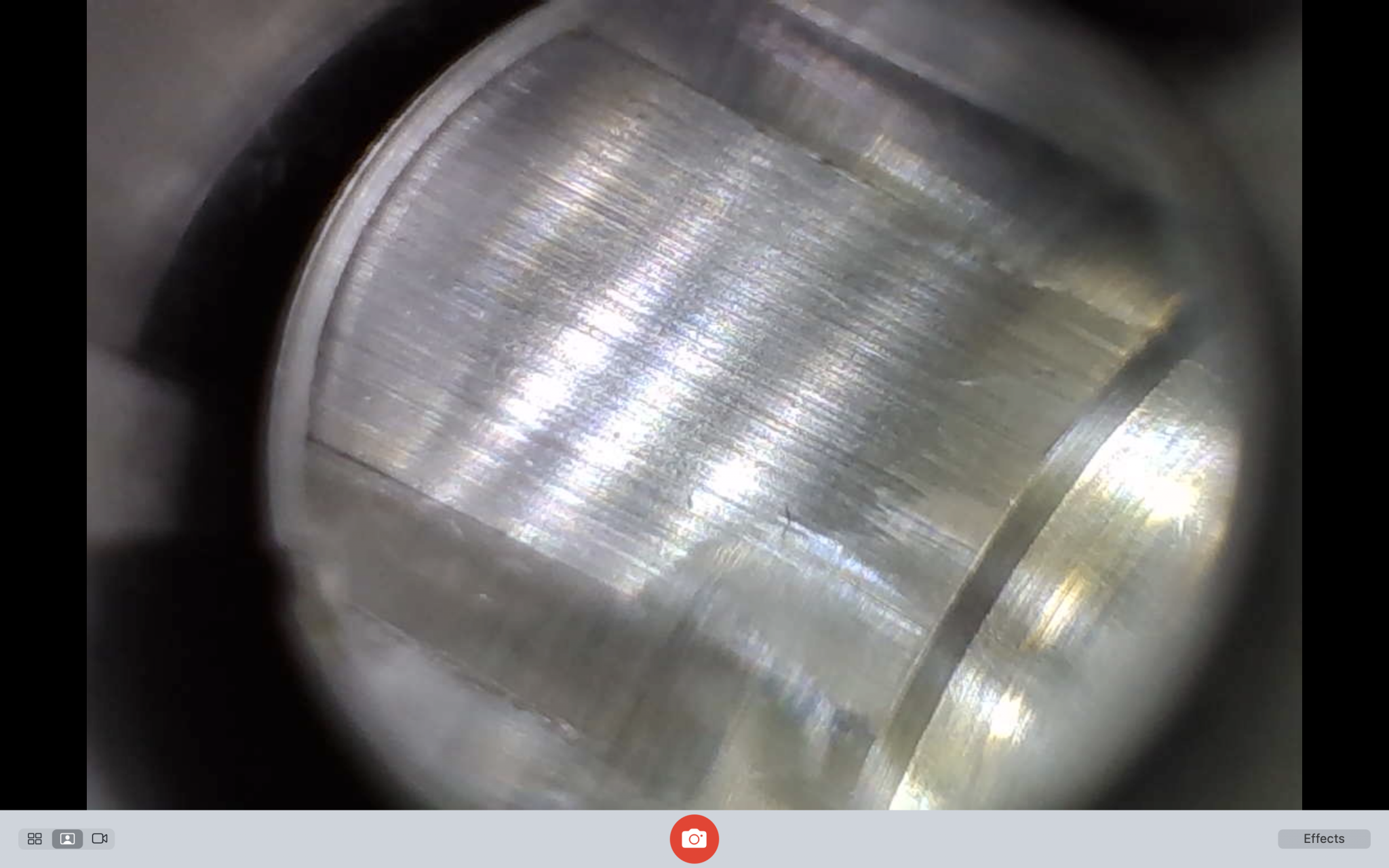

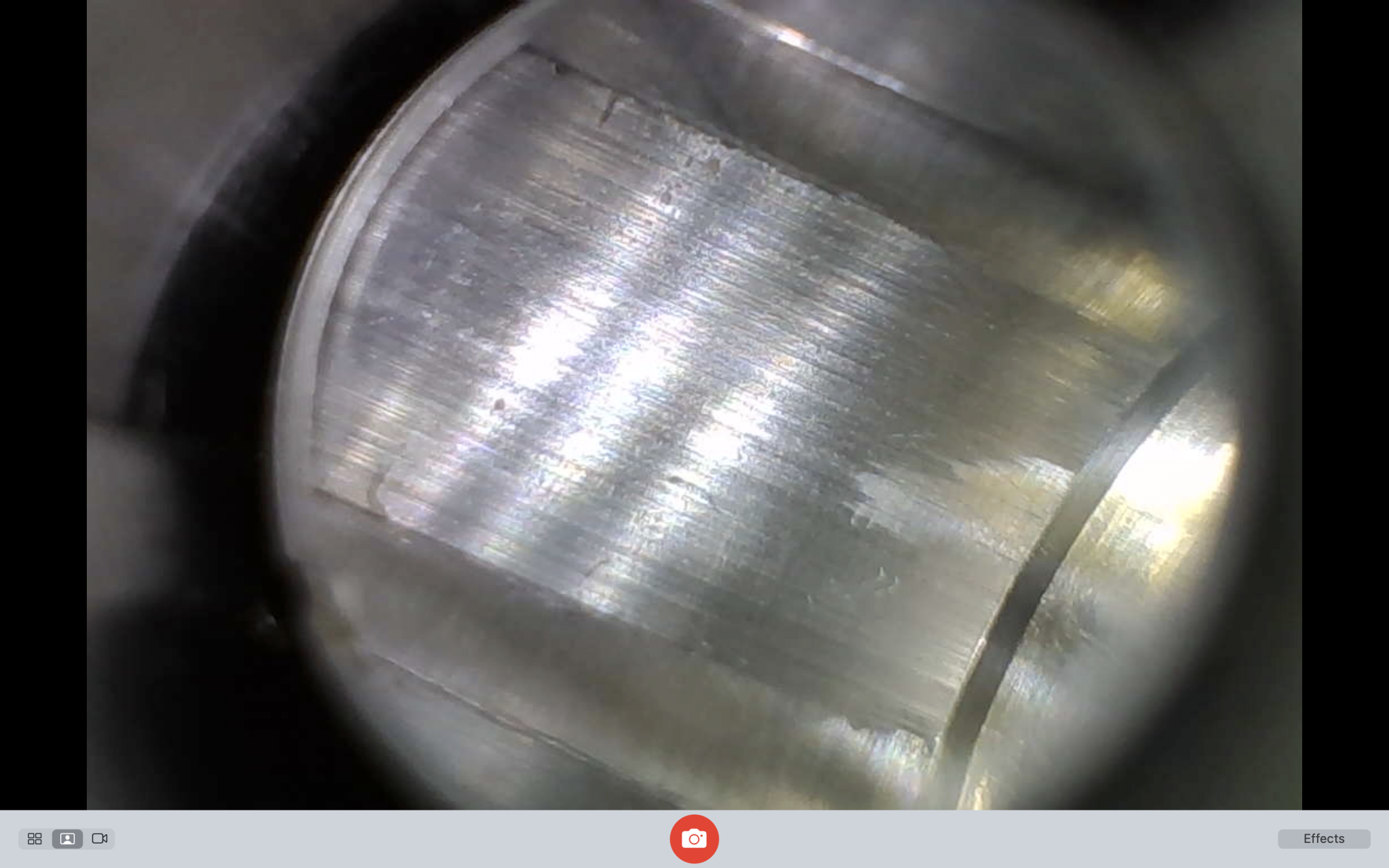

UPDATE: CLE sent the barrel back, and said that there’s nothing wrong with the barrel. In their defense, I was able to go through several bolts and finally found one that did headspace. However from my perspective there’s still a problem with the chamber as I don’t visually and functionally see any free bore. And I know what a free bore should look like.
Here’s the email replay from Conrad:
“I have inspected your barrel and it’s fine, your bolt headspaces fine and your free bore is fine. 77 grn Black Hills chambers fine with no marks on the bullet. The free bore is the same diameter as the bore and with tolerances between the bushing and bore and the bushing and reamer they usually don’t cut all the way around. One or two out of twenty might clean up, so pretty much every barrel that leaves here looks like yours, it only takes a couple of tenths difference in groove depth to not cut even. I would advise you install the barrel and have fun with it. Also, by the time it’s broken in, the throat will be even.

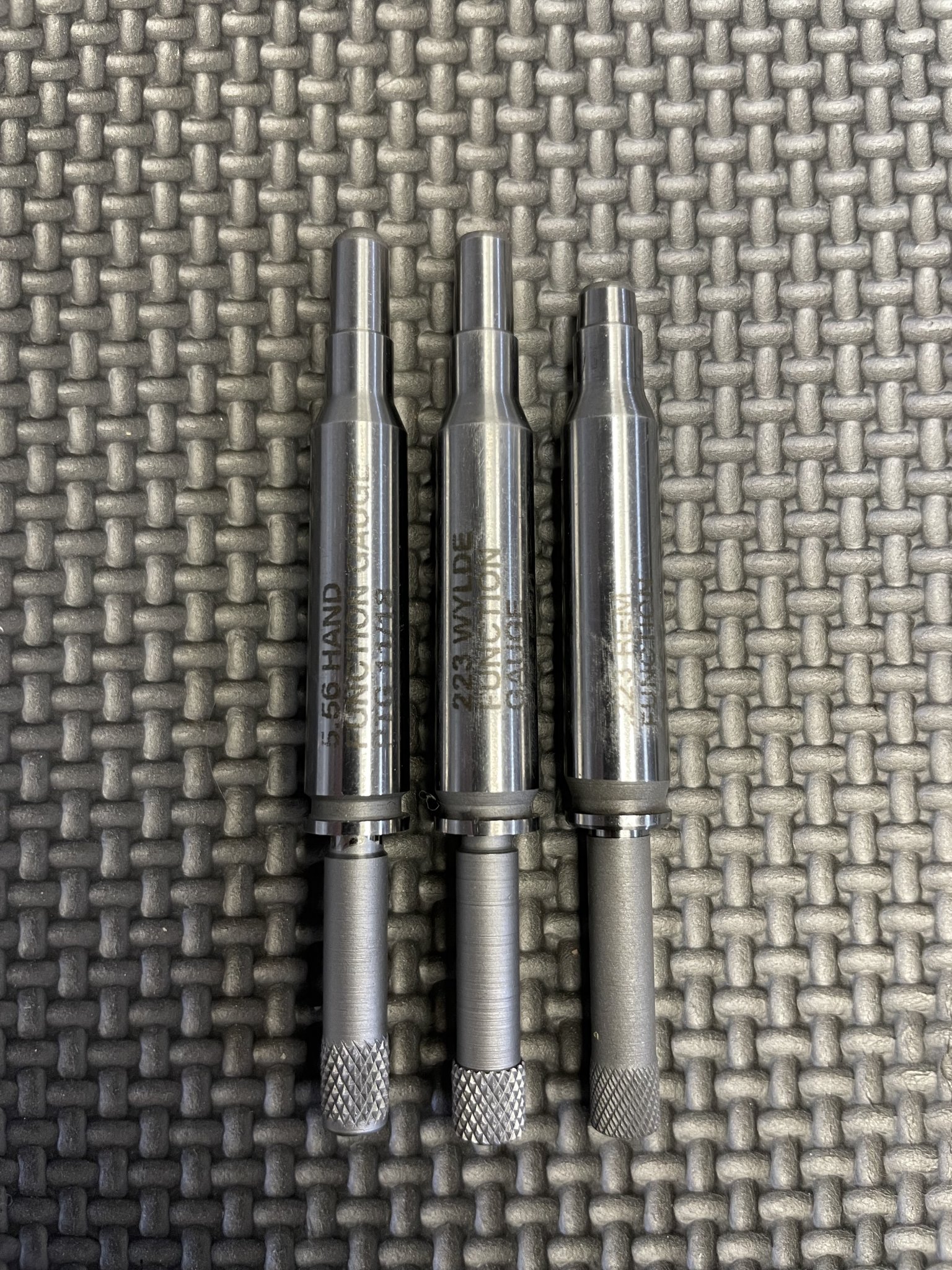

If there's a way to load a video on here, let me know as I took a video using the 5.56 NATO, .223 Wylde, and .223 chamber gauges in this barrel. I can always email the video to those that might be interested.
All of the function gauges stick with the .223 being less sticky and the 5.56 completely sticks. This is a fail in my world, as all of these gauges should free fall out of the barrel. A correctly cut .223 Wylde chamber should pass all 5.56 gauges.
I've attached a picture of the gauges used. Left to right: 5.56 NATO, .223 Wylde, .223 Rem.
If I’m missing something here, please chime in…
