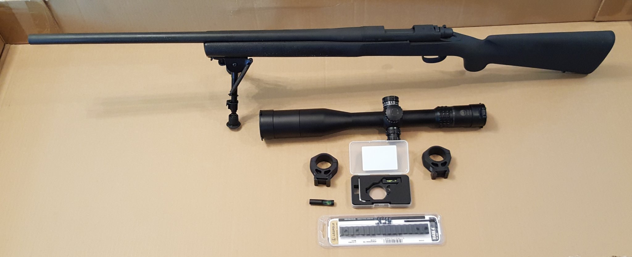

1. The Rifle
The rifle that I chose for this build-out is a Remington 700 heavy barrel, 26”. During my military career and while contracting, I employed the 24” version of the Remington 700. This particular gun fired wonderfully and I never had a single issue with this gun. During this same time I worked with several Marine snipers. I felt that their field craft and marksmanship were second to none. During one conversation, I was informed that the Marine snipers employed the 26” version of the Remington 700. sFor me, if the Marines were using the 26” barreled version of the Remington 700 then there was a reason for it and it became the gold standard for me. When I had opportunity, I purchased it.
2. The Scope
The scope that I selected is the Burris XTRII 4-20x50mm. While not specifically a “Mil” dot reticle in its truest, purest form, it still uses “Mil”dots with ½ mil markers/hash marks. For purpose of this series, the important point to be stressed is that the calculations that must be performed are still performed in the mind of the marksman and not inherent in the scope itself
3. The Scope Rings
The scope rings to be utilized are the XTR Burris signature rings (34mm), with customizable cants, which I won’t be utilizing. Since the scope is from Burris, I felt that the most appropriate rings to utilize would be Burris rings. For precision marksmanship I am not a fan of the 1-piece ring set. I believe in having two points of attachment as far apart from each other as possible. I have utilized 1-piece scope rings on weapons. They worked perfectly. For my own build-out, I prefer the old-school 2-piece scope rings.
4. Scope Mount​
For the scope mount I will be utilizing the Leupold Remington 700 1-piece rail with 20 MOA of cant. I’ve never used any cant in a long range precision marksmanship weapon. This will be a bit of an experiment. During the testing phase I’ll run some scenarios and see how the canted mount affects employment of the weapon itself.
5. Gun Level​
In the past I have only ever used one level and that on the scope itself. For this build out I am utilizing two levels – 1 level for the gun and one level for the scope. For the gun itself, I am using a simple level attached to the back of the 20moa Leupold scope mount. Attached to the scope will be a Tough Tactical Tools 34mm precision scope level. Is it necessary to utilize two levels? No. It is not. Is it necessary to even use 1 level. Nope. It is not. For years military snipers did not use levels, yet their ability to engage targets at extended ranges was superb. However, the addition of a level provides a measure of assurance regarding cant of the weapon that will surely have some productive results. In reality, the only point of the weapon that needs to be “leveled” is the scope. The barrel is symmetrical, so as long as the scope is “true” as tow when it was zero’d, it doesn’t matter what the gun (as long as it is still “trued” to the scope) is doing. With this being the case, why, one might ask am I going to employ a “gun” (scope mounted) level? Simply because, “Why not?” I think it will just be a bit of fun to have it on there and see how it all works out.
In actuality, the scope mounted level should (and it’s a very big should) ensure that the gun itself is level when I level the scope to it. With humans being fallible and there being a certain measure or tolerance in the construction of the weapon and the scope mount base itself, there will always be imperfections. So the result is… and will be… subjective. But.. it will still be fun!

THE BUILD-OUT
1. The Rifle
