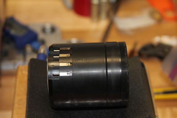

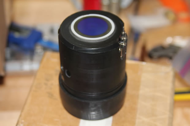

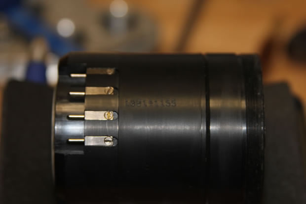

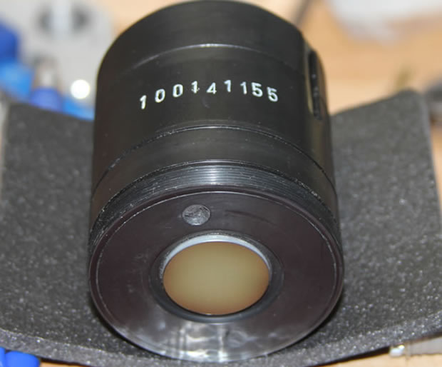

    Ok,
    So I procured an intensifier labeled "L3 MC-11620UV NOS" (written on a box in pencil) with no other identifying information. A serial number appears to be on it: 100141155
    The tube looks like it may have been installed, but given what any 25mm tube looks like... I'd have a hard time telling how used this tube is. (Never seen a pristine one is my point.)
    Pictures are now attached to the thread!
    It's eventual home will probably be an AN/PVS-4a

    Re: "L3 MX-11620UV NOS" 25mm Gen 3 Question (pics)
    It is definably a 25mm Gen 3. It also can be a Gen 3+1 which will give you problems using it in a PVS-4 (focal lengths are different). Tube is most likely 10 or more years old. Not enough info on the tube for me to tell you much more.
    If it will focus in your PVS-4 you will have a nice scope. If it does not you will have to look for something like a Star-Tron 428 to use it as a long range viewer. My bet is a Drop in Gen 3 for a PVS-4. The Gen 3+1 hybrid looks just like it but was not designed for use in a PVS-4.
    Yes it does. I've sent you through the data sheet in a PM. It's a pretty advanced tube, but it's not autogated. It won't handle very bright situations well.
    It will not be a 3+1. The FO plate is clearly evident in the images. That is certainly a 11620. These are somewhere between Gen2 and Gen3 in performance, but are excellent tubes and perform well. The resolution is low, but the large diameter makes up for it.
