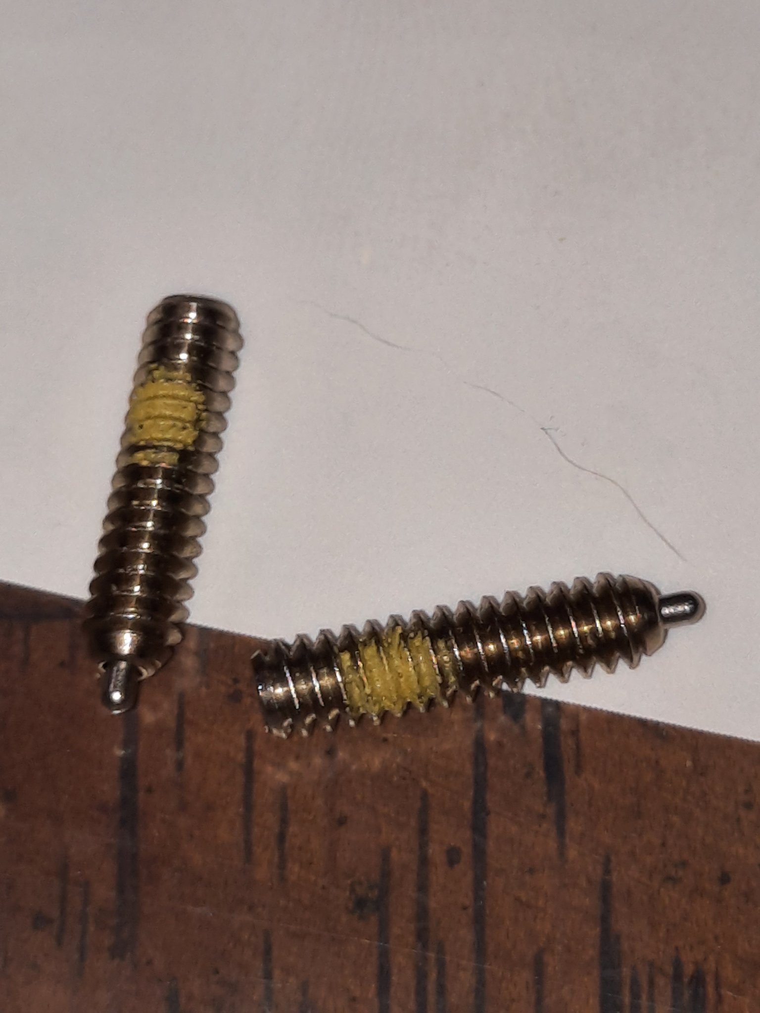

Below is what they look like in real life. These #6-32s are used to reduce the trigger pull on the Bergara B14R trigger. It was the only way to lower the
pull since the trigger is sealed unit with 7 rivets.

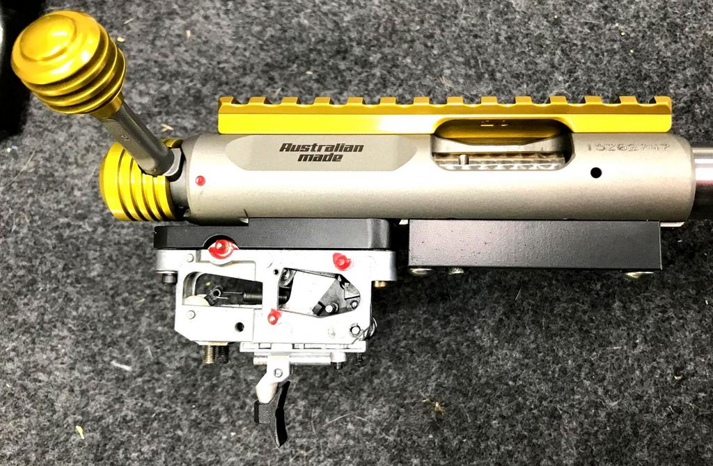

Shawn's advice is sound. The only thing I would add is make sure you use a good quality correctly fitting bit when removing that screw. More than one has been destroyed by ham fisted owners down here. Both mine were very tight to crack. I used 2.00 NM torque and purple to re-fit. The LA101 trigger will go reliably to approx. 16 ozs. and later models seem to have a cleaner break than rifles built prior to 2015. One of mine is fitted with a sear adjustment screw to virtually eliminate creep and the other only required spring changes to finish up with a decent trigger. I've posted some detailed information re these triggers on RFC. I have a clever friend who has an Anschutz 5018 in his so anything is possible if you have the skills and equipment!!!

Does this happen to be your friends LA101? In any case, it's a pretty gun !!
It looks like this one has been converted to a single shot as well.

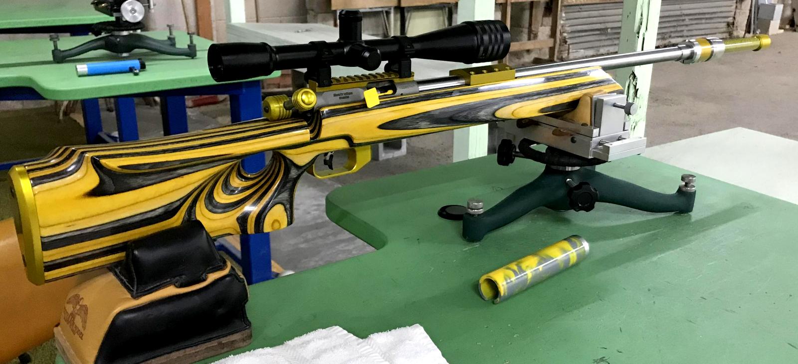

Yes it is. It belongs to my friend Jason Lowe who makes some innovative accessories for many brands of rifle. Jason and I go back a fair way and both enjoy "upgrading" bolt action 22's by any manufacturer that we think makes an action worthy of a few improvements.
That rifle features a Lilja 4 groove tight bore, barrel bedding block, installed into a custom stock, 5018 trigger modification & single shot loading tray.
I own my share of so called high end Euro & USA built rim fires.
I had a full custom done on one LA101 by an experienced rim fire smith - Match chambered premium barrel, bedded, trigger work etc which came in at approx. 60% of the cost of a Vudoo landed in Australia. The second rifle pictured is my "pretty" LA101 bedded into a walnut stock - Only mods to this one are a re-crown and trigger work. This rifle runs flawlessly and accuracy is on a par with my 1710 DHB's with selected lots of Lapua.
I'm currently running 14 "quality" rim fires. The laminated LA101 will function with the best of them and with matched ammo, nothing I currently have will consistently outshoot it.

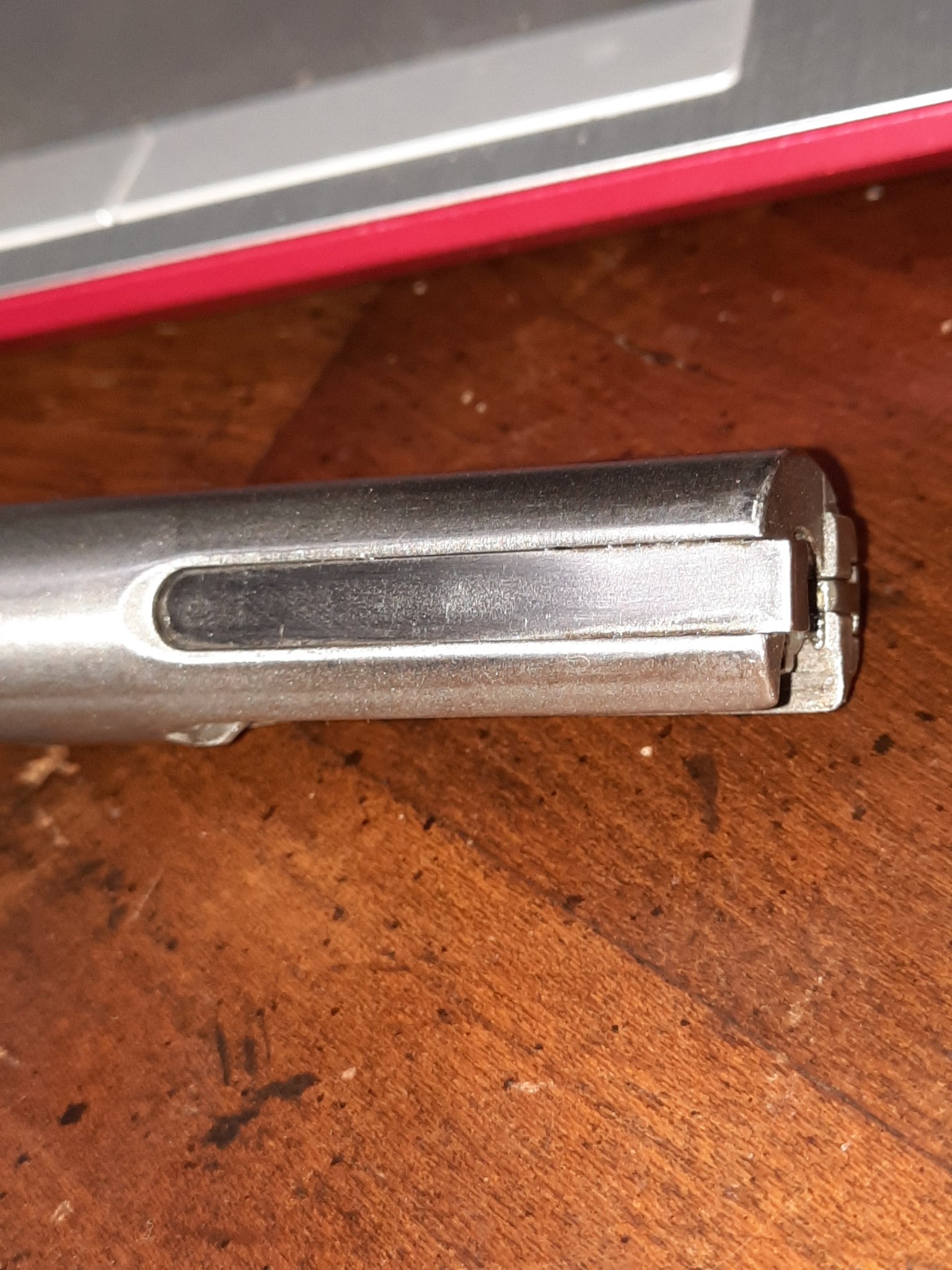

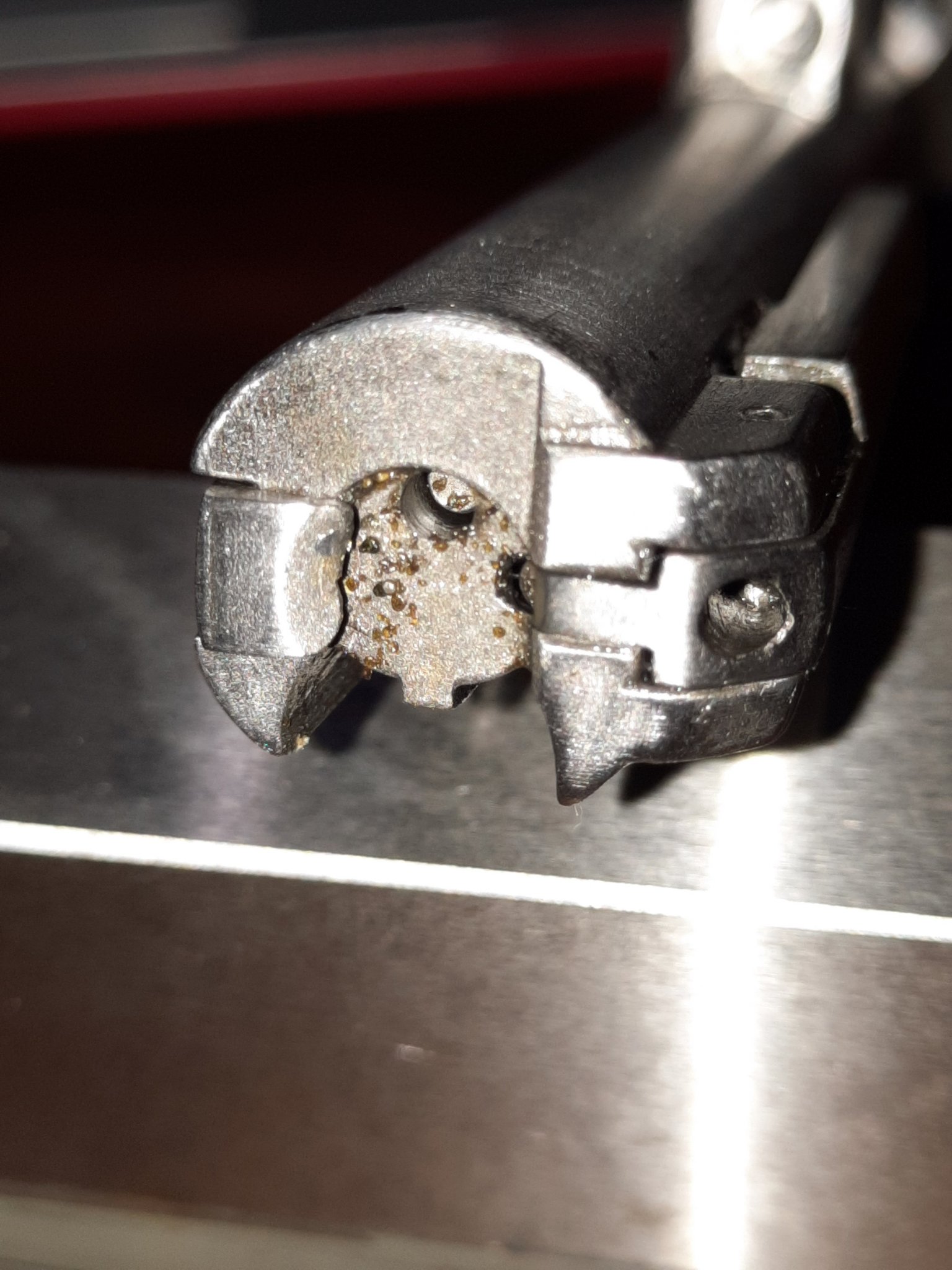

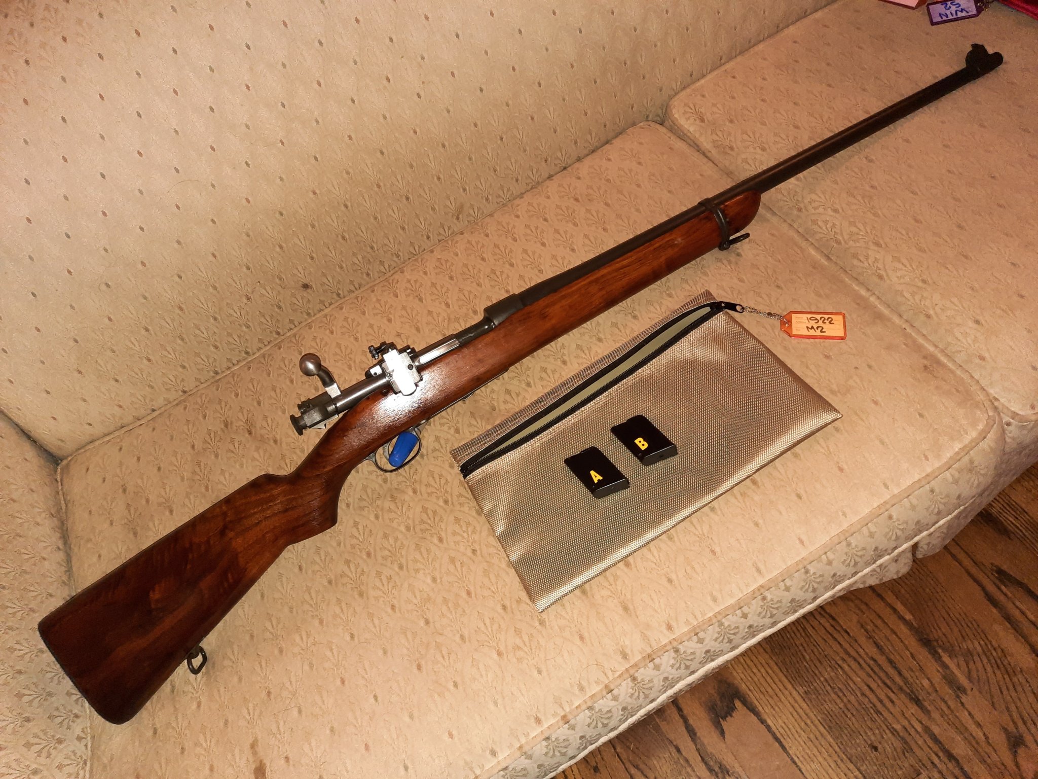

I think that is nuts.... I use my Springfield 1922 mk2 extractor as an example. It will pull any cartridge out of the chamber.
They paid attention to the extractor when they designed it. It has a lot of cartridge overlap, crisp hooks and a heavy leaf spring
design and follows the contour of the case wall. I even put a cartridge in it and bent it over until the case bottom tore off.
The B14R has an extractor clearance slot of about .180". The extractor is only .060" thick. A smith could easily stack two factory
extractors and mill the existing extractor slot to .125". The slot and extractor would still clear by around .028" top and bottom.

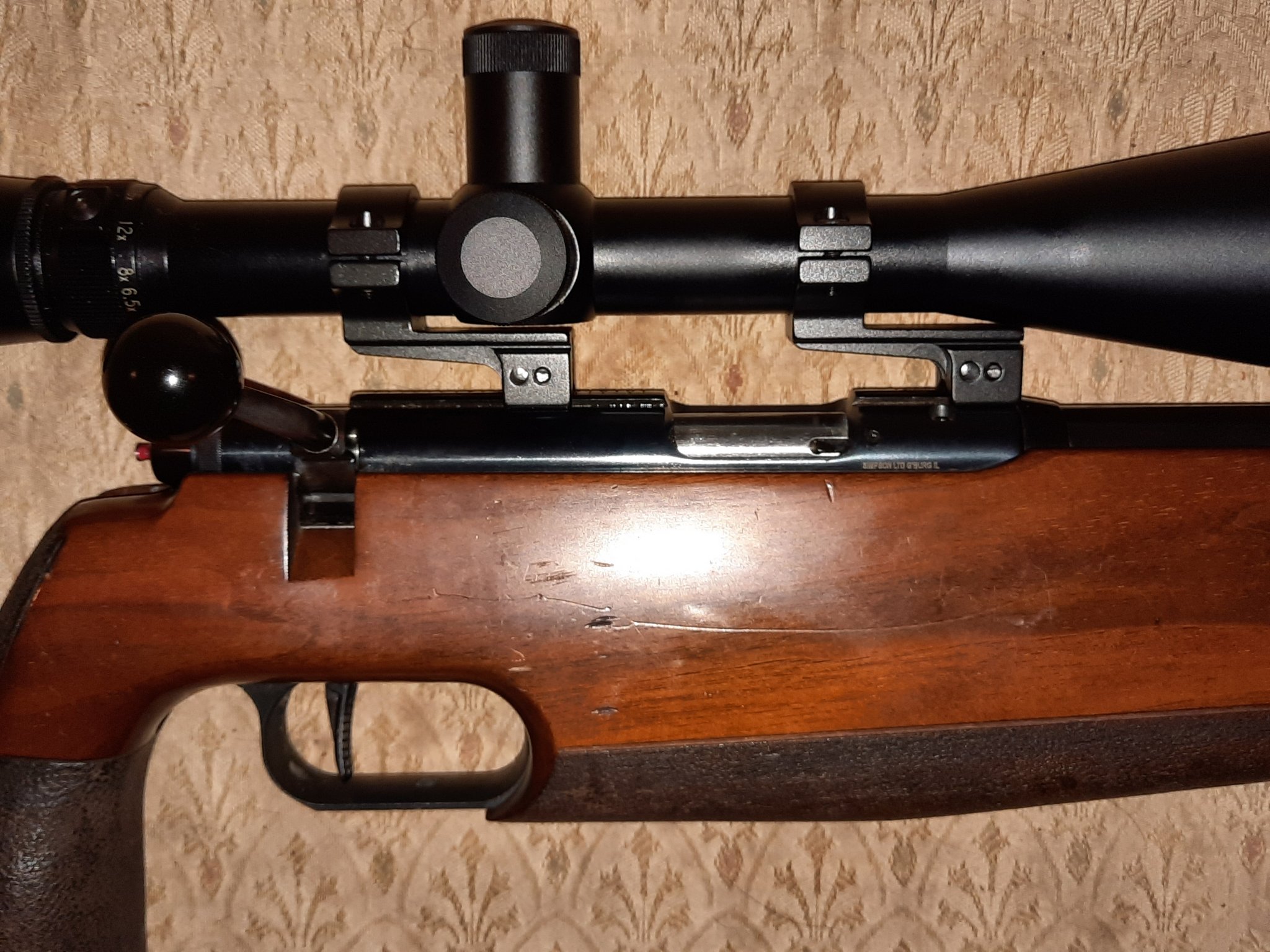

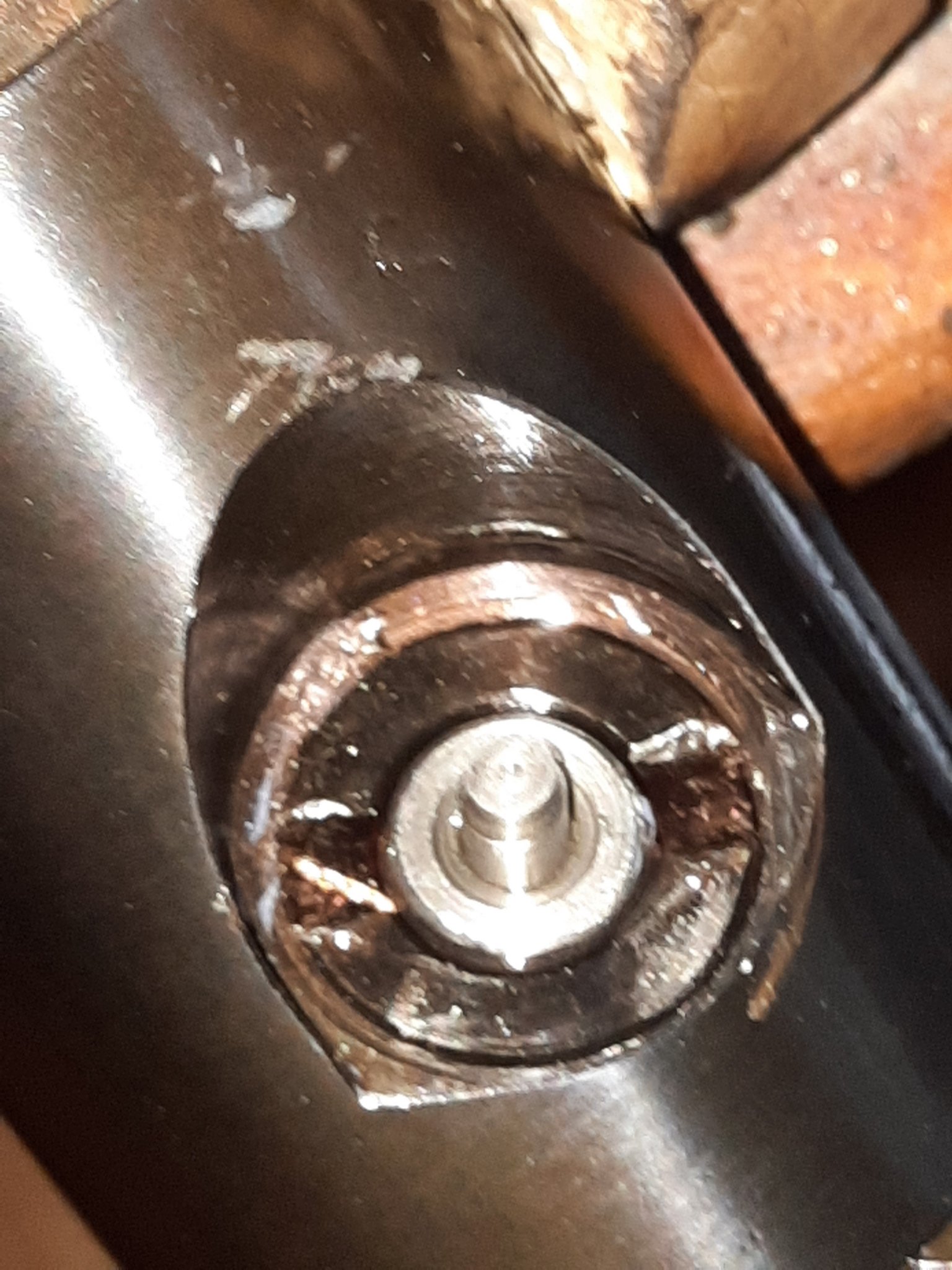

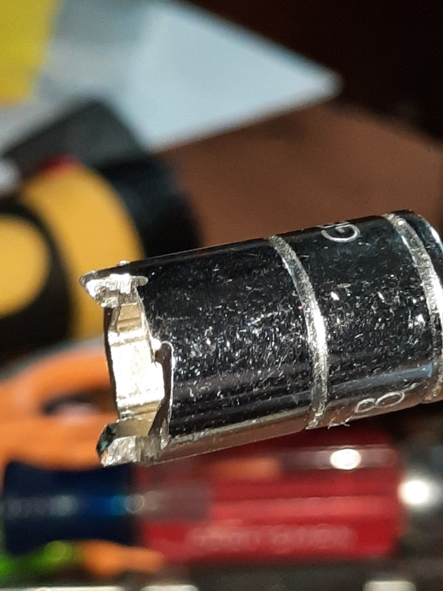

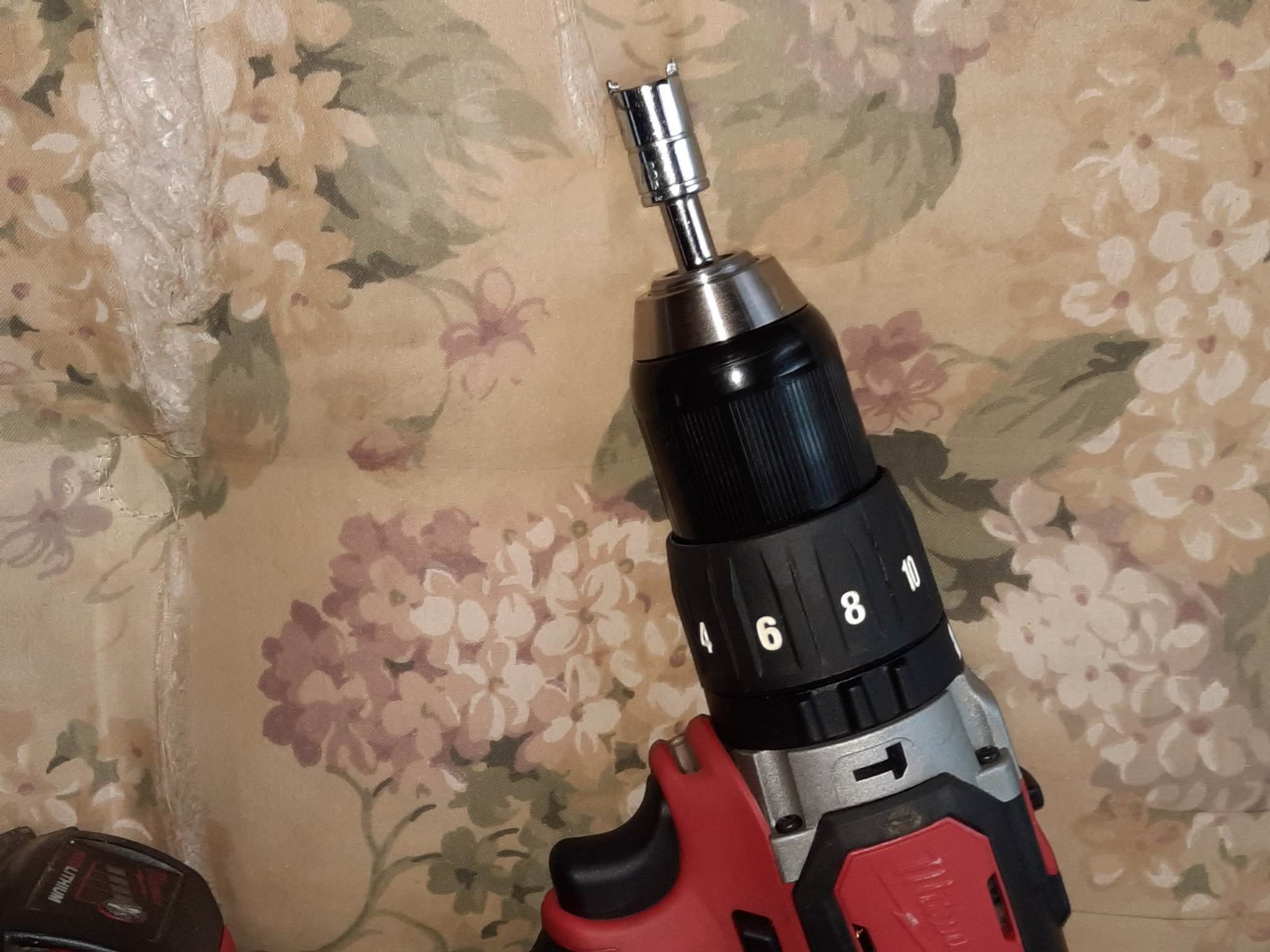

I happen to have a fastener now that won't come out. It is an M16 and about 8mm long. I altered a hardened socket
for its' slot drive. That won't get it out. Then I put it in my 18 volt hammer drill and still had no success. The applied heat
was too hot to touch even 2.5 inches from the fastener. NO good. I have done that at least three times and have also soaked
the area in Kroil on both sides. It isn't pinned, staked or held in place in any way either by the factory or by any of its owners.
Honestly, it seems ridiculous that it hasn't succumb to will by now. Grrrrr...... But it will. ;-)
Rather than risk damage to the bluing, my next step is to use a 2.5mm end mill to split the nut and make a "C" shape
to allow for a few thousandths of flex / collapse before it inner diameter contacts the piece that is holding in place. I can
buy a new nut for about 5 EUR or tap the 2.5mm I created to accept an M3 set screw to keep it from collapsing. Kind of like
a rotary wedge.

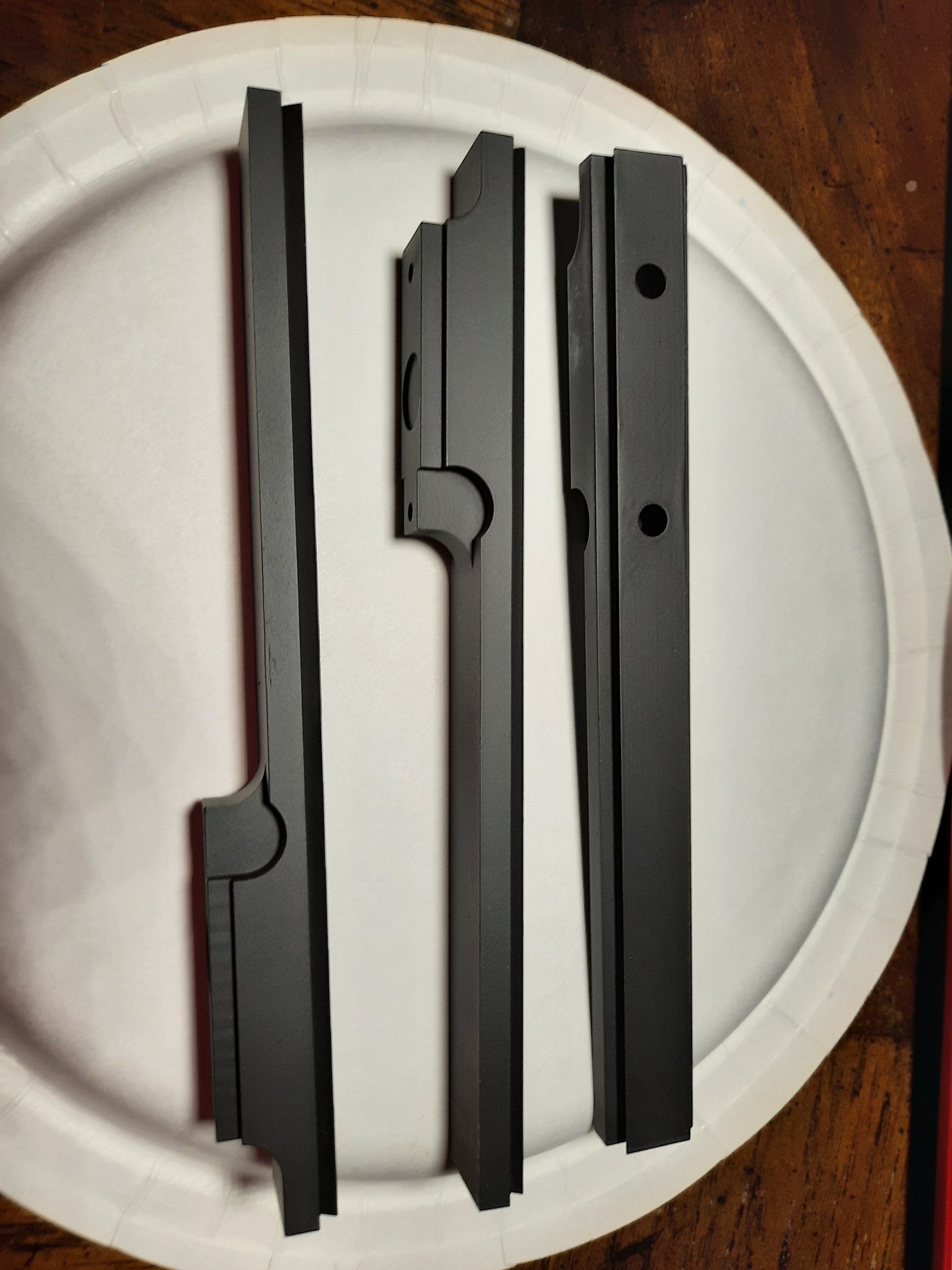

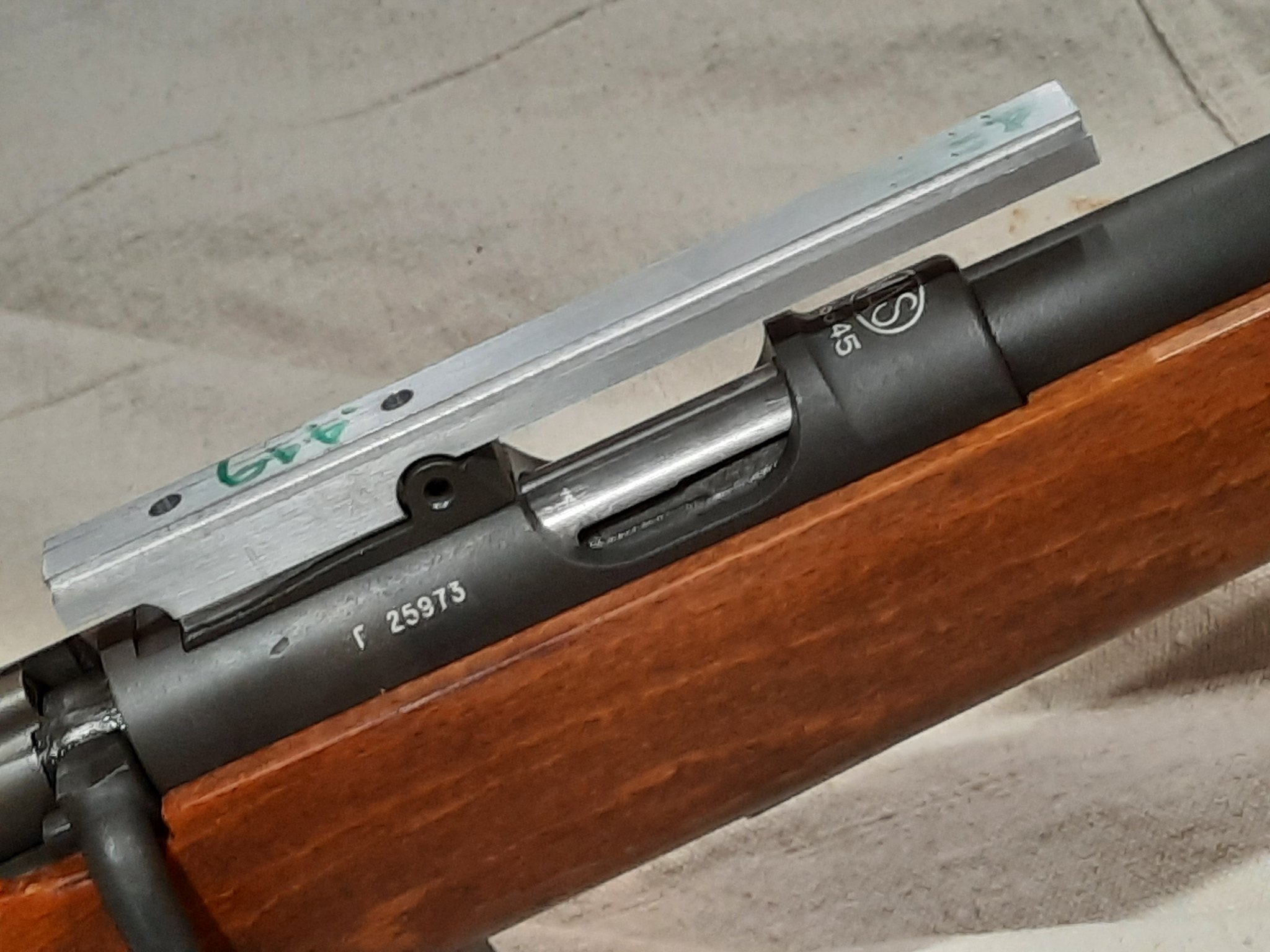

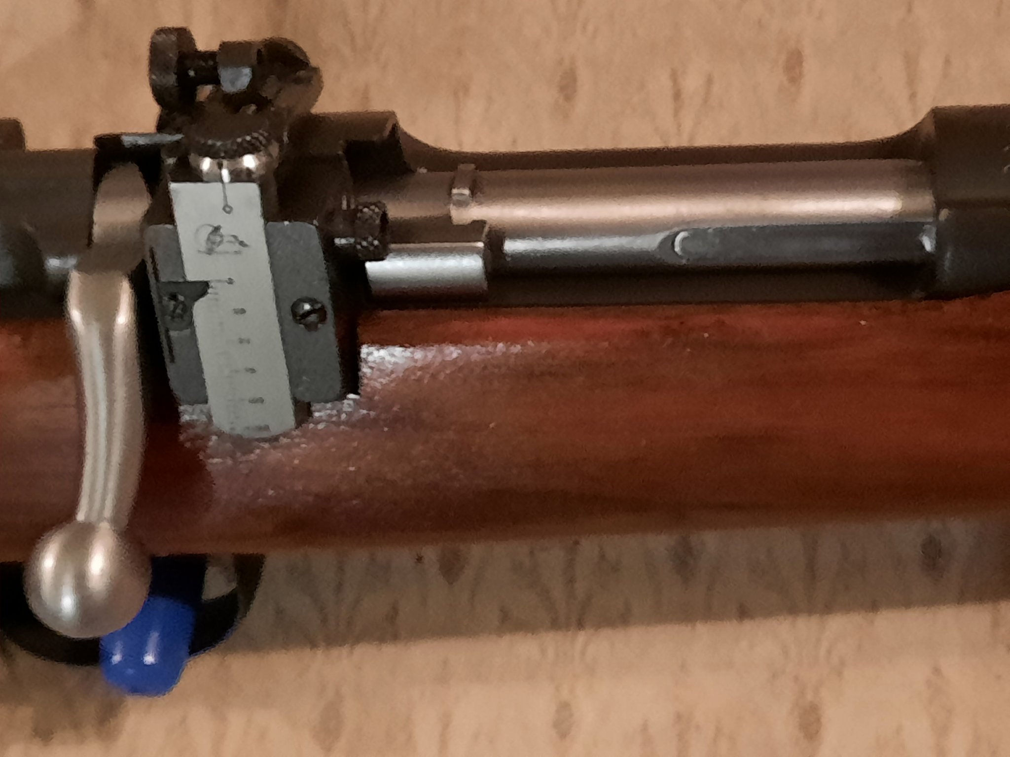

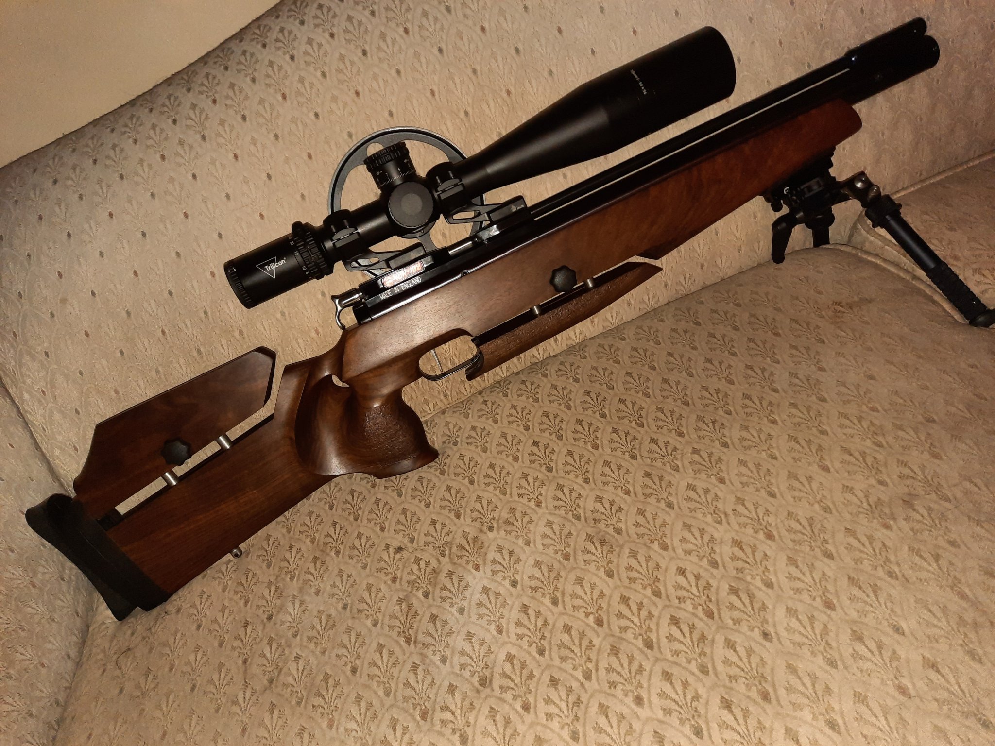

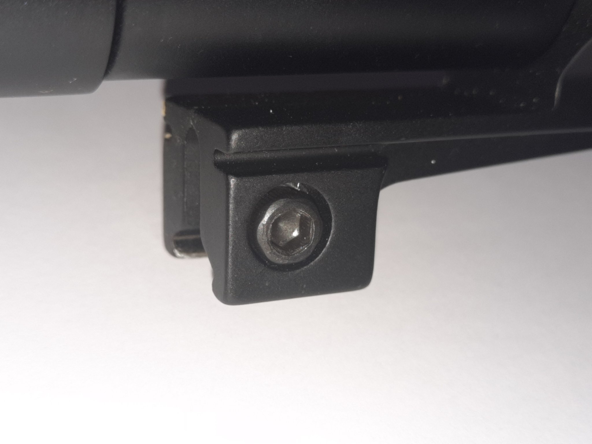

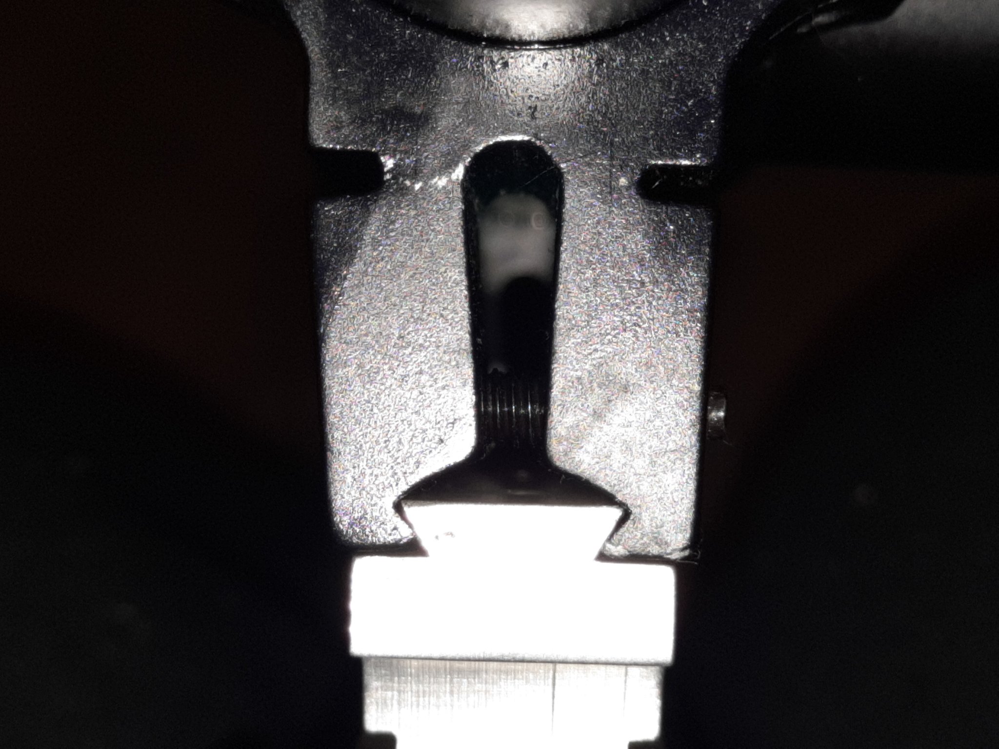

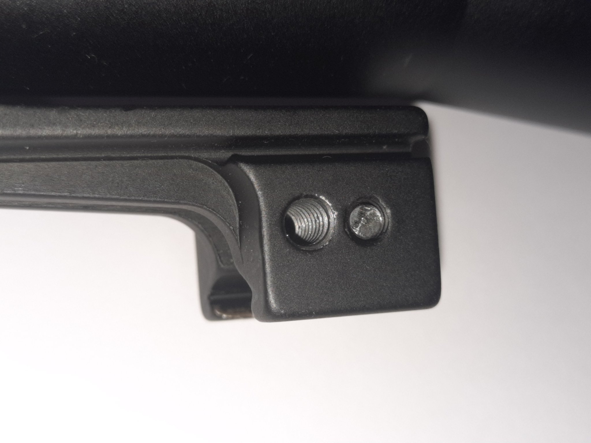

Look at images #4,5 and 6. They show a scope mount with a really cool feature. Dove tail mounts seem to various widths.
This particular brand has the normal screw to collapse and clamp onto the dove tail but it also has a tapped hole on one side only.
That allows you to install a screw into the mount and temporarily increase it's width. They are under $20.00 I believe.
I had a guy make me some no smith mounts for the French MAS 45. He made me a prototype and made the dove tail too narrow.
I was still able and willing to sacrifice the BKL mount to test the rest of the mount. Note the very tall slot and the side slots to
allow for flexure. Image #8 In that image, over the flat dove tail you will see some angles. Those are to clear receivers that have
a radii on them like an Anschutz. Most guns actually.....
The last photo is of his finished product. You removed the rear sight and installed the mount using the existing tapped holes.
I made those mounts because I was unwilling to drill holes in my action. I'm working on another cool mount for my Springfield

It's from a Walther LGR air rifle and all it does is hold back some air pressure that was developed from a single pump of the
side lever. It's a low power, Olympic 10 meter gun.
Sorry I got off track.... BKL has a lot of useful mounts and adapters for rimfire and air guns.

I stick to making alloy bolt shrouds, knobs and all sizes of pic-rails for the LA101 rather than trigger upgrades.
Do you have a link for any of the parts you make? Any chance you might make a few triggers?
Im in Australia. Yes i have an export permit, not sure if thats what you want.
Parts are in red. Also extended mag latch. Notice the trigger shoe is much wider on this one.
We DONT make the triggers or mag latches any more. We do however make rails in left and right, from zero to 60moa.
