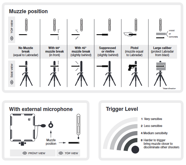

I am using the JKL trigger but I am getting quite a few acquisition errors and low velocity readings. I have the unit pointed at the target. Does the barrel have to be lined up with the unit of not? Other shooters at the range say they don't and the unit works fine with the external trigger. I have it set on trigger mode and tried different sensitivity settings. Any suggestions?
Do you have a sight? Sounds like potential alignment issue?
Silenced, bare or muzzle brake?
Where is your muzzle in relation to the radar?
But yes. If you want to get accurate readings of the bullet as it moves away from the radar you will want to have it aligned so the bullet is moving away from the radar and not across is. That should be obvious.

Bare. Had 2 different rifles both chambered in 222 rem. One bull barrel one sporter. Rifles lined up with the middle of the unit. Got no reading with the bull barrel all acquisition errors. 75% readings with the sporter barrel. Do the muzzle s have to be even with the unit of not. Other shooters said no and there unit works with the external trigger.
First I would skip the trigger and figure out how to work the radar.
Leave the trigger away until you actually have a reason to use it. Otherwise you’re just having false alarms the entire time. Can’t read a shot if it’s telling you it came prematurely at the triggers false alarm.
Put the muzzle even with the radar. The blast will set it off.
With a muzzle brake you want it ahead of the radar to limit the excessive blast and if you have a silencer then you want it behind the radar to catch more of the limited blast.

Shooting on a crowded range is a major factor in LabRadar setup, especially with a light caliber like .222, Especially if the .222 is long-barreled and unbraked. Then an inertia trigger is almost a necessity.
I'm fortunate to shoot on a range which I often have to myself... with a 28" braked .223, I still need trigger level 1 with the unit just forward of the rifle's bolt. With .22LR, I use the external-microphone trigger - which is useless if anyone anyone else is on the range with anything other than .22s due to false triggers.
And yes, you absolutely have to carefully aim the unit. After four years' use, I can get near-100% success aiming with just the V-notch. But a sight, even a length of soda straw, is helpful to many people. You also want the offset value set correctly - the lateral distance from the rifle to the unit. Mine is set at 6" as the LR is always set 6" from the side of the rifle.

Thanks for your help. I ordered a sight should help with aiming. Next time I go out I'll use a larger caliber and see how it goes.

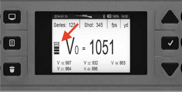

I do get a trigger every time acquisition error, low velocity reading, or a normal velocity. When I tap the trigger it does work. I use a magnetic mount by the action of or on the barrel. No clutter around.
As mentioned, .222 is a light recoil rifle. Are you actually getting a trigger on the LR with each shot and just no MV recorded, or is it not even triggering the LR? If it's not triggering, does it trigger every time you tap the recoil trigger with your finger? If not, the trigger may be faulty. How are you attaching the trigger to the rifle? With a light recoil, the provided velcro may absorb enough of a light recoil to keep it from triggering. I hot-glued a magnet to the back of my trigger for a much more solid connection to the rifle so it picks up the recoil more consistently.
Also, another thing to consider - I have several ranges, and the 100 yard range at the house is only a narrow strip cut through a heavily wooded area. It's just wide enough to run a 6' Bush Hog down it. With .223 bullets, the unit has a hard time picking up the little bullets because of the radar clutter returns from all the trees. It does ok with 6.5 and larger bullets on this range, but not .223 (even 88 and 90gr ones). It will pick these up fine, however, when I move out in the open to my big range. Make sure you don't have a lot of downrange clutter that might make it difficult for the radar to see your little bullet.
Sounds like the unit is not aimed precisely. Check the return-signal-strength bars on the right side of display. If you are seeing one or even two bars, subsequent acquisition errors are kinda likely. (Photo screen-capped from manual) 1693762689366.png
