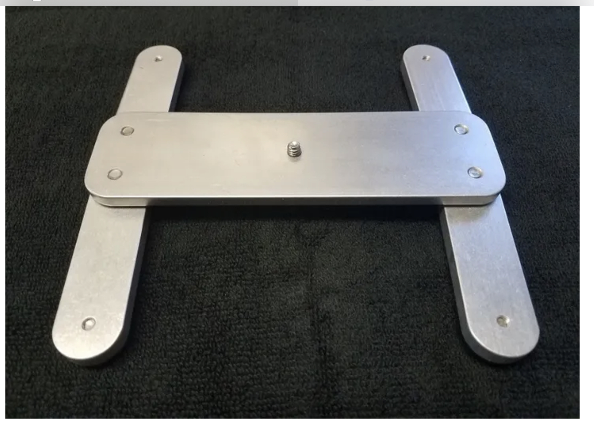

The quad pod base that LabRadar sells directly, allows precise aiming position, usable on the bench or ground or above for nasty brakes with conduit.
GreyOps arca base.
Piet recoil trigger, the new one has a magnet which makes attaching it even more flexible.
MK Machining sight or pic rail.
Hot gluing a roll pin or piece of tubing works as well, but may as well go all in.
Just ordered the Grey Ops Arca, thanks for the tip!
The Arko mount is nice too.

We run the 4 leg arko base linked above as well as an inertia trigger.
Zero need to finely tweak the aiming or microphones. Put it around the muzzle and point at target. The trigger works perfect and almost never misses a shot.
At times you will bump the rifle and get a reading that’s always much slower than the bullet velocity. You just delete that and keep going.

Quad pod is better for bench use than their Bench and tripod all purpose mount? Thanks!
We have the bench plate and their tripod.
This stand is far better than either. And if we need it mounted in any other way, we use the RRS 24L tripod.
The arko works well if shooting from a bench and the target is at the same height.
Unless you add a small ballhead to it your aiming is limited to left-right only. It's a niche item.
(The one exception on vertical aiming is if prone on soft ground and using their spikes, but hardly precise.)
If buying ONE mount (or your first), the Quad pod is the most flexible.
Its main forte is with legs sectioned from PVC conduit and used to position the radar above nasty brakes.
It also works great from the bench or next to you prone. Unlike the arko it can be aimed when shooting uphill or downhill.
Reactions: XTREM HTR16
Ah yeah, inexpensive ball head is what I use on my Arkco …don’t see a problem w that personally.
