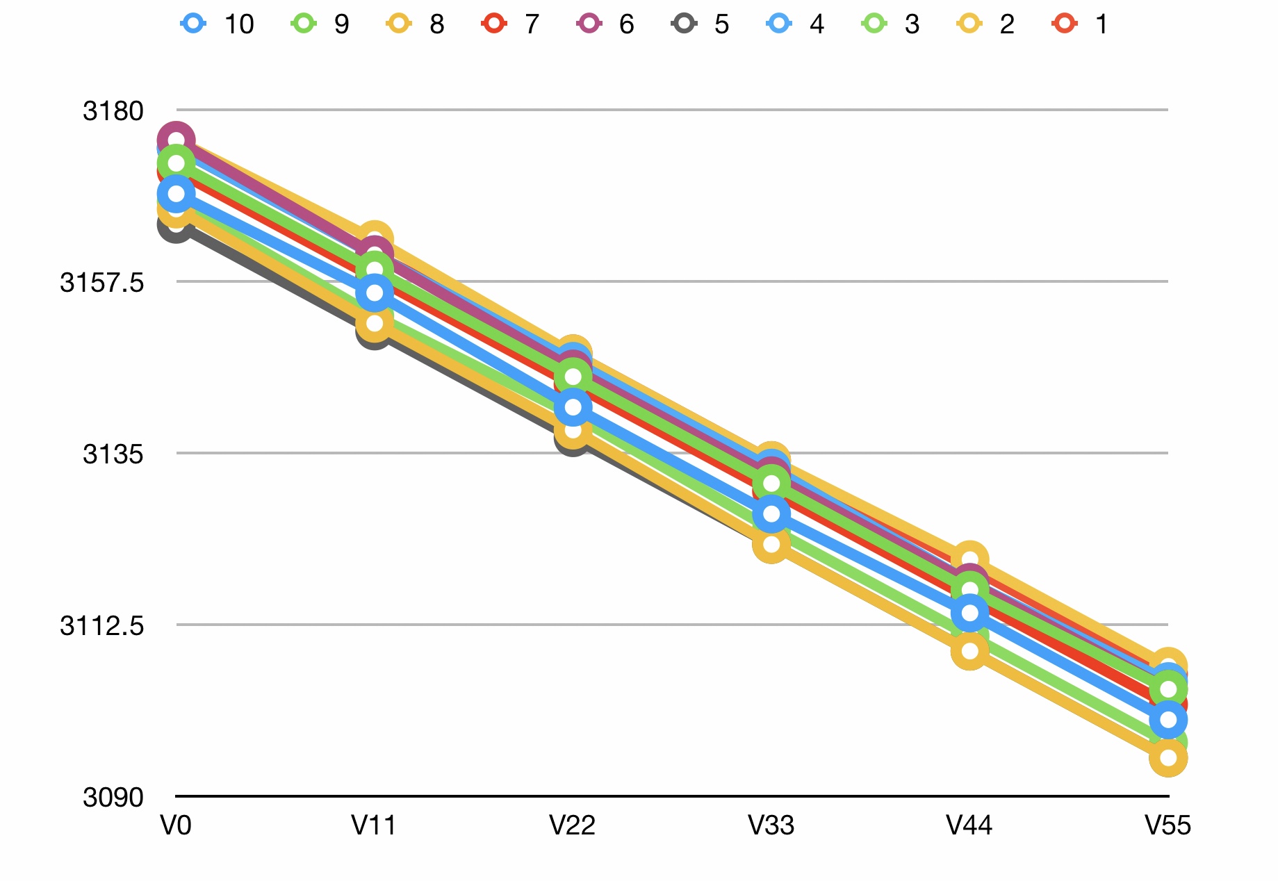

The Lab Radar is consistent enough to expose variable BC issues. I captured the multi-range plots and the rogue shots were always out of the group low.

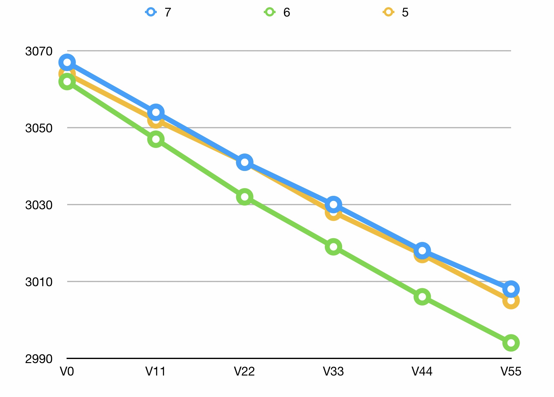

Here’s what a 10-shot string looks like using a different load.
