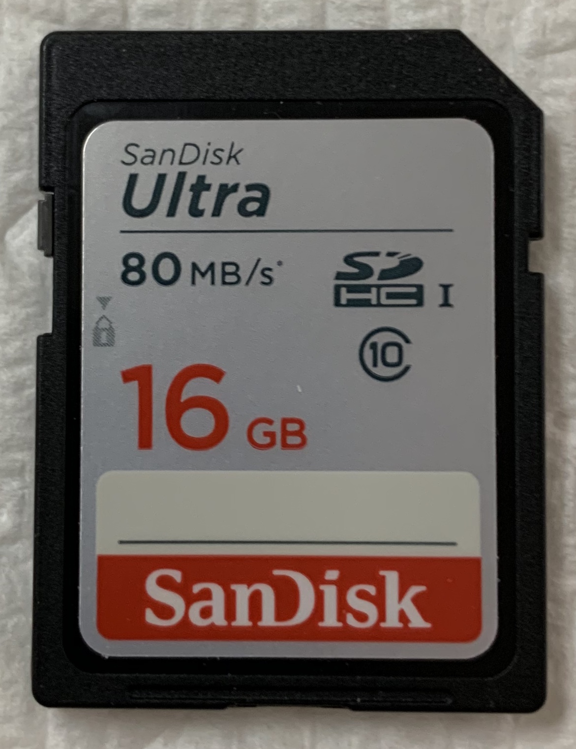

I’ve been using this card since I got my Labradar with zero issues.

this is the card I use. Works fine. https://www.amazon.com/SanDisk-Ultr...&psc=1&ref_=ppx_yo_mob_b_track_package_o0_img

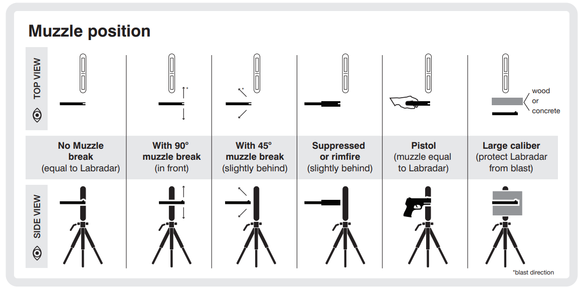

If you are shooting on anything but a wide-open-for-at-least-100-yards range, including 15-20 degrees off line of fire axis, and are getting a lot of missed shots, try the low-power setting.
@sgtsmmiii I almost always shoot suppressed. I set it to level 1 trigger, put the device about 6" in front and 4" to the side of the muzzle, set it to 6" offset, and I rarely have problems with pickup. I miss maybe 5 in 100 shots, and generally those are because I've bumped the aim of the device at some point. I've heard, like others have said, anything but wide open shots can cause problems... Like shooting down a tunnel or the like.
I have bigger problems with muzzle brakes than anything, but they're not terrible, and never my rifles!
Reactions: sgtsmmiii

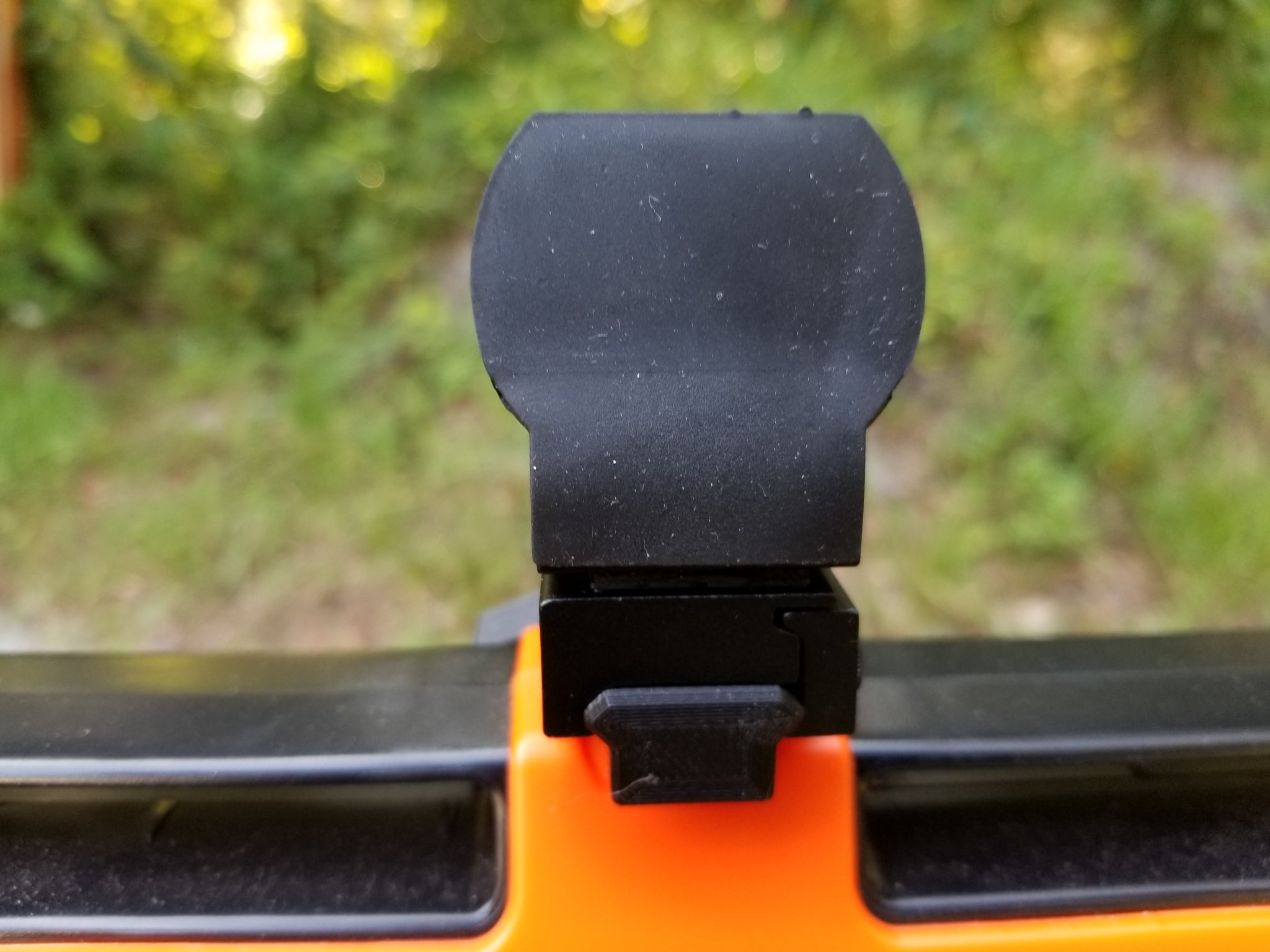

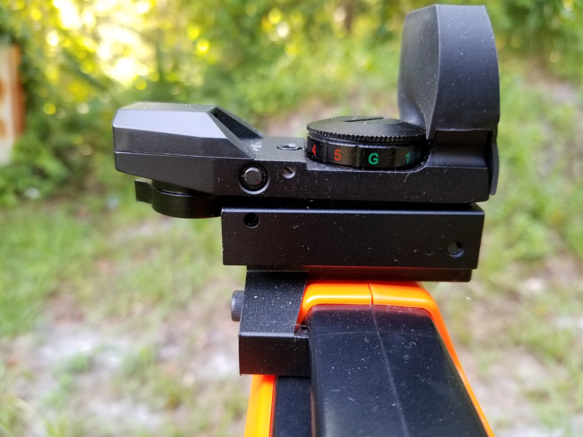

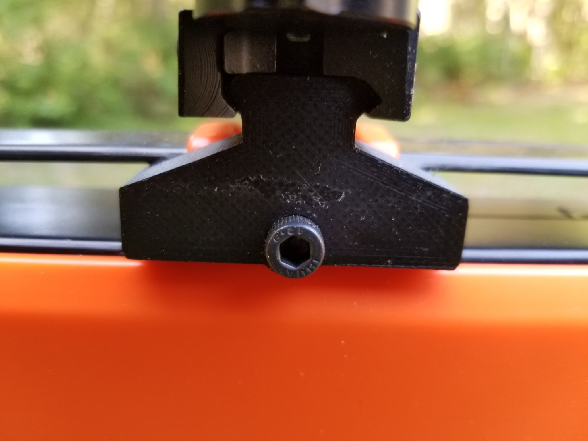

I set mine up with a cheap reflex red/green dot. co-witnessed with a large plastic speed square, makes aiming a piece of cake. I could of just used the speed square, but things move around sometimes and the dot sight makes it easy to check and adjust as necessary.
Interesting. Would love to see a pic of it if you get a chance.
Reactions: ACard
