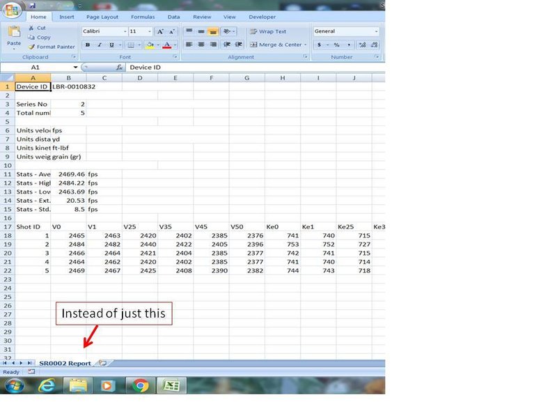

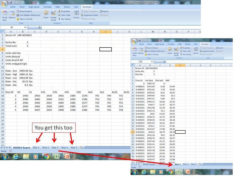

There was some confusion on another forum on what the macro does.. see pics below.

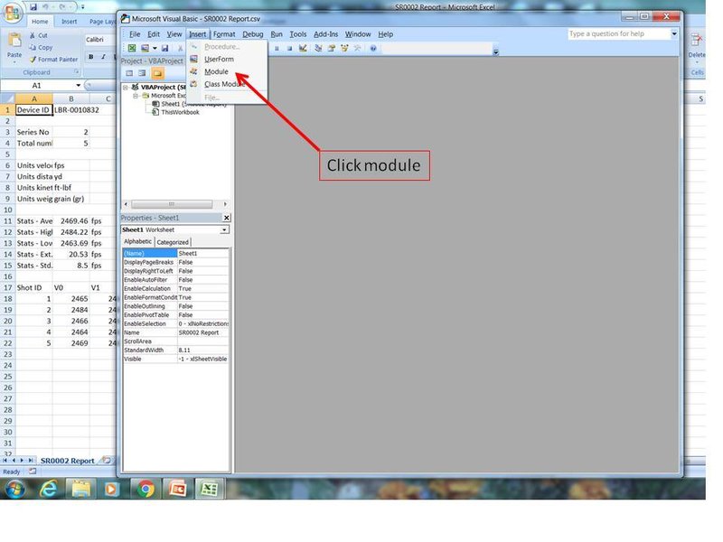

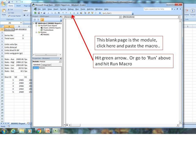

You have to have Excel loaded on your computer I believe.. not sure if it will work with Excel Online.
1. Copy from 'Sub combine_it()' all the way to 'End Sub'..
2. Open one of the Labradar output files (the one that looks like the first pic above, with the Average data in it)
3. Hit ALT+F11 (or Function+Alt+F11 if you don’t have dedicated function keys like on a laptop) to bring up the visual basic editor.
- if something else other than a window that says 'Microsoft Visual Basic' in the upper left comes up you might have hit the wrong buttons, or you don't have excel. See pic
4. On the menu bar at the top, go to ‘Insert’ and hit ‘Module’. see pic..
5. Paste what you copied into the module, the big blank space on the right.
6. Hit the green ‘play’ arrow in the toolbar, click that and it should Run. Or you can go to Run on the toolbar and hit ‘Run Sub’. See pic
- don't click outside the module before you hit run, or it won't run... just paste the module.. and click the arrow..
