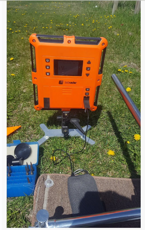

    So what about them guys falling over? I've read about how they can be like a kite in the field and fall over. What are you guys running for bases on the bench as well as in the field prone?
    There’s a guy on the accurate forum making a base that looks promising, he also sells spike feet for it. I have no experience with it just saw it and thinkin about buying it. It’s posted under reloading equipment. Here’s a pic from that thread.
    The units optional base works just fine. A simple sandbag on the base with anchor it just fine if you think it's in danger of falling over from wind.
    The tri-pod I linked earlier is very stable. I remove the center column and attach it to the ball-head. Legs on the tripod will go rather close to horizontal, so the unit stays very low to the surface it's sitting on, and the legs are prob 1' long without being extended. If that isn't enough, a sandbag on one of the legs and it's going no-where. The tripod is also much more versatile than the factory base plate.
