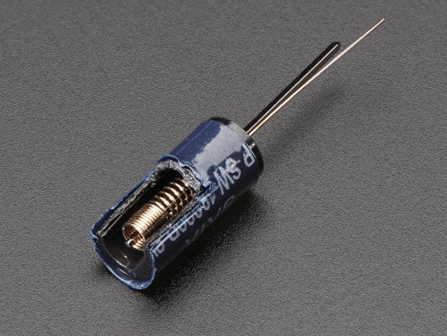

External kinetic triggers are an ON/OFF switch, and nothing in between. So there is no adjusting them in the radar settings for sensitivity. The sensitivity scale is for when you use a microphone. $50 kinetic triggers use a cheap Chinesium wobbly coil and fixed post setup seen in the photo.
Gun recoils and the coil wobbles, touching a fixed post and completing the circuit - ON. Coil settles and breaks the circuit - OFF.
You can however vary the sensitivity of a kinetic trigger by being careful where you mount it on the gun. Consider how the gun recoils when you are holding it. Typically the muzzle moves the most, whereas in the middle near the scope the least. Like a boat or plane in turbulence - calmest seats are in the middle. It also pays to know the orientation of the coil and post in the kinetic trigger. Coil inline with the barrel for less sensitivity, at right angles, more sensitive.

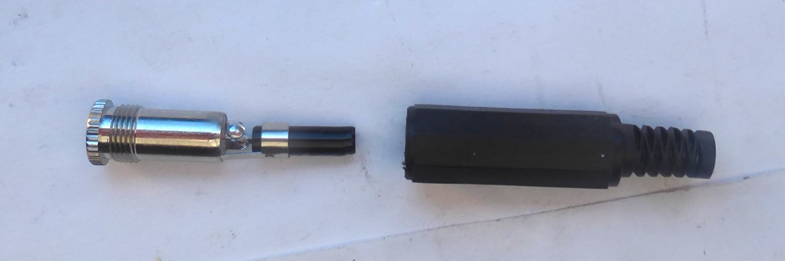

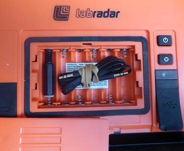

If you don't know the coil orientation you can always play around with different spots and orientations on the gun. Or make your own switch for $5. You just need four parts:
  1. a 'SW-18010P' vibration switch on EBay = $1
  2. a 3.5mm female socket (see photo)
  3. a 3.5mm male-male lead
  4. an elastic band to hold it against the gun.
Fits in your battery compartment.
As for false triggering from working the bolt, I just ignore it and keep on shooting. It is easier to delete them later on a computer. There is a screen on the radar that pops up directing you to push a button to reset it, but I ignore it - it resets itself on the next shot (I don't know why they even have it).
