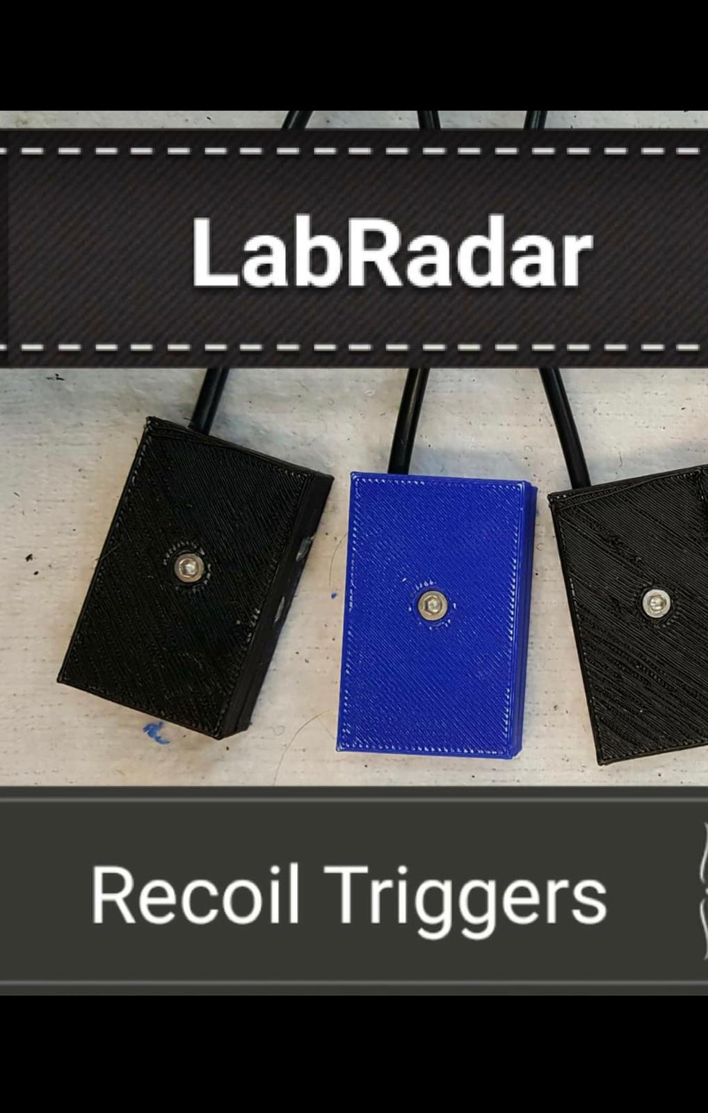

Recoil activated trigger, some guy on Facebook sells them.
But positioning your Labradar suppressed is the key with getting it to work. I had issues, sent it in for microphone update. Now it picks up 22 suppressed no problem, but have to have Labradar 3” to the side and about 4” in front of muzzle.
Really thinking about getting a recoil trigger

Get the recoil trigger from Greg. He's a supper nice guy and great to deal with. I ordered the trigger before i got my labradar. Went out the first time, set it up and it recorded every single shot for 180 rounds. Thing works perfect, i'm glad i didnt try anything else and went straight for Gregs trigger.
Reactions: 021411
Make sure you get it from Greg. Someone ripped off his work recently which is pretty shitty. Free market, capitalism yada yada yada.. Give credit where credit is due.

Well try it first and see if your LR will pick everything up. If it doesn’t then you know there’s a solid solution for it. The other beauty of the recoil sensor from Greg is that you do not have to have the LR right next to your muzzle. It can be way off to the side. The sensor weighs next to nothing and can be held on by a piece of tape.
