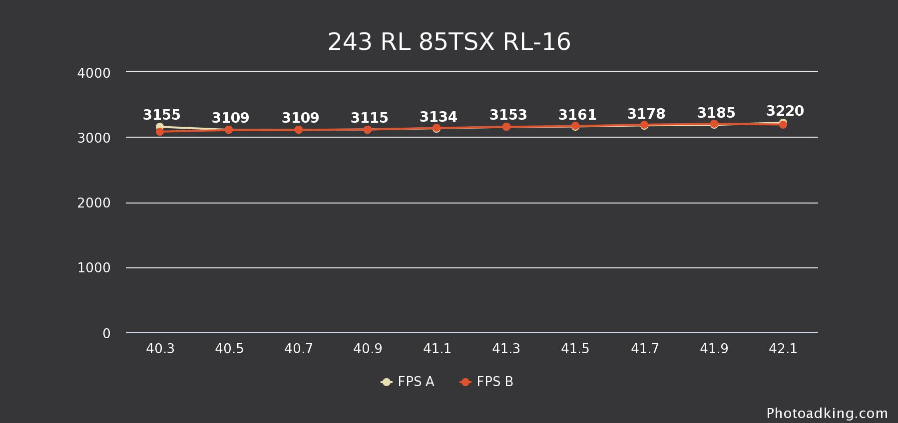

OK guys wheres my node? Obviously its not 40.3 or 42.1 they were the worst. That is 2 strings, Same day, shot in opposite order (Low to high then high to low). Carefully look at the different colors on the graph. They are almost identical. the load is a 243 Winchester, 85 gr TSX, RL-16 powder, Lapua brass, 210M primer. Did I do something wrong?
Your test has a sample size that's statistically irrelevant to determine any velocity "nodes".
The only thing you can determine from your test is approximate velocity per powder charge and where pressure is (which will be determined by physical signs on the brass and bolt lift).
Ya lost me. I have done this same test and seen wildly different results in other guns. What do I do differently? None were heavy bolt lift or high pressure signs that I could see. That is 1 grain above book min to book max range of powder
I used to do what you do, thinking I would find "nodes" through the Satterlee method.
Then I started loading up multiple identical ladders, and found that with more data (aka larger sample sizes), any so called "nodes" that I found using a ladder weren't "nodes" after all.
Use that ladder to get an idea of what velocities you get per powder charge, and where pressure begins (if you saw any pressure). There's not enough data to conclude if there's a velocity node or not.
I just want to know what the OCW is and what is max. After that I like to find what jump is best. Those Barnes monolithic bullets DO NOT like being jammed into the or right off the lands. Somewhere in the .050-.075 off is the best I have found.
Okay.
You need test targets to determine OCW nodes.
Your testing will not find any velocity nodes.
There's nothing here for the 'hide to interpret or analyz
Well, hear me out on this. I’m not being an ass and I’m not trying to be a jerk that you’re telling me that all these people that are shooting across lab radars and shooting across magneto’s are wasting their time? I’ve been told there are two ways to do. This. One of them is to shoot paper at 300 or further and the other is check for speed with an accurate device. You’re saying that paper is the only way to do this correctly? If you’re telling me paper is the only way to do it correctly you’re introducing a lot of variables into the equation when shooting a hunting rifle. I’d be interested in you posting a link to educate those of us that are obviously doing it wrong and once again, I’m not being a smart ass I’m trying to learn.
Do a pressure ladder first to see what range you have to work with. When you hit pressure, that's the high charge weight. Drop down 3 grains below that and that's your low charge weight starting point.
With that range of charge weight
Load up a ladder in .25 gr increments. Then number the groups and shoots the numbers at random or some other way to be "blind". Then see where your POI (point of impact) moves. There will be an area in there where you will see the 3 rounds start moving to and over 3 or more charge weights you will see that they have same point of impact as a group.
Then pick the middle of that charge weight.
Then do a seating depth ladder with only your selected charge weight. This should be a long ladder. Start like 10thou off the lands and then go to 100 thou off with 3 shot groups. Make your jumps in 5 thou increments. Pick the one that had a tight group on either side of it and that's your seating depth.
You're done. (The various jumps in charge weight and seating depth is up to you, some done want to shoot that much but this way will work every single time, all the time and get a good load. You don't just "have to" go 3 grains below first pressure but it's the best overall way I've found and often there are a "high" and "low" that do the same basically it just depends on how fast you want to run and brass life you want.)

I purposely ran it 3 times for that very reason those results are the 2nd and 3 time. Previous numbers look identical. I'm so confused now my head hurts. its obvious the starting and ending loads are not good (73 & 29 fps difference) the rest are within 3-4 fps. There is the actual scratch paper from the range.
Then load up whatever you think your "nodes" are and compare them with other charge weights.
Do a constant comparison over a chrono over different days and conditions.
If it truly is a node, then great. If not, it should still shoot well as long as you have a good process, equipment and components.
Either way, it's a win/win.

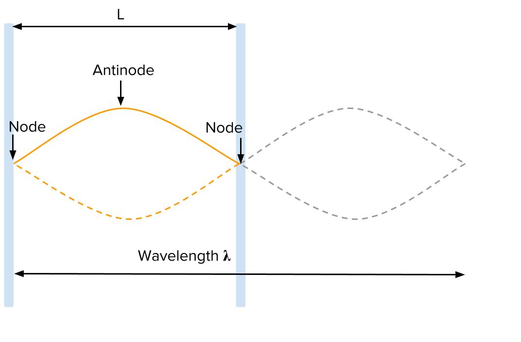

For those who are unfamiliar with barrel harmonics . . .
In trying to KISS this, every barrel has it's own harmonic vibration that is a sine wave that's along the length of the barrel:
When we talk about finding the "node", we're actually trying to find the area at the "antinode" of the wave where the motion is at it slowest at the muzzle for most consistent release of the bullet. So, the timing of the bullet to get to the muzzle release at the pint of the harmonic antinode is the goal for finding "the node".
Because long and/or heavy barrels have a lower frequency than short and/or lighter barrels, the time around antinode is longest, which is why it's easier to find and stay in "the node" with the longer and/or heavier barrels.
I choose the red. ;)
