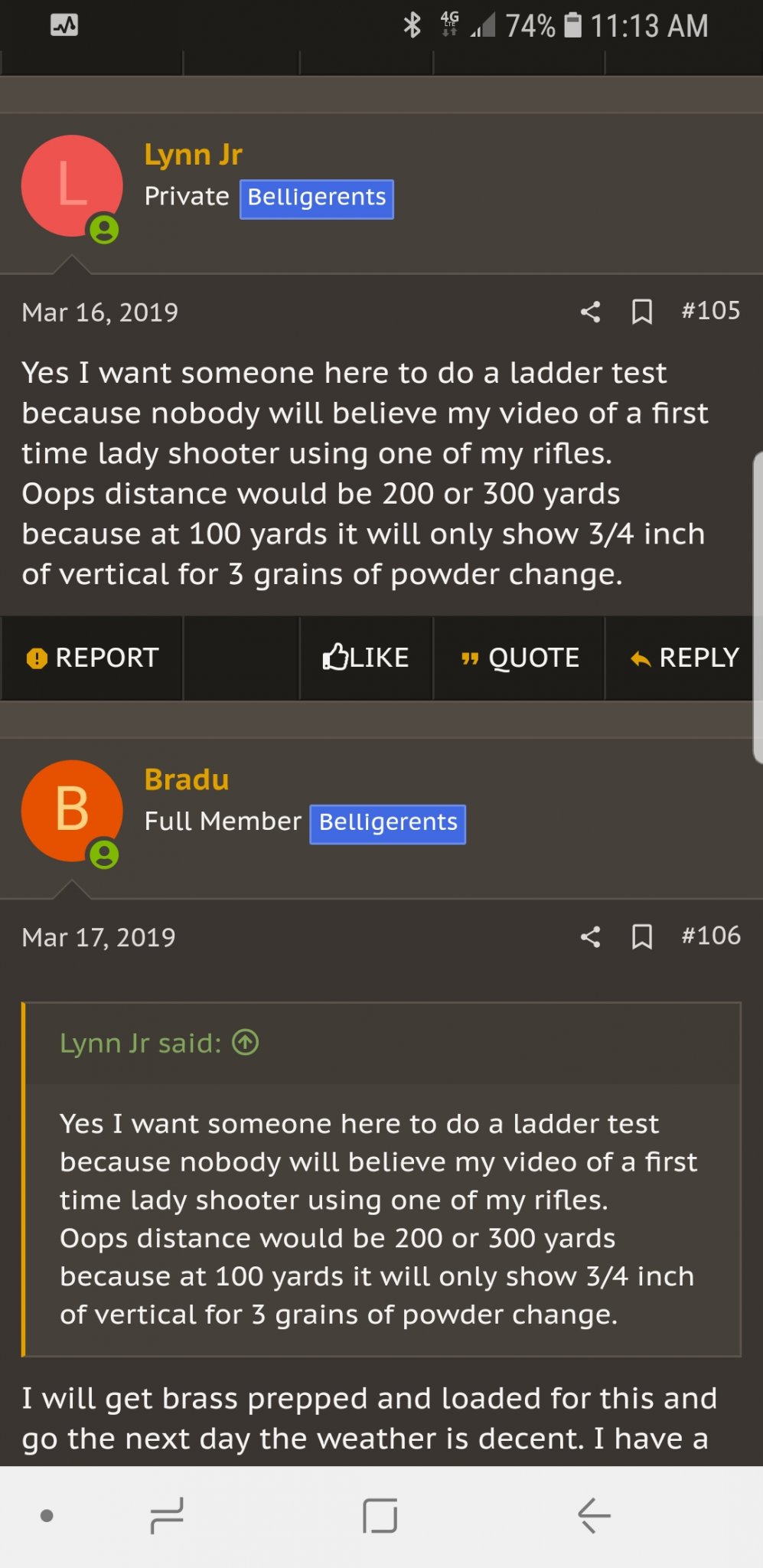

This is what he said to do
If i remember the original conversation correctly, you and your gear are not capable, which shows your skills or equipment are not up to the task at hand. You obviously don't know what's important and you don't want to learn because you're a "millenial". You obviously aren't capable of doing a ladder test, so you post a bunch of nonsense.

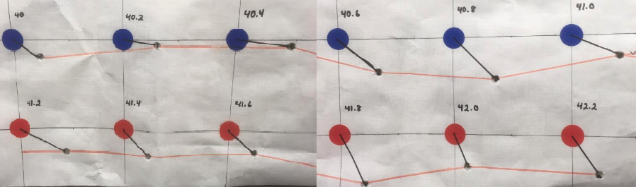

I've been doing this at 100 yards. It gives all the same info as the Audette ladder, or more,
but in an easier to visualize way.
You get to see the vertical expressed in the sine wave pattern, but you also get to see the horizontal deviation and the "clocking" of the barrel direction in relation to point of aim. I intentionally off set the POI to the lower right qradrant to make the effect easier to see.
