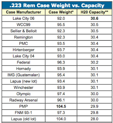

As long as you are using 223 data you'll be fine. Most manuals will tell you that military brass has less case capacity. This isn't always the case. [ pun intended ]
I use LC brass for “lost brass” endeavors, and Lapua brass when I can recover spent casings. My load is almost the same, but I bump up a couple tenths of powder charge in Lake City because the LC brass has more capacity than the Lapua match brass. Accuracy is same velocity is very close. The LC brass takes some prep work to be consistent - I suspect I’m not saving anything if you include my prep time. This is in a bolt gun. My AR only sees LC brass.
