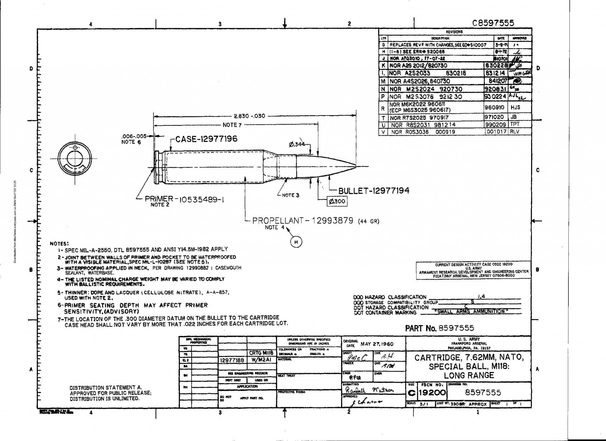

M852 has "Match" in its headstamp. Not sure when they stopped loading 173-grain Match.
Long Range is stamped "LR."
Last 40mm can of 96 Match brass I bought at Camp Perry is all knurled, but I haven't seen it released in a long while (since M118 LR and Mark 318 are the preferred 7.62 loads for M24s, Mark 11s, and M110s and has pretty much replaced Match since the M14 went away in 1994).
