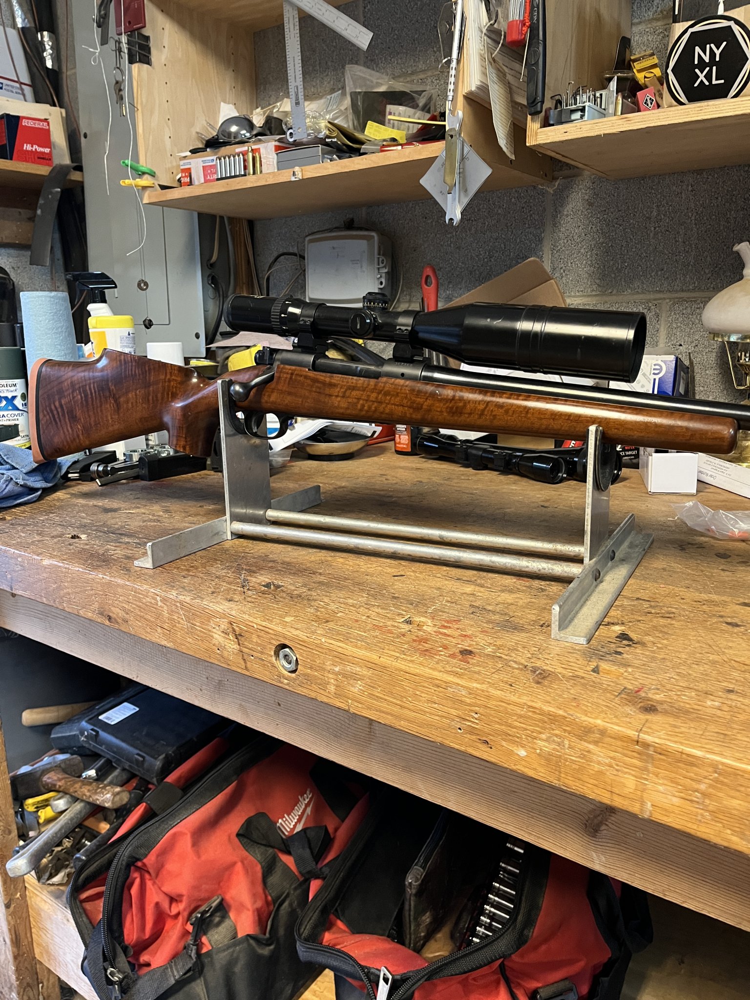

I was not totally sure I should do it, but I gave it a whack. I looked around. Seems like precision shooters are fighting about this all over the web. I started thinking maybe the pro-lappers were right.
I had some thoughts, which I'm sure will be received with all sorts of gratitude and respect.
First of all, how does anyone know a scope ring's registration on the mount is repeatable? I had to take the rings off to clean the lapping compound off, and it made me wonder if I was undoing all the work I had just done. Maybe I was.
Second, it's not easy to keep the compound from getting on threads when you remove the caps to check the work. Once the compound is in there, how do you get it out? Seems like that grit would do its best to embed itself in aluminum, and then you have threads that may not torque accurately due to the grit increasing the friction. I worked pretty hard to clean everything, but I don't know whether the rings are attached exactly the way they should me.
I used a sonic cleaner and brake cleaner to clean the grit out. Don't know if it actually worked.
Anyway, it's always fun to play gunsmith, and I'm sure none of this will matter much at 50 yards.
Maybe I'll just buy Seekins next time, as I have in the past.
