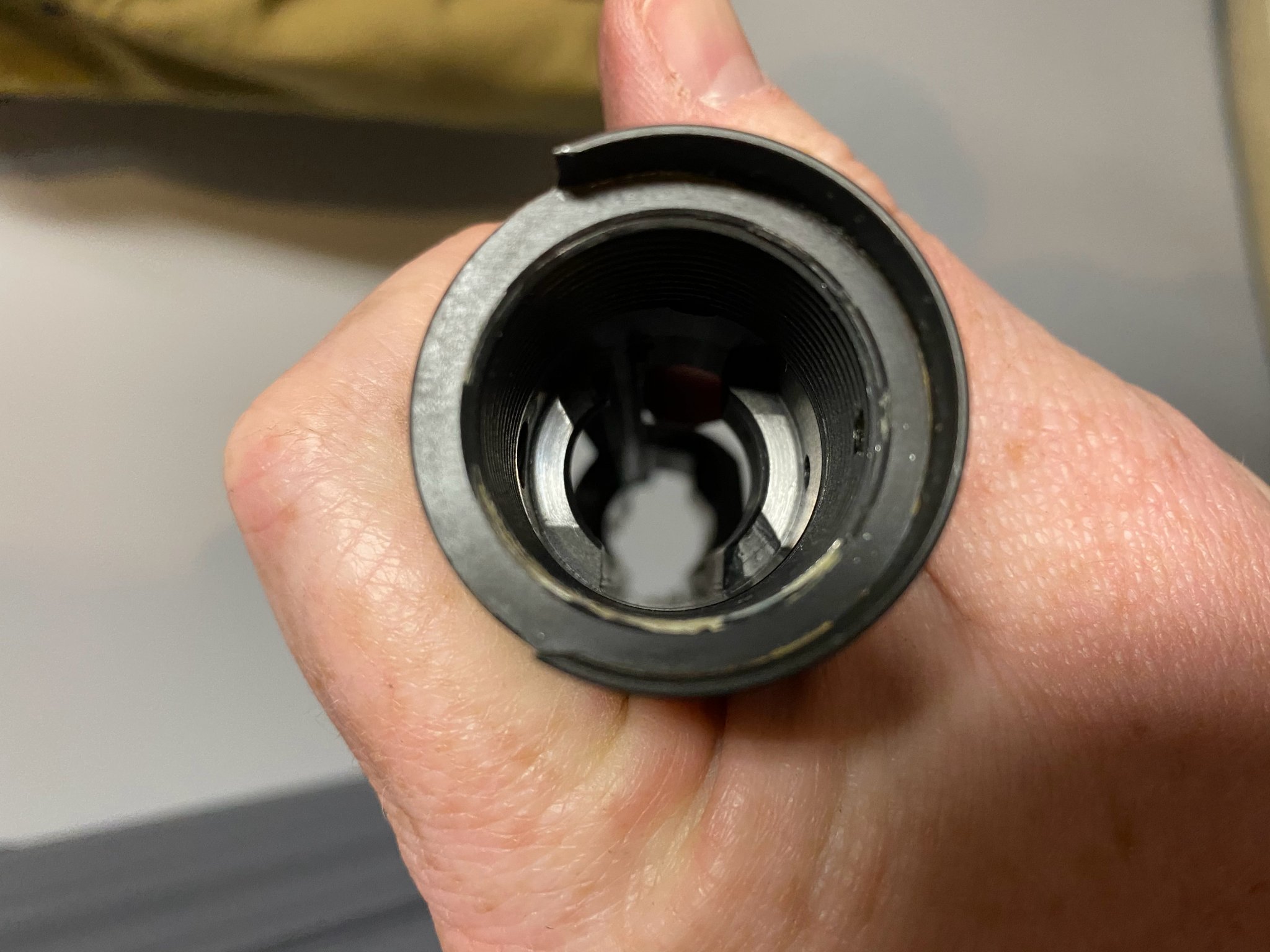

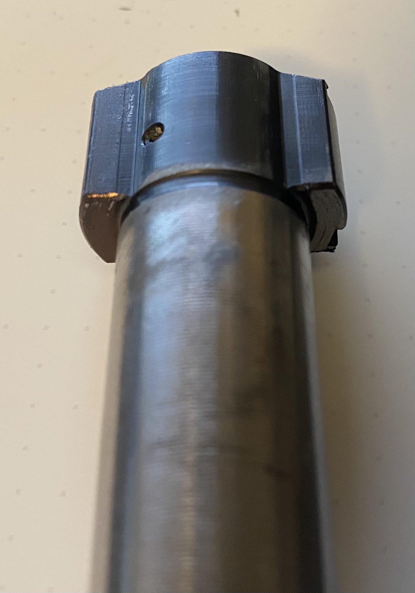

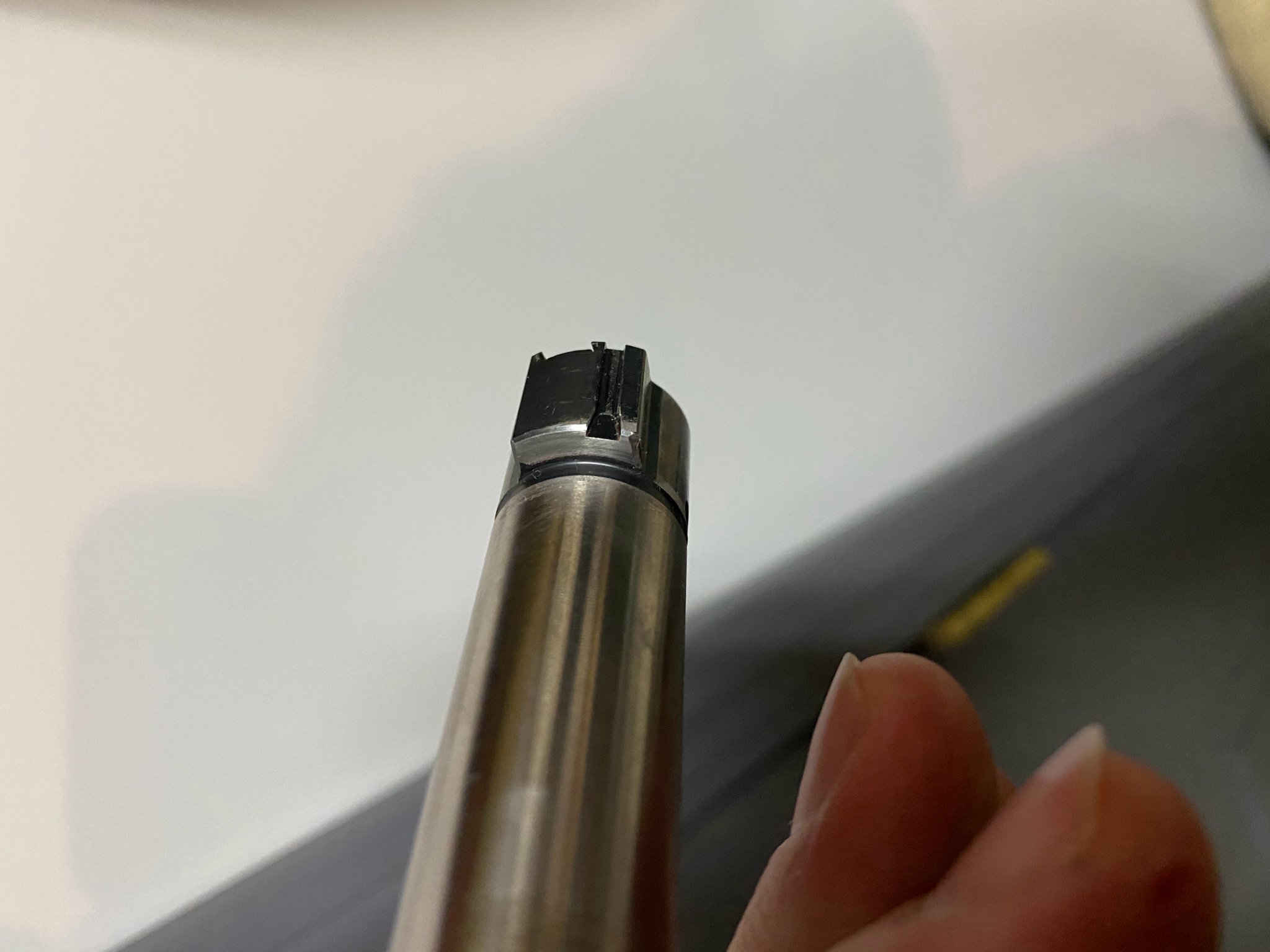

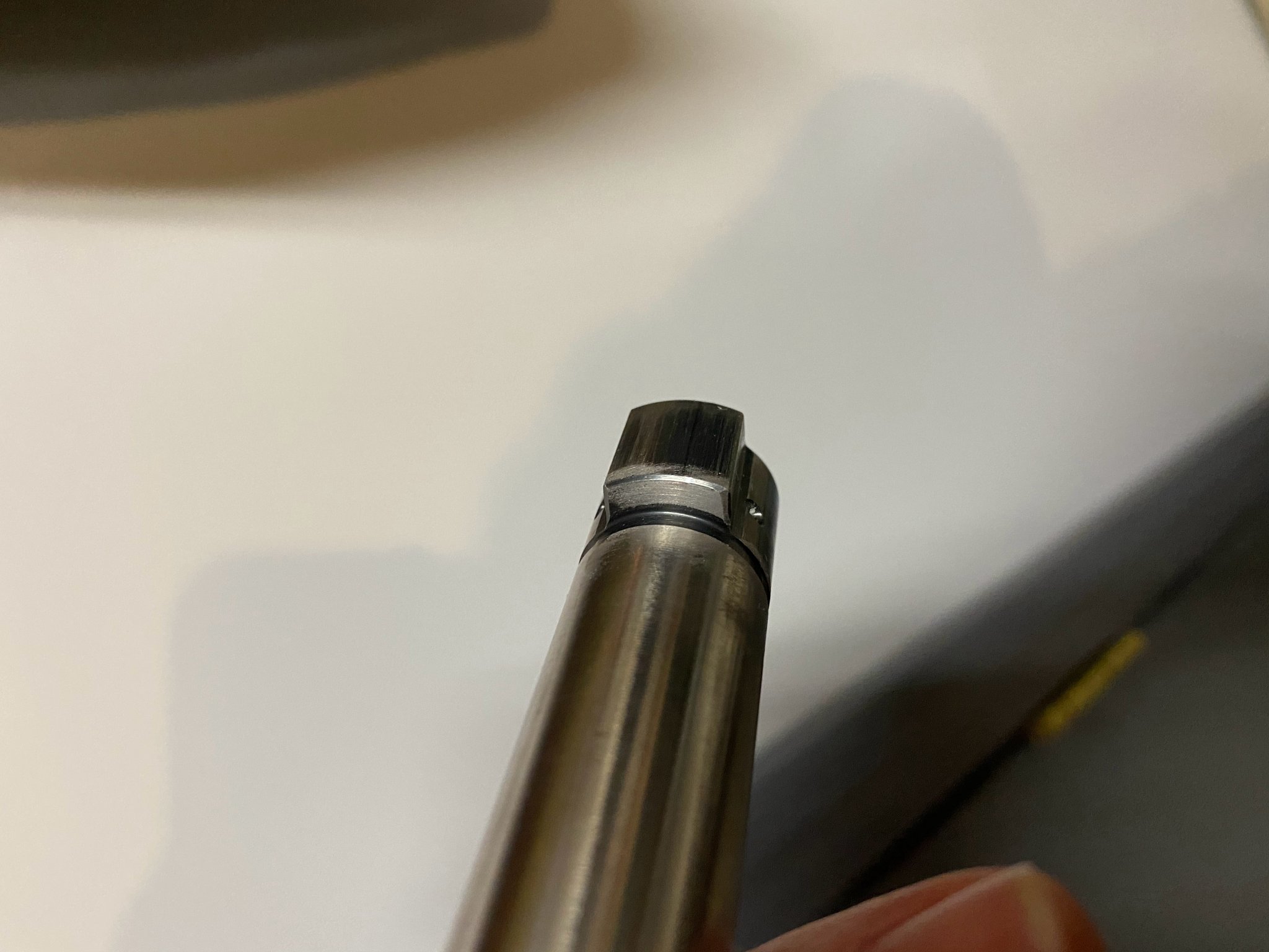

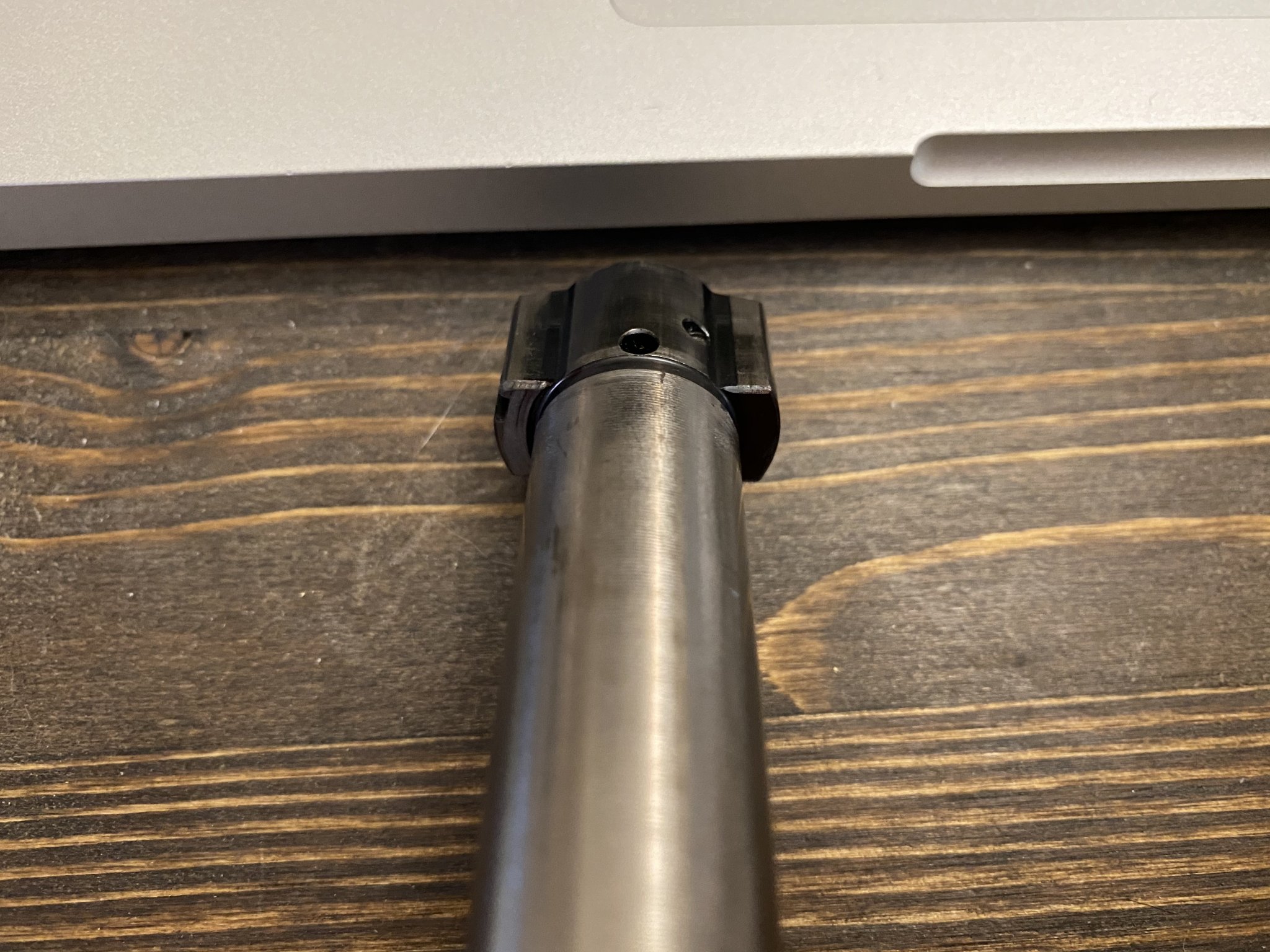

First time lapping lugs myself. Just wanted to check to make sure it looks like I have full engagement on both lugs and also ask if I should switch up to a jewelers rouge to polish the engagement surfaces a bit or just leave it be and let it self "polish"?

Are you rebarreling the rifle? Your last picture shows you only have contact via one lug.

So if I’m still not getting engagement (with barrel, lug and fired case installed) on both lugs, do you recommend I continue lapping? It looks like the left lug is just beginning to kiss the abutment surface.
If you’re lapping with the trigger installed, and you have any clearance at the rear receiver ring(almost all actions do), you’ll only have contact with the lug at 6 o’clock. The trigger is pushing the rear of the bolt up. The 12 o’clock lug will be hovering. This is not the way to lap lugs, as you’ll only lap things into misalignment.
