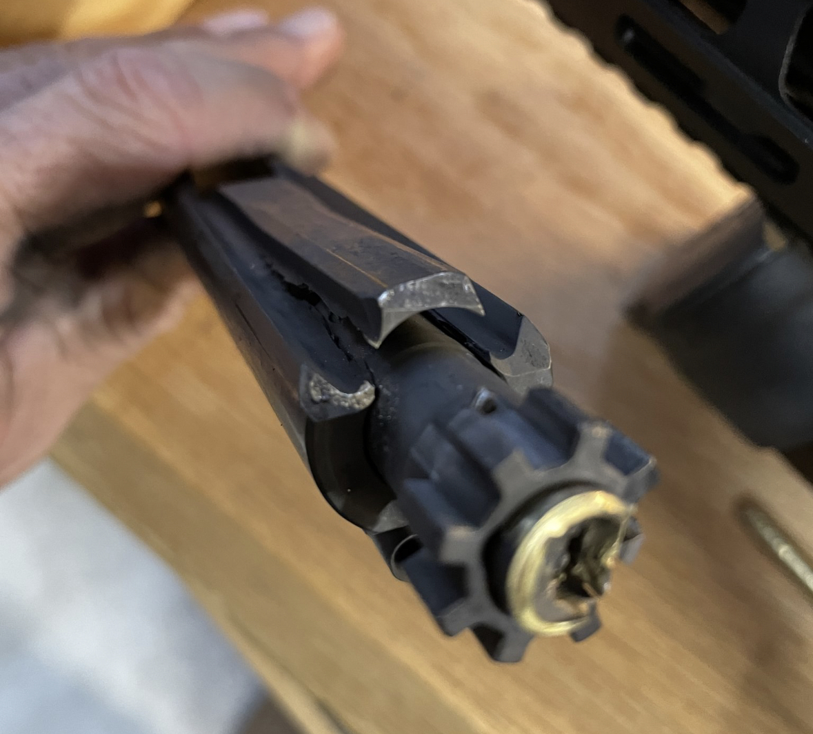

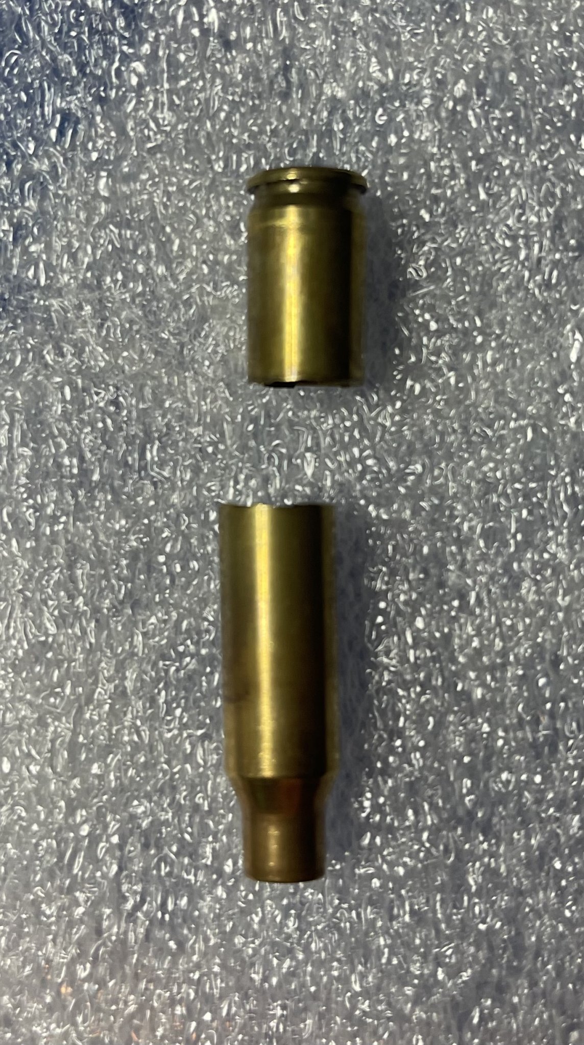

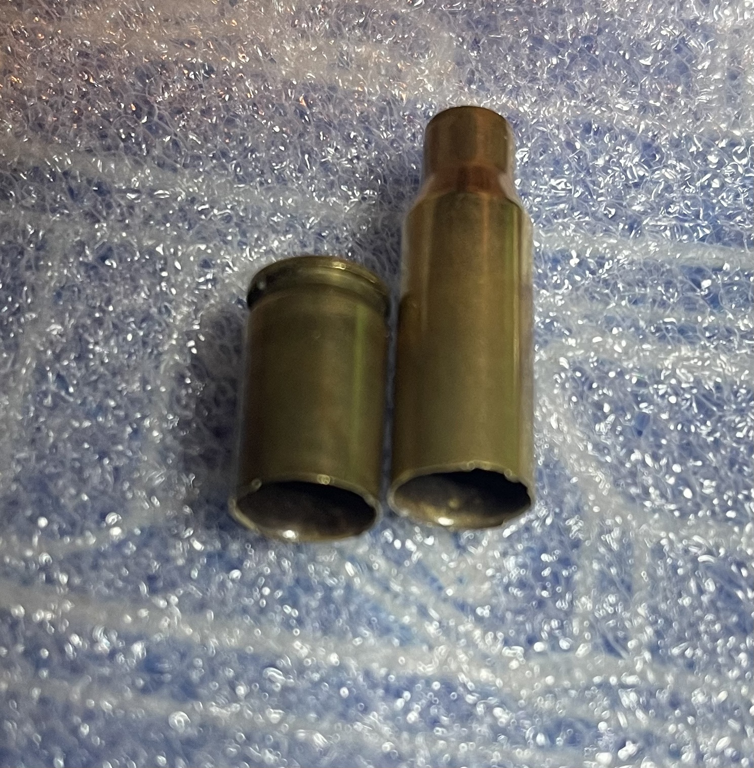

Wondering if anyone has encountered a situation like this...
I bought some Lapua brass for my .223. I have reloaded this brass 5 times. My reloading process includes, de-prime, anneal, wet tumble, full resize, mandrel, prime, and load. After the 5th firing, I found one of my brass broke in half in the wet tumble. Later, when i got to the mandrel stage, i found four of my brass collapsing at the shoulder. At this point, i retired the whole batch of 50 Lapua Brass due to safety concerns.
As for the loads themselves, I am running 24.3gr of IMR 8208 in order to push 80gr Berger VLDs at 2940fps. My barrel is a 1:7 twist at 28" bull barrel. I observe my brass after each firing and have never seen any signs of over pressure. When the brass is ejected after firing, it is barely warm at all.
I have other brass from Lapua and Peterson for my 6.5 creedmoor. I am able to get up to 10 loads from each. But for my .223 Lapua Brass, it seems i am lucky to get 5 reloads.
Any thoughts?
How far are you pushing the shoulder back upon sizing?
Bingo.
OP: the answers are inthe numbers, what are your fired vs sized dimensions. Shoulder set back (headspace clearance) is the primary culprit in case head separation but you should be noting that plus all other diameters- base shoulder neck.

More case head separation.
Let me guess, bottoming die out on the case holder, not measuring shoulder bump.
Correct...

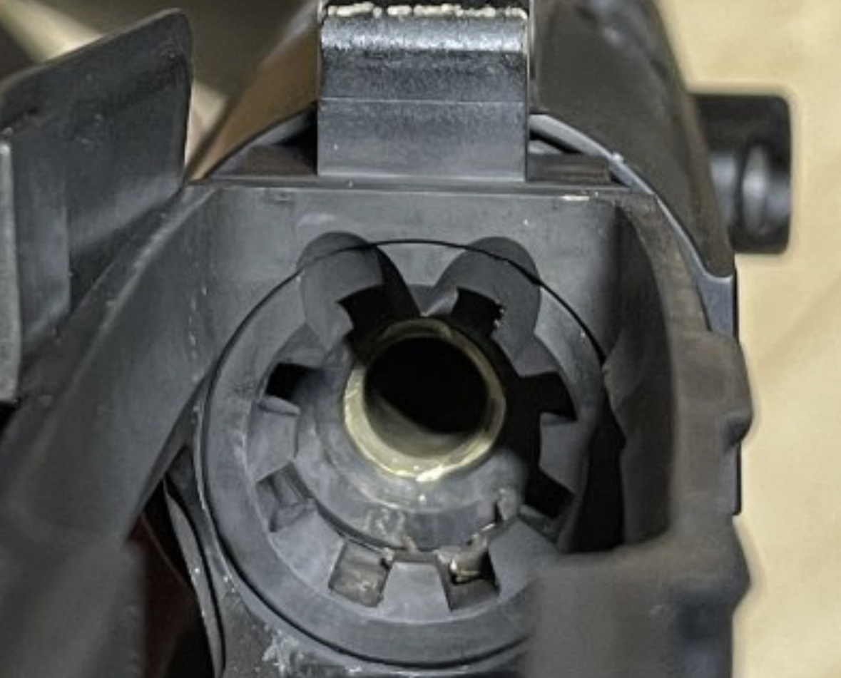

I would double check your headspace again.
A few years back, I had a non-shouldered prefit that was installed and torqued by a pro. He machined the barrel as well.
About 600 rounds later, I started having the same issue that you have. It turned out the barrel nut had backed off about 20 thousandths.
Are you having light strike issues? That is another symptom of headspace being out of spec.
