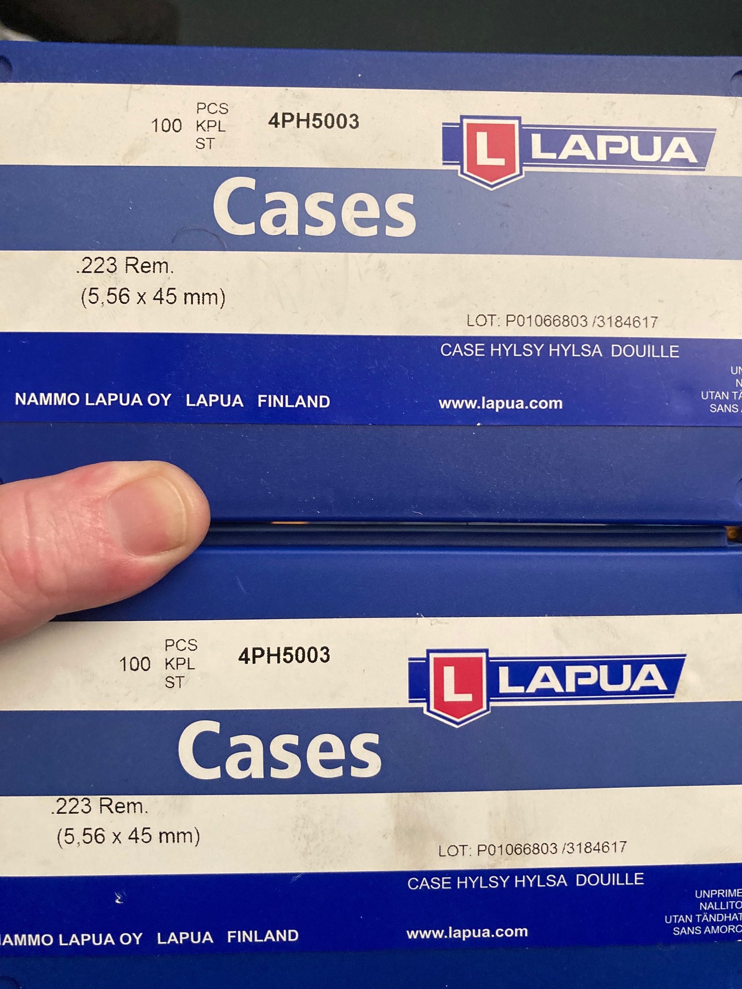

My 75gr ELDm loaded rounds measured 0.250in and I use a 0.248in bushing. This lot of Lapua is from circa early 2018
