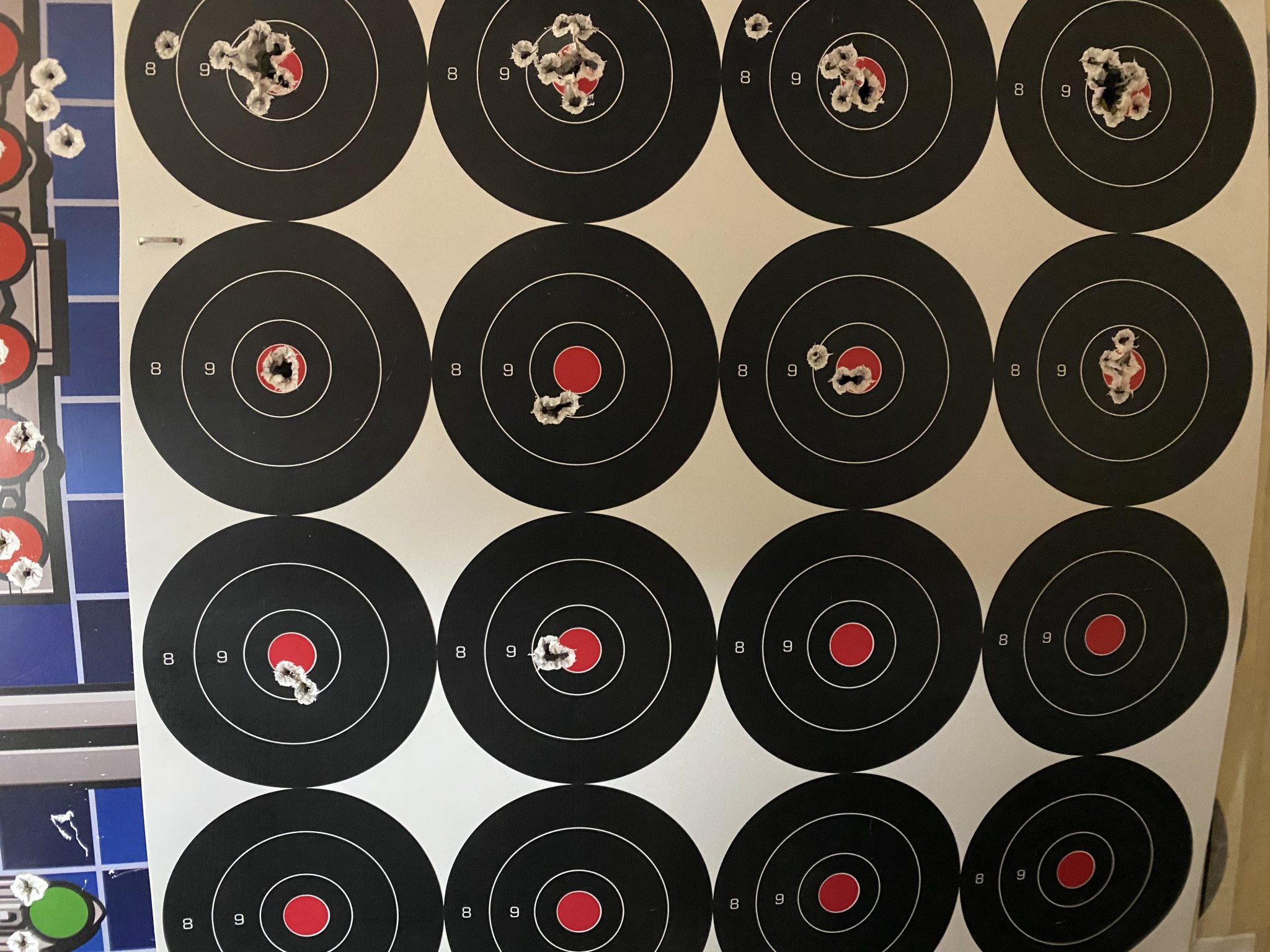

For me finding center x in commiefornia is practically impossible unless I have it shipped in. I’ll never find the same lot to lot so I go by speed. My barrel likes 28xxx -29xxx so that’s what I try to find. Works for Midas as well. Bought two rando bricks of Midas+ @ 28xxx and 10 rounds go into the same hole 🤷‍♂️
- pic:
- top row is 10 rounds each of some SKLR my barrel hates
- 2nd row: left to right; left is 10 rounds Midas +, next is 5 rounds lapua SLR, next is 5 rounds Lapua LR, next is another lot of center x @ 24xxxx
- 3rd row: both are 5 shot groups of x act

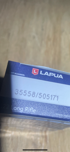

Matching the first five numbers will only ensure the manufacturer's rated average MV, the type of bullet, and the year of manufacture. The numbers following the slash in the lot number is what identifies the lot.
The "speed" of the ammo is not relevant to its performance. Characteristics other than a lot's average MV (as calculated by the manufacturer) will determine how it shoots.
Below is an explanation of the Lapua lot number system. This particular lot of Center X happened to shoot poorly in a number of my rifles.

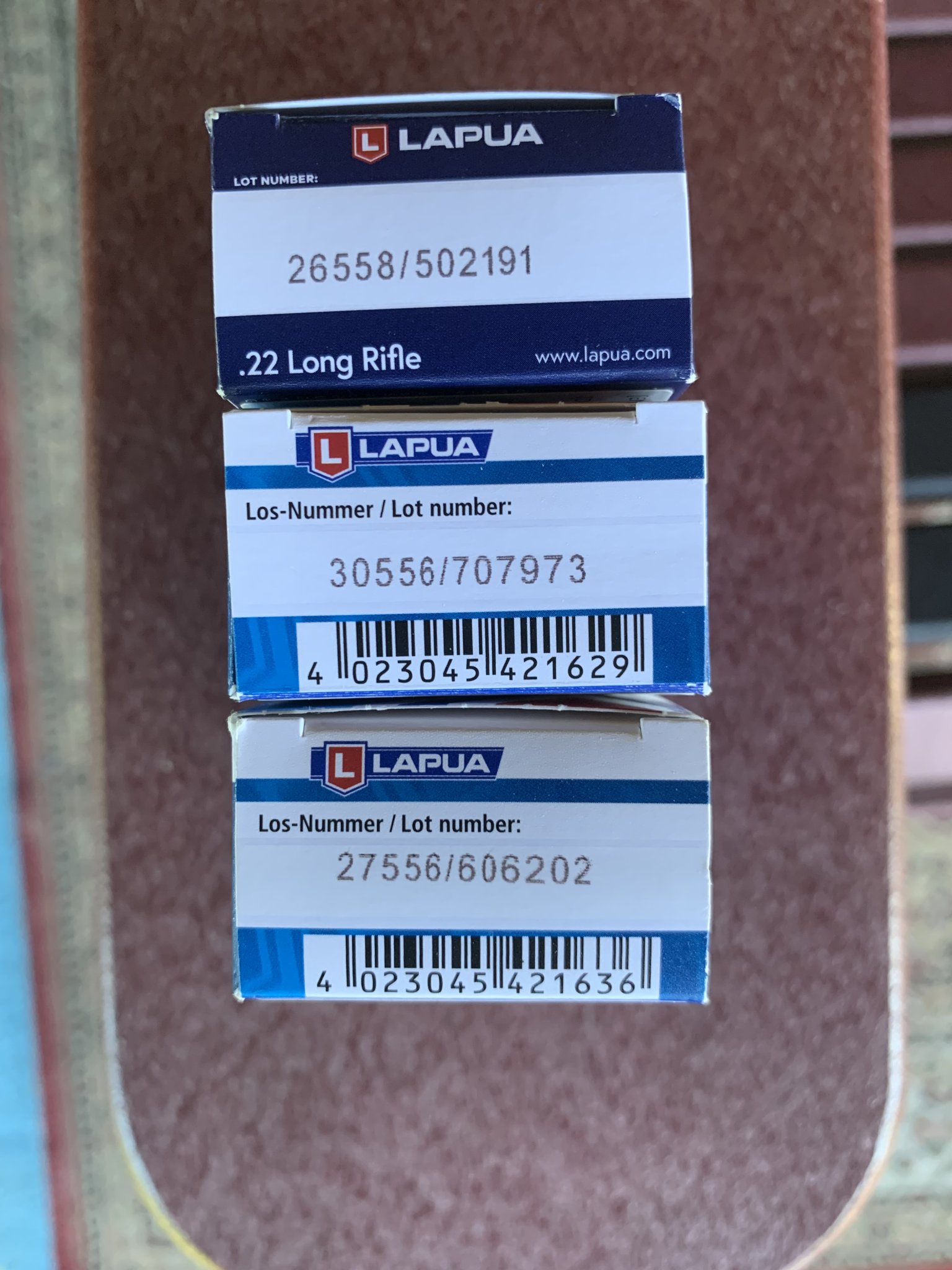

Lot numbers are different now. I don’t know what they mean now. The 2 lower boxes are a few years old and the top box is from the test center last year.
How are they different now? The two lower boxes are made in 2021 and loaded by machines numbered 6 and 7. The top box is from 2023 and was loaded by machine number 5. (Lapua uses more than a single loading machine.)
