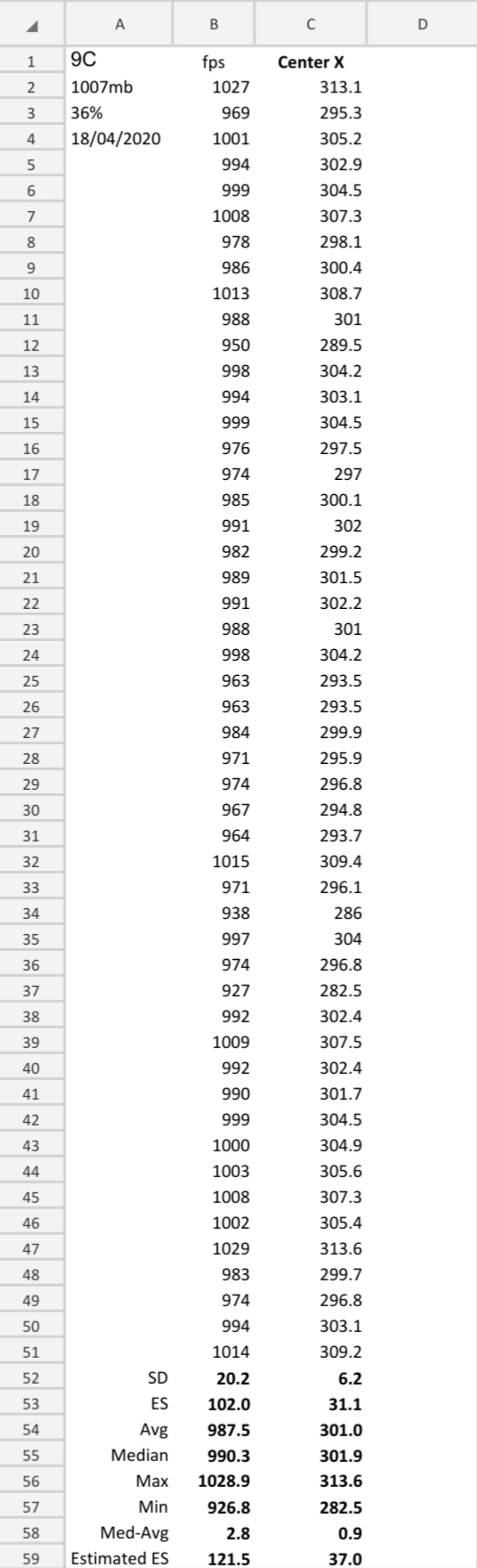

20 shots for each lot#. Chrony could be off but every group that had a flyer, I would get a hot or cold reading on the flyer. I have a V-3 also but only use it with verified repeatable accurate loads. Had issues running Saterlee ladders on one centerfire gun.
In my limited experience in shooting and observing others, what you got out of your Center-X is not typical.

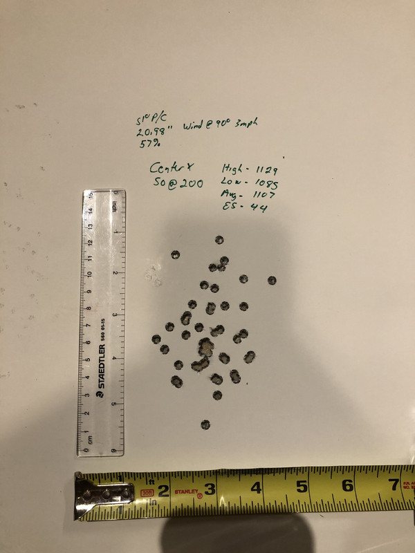

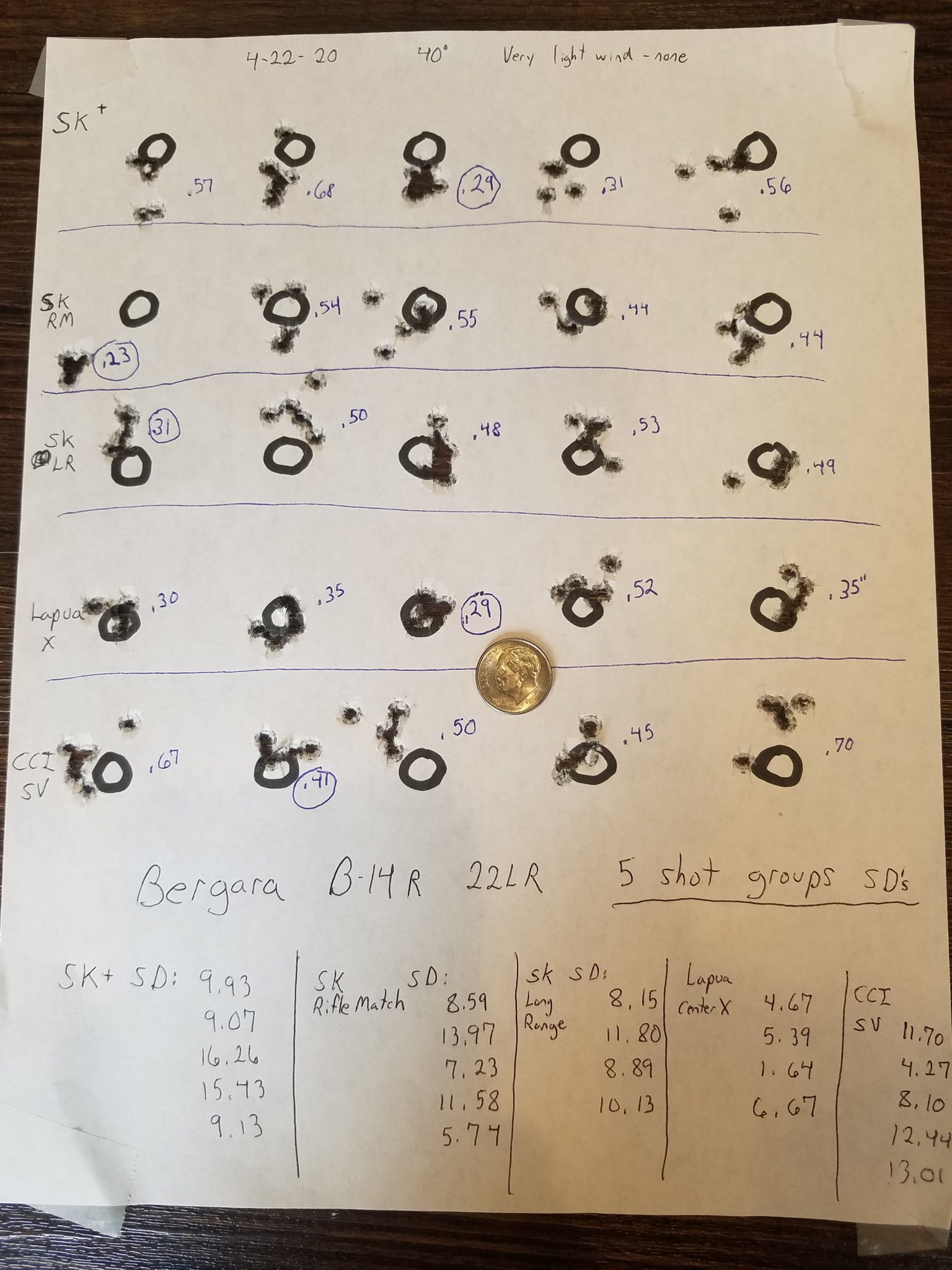

I recently tested Center X through my Bergara B14r and got decent numbers. The ES numbers for the 4 groups of 5 shots are: 15, 4, 14, and 11. The groups were awesome too.

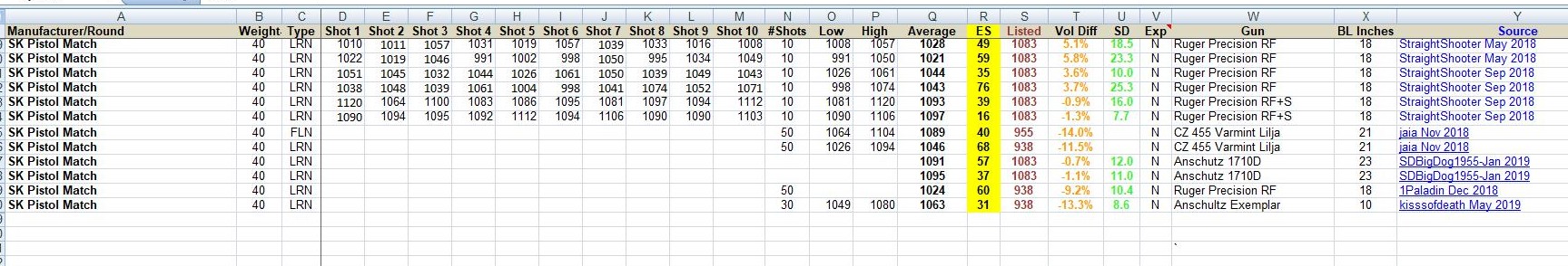

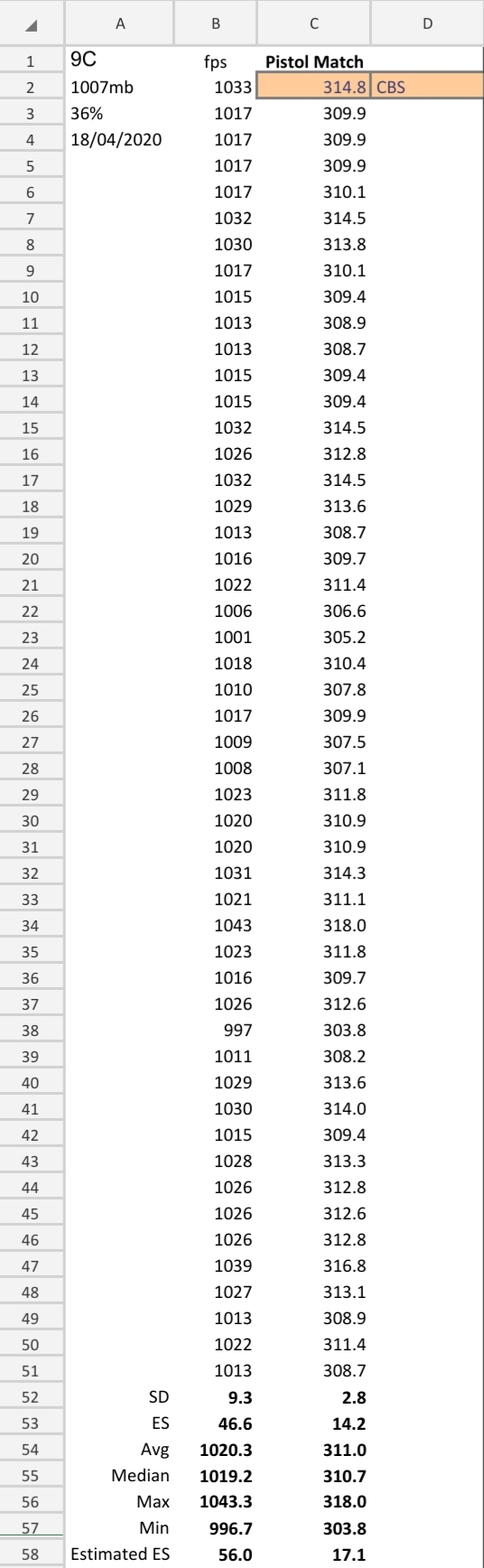

Here's some Pistol Match in comparision:
Thats very big ES with just 10 shots.

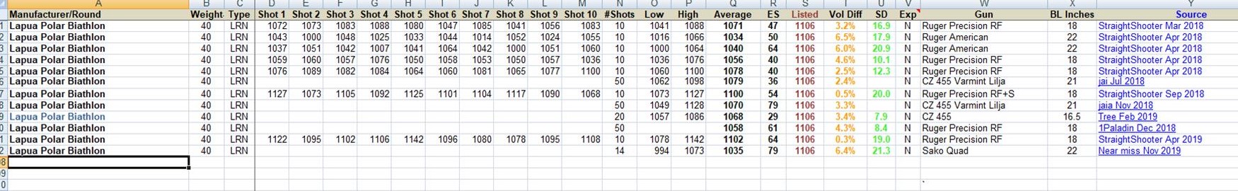

Center-X should be better but I have also gotten bad lot of Polar

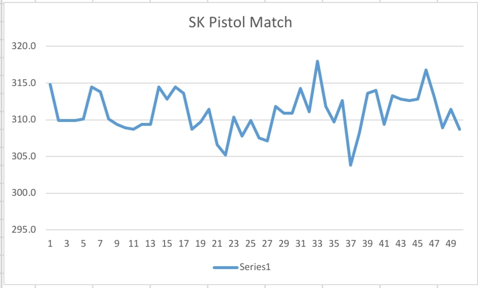

To give an idea how the sample size matters check out this graph.
You see that the only rounds in the extreme regions are quite alone there? You do not need to ditch the lot if it has them but just acknowledge what is the chance of it.
Yes, it is. And even higher when I combine the 10 shot data.

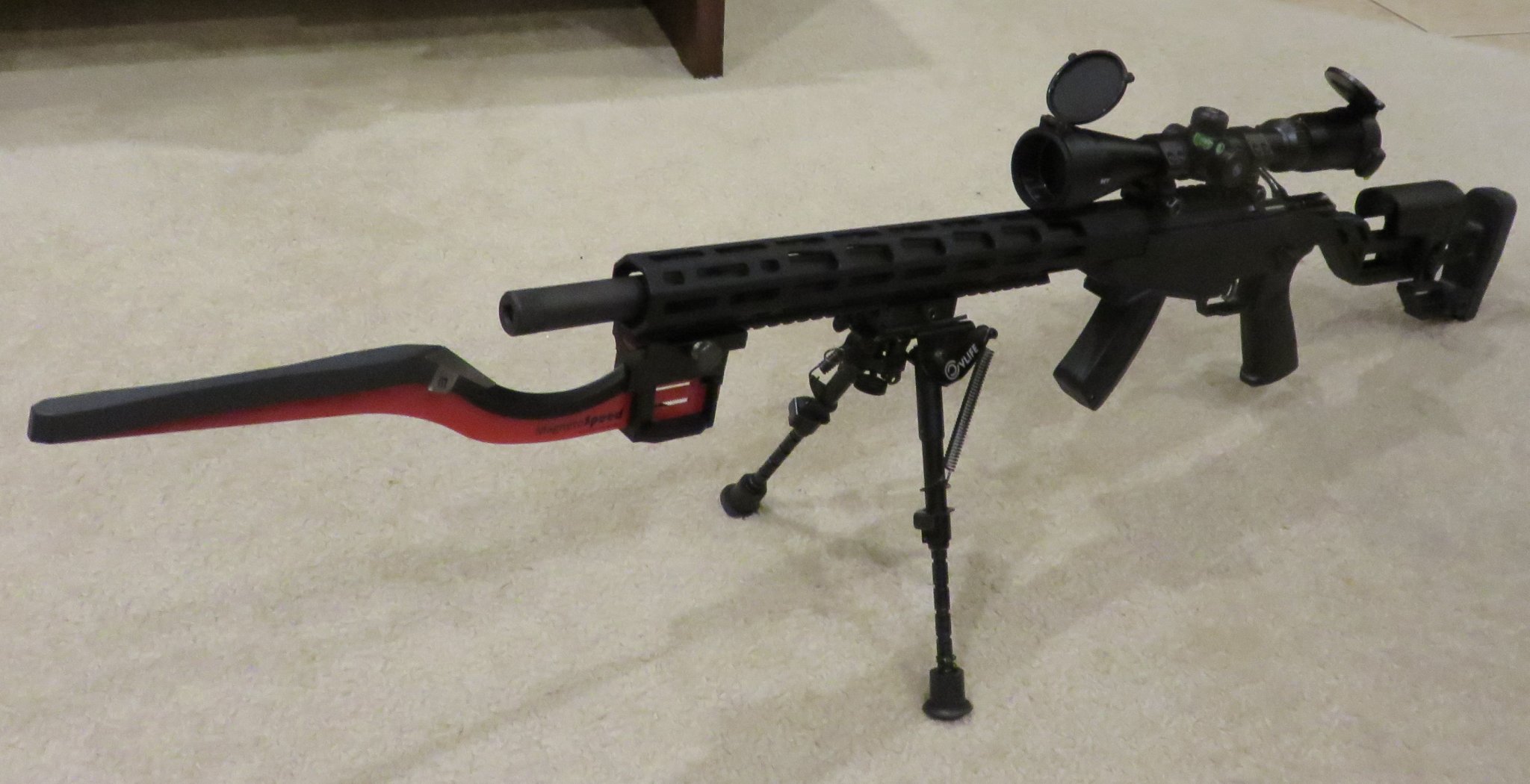

BTW: For the primary gun I use most (an RPRR), I don't have it mounted to the barrel. Since a picture is worth a thousand words . . .
