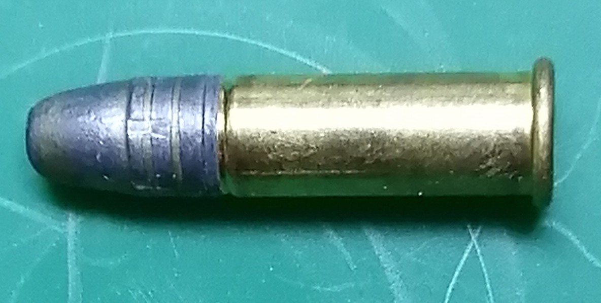

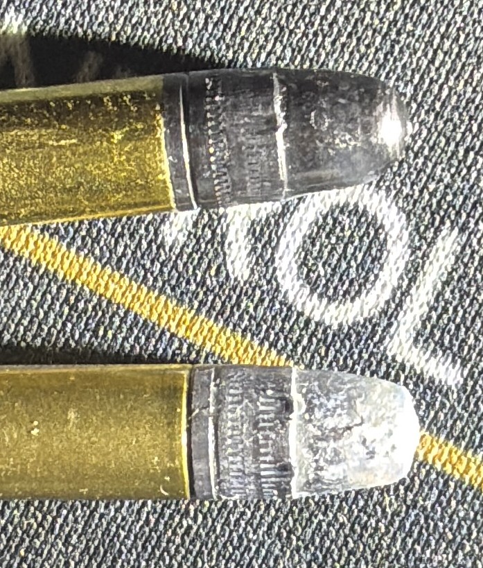

Most likely this has been done before. I wondered how Center-X vs Tenex would look pressed into the same guns bore, extracted without firing to view the lead impression from rifling lands. I attached a photo.
I noticed the Center-X took quite a bit more force to seat the rim to the chamber edge. Perhaps double. I didn't have a calibrated gauge to measure force. CZ 457 MTR was used.
Tenex is on the bottom. What interesting is Center-X has the rifle land mark deep into the sealing groove area while Tenex the striations are still very visible.
Brass looks very different too.
I also took bore scope shots but couldn't see the contact area of course.
Different lead and coatings but what else? Anyone else try this?

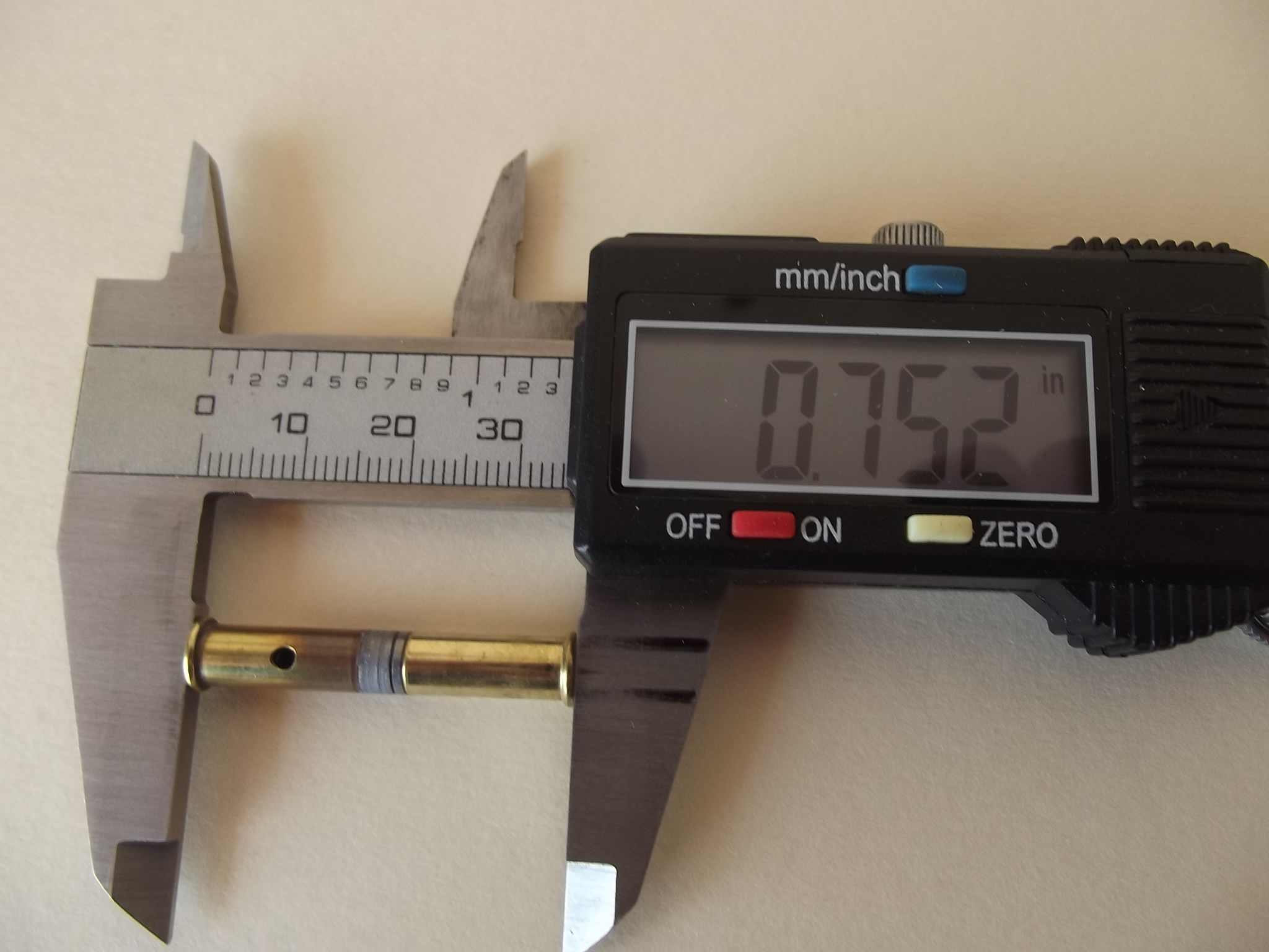

G'day GuideDog,the base to ogive measurement (where the curve on the lead starts ) is longer on the centrex compared to the tenex. I batch all my ammo and tenex is .754 in long whereas the centrex is .768 in so they are going further into the lands and grooves of the barrel .Pic of eley match (same as tenex ).:cool: Scott in AU.DSCF2080.JPG

I pushed the rounds in with a wood dowel for safety and did not use the bolt. My test was to see if the contribution to what ammo shoots best can be due to rifle land contact. After research that's just a small factor. The lubricants are a factor, and yes the lead hardness too. It's a complex group of differences that even if we understand there's still too much variation in barrels to determine what ammo is best other than shoot it.
This started since I noticed closing the bolt took a bit more force with ammo brands, and it was not a headspace issue.

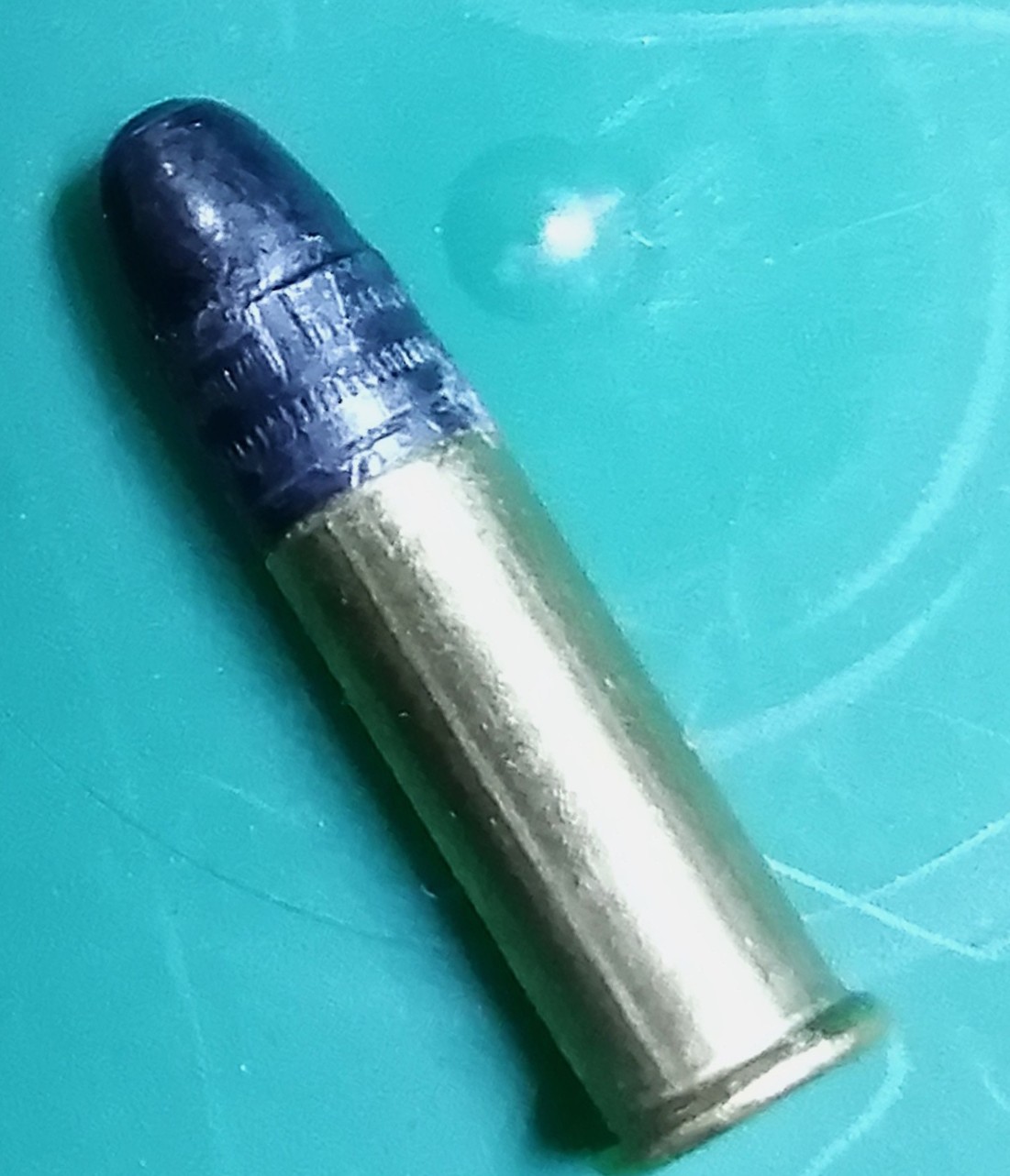

I have a VMTR with about 2500 rounds fired. I recently 'tested' the engraving for another thread concerning SK ammo and got pics. I just used SK Magazine, which is purportedly the 'same cartridge' as SK Standard and SK-RM - Just different Lot speeds. I also had some Norma Sub-sonic on hand and ran one of them too. The bullets I chambered using the bolt, 'carefully', and BOTH were hard to close fully. From my reading this is mostly due to the diff between SK/LAPUA and ELEY 'rim thickness'. Thus, the engraving might be a bit less with SK since the rim would 'hold the bullet a bit further away' than the Eley. I didn't think to run some Eley thru also. The 'Engravure' looks about the same length IMO.
SK MAGAZINE
NORMA SUB-SONIC
