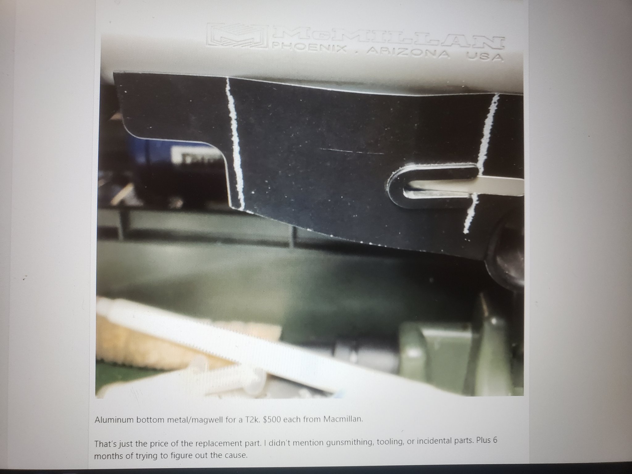

Lots of great reviews from Accurate Shooter on the Alpha brass. But as said above, Lapua is consistently great too, you can't go wrong. FWIW, personally if the Alpha were available after I built my gun that's what I would have started with, just to save some wear on the barrel.
Can you point us to where others have talked about these issues. Im interested as i have not read much about Alpha brass and thought it was good stuff. I was about to order some and am hesitating now. Would love to read more about these issues others have had. Thanks for any info.
The 6BRA group on FB
Various other posts/groups on FB
It typically ends with Mike Keenan and Tom Danielson shitting on the end user

Pretty strong words right there. Please provide factual evidence of that and not just words
Might be pretty hard to find the FB thread as its been probably 2 years and the shooter has since passed. But it was a tubb gun and the receiver was trashed. national champion high power shooter. 6XC. norma and peterson brass no issues same barrel.
Since AccurateShooter was brought up earlier.
More than one thread over there about it
Here's your factual evidence. Btw this happened twice.
And you know what. Shit happens. Bad batches of metal exist. Spuhr has had cracked clamping rails
But spuhr owns it and fixes the problem
Alpha responds poorly at best to anyone who has a negative comment or critique
