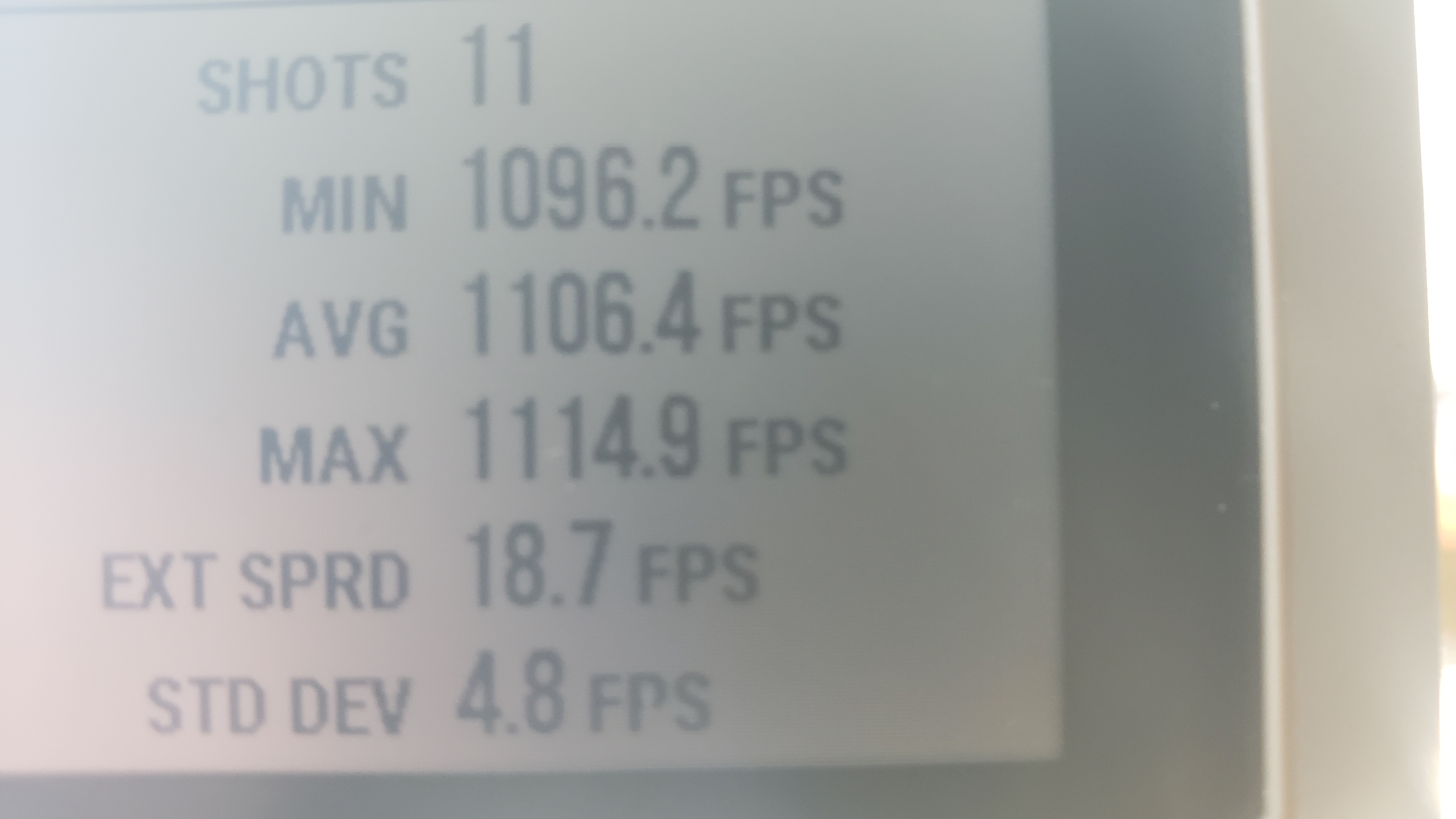

I set up the Garmin Chronograph to see how this same batch of Lapua Super Long Range Chris used at Rayners would do and have some data to share. I think I shot 11 shots to see how his targets would move when hit to make keeping score easy. They worked perfect, might get a center hit, then 3 inches off the right, then 6 inches off the left but elevation was really really great. EXT SPRD was 18.7 fps and STD DEV was 4.8 fps. Thats why it shoots so well. A buddy that was there wanted to try the two different versions of Wolf Target. We always thought the Old Wolf shot better than the new stuff so this should show up on the Garmin.

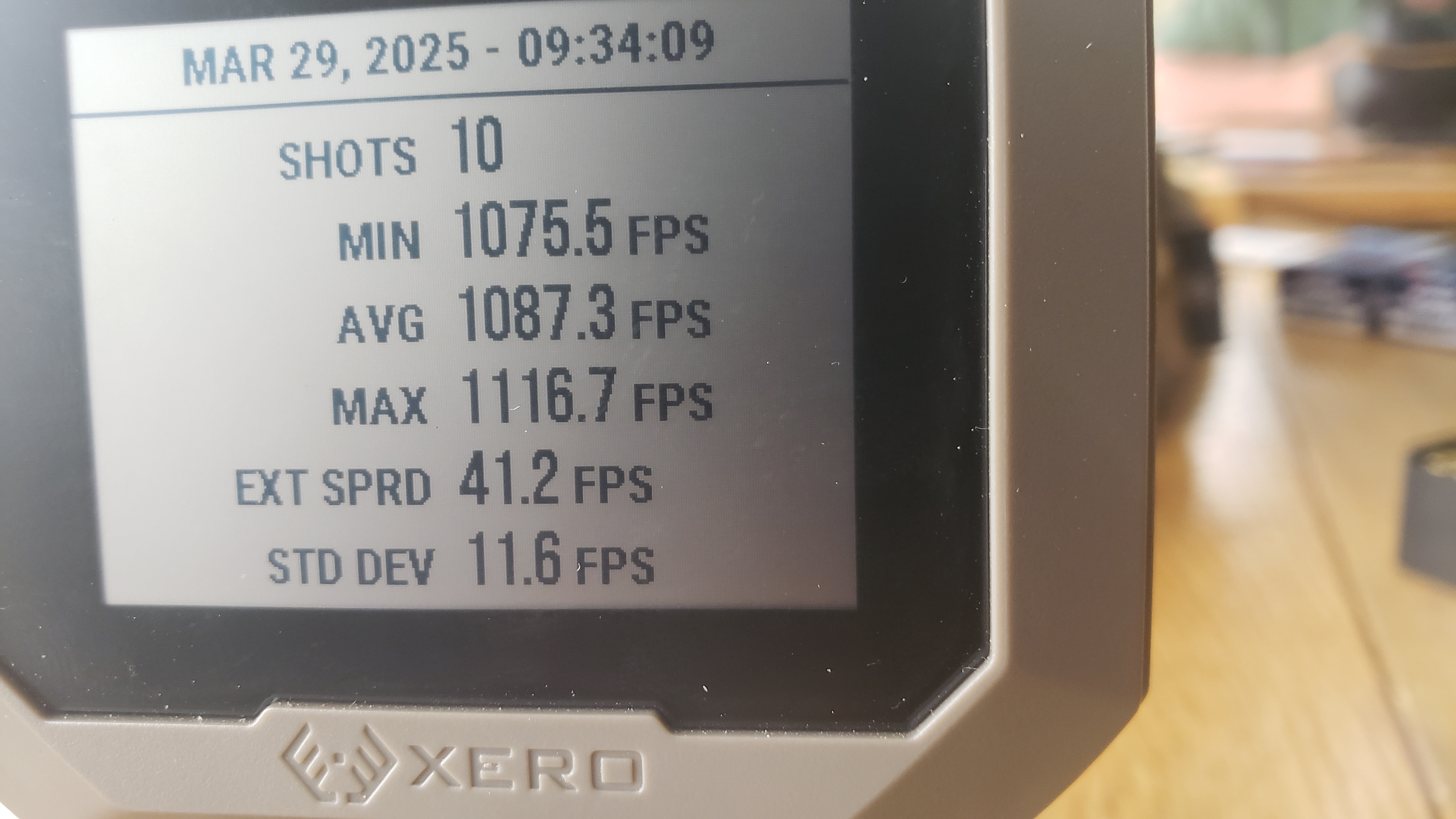

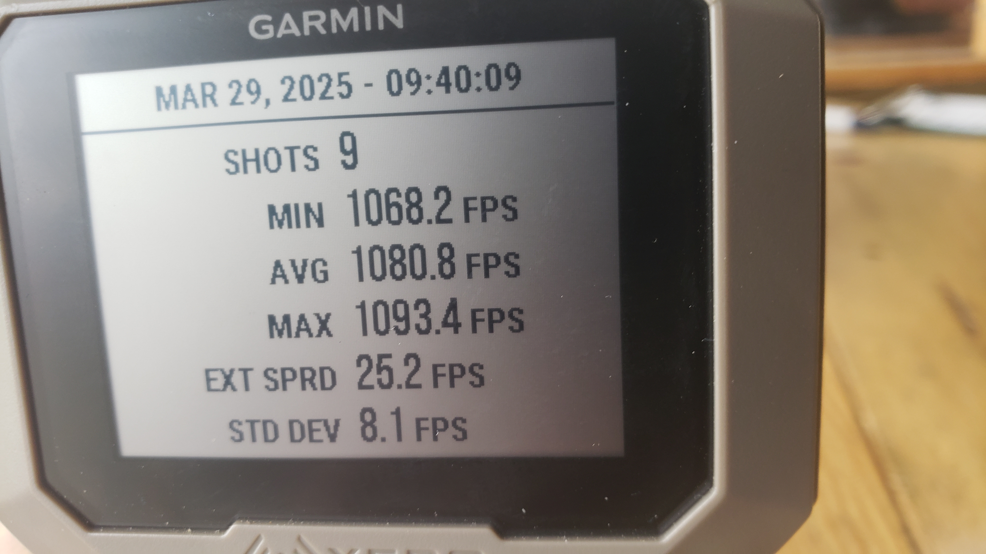

He shot the New stuff first and fired 10 shots, Wasn't very impressive with verticle hits on the 300 yard target.The EXT SPRD was 41.2 FPS and STD DEV was 11.6 fps. He then fired 9 shots of the Old Wolf with EXT SPRD 25.2 fps and STD DEV was 8.1 fps. It did had a bit better verticle spread on the 300 yard target. I know, I keep saying it's AMMO AMMO AMMO and don't care what equipment you bring but this does show there is a big difference especially at distance.
Lapua SLR
New Wolf by Eley
Old Wolf
