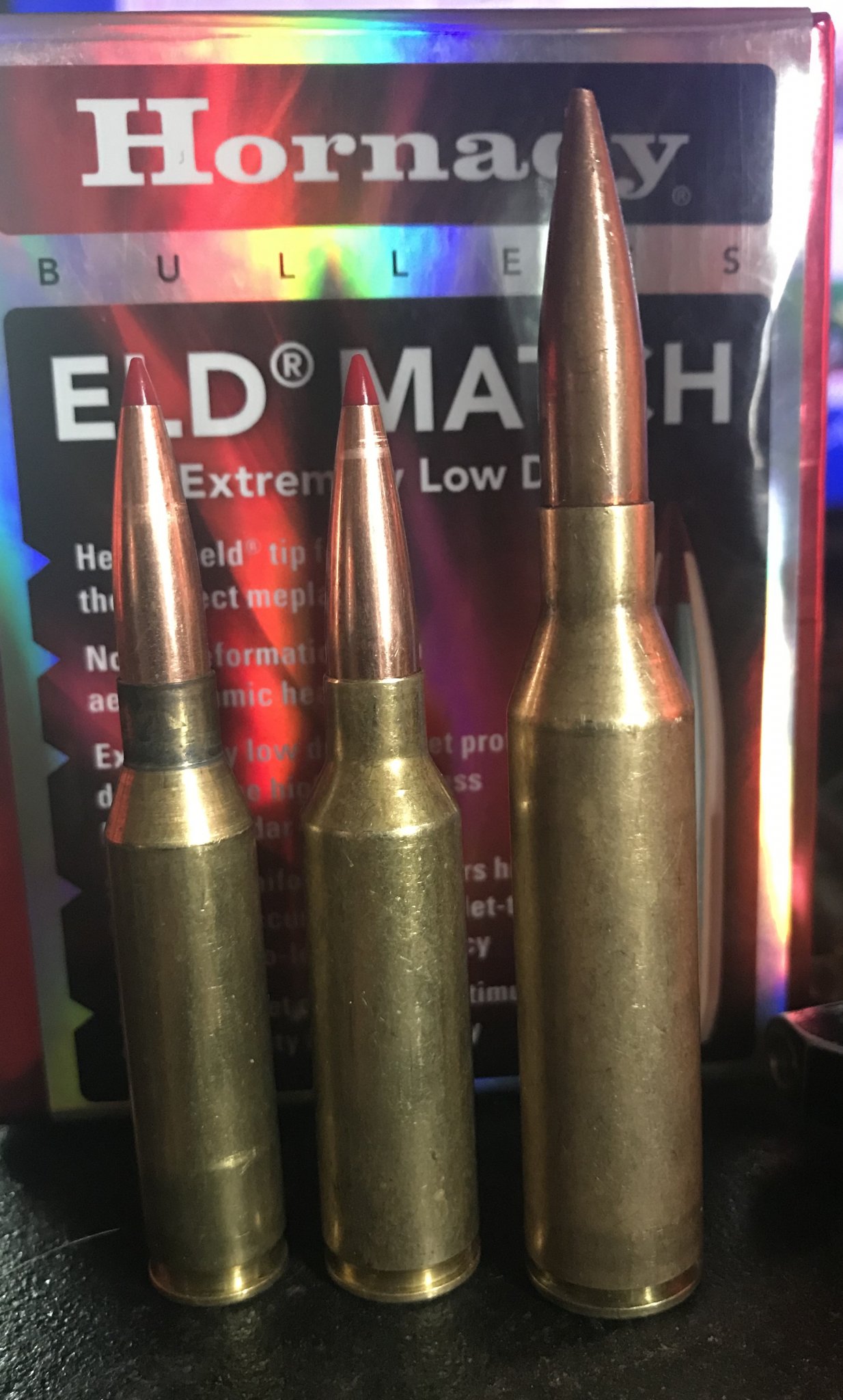

This shows the 185RDF, the 175SMK and the 180Hyb, and a one-off load of the RDFs tested at 200yds. They run about 2800fps at less than 2.800" OAL. I should try the 162 ELDs with reloader 26. Might be able to get them up to 3000fps. The old 162 Amax and Re17 would run about 2950fps.

I stuffed a 180 ELD into a 6.3 PRC case today for a mock up as it’s the same length as 7mm SAUM and it totally looks like it would work in long AI type mags.
