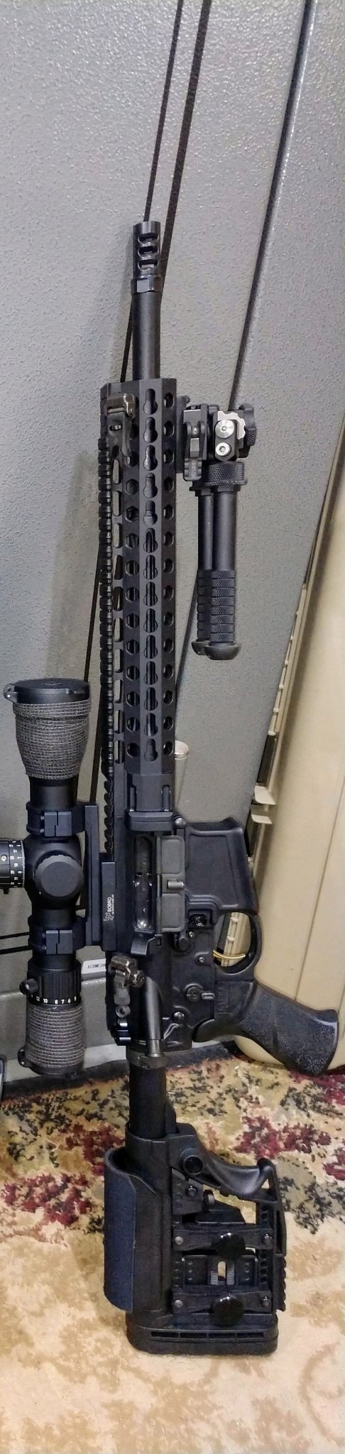

    Me personally, I use Both. LaRue used to sell his Upper Receiver/Handguard Combo on it's own for $400, and the true free floating barrel/handguard design helps the accuracy even further. This is a Compass Lake 16" Krieger CLE Match Chamber, 1-7.7 Twist, Intermediate Gas, SDM Profile, 9/16 Threads and Headspaced to a JP Enhanced Bolt/BCG. She's a honest Sub 1/2 MOA Setup.
    If I was doing this build for you I'd, buy the LaRue 16" "Accuracy" Upper for $750, and order a Compass Lake Barrel like mentioned above because right now any quality barrel blanks are running between 6 to 9 months behind if not longer.
    Shoot the LaRue upper as is until the CLE arrives, this will also give you time to find out how well of a semi-auto shooter you are, because I'm 100% sure the LaRue barrel will shoot at least sub MOA - .75 with Match Ammo. If you can't at least hold under 1" with Match Ammo all day with the LaRue barrel the CLE isn't going to magically make you better, and now days with the advancements/improvements in modern CNC machining shooting MOA with quality ammo isn't what I'd call a high Bar.

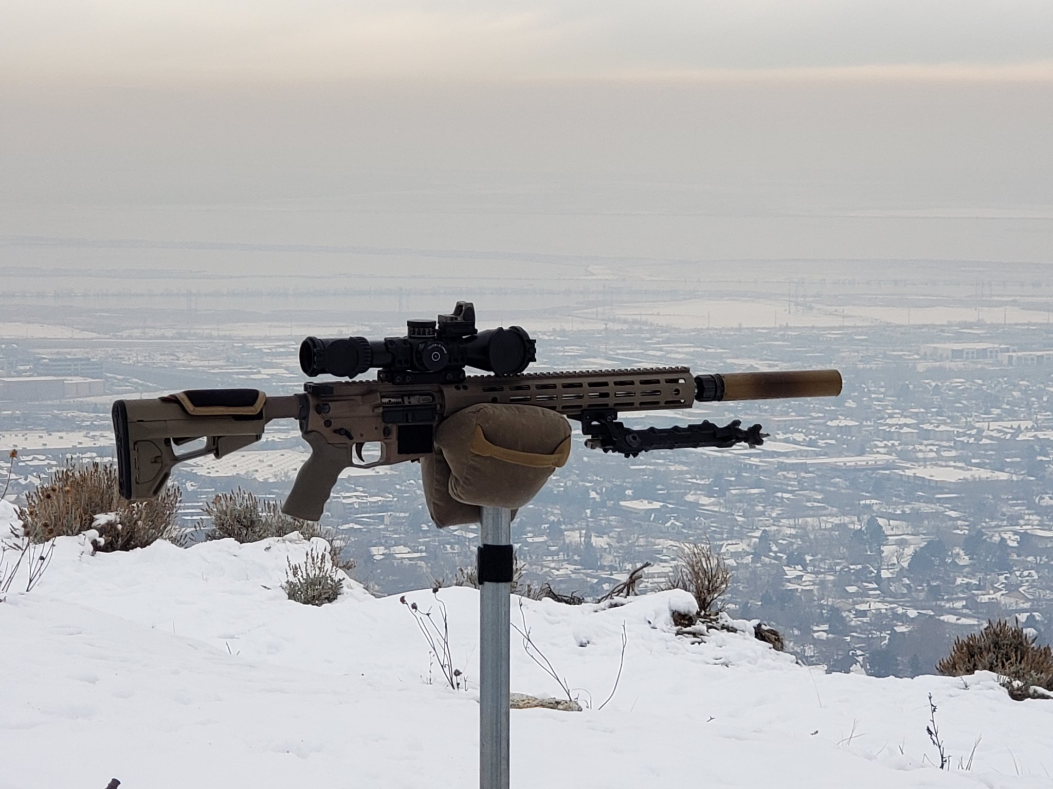

    You will be fine... In the pic I posted above I'm running a jp scs and a superlative gas block and a hybrid with a 30 cal end cap . It's a pussycat to shoot. No issues shooting it supressed bor unsuppressed

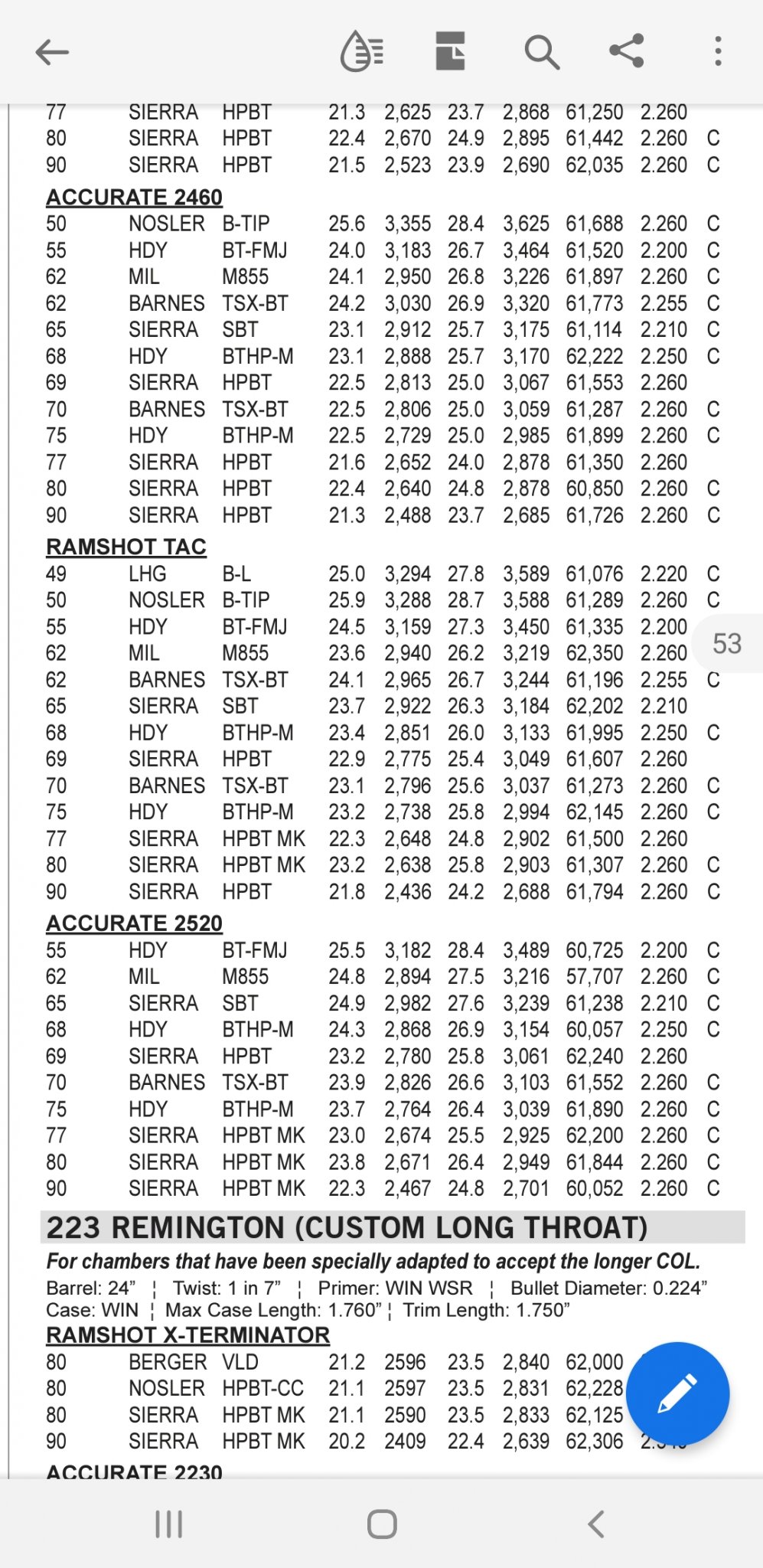

    Thats how mine is setup. I also know the setting for the can on to also BARELY operate. 5 clicks down. But its pretty tame with the can on also. I run a 30cal AAC 762SDN6.
    If you are a reloader get you some 8208XBR and you'll probably be pretty much in the ballpark at 23.2-23.4g load.

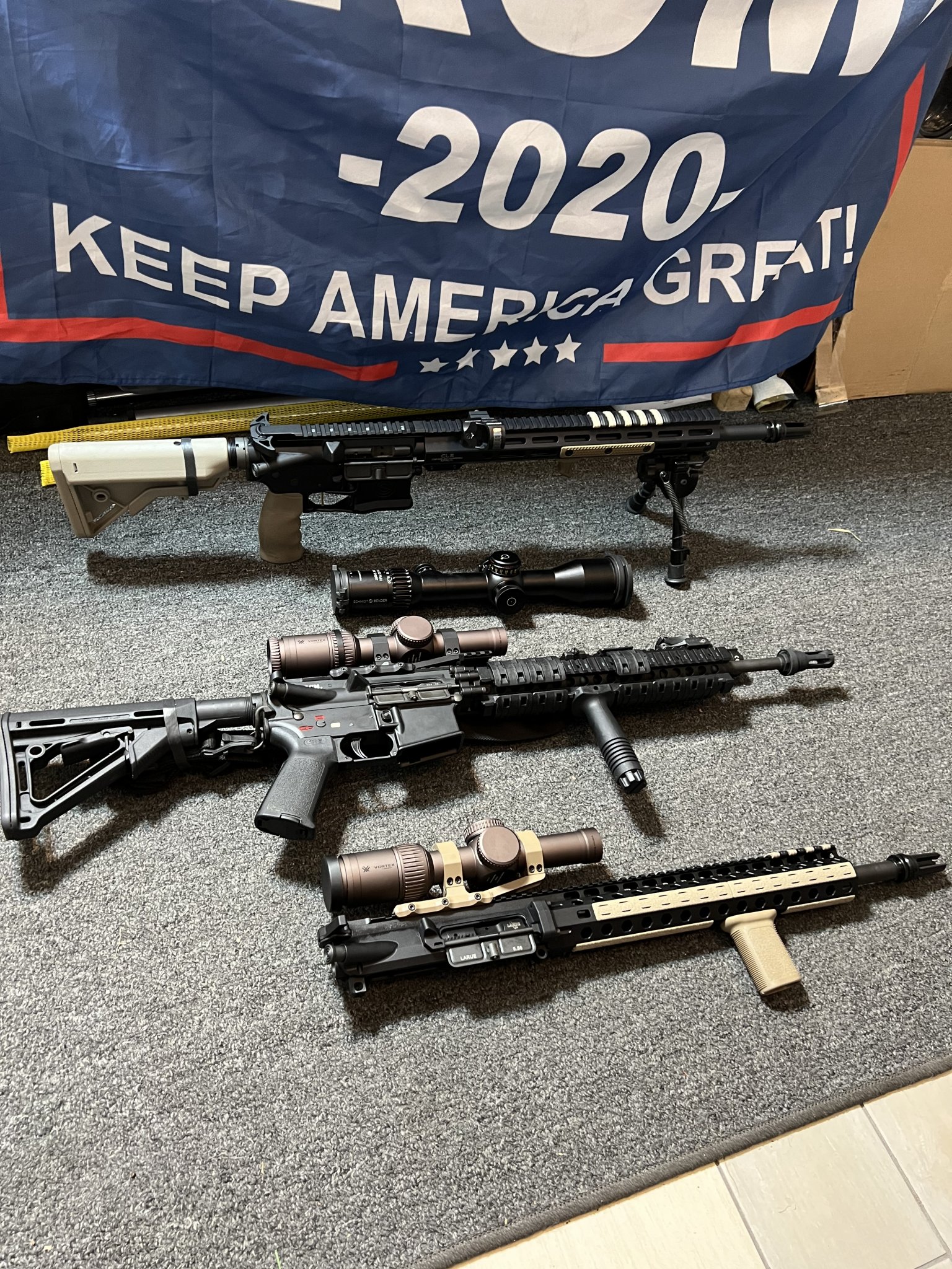

    So I ended up buying both lol. Will see which one shoots better this weekend. Middle one is an old BCM lightweight. Top is the compass lake waiting for a mount.
    Reactions: Tx_Aggie
    The compass lake rifle is going to run circles around the rest of them just feed it 77gr match ammo. If it was me I'd switch the two barrels, put the CLE Barrel into the LaRue upper.
    The LaRue barrel is going to shoot the same regardless witch upper it's in, but the true free floating design in the LaRue upper/handguard combo will make that CLE truly shine. I haven't made a rifle with that combination of parts that hasn't shot SUB 1/2 MOA yet and I've made a lot of them.
    After playing with both I’ve found fit and finish to be pretty similar with the edge to larue. The hand guard design on the larue is beefy as hell. I just which it had mlok at the 10, 2, 4, and 7 o clock positions. I like to put a tape switch there usually at 10 o clock. Only changes I’ve made is adding optics, light and changed the charging handle to a radian and a SiCo GDCH. Still can tell they need to break in and wear some of the anodizing down. Will do a rough zero and blast 100 rounds of junk ammo through both, clean both rifles then foul and shoot for groups and measure velocity.

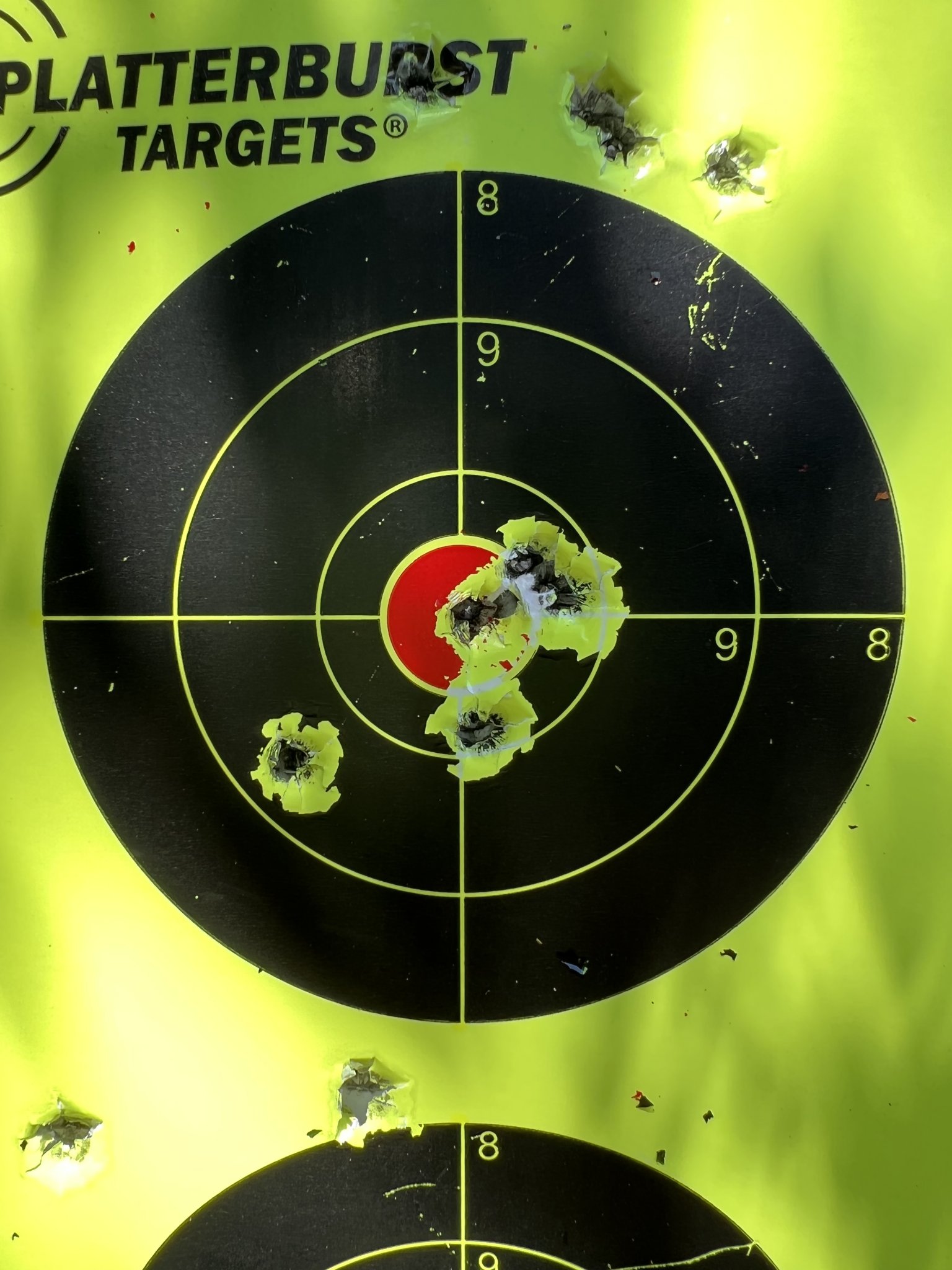

    Larue 5 round group with 77 bthp reman ammo. I had one bad trigger press. Not sure if it was that flier or not as it’s hard to tell through only a 6x scope. All in all I’m very pleased with the larue. Very mild recoil impulse as well
    i shot several groups. Only 2 at 100 and then shot at 363 yards and it printed a nice group on the steel. This upper is def a shooter and with reman ammo is pretty impressive. I need to get velocity numbers after around 100 rounds when it’s fully broken in.
    Post some more results once it gets broken in. Looks like you are off to a solid start
