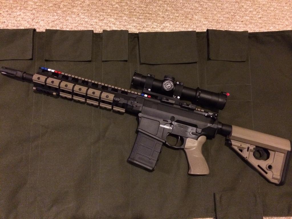

The looks need some work. I'd originally planned on a (black) NF ATACR on top of this gun, but that scope and mount are in use elsewhere. This S&B was already in the correct height Spuhr mount, not being used. But the RAL8000 Cerakote on the S&B just looks odd with the Magpul Foliage Green.
I've got an idea.
The attraction of the 6.5 CM when compared to the .308 for me is - obviously - the 6.5 CM's higher velocity with a higher BC projectile. To go shorter on the barrel would negate the velocity advantage to some degree.
I will tell you that the rig shown above with 24" barrel, complete with suppressor, is a handful, no question about it. But, it seems to work quite well for its intended purpose, long range capability.
Something 16" like this .308 is much easier to maneuver:
