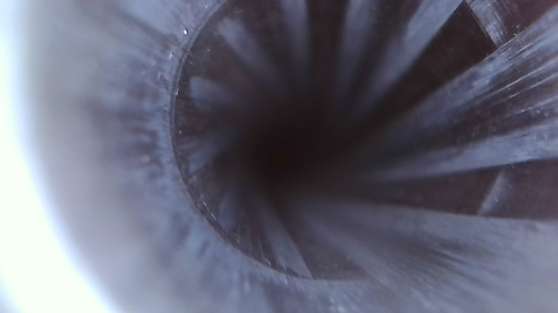

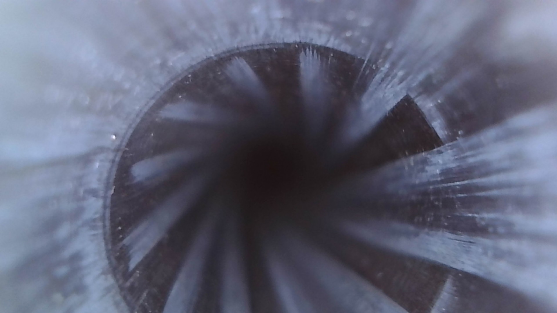

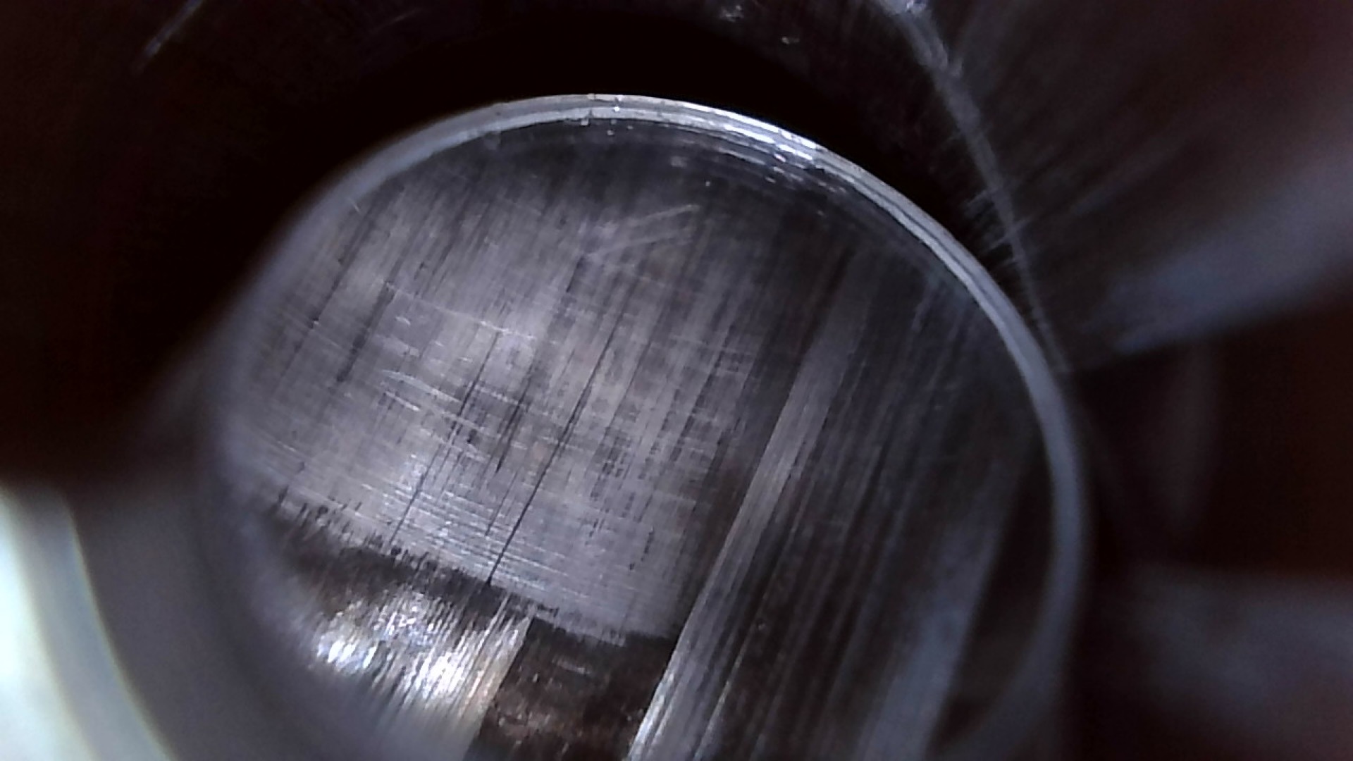

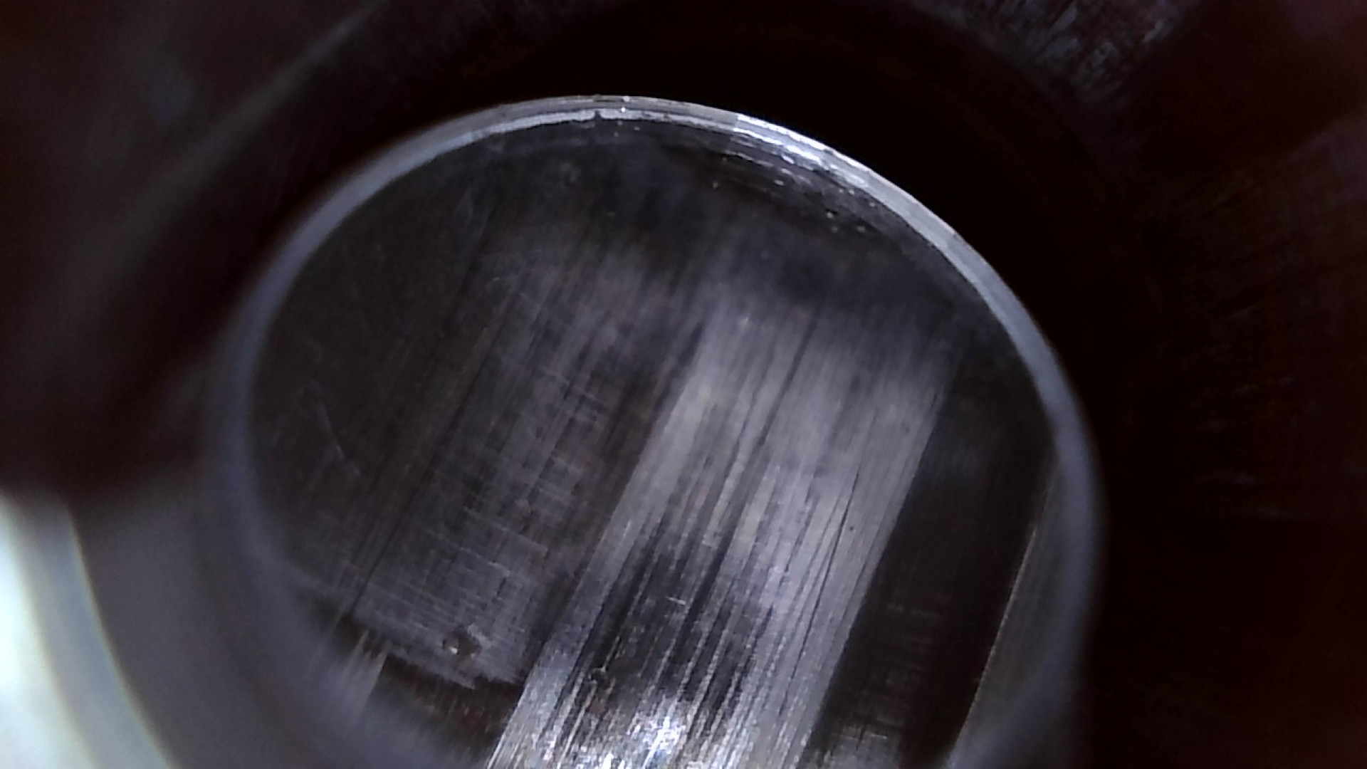

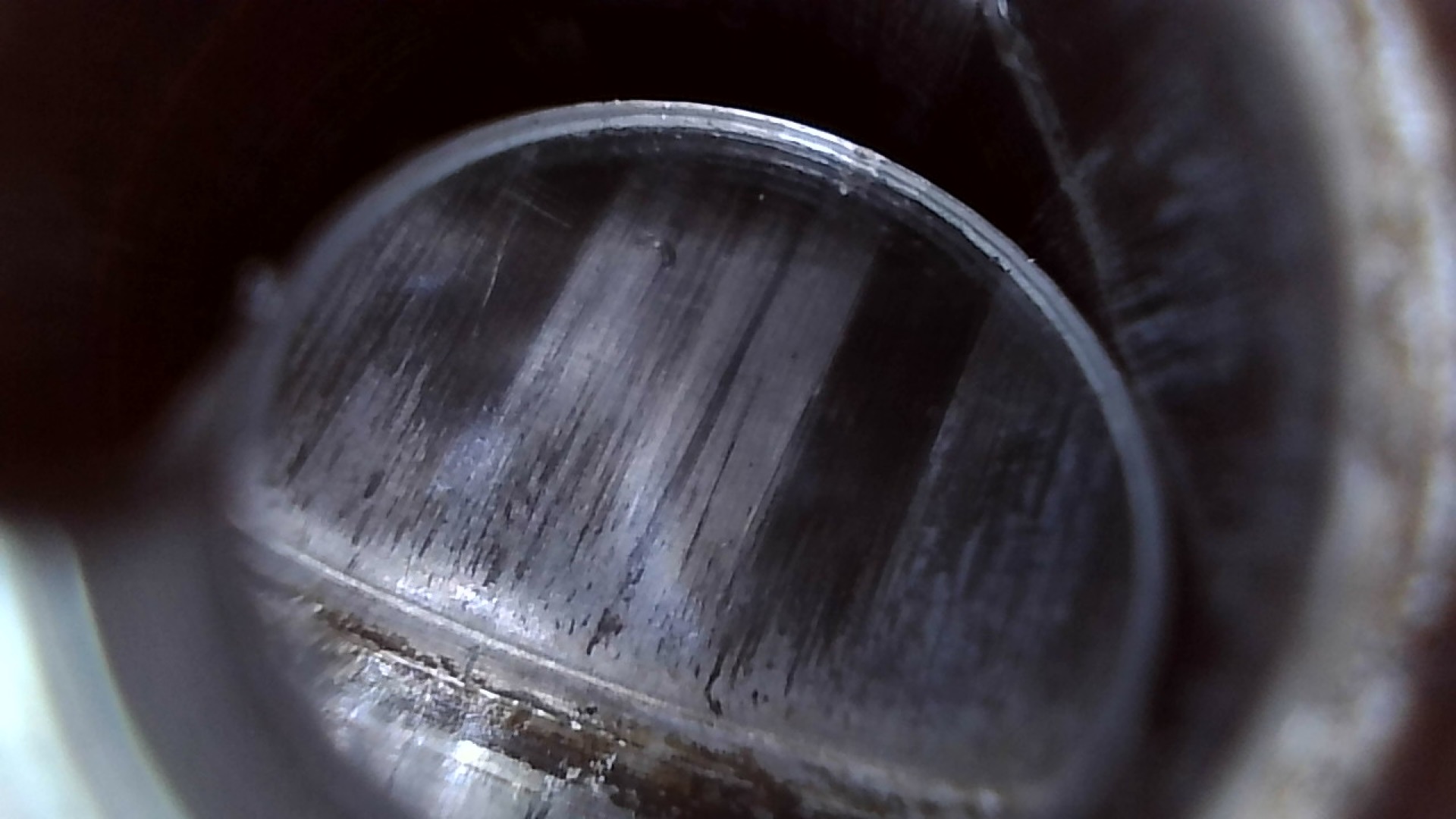

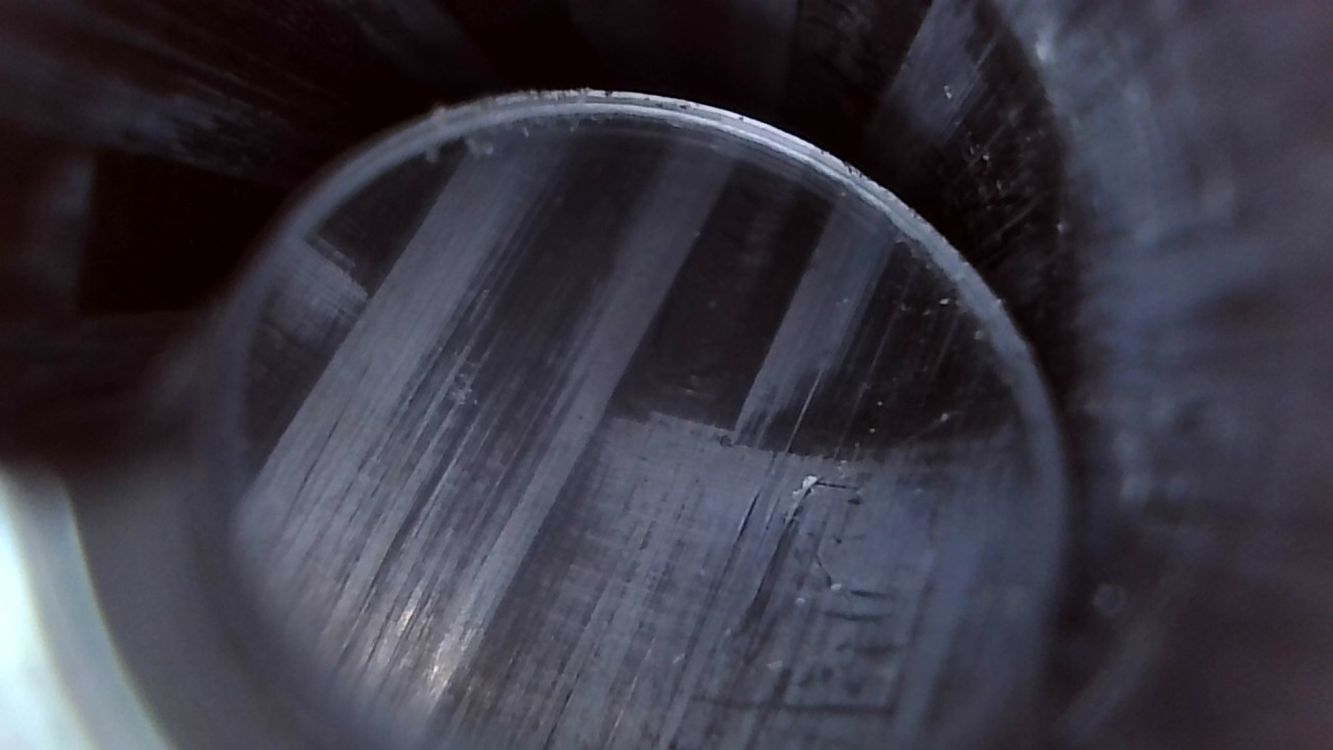

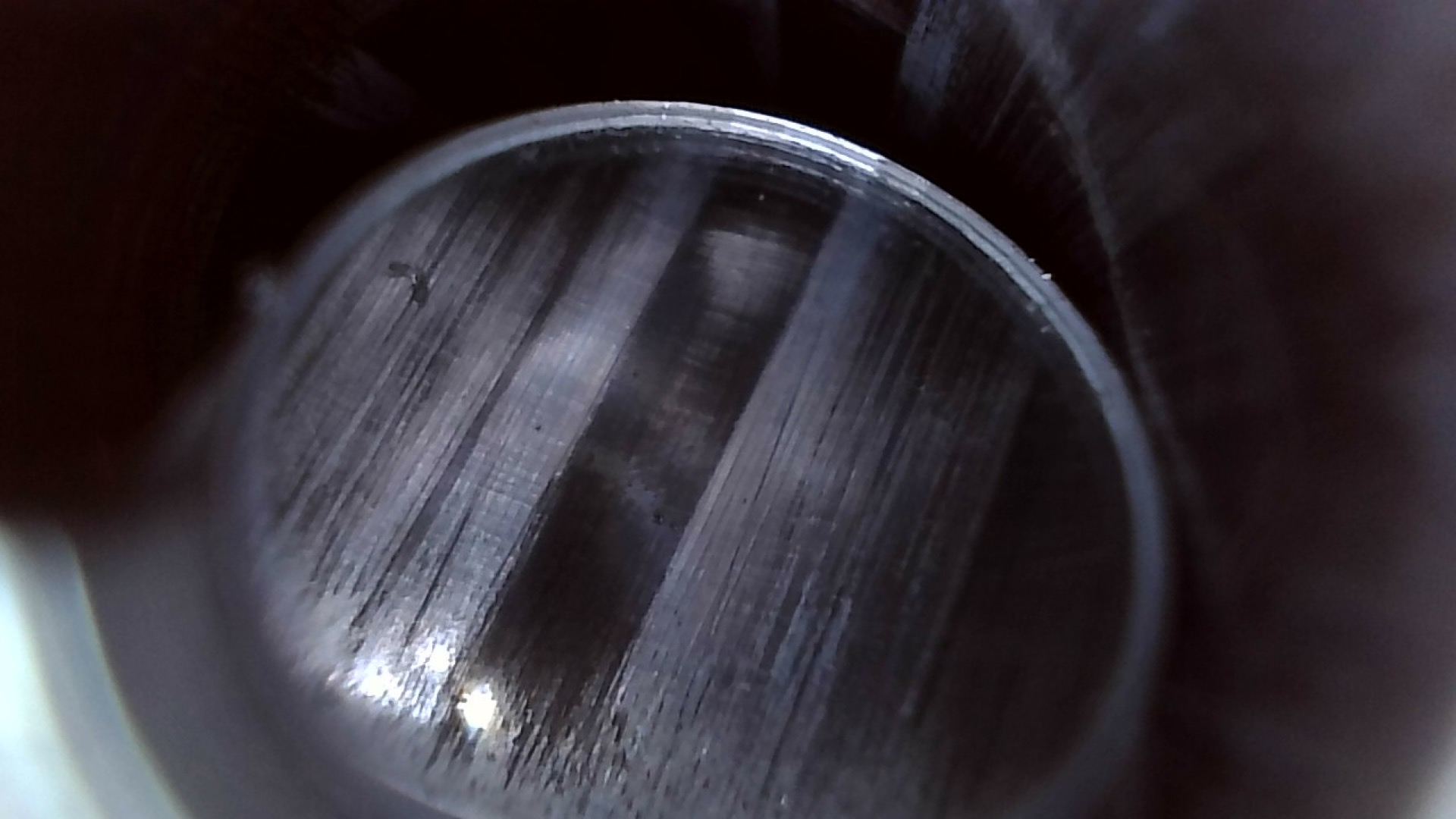

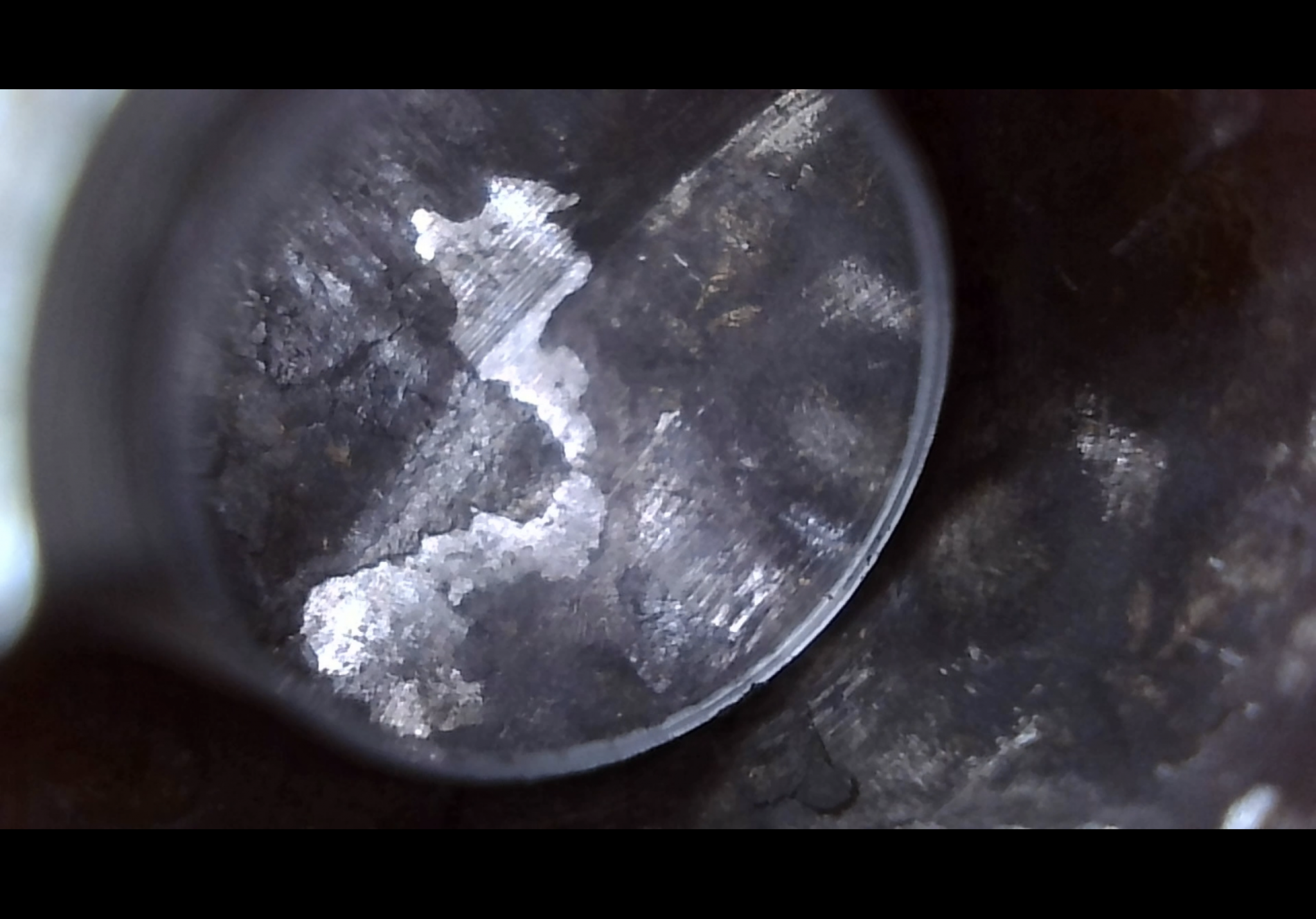

Fired brass was weird. Lots of dimples on the shoulder of fired brass. Not initially, but after maybe 20 rounds brass coming out of the gun looked mangled in the shoulder. Remained across different loads. I thought maybe lubricant in the chamber or maybe dirt until I borescoped it. I will borescope again after I clean the rifle, but this seems excessive, crazily so for 100 rounds total.
what seems extra weird to me is that the grooves of the rifling extend into the throat, and the shoulder looks like hammered dogshit. This is a new barrel with less than a hundred rounds total fired.
Is this normal? I am gonna clean and rescope, but I am worried that the grooves in the throat might be allowing gas/carbon directly into the shoulder area of the case causing rapid heavy fouling right at the shoulder.
I have still not ruled out user error either. But 2 moa seems excessive, especially with two experienced shooters behind the gun, across multiple loads, swapping between quality scopes, and retorquing everything to spec. Shot from prone with a rear bag and bipod in good conditions. Should be moa or slightly better all day long. Absent advice otherwise I am leaning towards an issue with the weapon. Either the barrel-action connection, or a defect in the chamber/barrel (most likely imho). Still possible we had a few shit rounds that fouled the chamber, or that we screwed something else up, but I am skeptical. just dont have a warm fuzzy that this is how things should be.

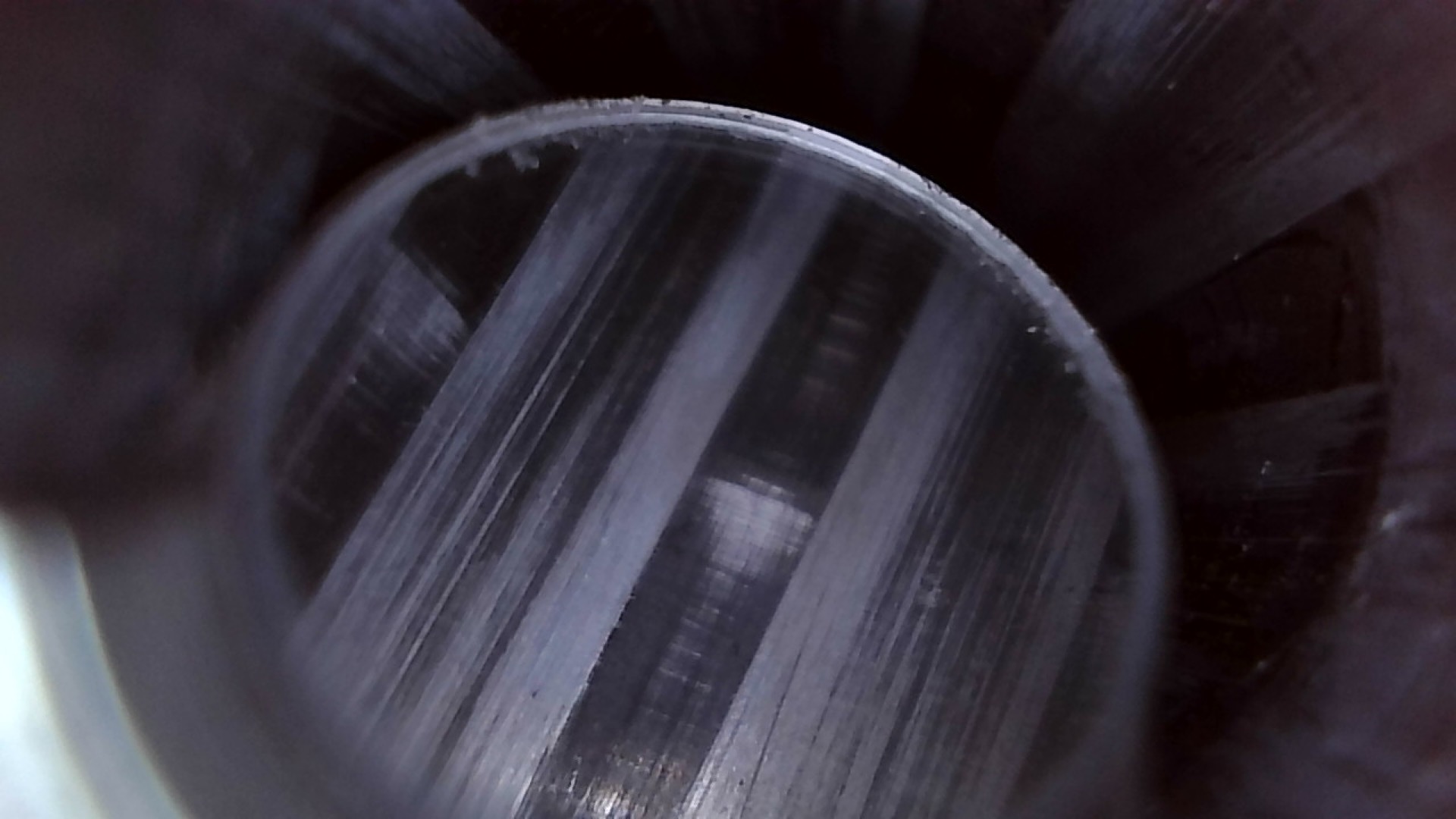

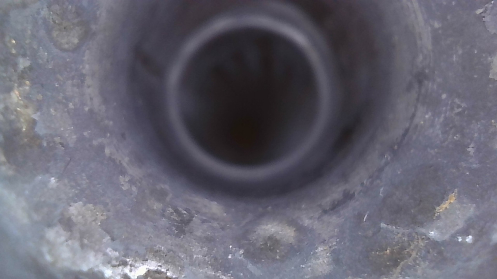

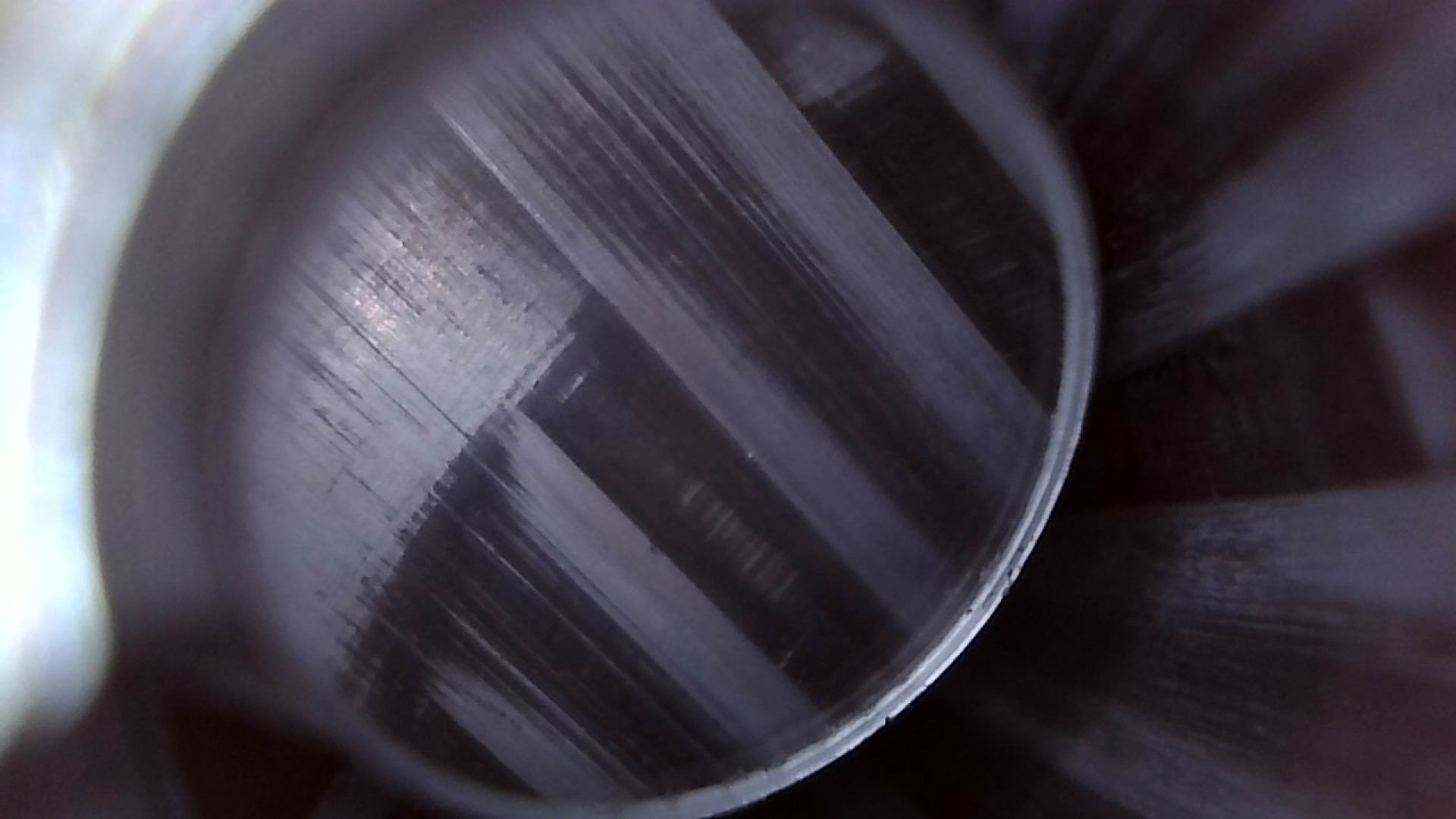

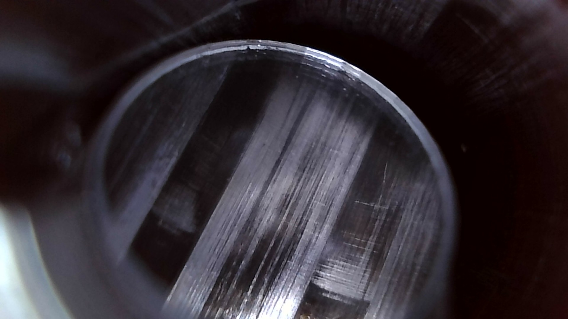

So a quick follow up. Attached are a couple photos after cleaning the rifle. The rifling clearly extends in places all the way down the throat to the neck of the chamber.
I dont have the tools to measure, but my guess is the chamber is not concentric to the bore, and the grooves are allowing gas back to the shoulder area.
Is this normal? I have never seen it before, and it is not present on my other rifles, but I am not experienced with a borescope either.
