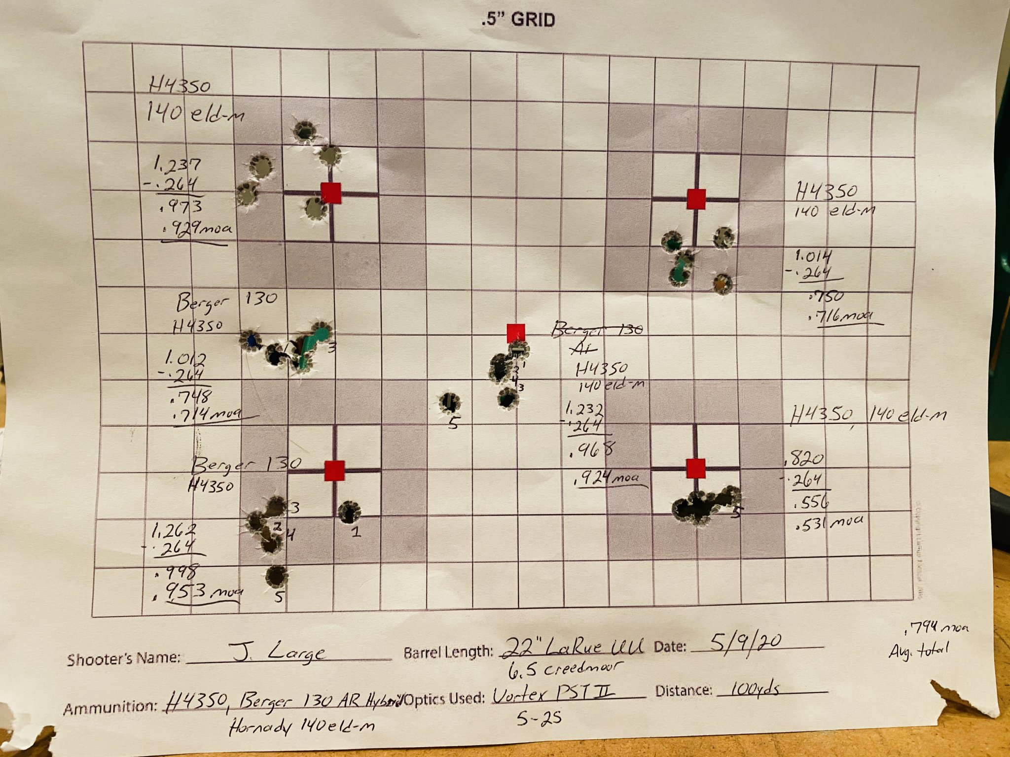

All of that said, I purchased the UU kit in 6.5creedmoor and while I’ve only put 45rds downrange, I’m very happy with it. It shoots factory Hornady 140eld ammo and 140eld handloads very well. I’m not sure if this is normal now with the in-house barrels or I just got lucky. I’ve got a 6.5g UU kit ordered as well. If I go 2/2 on the new barrels after my bad luck previously, I’ll be inclined to think something changed with their barrel making process.

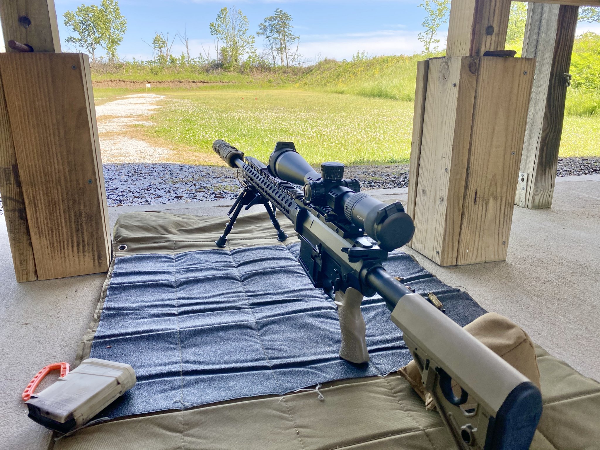

No experience with their suppressors. I shot these with one of my 30p-1’s. They are as heavy as a suppressor as I’ll run, and the Tranquillo is considerably heavier.
6 different loads tested, with some brass that had noticeable differences in neck tension. I wanted to shoot and not prep/load more ammo, so I went with what I had.
First try w/ Hornady 140 factory ammo.
