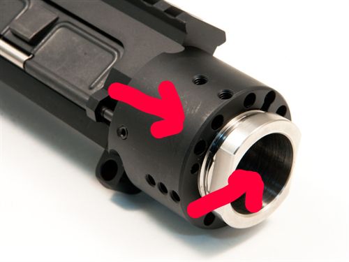

Once you insert you're Barrel into the upper of a seekins in then has a collar style barrel nut that secures the Barrel in place, if you put strain on the handguard it will transfer strain on the barrel, because the handguard is a attached to the outside of the upper Receiver and the upper receiver secures the barrel.

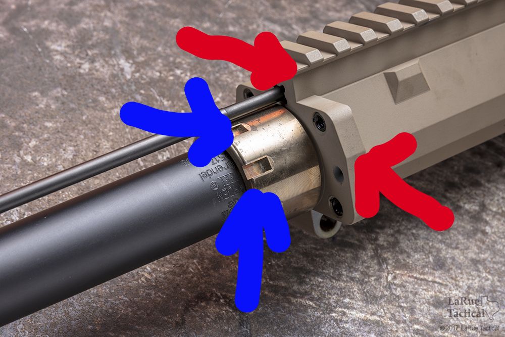

LaRue doesn't work that way, the handguard is attached to the upper receiver but not where the barrel nut threads are located, so you can put as much strain on that handguard and it will not come in contact with the barrel nut in anyway keeping a true free floating platform.
This is what I'm talking about
As seen here with the Red arrows indicating pressure transfer, Any Force/torque that is applied to the outside of the handguard will transfer straight through to the barrel, because they are all connected.
with the LaRue any pressure or torque that is applied from the handguard will be transferred to the area's pointed out and in red, while keeping areas highlighted in blue completely free floating an unaffected from any other outside force.

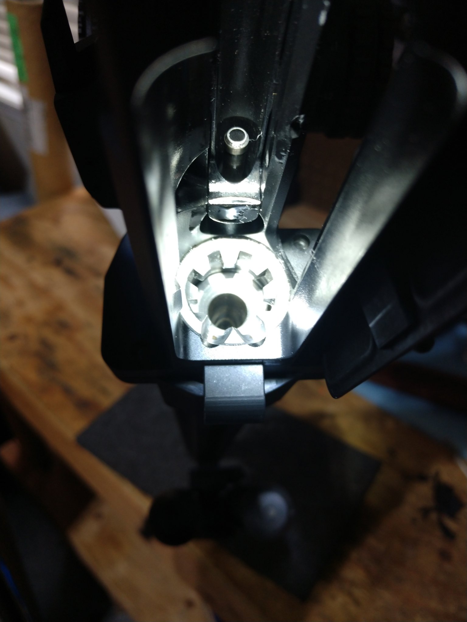

The Larue UU kit is a good design, but the Larue barrel extensions are cut .003 smaller then the DPMS extensions. Larue will tell you they fit and they do with a lot of heat and force. All the DPMS extensions (from Proof) I’ve seen in UU kits the feed ramps don’t line up. Easy fix with a dremel. I’ve had great performance out of my Larue barrels. I wish Larue would put a bit more aluminum in the handguard and barrel interface to account for the difference in heat expansion of steel and aluminum. I haven’t seen any issues with my Ptober or UU’s, I’d still like more meat for piece of mimd.
The Seekins guns have a huge amount of aluminum in the handguard and barrel nut interface. The handguard didn’t feel good in the hand and the plain machining doesn’t do much for pride of ownership. The handguard rides bags really well. I haven’t been pleased with the performance with the Seekins factory barrels but DPMS barrel extensions fit perfect so the aftermarket is endless. I’ve now seen several SP-10M’s and they have all shot amazing. If I was gonna build a comp gun today it would be on a Seekins kit with a barrel of my choosing. I’d choose Seekins for the long strings of fire in comps and short cooling time in between stages.
I shot a G MK18 in tac light and it shot all over the place. The threads on the small frame upper just isn’t enough to handle 16” of handguard no matter the barrel nut design. If it touched anything, bi-pod or support once it got hot it slung bullets.

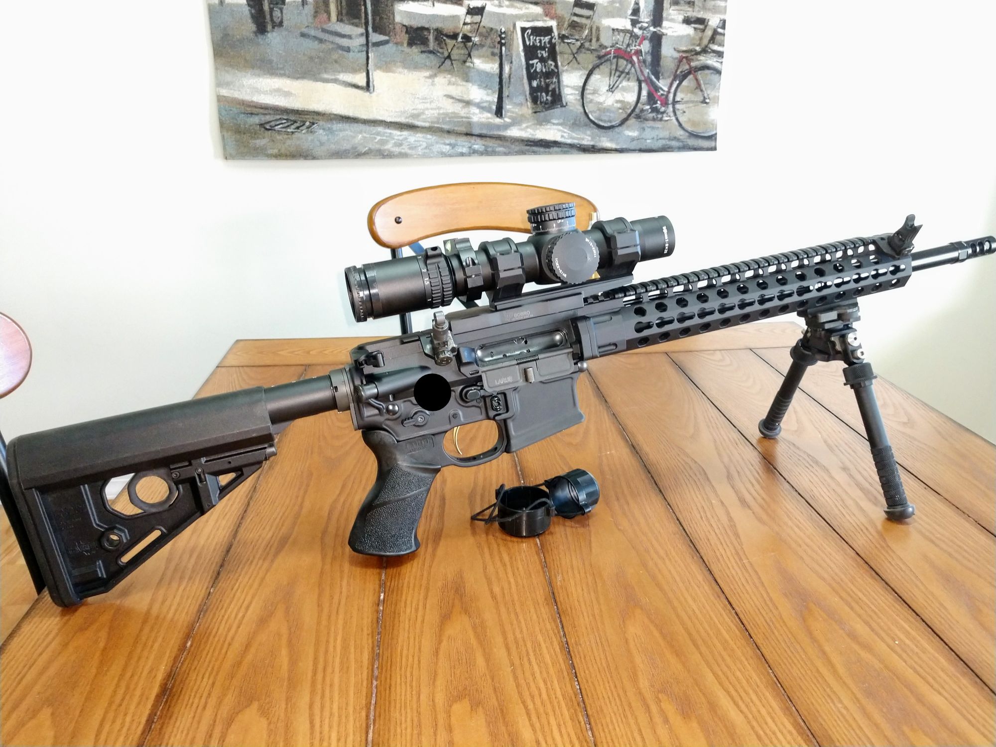

Are you talking about large frame or small frame? Also I am now on my 4th build using the LaRue upper receiver handguard combo and with the barrel extensions supplied by Compass Lake they absolutely fit perfectly. And that tight thermal fitting is actually a positive, sometimes it could be a pain in the ass but it is actually the desired fit.

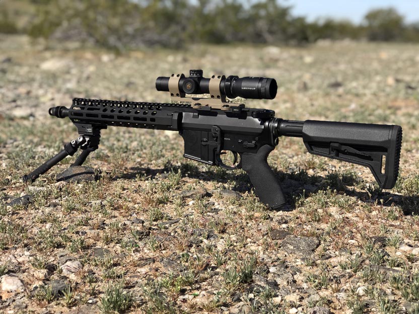

This is one of the four that I recently finished and it is by far the most accurate recce rifle I've built to date.
I only have experience with the UU large frames. I'm very familiar with thermal fit, if it worn't for the feed ramps not lining up I would say the DPMS/SR to UU fitment was perfect. Even if the extension ramps were recessed I would have been good with it, but the DPMS large frame extension protruded into the upper a few thou causing a lip. Luckly all my larue barrel have shot great so no issue. It's good to hear that the small frames are an easy fit.
Here's a pic I just took for you from my small frame, you can also take a thin barrel shim and cut out 1/16" for the centering anti rotation pin out of it and use it to bring the barrel extension inside back to flush.
Also I wouldn't be surprised if this was a proof research issue do you have any friends that may have a JP Barrel hanging around somewhere?
Also how FT-LB did you torque the barrel down to?
Yes, but honestly I’m not that interested in finding out at this time. I’ve got a stack of Larue barrels and they’ve been great so far.
Great idea with the shim. If I run into that problem again that’ll be my go to.
