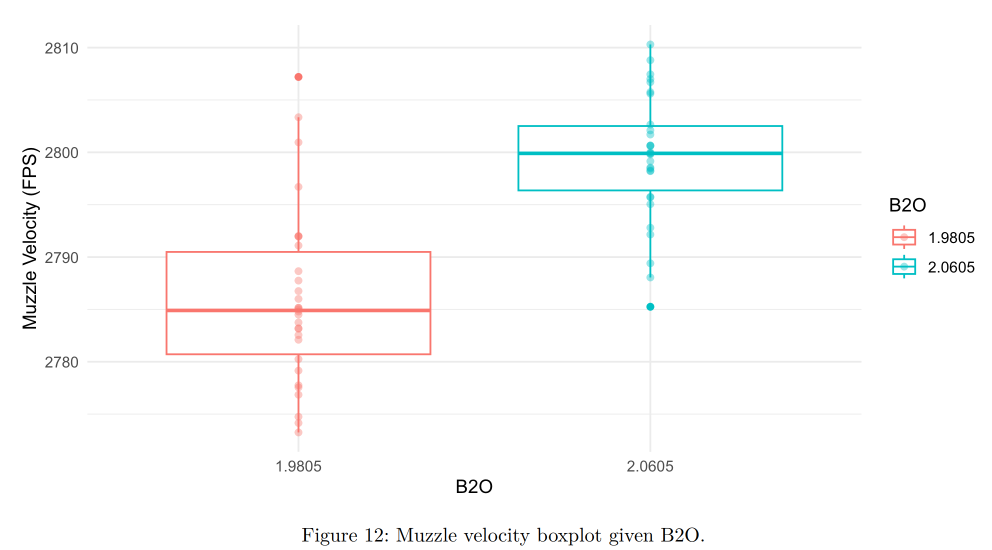

On the jump/velocity questions, I read something about longer jumps giving lower velocity spreads in a fleet of PRS guns. I was working on a 7/300PRC set up for 190s at the time. Those results were:
Jump, Avg Vel, ES, SD
10 Jam, 3025, 11, 4.9
25 Jump, 3002, 10, 4.3
50 Jump, 2999, 14, 5.2
75 Jump, 2998, 15, 5.5
5 shot strings, shot in the order presented. The most likely source of noise was the air heating up about 5 degrees during the test.
The assertion was jumps beyond 50 gave better velocity spreads on the whole. I decided that might be the case if you were loading for several PRS rifles but the first cut at it didn't look that promising with relatively overbore cartridges and an individual rifle.
Reactions: Taylorbok

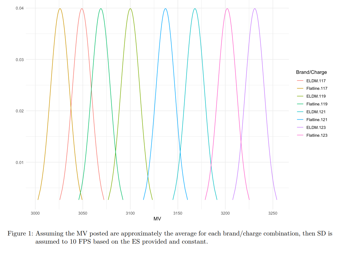

Are those MV averages or single shot?
As I went up in charge the gap widened between the 400 and 375gr Lazers.
I'm going to test at distance between the 390 and 400 next week. The A-tip should be a bit better in the wind but it's not a huge difference.
This is based on 5 shot sample.

5 shot averages. They weren't great, between 20 and 30 fps on the ES.
Based on those ES, it’s assumed the SD is around 10 FPS. We would see approximate distributions like the figure below. We can see there are some of overlap.
A bit of trivia is for cartridges with ELR overbore ratios, 100 fps takes about 10,000 psi.
PRS stuff is closer to 150 fps for 10,000 psi.

This is what 20 fps ES and 2% on the BC for 10 shots looks like at 3300 yards. 2950 fps with a 0.45 G7, pretty similar to 375 Cheytac with Lazers. With a properly chambered fresh barrel and top notch loading, the BC spread can be 1% and 10 fps on the velocity. The vertical will be a little over half of what's in this video. After the similarities to 375CT ballistics, the next thing I like about this test is the wind is obviously up there but vertical is clearly the larger problem.
With a jacketed bullet freebore, the payoff at distance is a lot less likely to be there.
